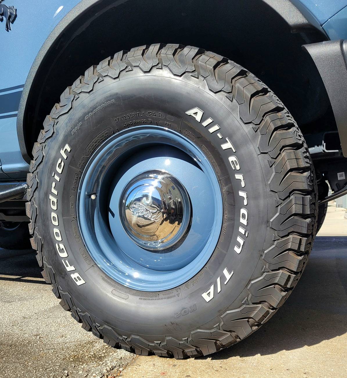

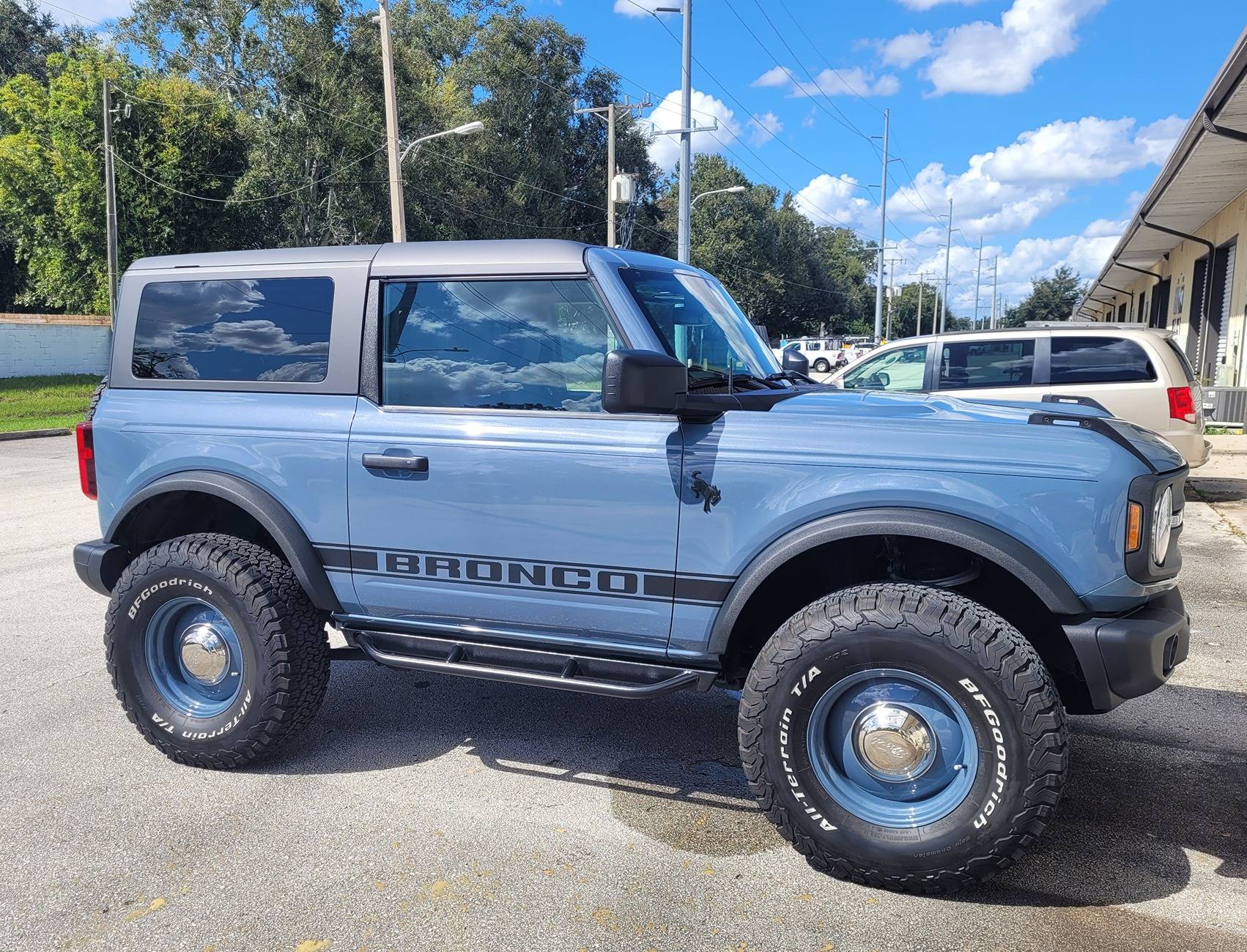

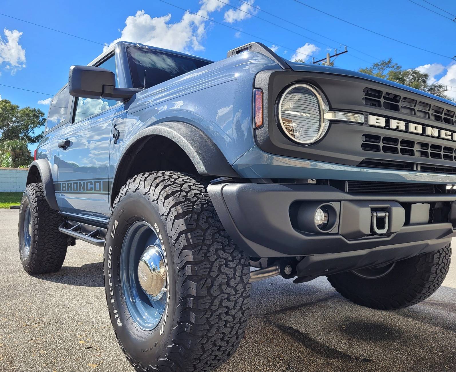

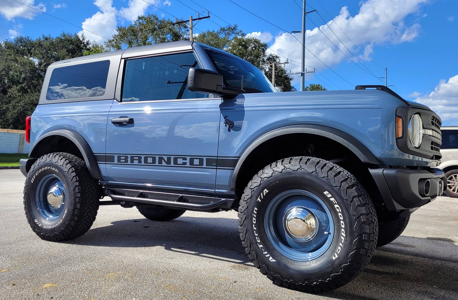

Finally finished my build. Went for an old school vibe. I love the final look. Lots of compliments on not overdoing it. Just wanted to post in case anyone else wants this look. Started with a new 2023 black diamond. Lifted 3" with Bilstein 5100 shocks on top setting. Went with U.S. Wheel Smoothie Series 51. 17x9. Offset: 19 | Backspacing: 5.75. Pro painted to match OEM color. Ford retro chrome center caps. BF Goodrich All Terrain KO2 37x12.5xr17. Nice poke, no rubbing at all. Custom Bronco side decal and black horse emblems. Rock Hard 4x4 Patriot Series tube sliders angled down(amazing quality). Love looking at and driving this Bronco! On the road in Orlando, FL. Jeff

Did you replace your upper control arms with the 5100s? If not how was the alignment after, we're they able to get the camber within spec.

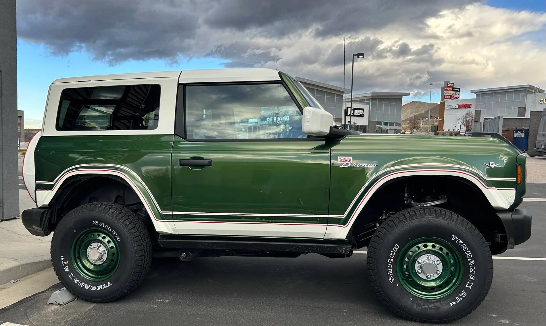

It looks fantastic. I love the color matched wheels. I did the same thing with my factory steel wheels. For winter wheels.
Ford Bronco 'Old School' Vibe Bronco Build Finally Finished IMG_5648
Stock control arms.
I did have to do an alignment. Flat and straight as an arrow after

Love the Vibe!!! Do you know if the wheels are hub centric or universal fit?
