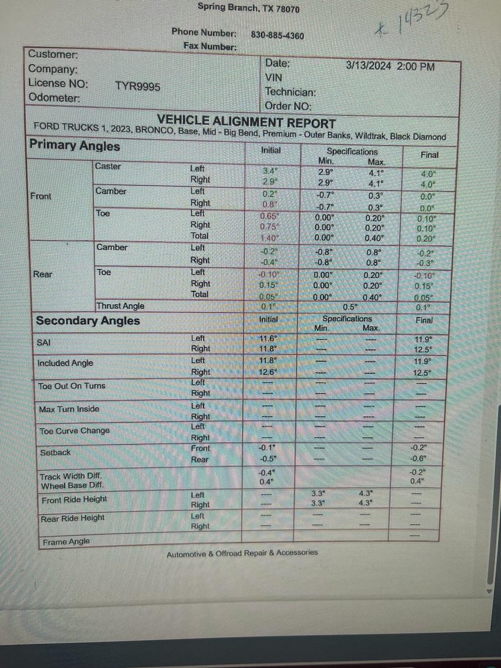

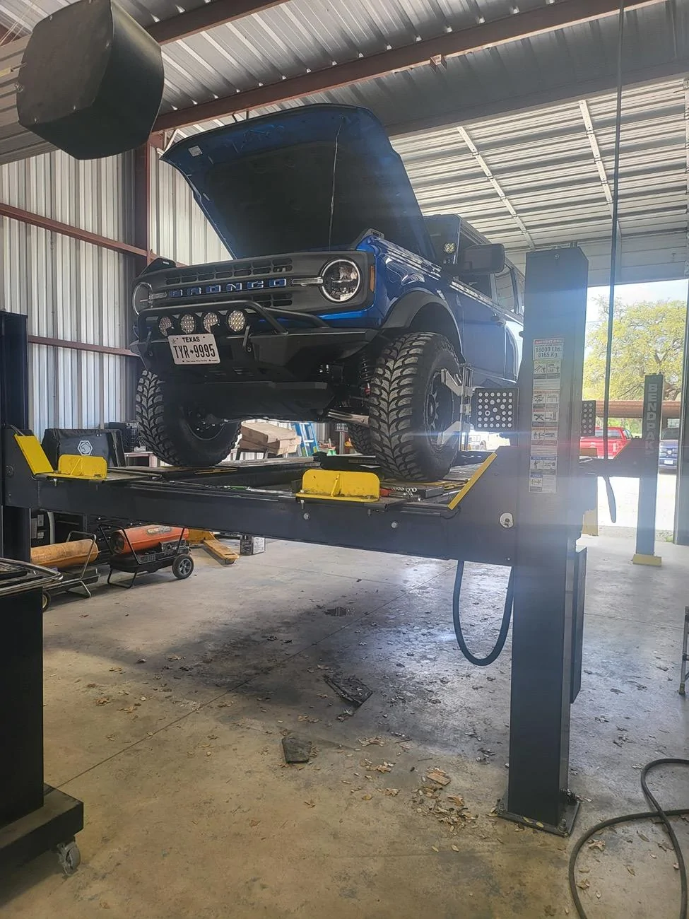

They’re in the business of selling control arms. My Bronco aligned just fine with stock uppers. My son did the alignment and at my request added additional caster.

I would trust stock uppers to not allow over extended full droop more than aftermarket. Per the video they are just building in some slight caster and camber correction into their aftermarket uppers. Not rocket science. But you spend your money how you see fit for a 2” lift .

When Bilstein was testing 8112s on my Bronco they said that the Bronco aligned just fine with stock UCAs and over 3.5" lift. They had lifted it that much just for testing. In the end I ended up with 2" lift on stock UCAs.
By all accounts the Bronco UCAs are designed better than the Toyota ones, at least in terms of tolerance for lift. From what I have read with a Toyota you do need UCAs with 2" lift.
