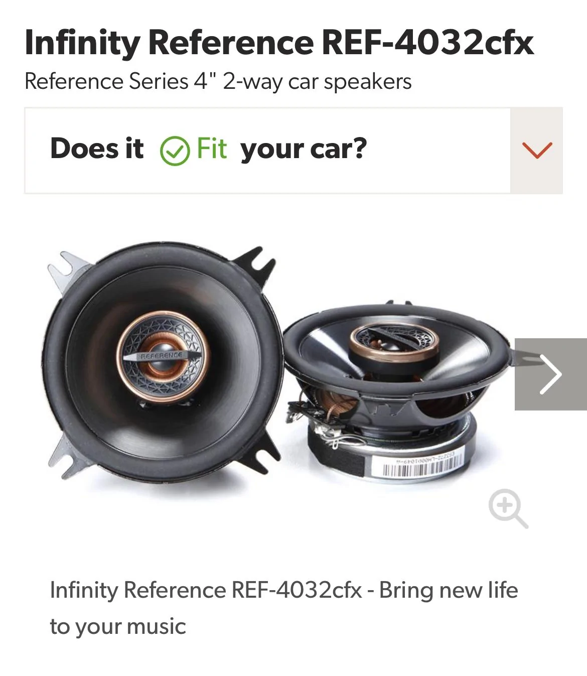

Purchased 4 of these to replace the 4” in front and rear. This is on a stock system, not B&O, and will not have an amp powering. Looking for someone who has installed these without amp and how they sound…anything better I should consider for more clean and pure sound?
May also consider installing a powered sub in rear.

I did first without and amp and now with an amp. My observations-
1. Significant improvement in clarity of sound.
2. Slightly more volume (lower impedance and more efficient speaker, so that was expected).
3. I added "bass blockers" at 300hz and that helped allow them a bit more volume without distortion.
4. They are "bright" sounding off the windshield. Not overpowering, but may be great or not, depending on your preference.
5. I have had an intermittent buzzing from the right front. Infinity (Harman/JBL) is warrantying them and I will move them to the rear pods.
Current state- I ordered a dash upgrade, Kicker 47KSC404. They will go in Wednesday when they arrive. Now that I have the amp and added aftermarket Kicker 6.5' in the kick panels, I wanted something with a textile dome tweeter (less "bright" hopefully) and a bit more power handling.
It is really good now, but still will be adding an sub and additional or different amp as a next step.
