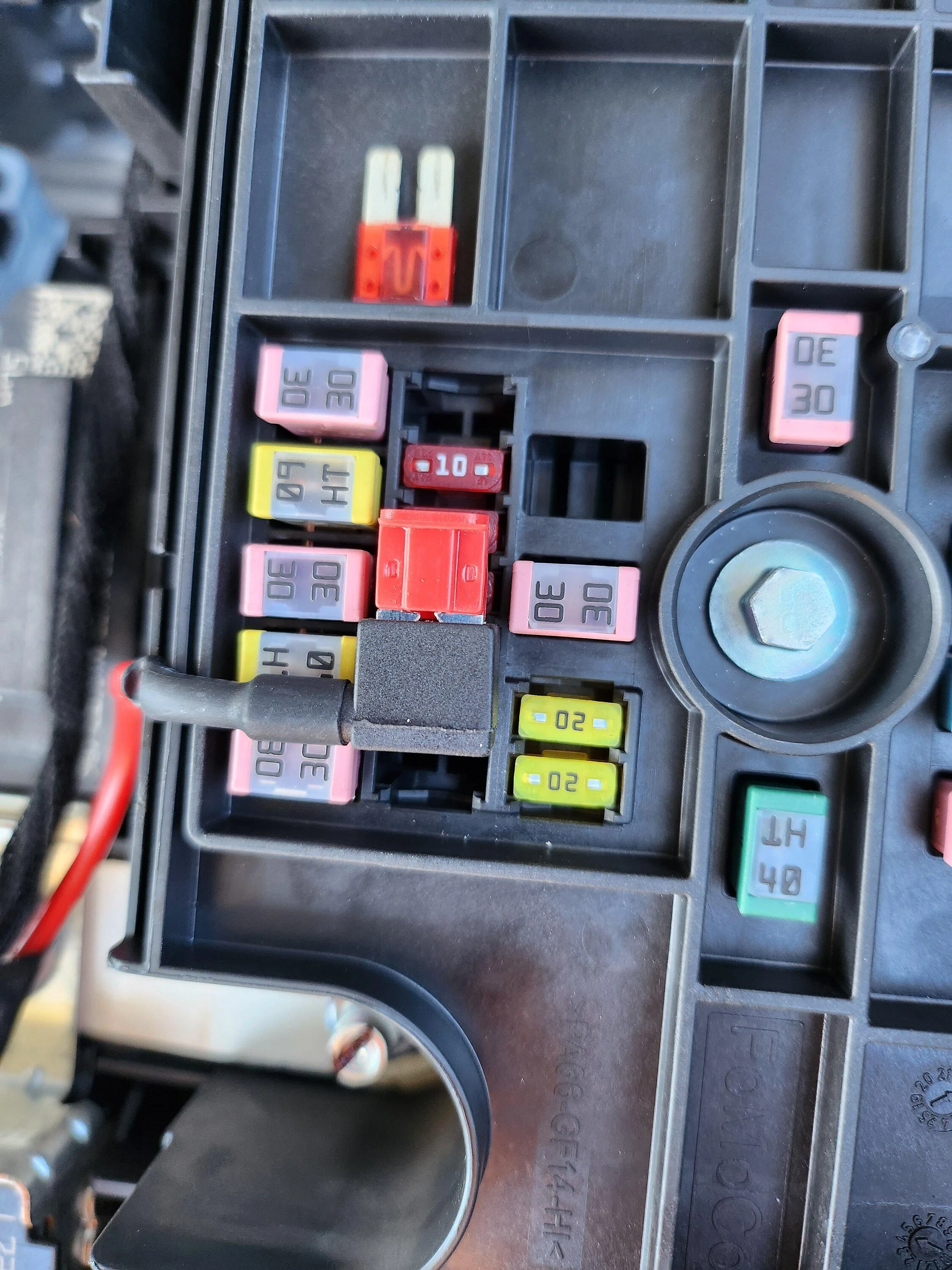

I installed the oracle bronco letters a couple months back I added the fuse at this location(pic 1)
Ford Bronco Oracle bronco light add a fuse location help. image

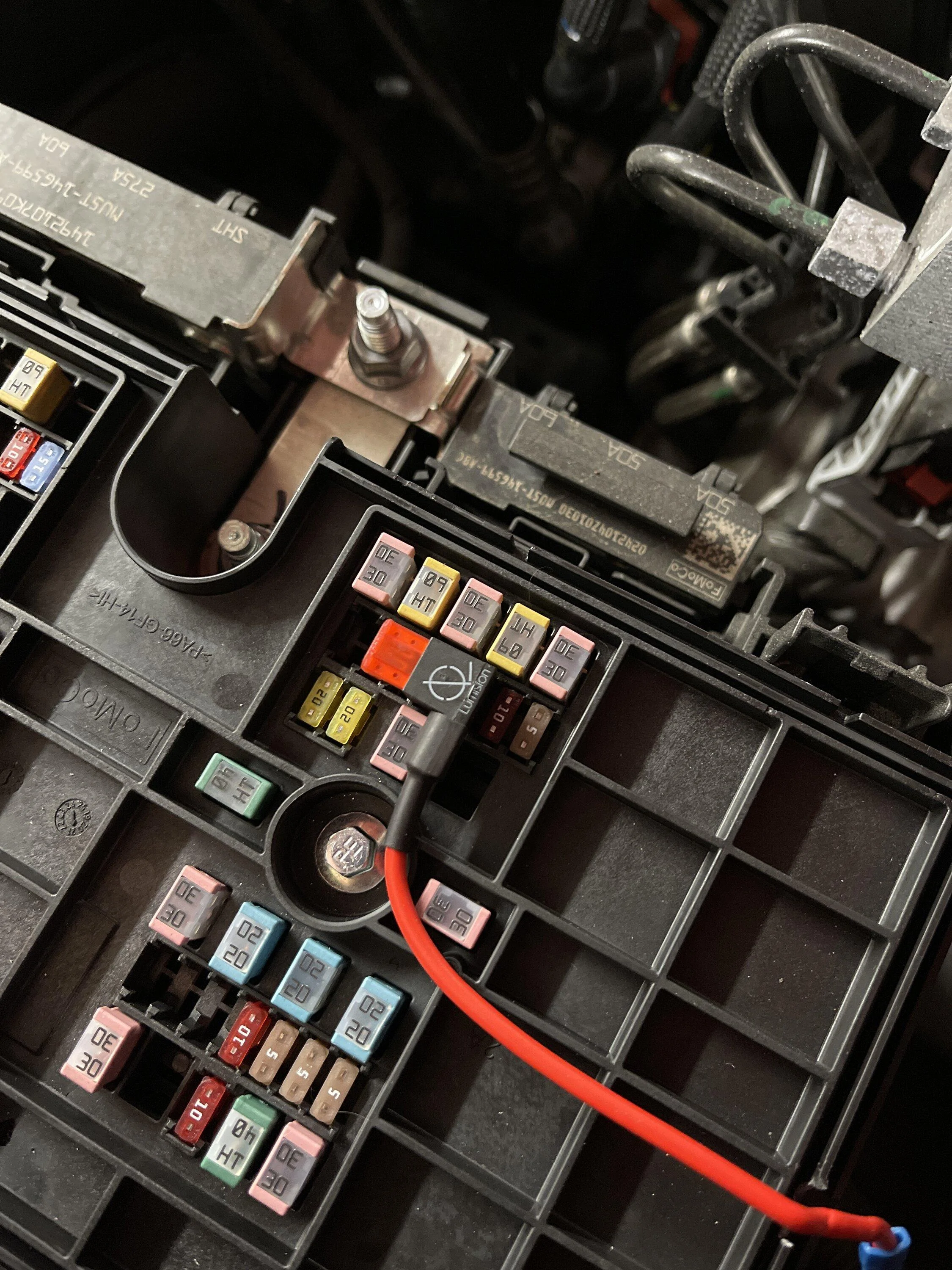

It's not a bad spot although the lights stay on for like 5-10 minutes after the car is off.
I saw another thread where they added the fuse to this one.
When I did that, I got a cross traffic alert system failure. Thus I went back to the other fuse location. It's worth to note I tapped into that fuse for my amp remote line. The amp wouldn't draw that much power to throw off the cross traffic system? Any other options?

That's the one I put in and it threw the errors

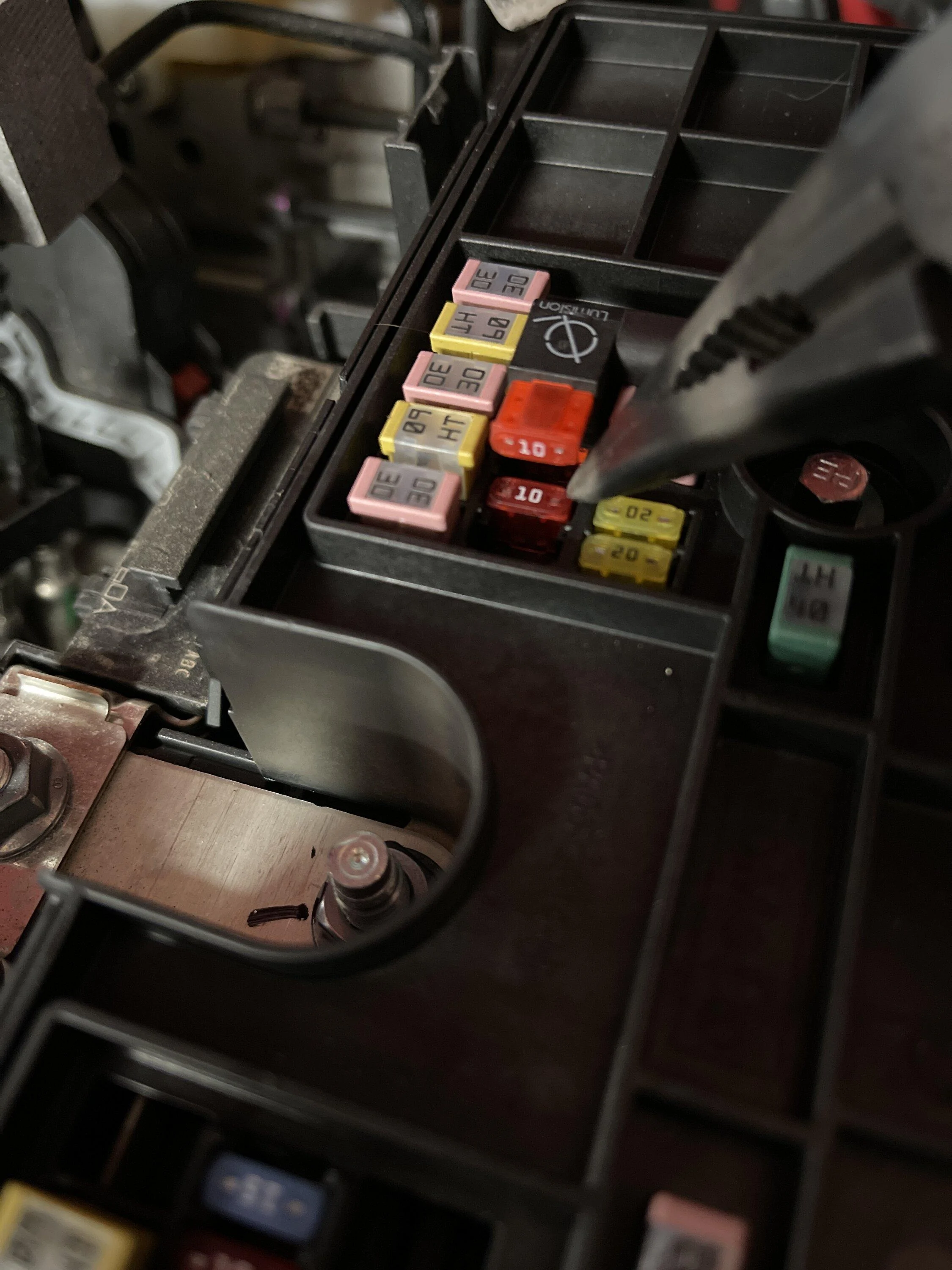

I got the same error when I had 1 fuse. When I put another fuse on the 2nd slot total 20amp fuse. It didn't throw an error.
Are you guys able to close the fuse box all the way down to where it locks the 3 sides?
I got mine to close, I used a lil DIY to cut a slot and it worked.
