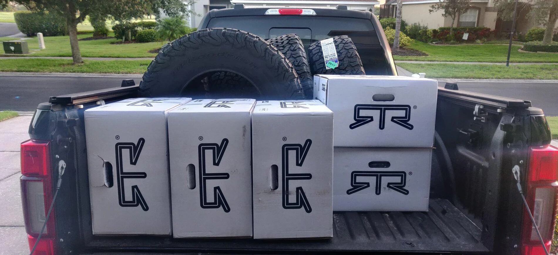

We have RTR Tech 6 Wheels waiting for a set of 35s to arrive and the 4WP leveling kit will arrive later this week. I am hopeful to have everything installed this weekend.

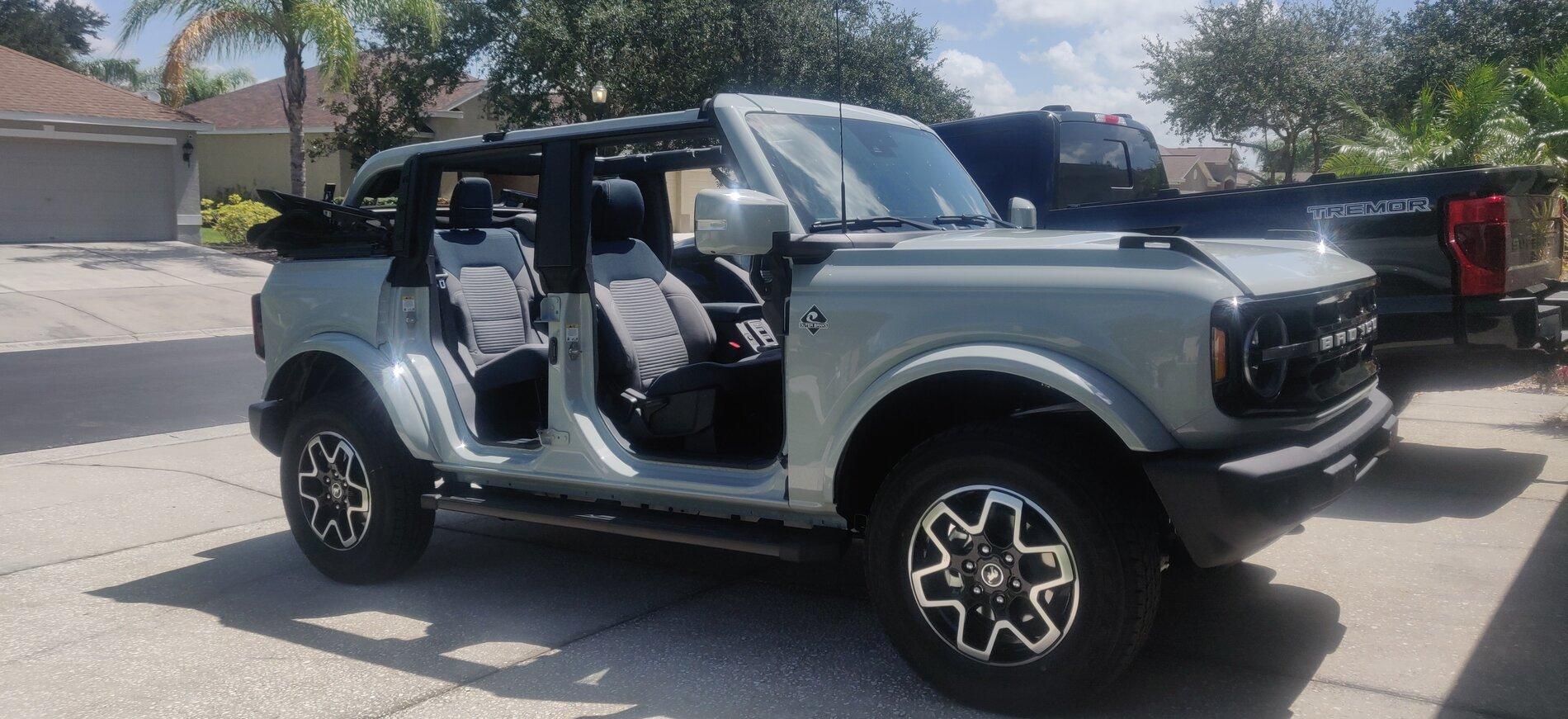

A few quick first impressions.
The ride is super smooth.
The stock Outerbanks wheels and tires look much better in person.
The blue on the seats is not as vibrant as it comes across in pictures, it also looks better in person.

I've been impatiently waiting to see what the leveled/bigger tires will look like with the smaller painted OBX flares. Make sure to take pics from every angle possible!

What 35" size and brand tires did you go with? For the RTR Tech 6 wheels did you go with 17x9 with +30 offset? Satin Black or Satin Charcoal? Are you doing any lift to fit the 35s? Or just level? What about the TPMS? Different Lug nuts?
I have an OBX on the way in AMB color and I'm very much looking forward to seeing your results. Thinking of going with the RTRs (17x9 +30) in Satin Charcoal and using BFG KO2 285/70/17 tires. Will be curious to see if you are able to go bigger without a lift!
We are in the process of installing the 4 Wheel Parts leveling kit. The kit is great but a single bolt has created a nightmare. There are two options to complete the install, remove the lower control arm or remove the lower strut bolts from the strut. I choose to remove the lower strut bolts, the first came out in 5 seconds with an air hammer, the second is seized and I cannot remove it (going to try using a press later today). Unfortunately, the Bronco is not yet in the Ford parts department catalogs yet and the bolt is part of the strut so I might need to get creative as replacement struts are not yet available.
If I can make this work, I will be installing 315/70r17 on 17x9 +30 RTR Tech 6 wheels. I did pick up narrow spline lug nuts, I believe the stock lug nuts will work but there would be very little clearance.
The 4wp leveling kit comes with new crash bars labeled "Big Tire Kit", I am not sure if they would be required to fit 315/70r17s but I do plan on testing with the stock crash bars.

I am going to have the tire shop swap the TPMS sensors to the new wheels, because of this we are waiting to have the tires mounted to the wheels until they are ready to throw on the Bronco.
We went with black lug nuts rather than chrome.
