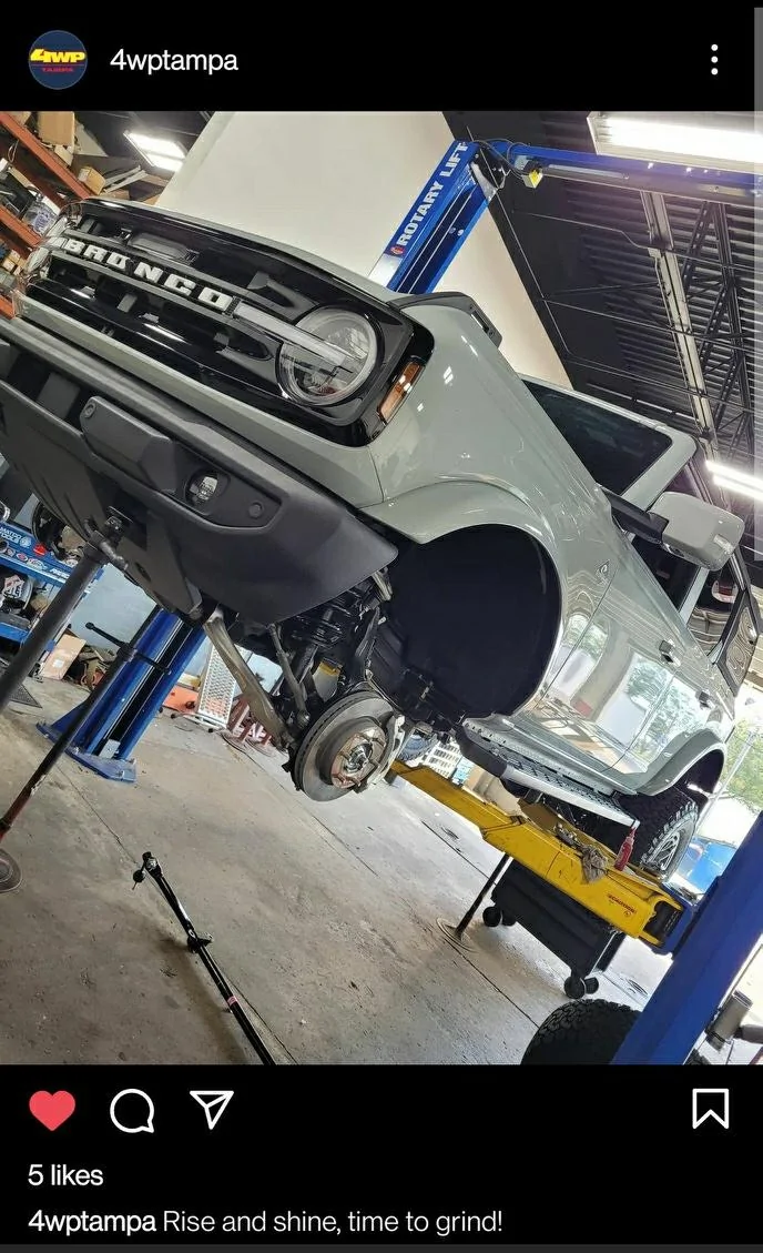

Our Bronco will be available to pick up from 4wp tomorrow. Should have been finished today but they also ran into troublesome bolts and had to order replacements to put the Bronco back together, their issue was the lower control arm bolts.
I posted the following within other threads but figured it would be good to share here also. I attempted the 4wp level install last Sunday and I rather than attempt to remove the lower control arms I went for the lower strut bolts. The first one came out like butter, I fought the second one for 4-5 hours with no luck. I ended up damaging 2 or 3 threads so I put it back to stock. I then proceeded to Ford to see about getting replacement lower strut bolts to which I found they are not available yet as they are part of the strut. That is when I threw in the towel because I do not want to take the blame if the Bronco is put of commission, I have been married long enough to know better. So now it is at 4wp where they are running into similar issues. This is a first for me, I have always been a do it yourself kind of guy.

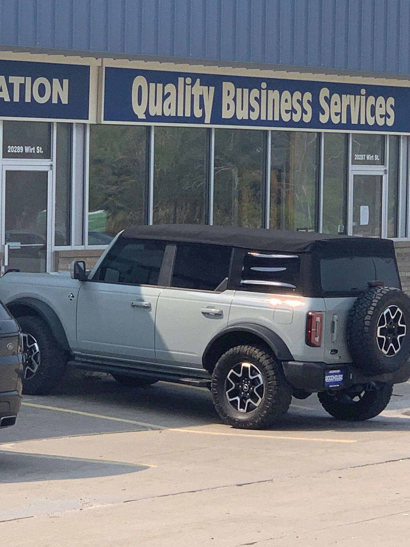

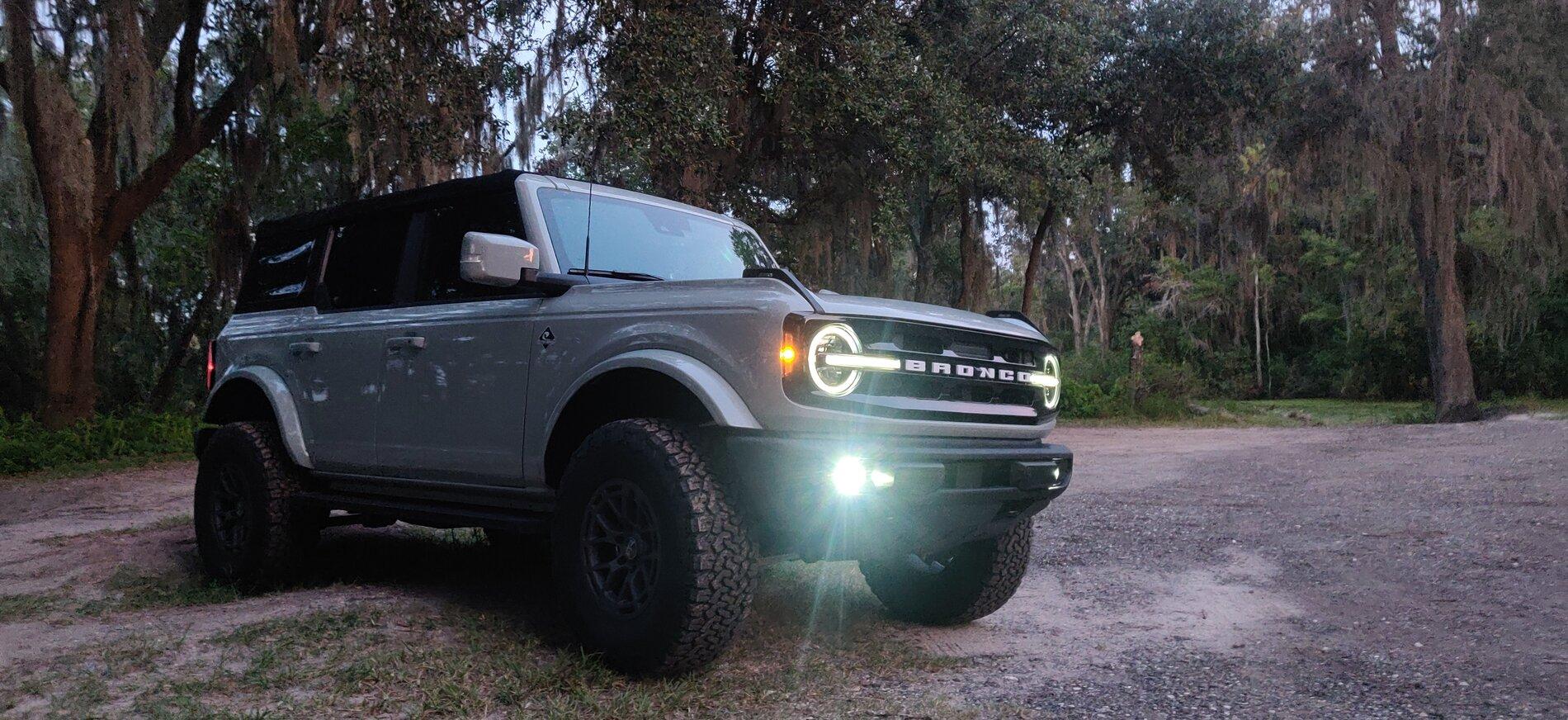

I posted this in a separate thread in the Wheel and Tire subforum however I wanted to track it here in our build thread also.
4WP was successful in installing their leveling kit on our Bronco! From there they also mounted and balanced our 17x9 +30 RTR Tech 6 wheels with 315/70r17 BFG KO2s. No rubbing even at full articulation. We are loving the stance, there is 1.25 inches of tire "poke" beyond the Non-Sas OBX fenders, just the right amount in my opinion.
Also the 3rd brake light clears the spare, barely but it clears and looks great!

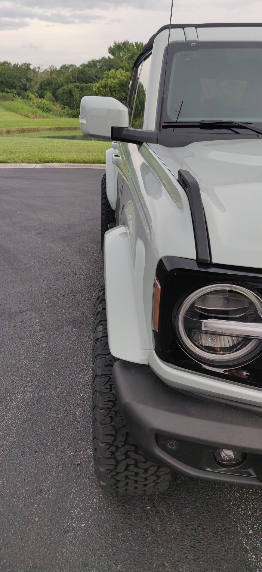

That’s gonna look sweet with upgraded wheels and tires. I think cactus looks best on outer banks. Wish badlands had color matched mirrors and handles. Curious how the fenders would look with Sasquatch.
Sasquatch flares, but not a Sasquatch build… not the best pic, but you get the point
