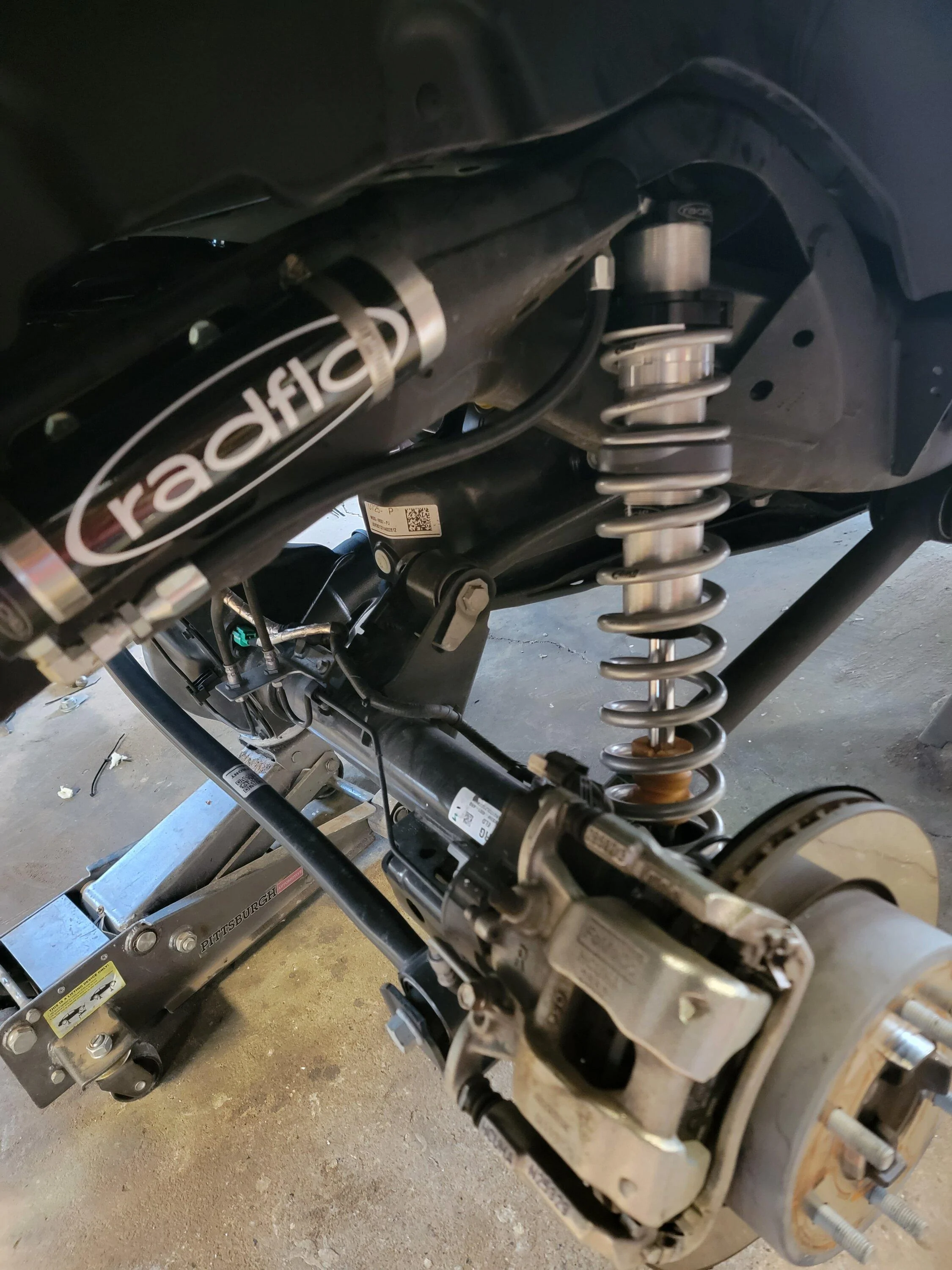

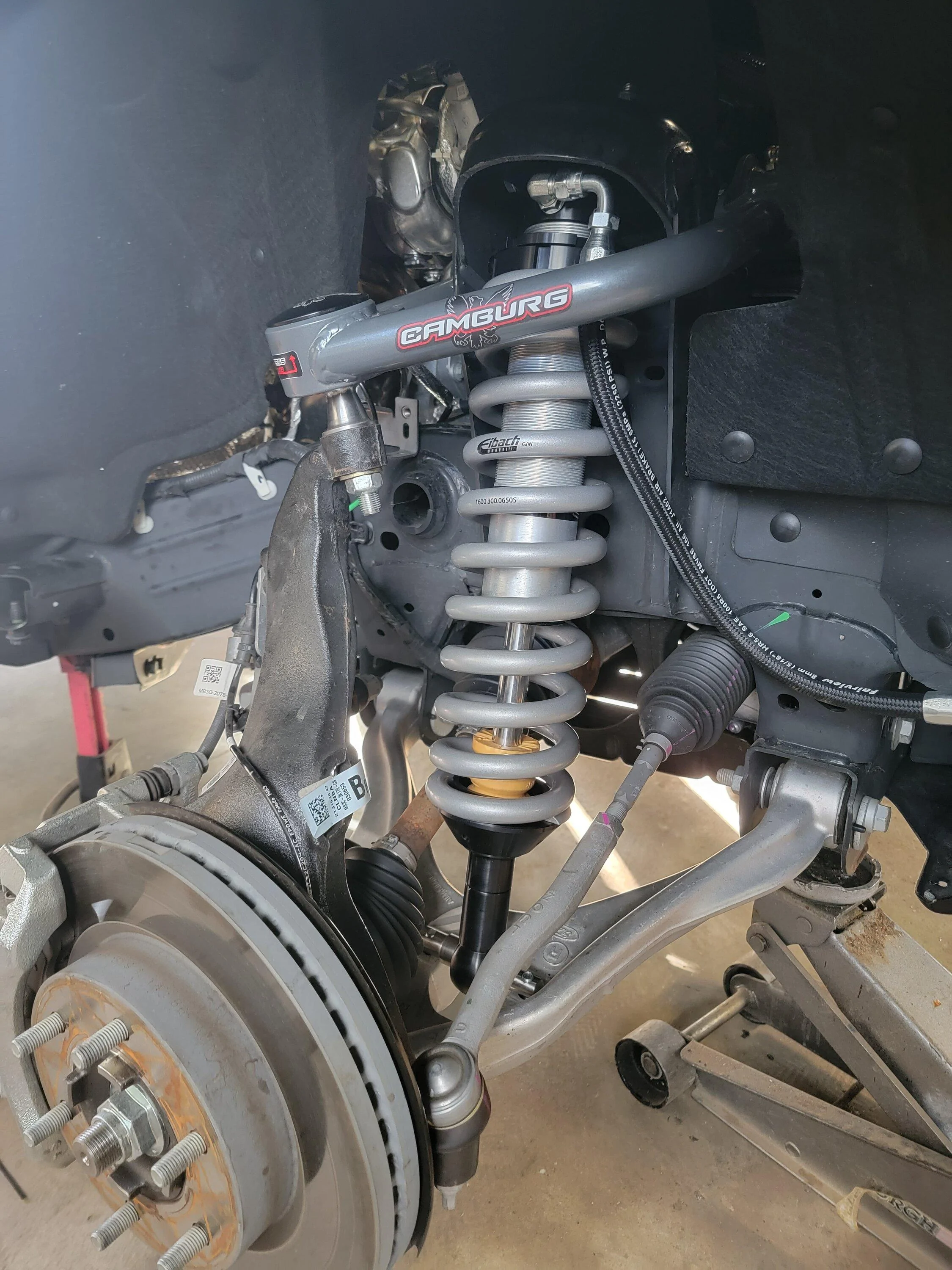

I went with radflos. Very happy with performance so far. I can adjust them to firmer valving if needed. Will be heading to Rubicon next weekend and see how they do in the rocks.
