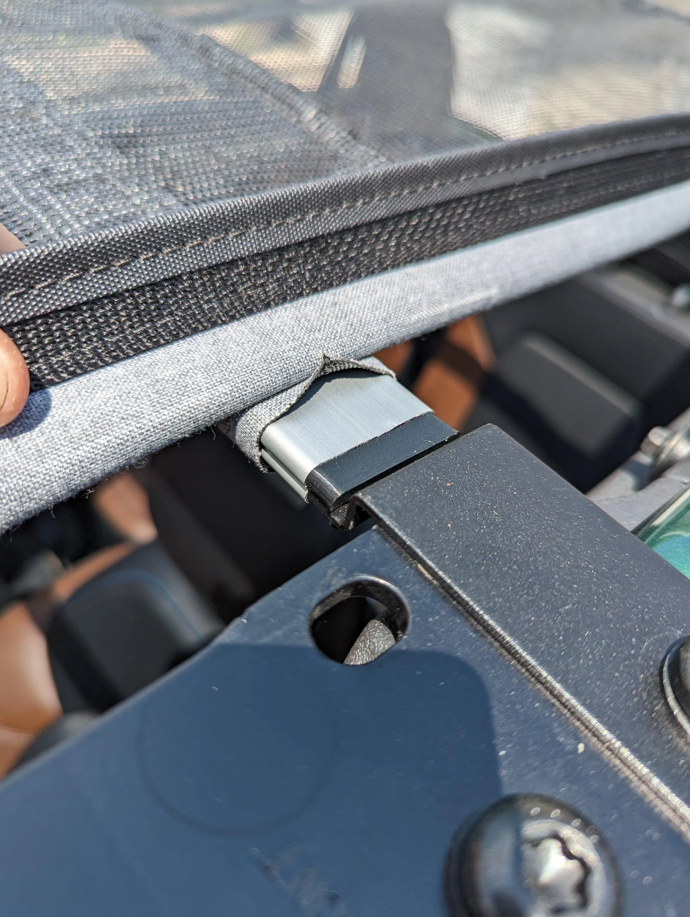

Looking for some feedback, curious if mine's a fluke.
I noticed the aluminum extrusion that goes over your head feels like it should've been maybe half an inch longer. On mine, it just *barely* rests on the mounting bracket on either side. If the mount rotates slightly, the extrusion could pop off.
The little plastic endbushings as well, their inner hole is much bigger than the mounting bracket tab they slide into. This lets the extrustion bounce and make a ton of noise at anything above 45mph. I managed to lose one of the two bushings so now I'm working on designing / printing ones that are longer and fit snugger.

Can you be specific on which mesh top you're referring to?

With the other question, we may need more info. But from what I can gather your aluminum center support seems to be looser than it should be, should be tight. The metal support brackets on either side have slotted holes, so there is some adjustment there, make sure the brackets are mounted all the way inward.
Hmm. It's not on the Build-and-Price anymore, nor does it show up on the Ford Accessories site. It just shows up on my 2022 window sticker as "Top - Mesh Shade Bimini"
edit: this one Bronco 2Dr 2021-2023 Soft Mesh Bimini Top ~ VM2DZ54500W00A (ford.com)

I have the exact same issue with the Bestop Bimini top - I just installed it last weeked. That extrusion kept falling off. I loosened all of the bolts that are holding the bracket where it attaches, and pushed the bracket inward and retightened them (did both sides). This took up some of the tolerance, and it hasn't fallen out again. It has only been 2 days, so we will see. But I am with you, that extrusion should be 1/4 - 1/2" longer.
Also have had issues with the plastic pieces falling out.

I think I have a design settled on replacing the bushings with longer/tighter versions. Do you have any issues with it rattling at higher speeds? At 50mph I could cut my overall noise in half by simply holding onto the aluminum extrusion.

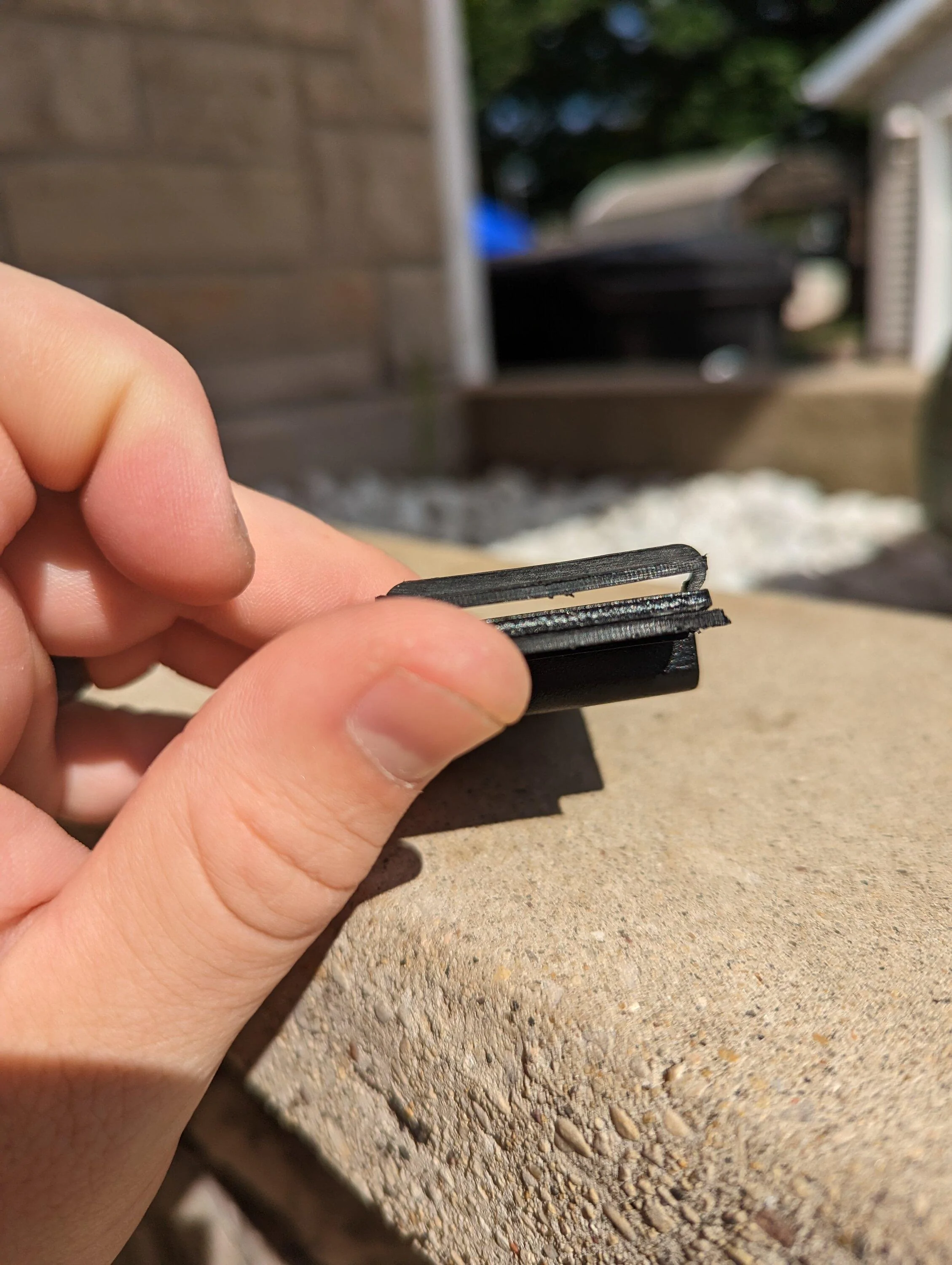

OP, what is that plastic piece you included in the photo?
The little bushing in the ends of the aluminum bar, including the amount of wiggle room left in it.
I printed replacement ones with a tighter fit, no wiggle anymore. Taking it on the interstate today and I expect a much quieter ride.
With the bar properly held up there I’m not noting rattling. It has not fallen back out yet, but I’m still not confident in it.
