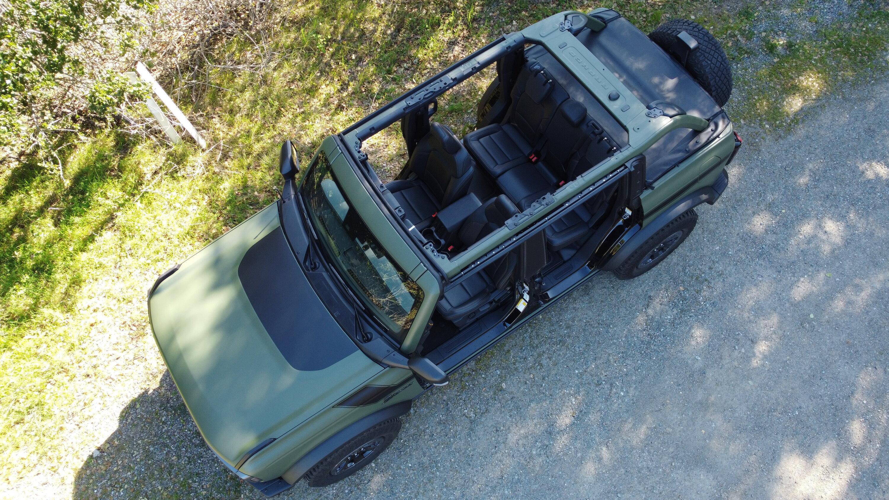

I am just some guy with a 4 door hard top passing through trying to be helpful.. @smoot618 :D
Not sure if this is of any help but I had a photo from above taken with my drone before I ever added any hardware for my Gearshade top.
It only takes 2 longer torx bolts and 8 shorter torx bolts to mount/remove the hard top (along with locking/unlocking the hard top latches from inside the truck)
