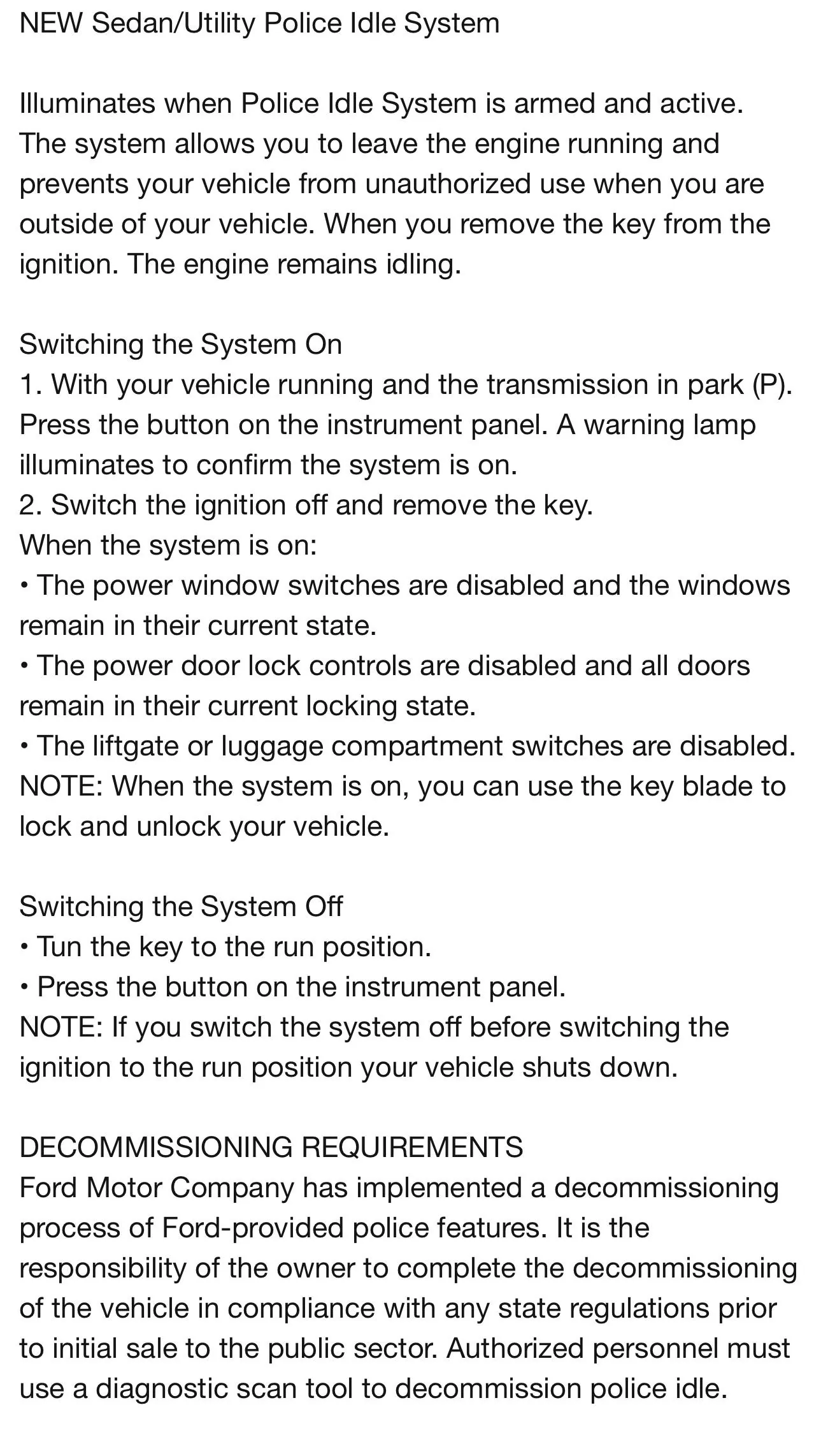

just curious if "police idle" permanently shuts off the 30 minute max idle? often times when out on offroad recoveries, we're doing heavy winching. This puts a strain on your battery. I know you can just go in and toggle it off for that "session" per say, but it auto enables next restart.
if I want to leave the bronco idle all day, I want to leave it idle all day.
I think there is some confusion between "secure idle" which is already on, and "police idle." There isn't really any good info on that.
Does anyone know if this police idle mode allows the vehicle to idle longer than 30 minutes regardless if the idle timeout is on or not? Certainly a first responder somewhere is running a newer ford with this max idle timeout disabled.
thanks!

Is police idle a selection on the Bronco, or a Forescan change?

Police idle is not for push button start vehicles.
Ford Bronco permanently disable 30 minute idle timeout B90C30CC-DD21-43DB-A3D6-D4E02060B1DF

good to know that "police idle" mode does nothing on a push button vehicle.
and yes, the bronco will shut down after 30 minutes of idling in park. which happened to me over the weekend while offroading. we got stuck behind a truck that was completely blocking the road, and in our attempts to recover it, we burned 90 minutes of time. by then after leaving the hazards on for an hour, (granted with LEDs the battery wasn't dead) but the cab was totally cold, and the engine had cooled off.
like I said, if i want to leave it run, i want to leave it run. without having to toggle a button every time.
if any first responders are running a newer ford and know how to defeat this forever i'd really like to know. maybe it's as simple as wedging something onto the brake pedal to keep it depressed...
it's in forscan in the BCM. but apparently does nothing on push button rigs.
