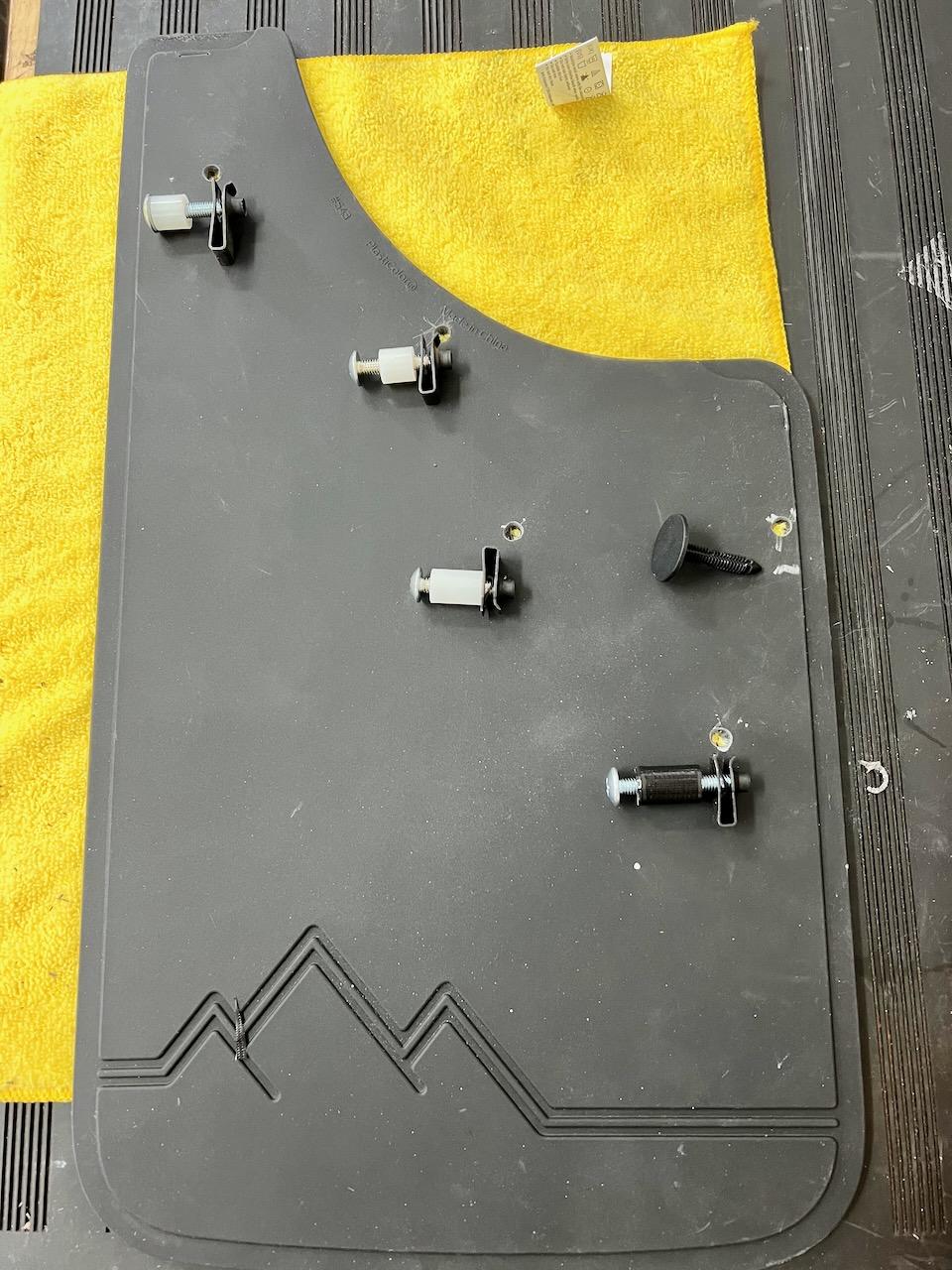

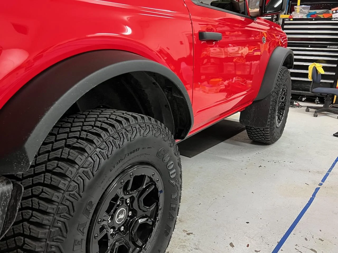

Mud Flaps:

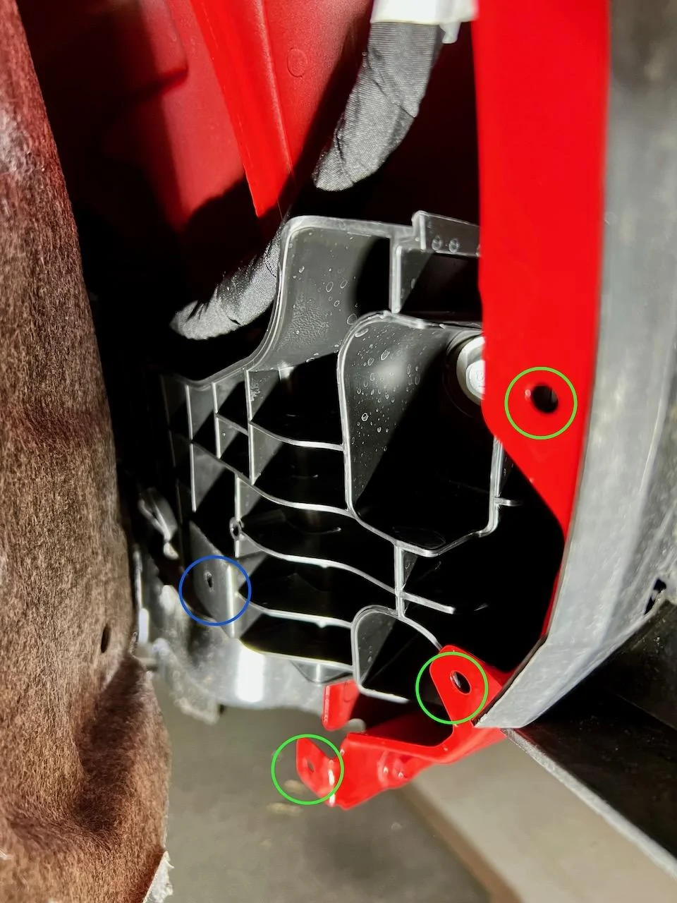

Didn't really like the looks (let alone the $300 price) of the big gatorback mud flaps, and the $50 Ford ones are not compatible with the Sasquatch flares, so I picked up some nice fiberglass reinforced generic flaps and some hardware. Mounted into all stock holes with no body drilling using M6 speed nuts and truss-head bolts replacing the plastic fasteners, with one additional hole on the inside concave portion of the flare itself. 100% reversible to stock.
The hardest part of the job is just templating exactly where to drill holes in the mud flaps...
Ford Bronco PFBZ: Race Red Wildtrak 2-door Bronco mud flaps - 3
Ford Bronco PFBZ: Race Red Wildtrak 2-door Bronco mud flaps - 10
Ford Bronco PFBZ: Race Red Wildtrak 2-door Bronco mud flaps - 12
Ford Bronco PFBZ: Race Red Wildtrak 2-door Bronco mud flaps - 13

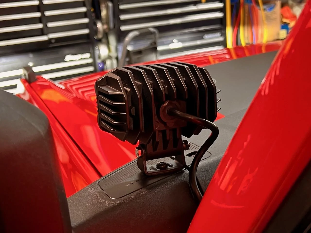

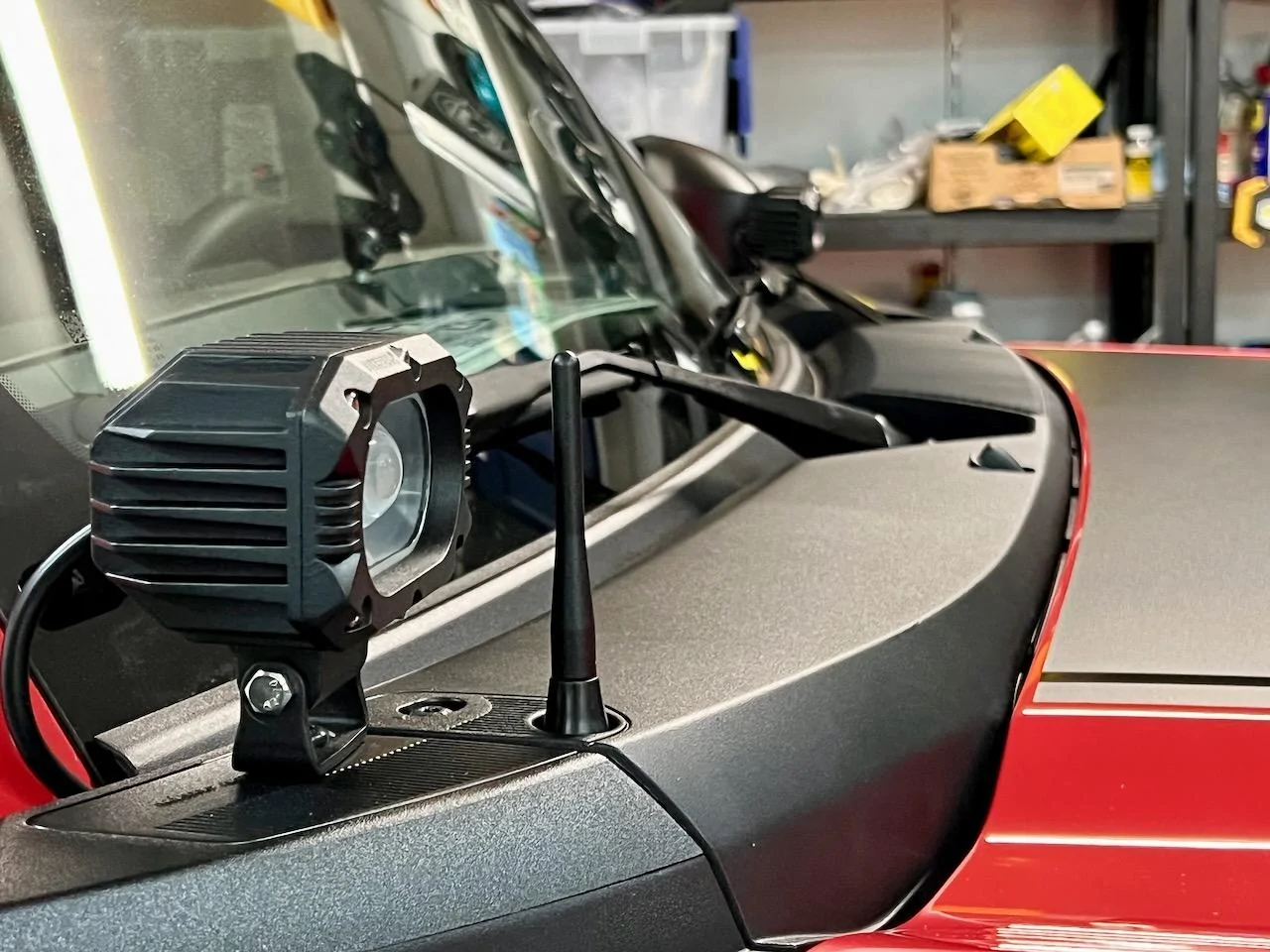

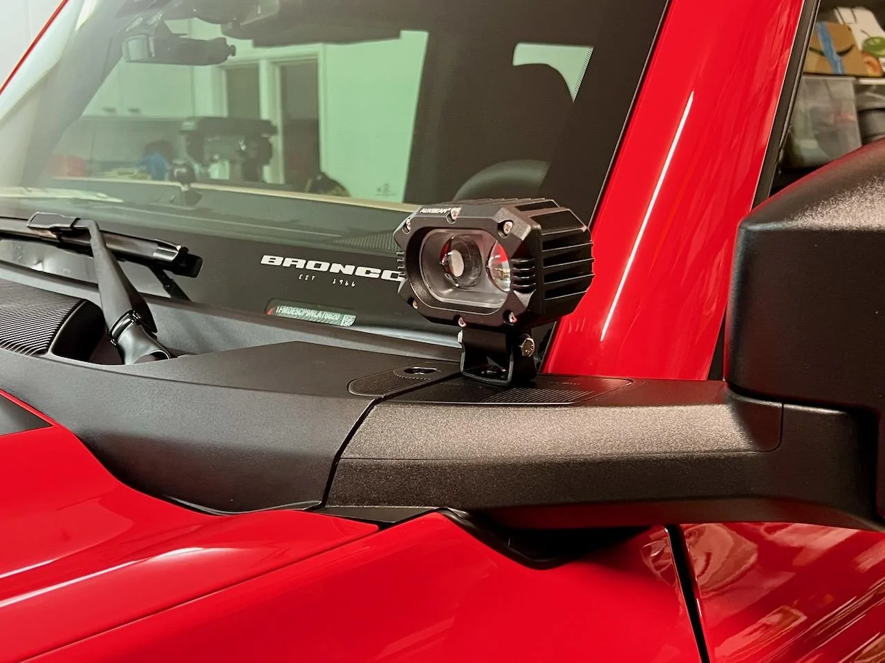

Pod Lights, Stubby Antenna:
I wanted some compact, spot-beam pod lights for my hood mounts, went with the Auxbeam double spots. GREAT light output, focused spot beam, decent mount, great size, looks like decent quality, we shall see if they stay moisture free. Custom harness to the aux switch relays.
You can also spot my Cravenspeed Stubby antenna... Does not interfere with the LED light pods.

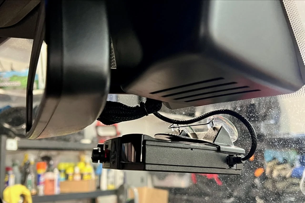

V1 Power Tap:
Pretty minor mod, tapped into the mirror connector for 12V for my V1 radar...

Mud Flaps:
This looks workable - can you describe any of the following a bit more:
-Where did you attach the 5th connection on the flare? Did you have to drill/modify the flare?
-What are the spacers you used, and do you have the measurements of those- i.e. are they premade or did you have to make them?
-Can you provide a link to the hardware you purchased?
Thanks for posting this solution- rocks and muck are a major issue for the Sasquatch package. It's frustrating Ford did not provide a factory solution.

OP - why not just go with the Ford OEM splash guards for Broncos without tube steps or rock rails, instead of these?
They are not compatible with the Sasquatch package...
