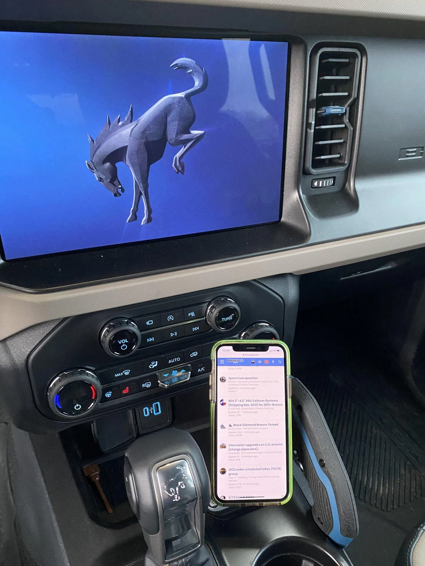

With Apple CarPlay and Android Auto why do people still want their phones mounted? Mine goes in a cubby and I don’t touch it because I don’t need to, all the functionality is on screen.
Ok did everyone just say the same thing here and not read? Yes CarPlay is great but it is far from doing all functions of the phone on a screen. Example someone emails you address or info and you want to copy that to gps or waze. Pod cast selection is so much better on the phone to select. Just a few things that make it nice to have the phone up. Also like I said before if the phone is in a “cubby” I will jump out and forget the phone in the car every time, that’s just me I guess from reading all of you guys posts. Or maybe I’m just in and out of my cars more.

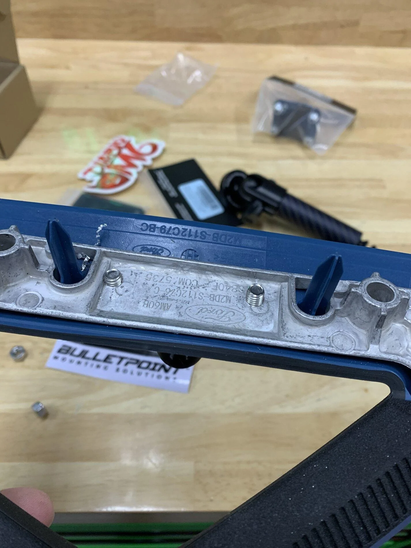

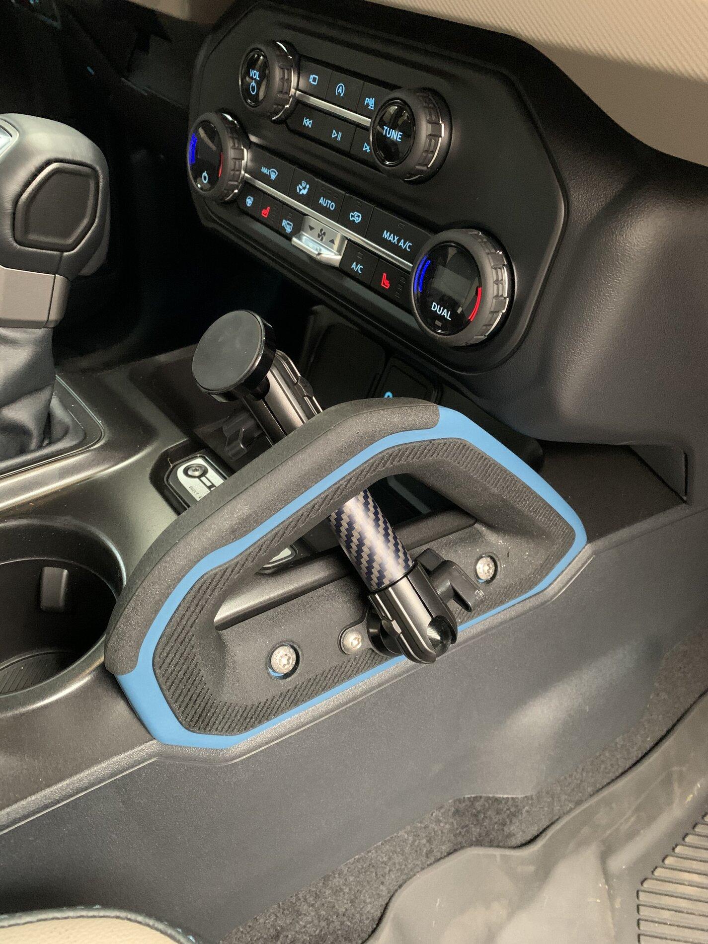

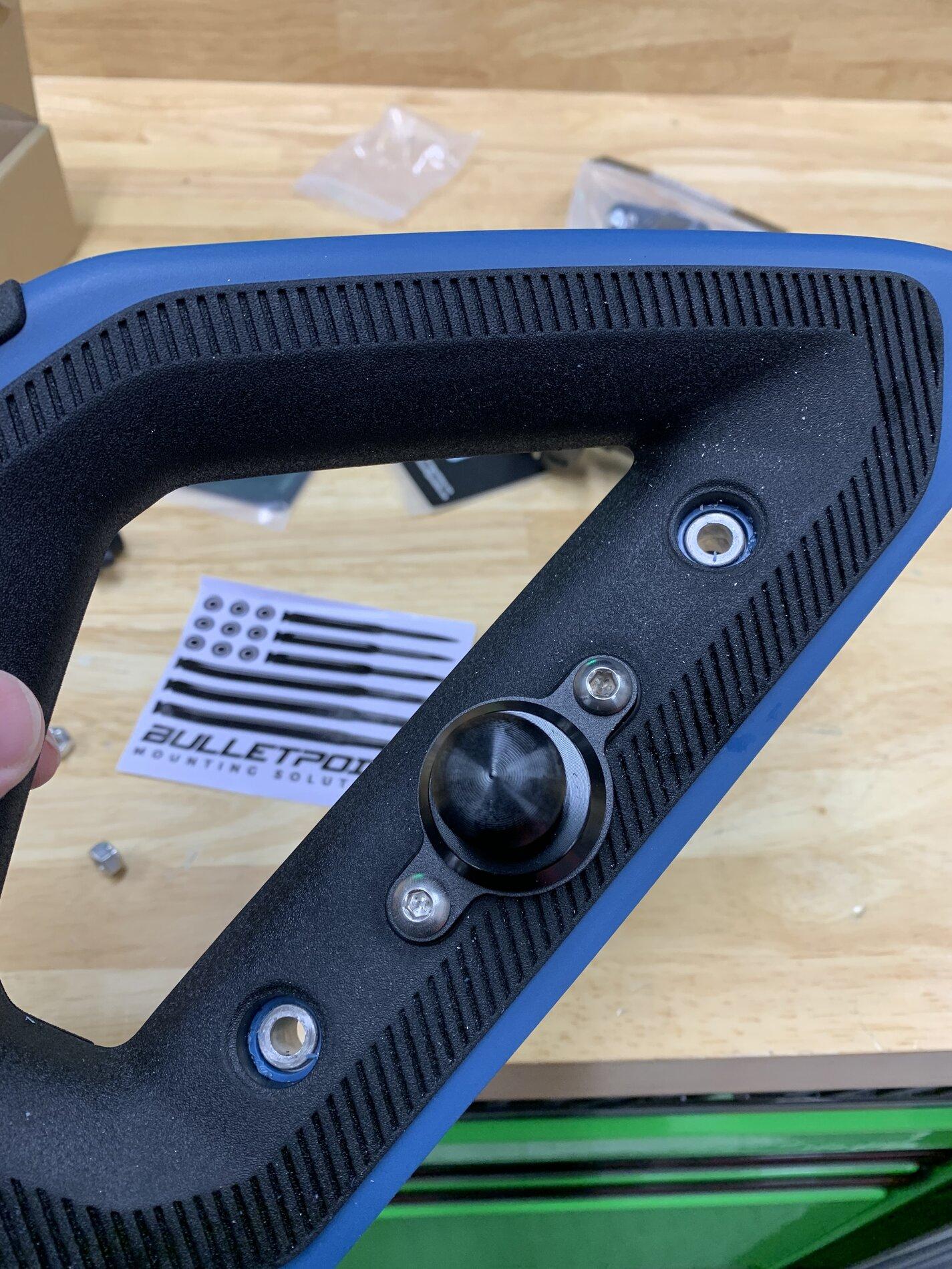

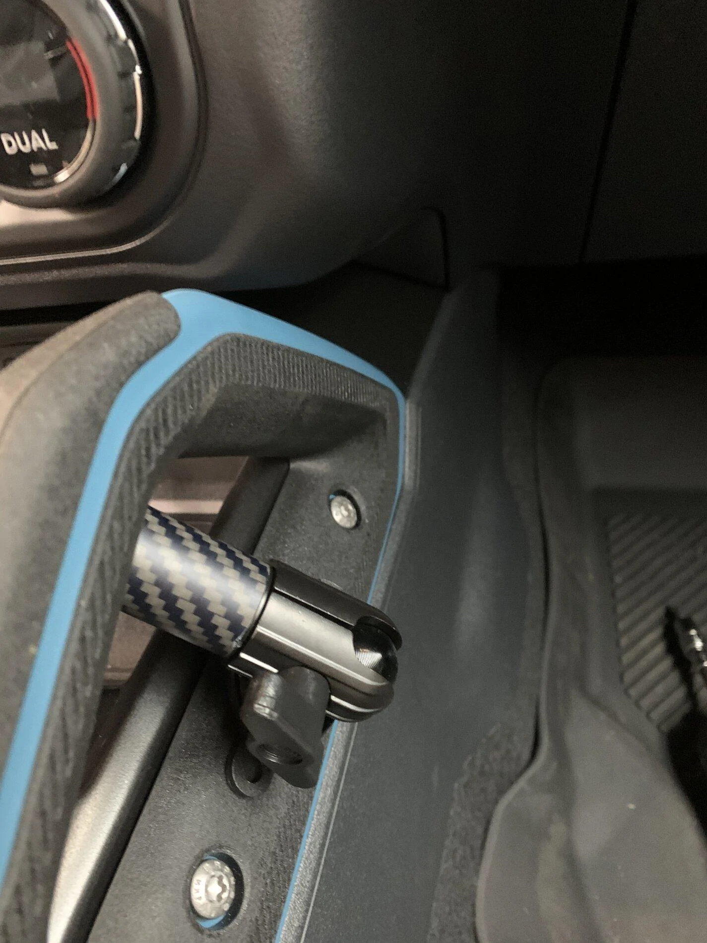

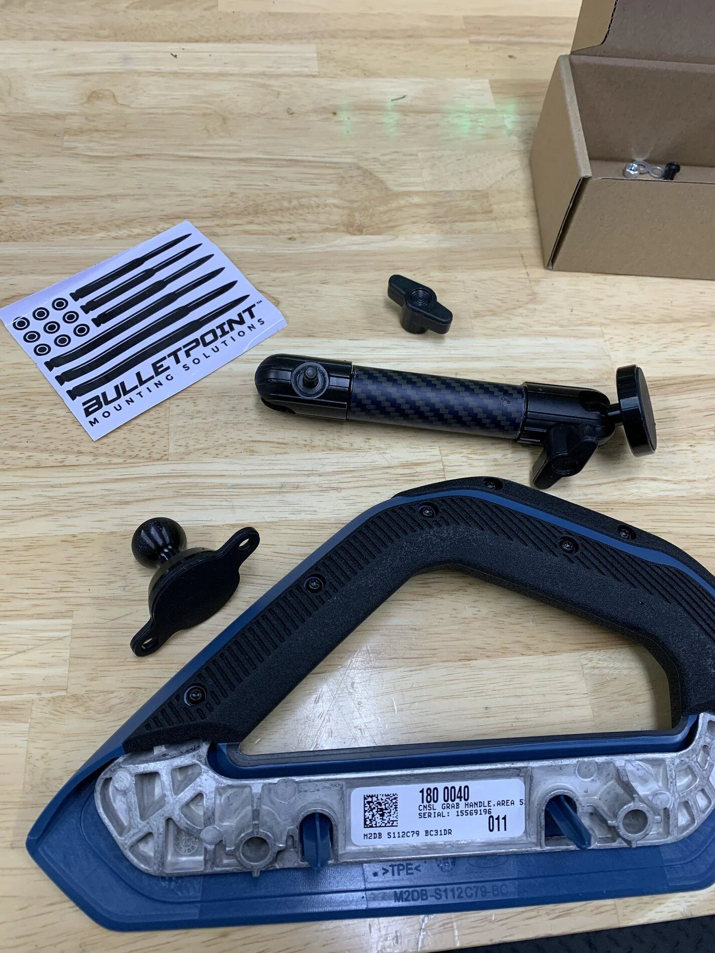

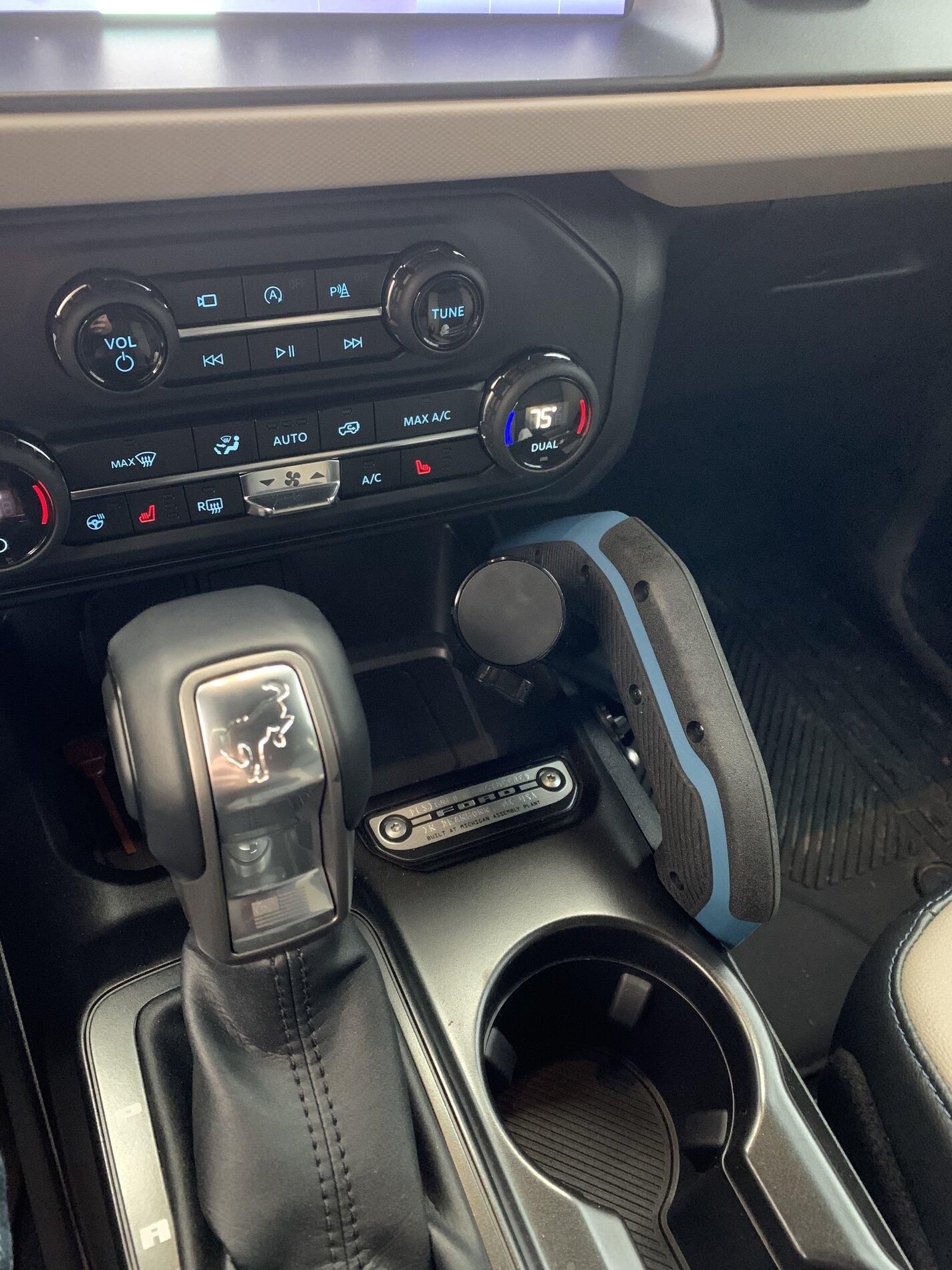

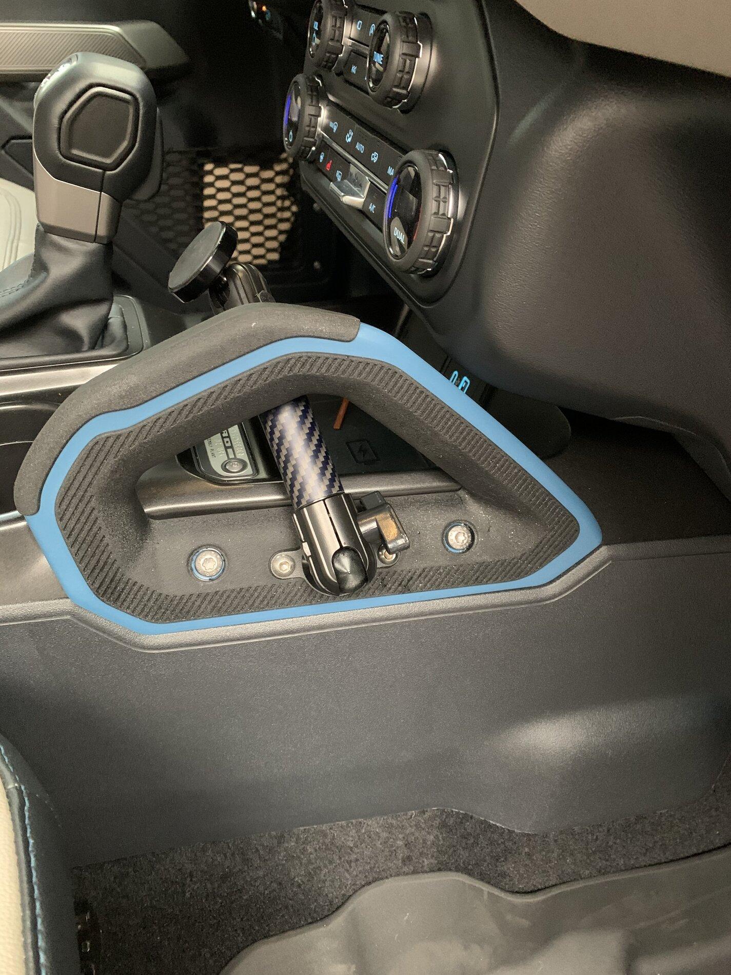

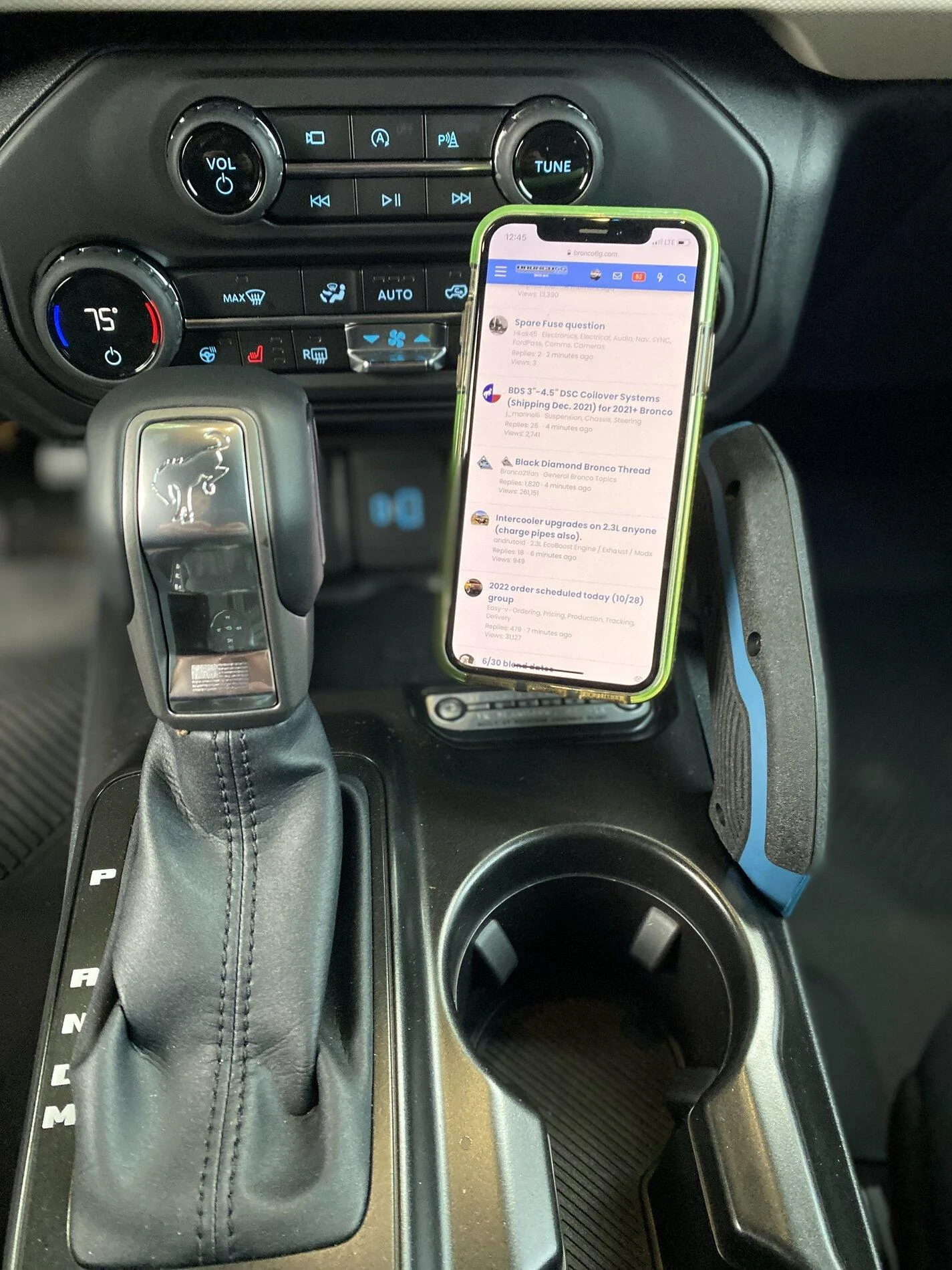

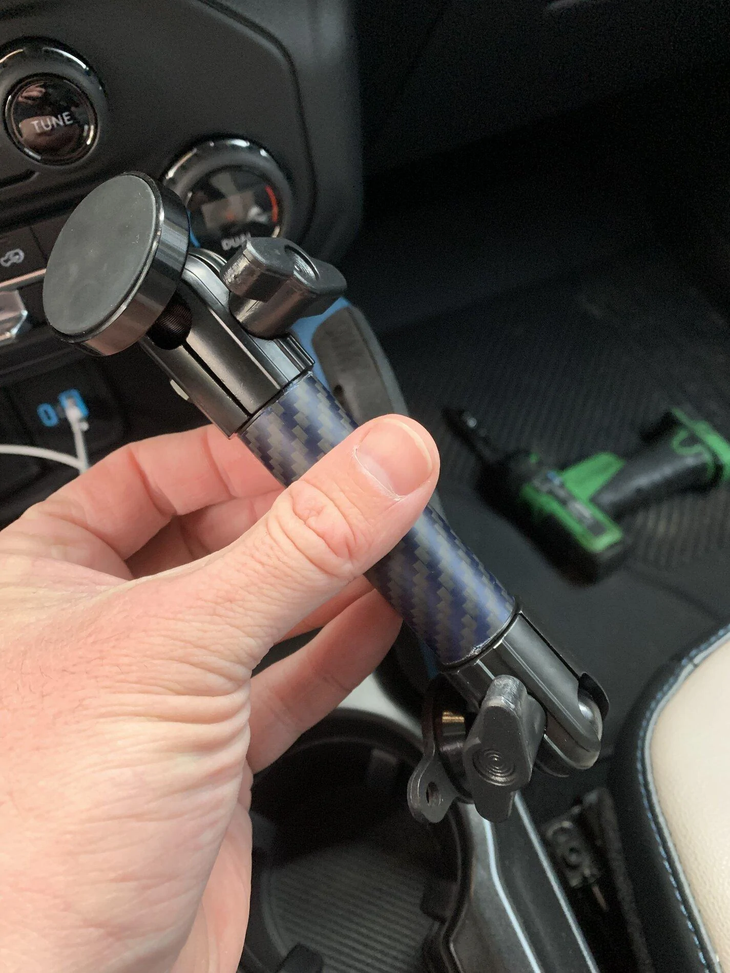

So I was looking for ways to get a magnet mount right in the area by the cup holder. Out of my line of sight but not where I can’t see it at all. Here is what I came up with. Drilled 2 holes in the grab handle and tapped the alum to m6 and used stainless button head Allen screws. The blueish carbon bar looks perfect. And a wing nut and it can be moved around.

They are like 8mm. I’ll can pull one and check. I thought about just getting a threaded ball for there. I also figure someone will make a handle replacement of of billet or a rail for that area. Most people that handle isn’t used much.
That would work well. Then just get 2 of these: https://twistedthrottle.com/shop/el...l-base-with-m8-1-25-pitch-male-threaded-post/
Could use one to mount my gmrs radio and another for my ham radio.
Edit: The M8 bolts do not fit in the grab handle slot, too big.
Quick update the M8 ram balls do not fit. The threading seems correct but it is too thick. Perhaps the M6 will fit.
