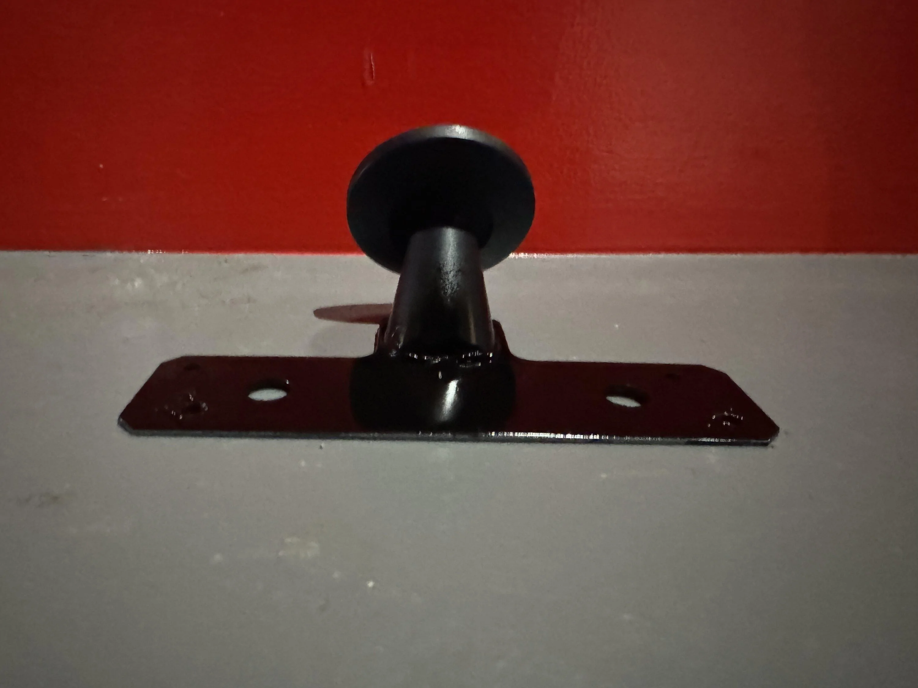

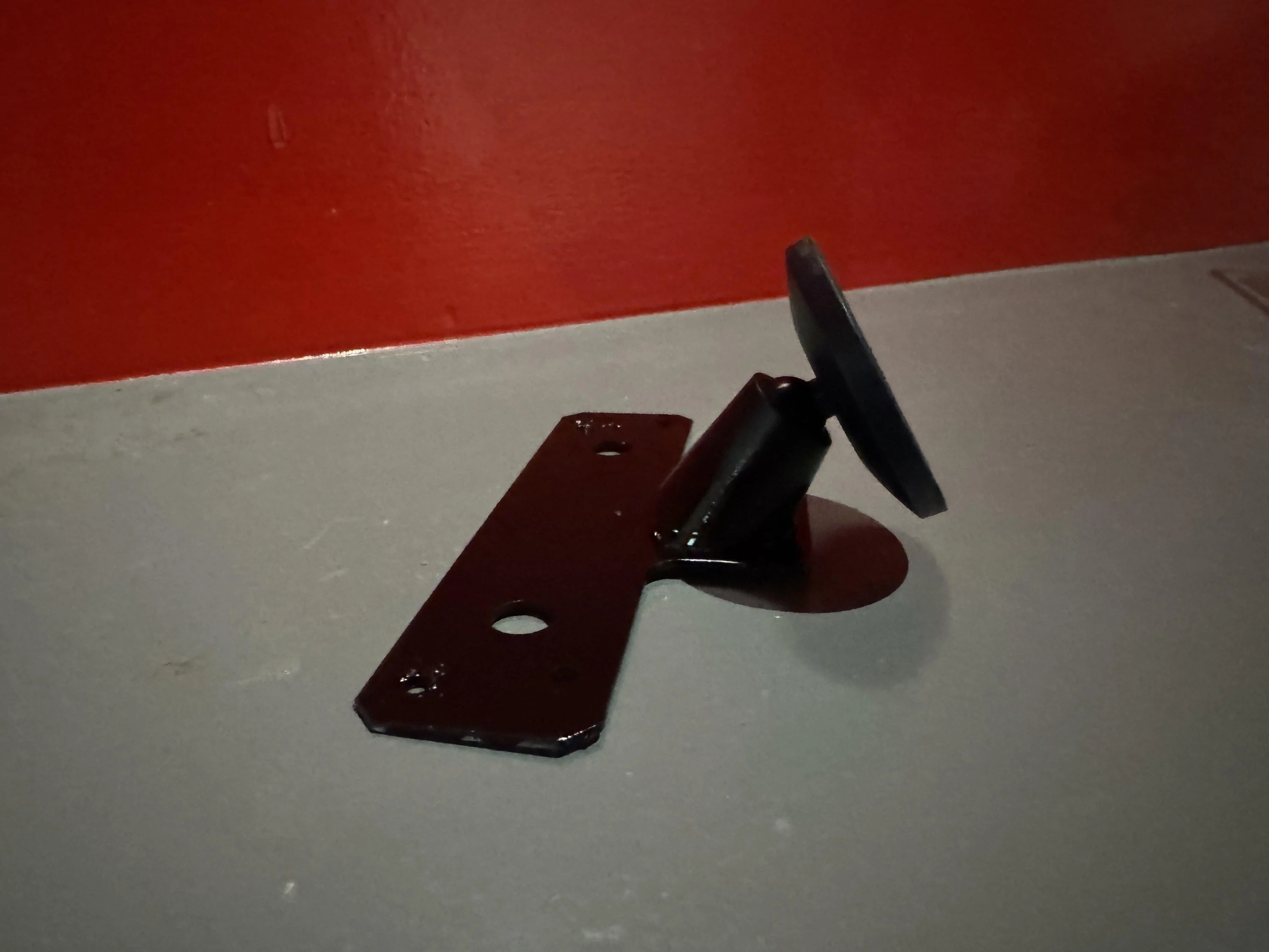

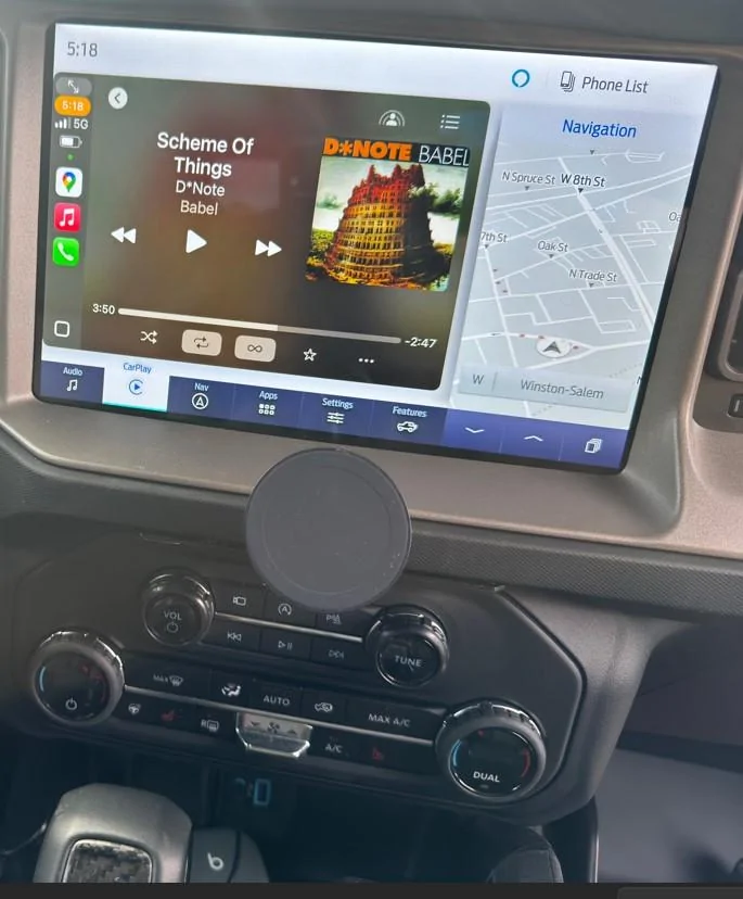

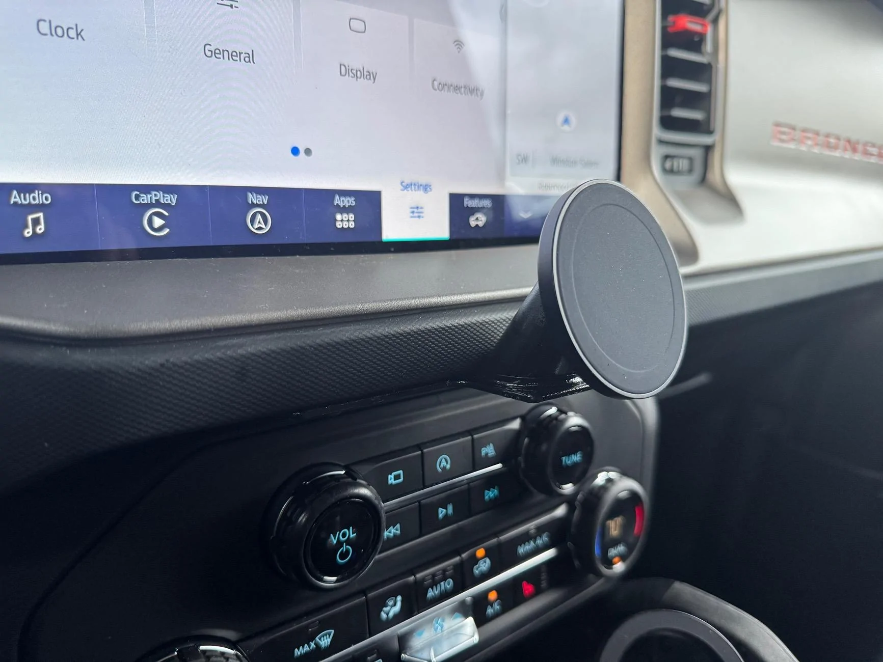

I don't like having my phone too high or too low and hadn't seen anything that would work out there. So I made my own using an existing magsafe phone mount and modifying it so I could mount it a bit lower than the screen. I can still see mostly all of the buttons in portrait and if I need to see more I just spin it to landscape. I used a T shaped mending plate from Home Depot. A magsafe mount from Amazon and a can of gloss black. Keeps my phone at arm length and height. Anyway took about 30 minutes and of course paint dry time.
Always looking for better ideas but just didn't see anything out there. I admit I am not the best when it comes to modding so it will be cool to see what others came up with...

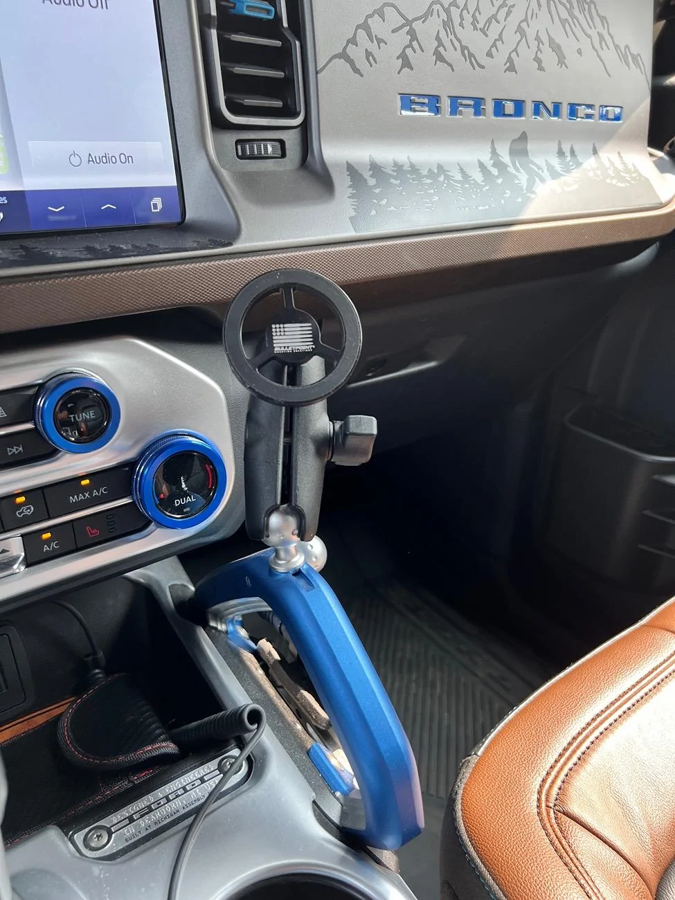

Here was my solution, dual phone mount, all completely out of the way of the screen. Obviously more expensive than your solution as I sourced everything off Amazon.

Really nice set up!
I like it. How did you fasten it to the dashboard?

1/2 inch screws underneath. Nothing shows unless you get on the floor board and look up ha

Sweet! What I’ve been looking for. Looks like it needs a few more holes for screws to give it a stair mounting but yeah that’s a great product! I did save $30 over their version by building this myself.
I do like their charging version but at $90 I might just stay with what I built.
Thanks for the heads up tho. I can tell you I probably would’ve bought one had I known they existed before I built the one I have.
