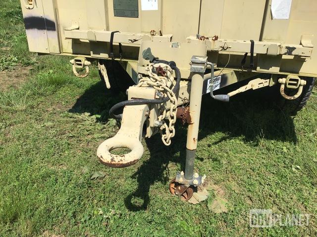

Just purchased a 2006 Raytheon M1102 Cargo Trailer to convert into an overland trailer. It has a pintle eye / hitch.
My Wildtrak has the tow package with a 2" receiver.
Not sure I can replace the eye on the trailer for a swivel eye (preferred). I have seen swivel pintle hitches to mount on a plate and without; then slide into receiver. Seems easier, just think the swivel should be on the trailer, Yes?
Any recommendations on the above and thoughts on using and extension with my hitch or extending the the trailer eye to push it back a foot or two.

That trailer needs brakes period
So you either have hydraulic juice brakes that are actuated by a moving tongue (that’s what it has)
or replace the lunette with a swivel lunette and axle with electric brakes

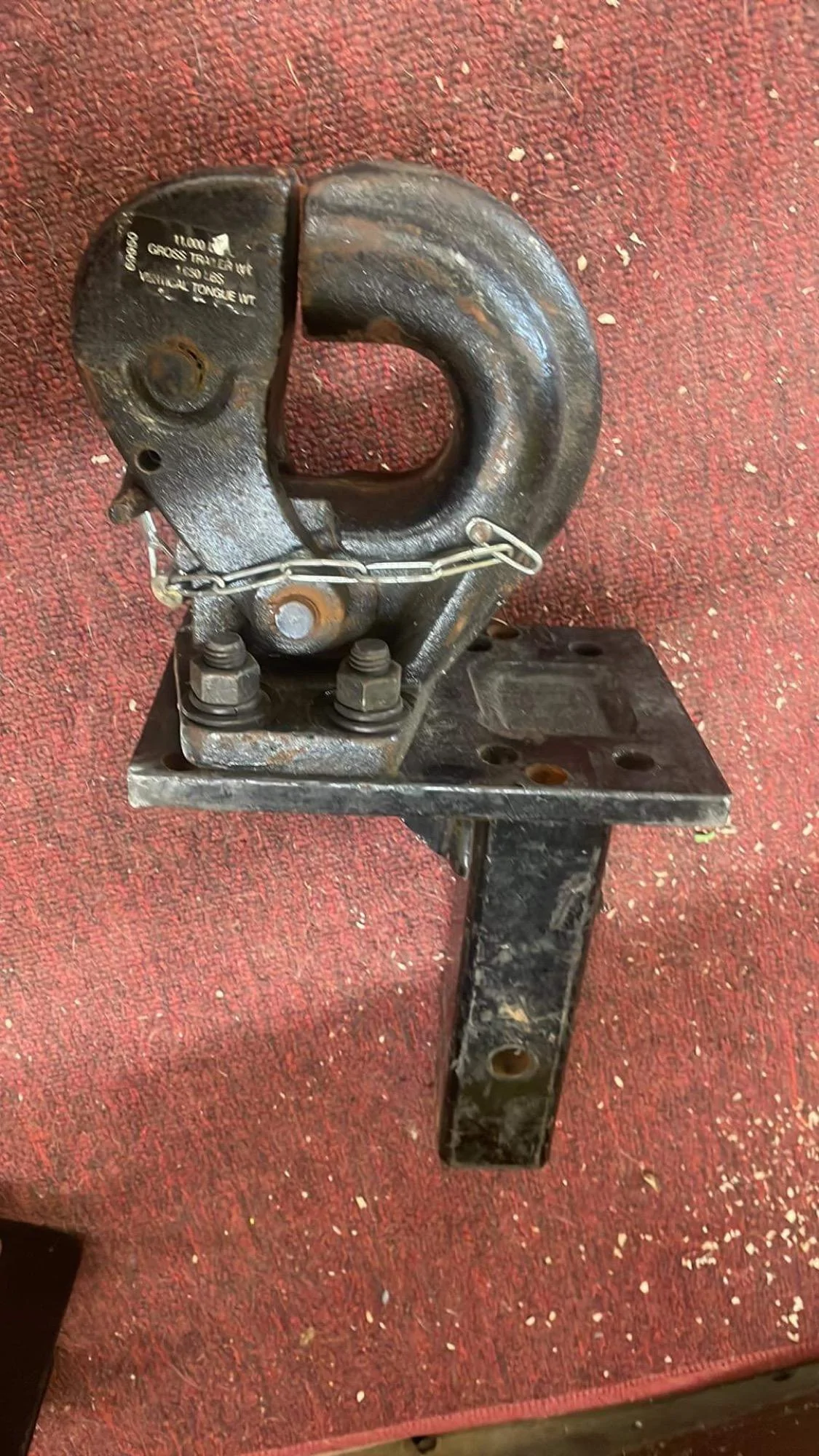

Keep in mind you can easily roll that trailer with a swivel
i have the current hitch the one with the receiver, but will make a receiver for my bronco if I ever get it for the auto close one
Ford Bronco Pintle Hitch Help for M1102 Trailer 60337C4D-33ED-4D1E-9DA7-5DC5DCDD6349
Ford Bronco Pintle Hitch Help for M1102 Trailer 91184310-9B1B-486D-9C92-C5AC26340A96
Yes, hydraulic brakes by Lunette (had no idea that's what it is called). If i go swivel... can i stay with hydraulic?
Good thought.... Are the swivels full time or can you install a pin to make it fixed?
Not sure if Tow, Lux package came with a brake controller.
You can keep them
You have to put the pin in when you back up or it’s hell!
my preference would be electric for simplicity and ease but the surge brakes can work and did
Correct, but given the right conditions if the trailer were to roll without the swivel in place it could cause the vehicle to roll over too.
Based on my military experience if you are going to run a swivel it belongs on the tow vehicle and not the trailer.
Agreed
I’ve heard of people rolling artillery units behind 5tons…..
sometimes things are cheap because they are not hood deals
Great! I was looking for that.... Everything seems to point to the hitch is the swivel point.
