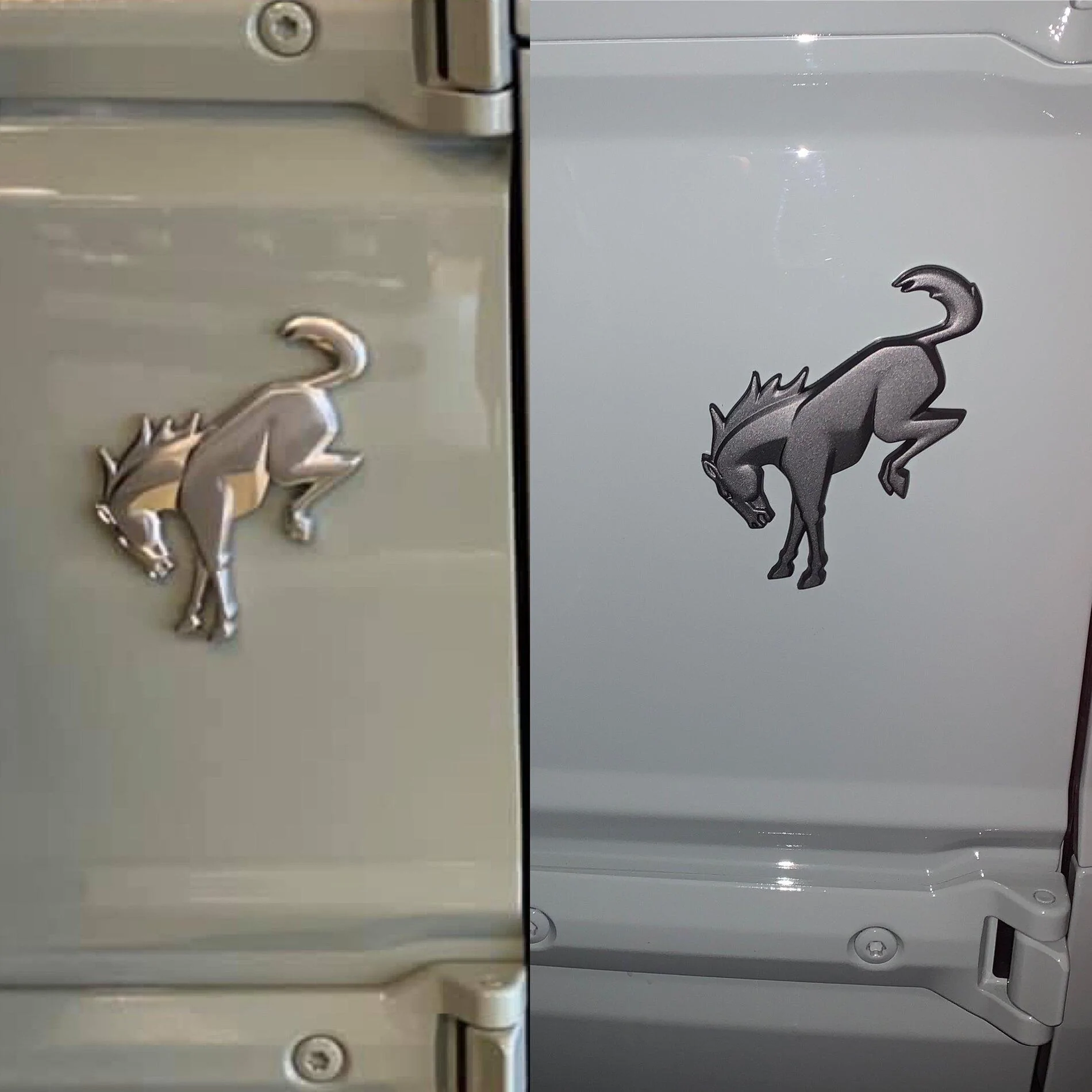

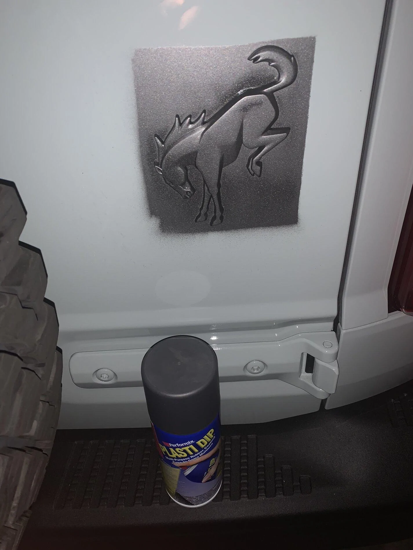

Instead of paying for a new black Bronco emblem on the rear I decided to see how the plastidip I had laying around would look. Anthracite gray matches the carbonized gray grille on the badlands almost perfectly. I’m tempted to try it on the Sasquatch beauty rings but I’m going to stick to paint on those for durability.
Before:
During:
After:
Before/After:
I did two coats, skipped the glossifier I had because I liked how it turned out without it. Anyway, if you want to change the color of your bronco emblem I suggest this over buying a new one. Quick, easy & cheap.

It just peels off. The overspray rubbed off with my finger. I should have taped it but just used some cardboard with a square cut out of it. My 5 year old was running around the garage so I didn’t want to go downstairs and grab painters tape.

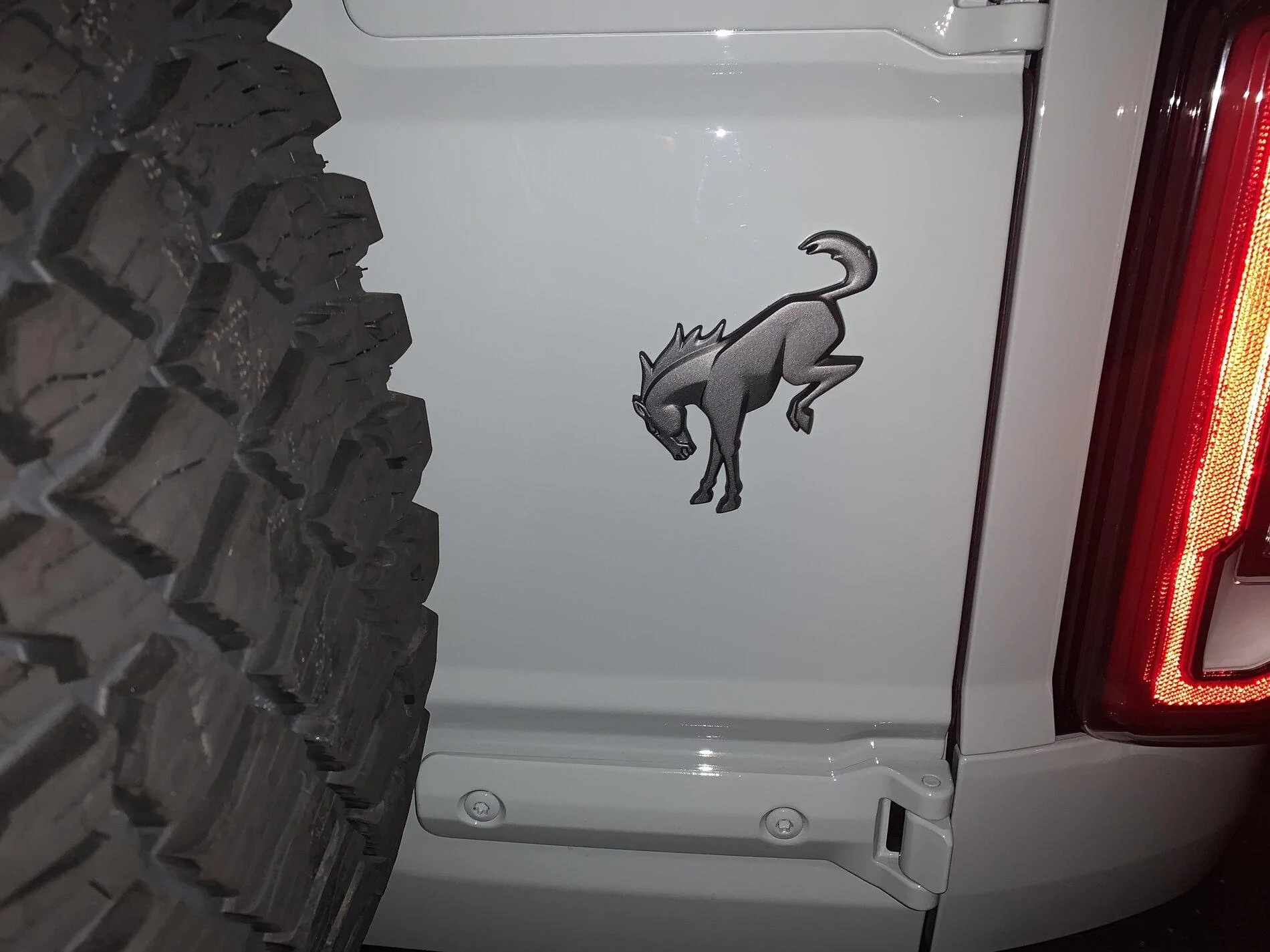

No definitely don’t sand. That’s the good part, you can peel it off and have it look stock with no issues. Still looks as good as the first day I put it on. The wheels I did years ago needed no touch ups after 2-3 years. I sold it after that so not sure past that but it’s pretty durable, especially if it’s just a badge.
