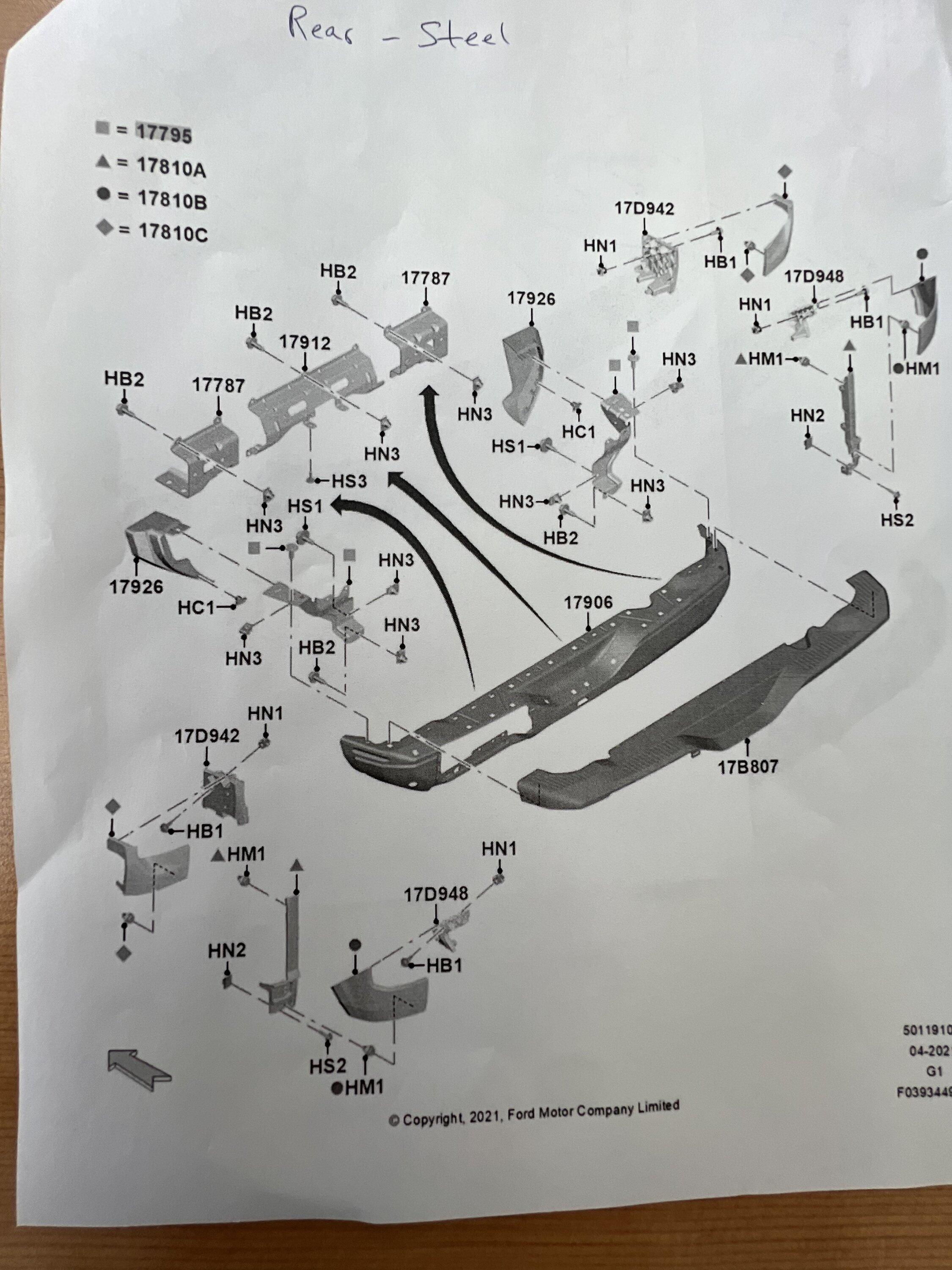

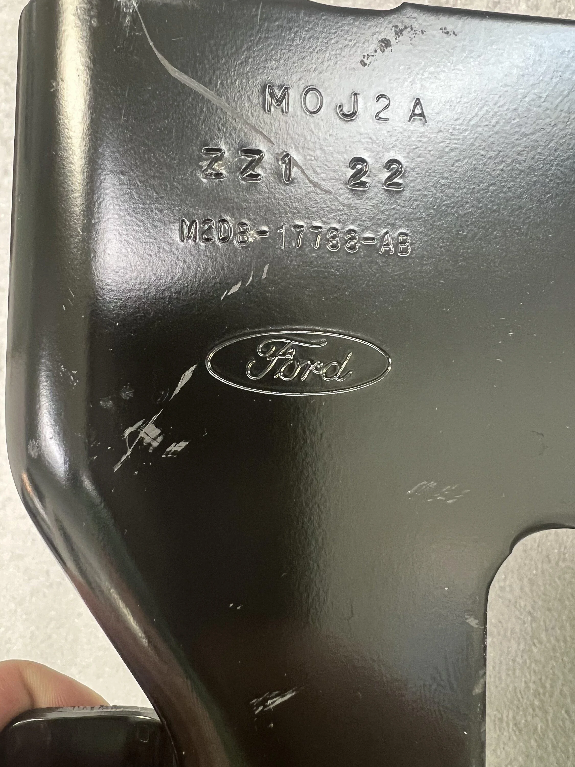

Someone was looking for part numbers of rear steel bumper mounting brackets. Here is parts catalog photo should b part 17787

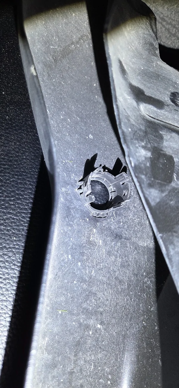

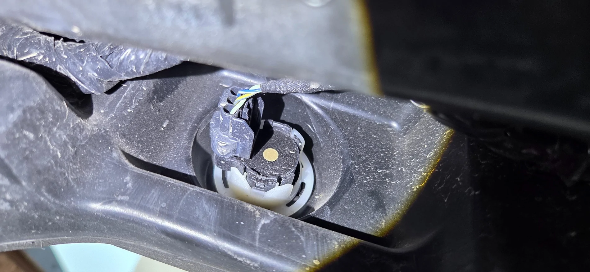

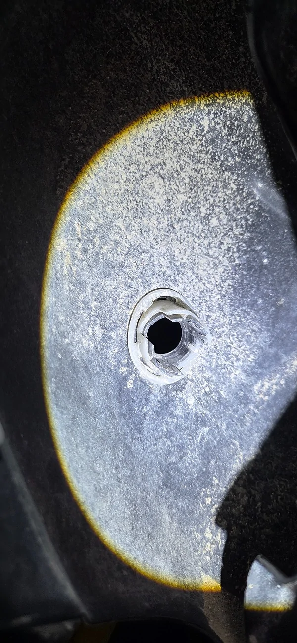

i did this about a month ago. It went really easy - only hard part was swapping wire harness. I had to get a few senor mounting /retainers brackets as the ones I had in the steel I purchased broke. I didnt have to get new senors or anything. I will note that make sure you 100% hear the clicking noise attaching the wire harness back to the car on each side or youll get a parking assist filaure. I had to pull mine twice to get those clips to really clip together.
