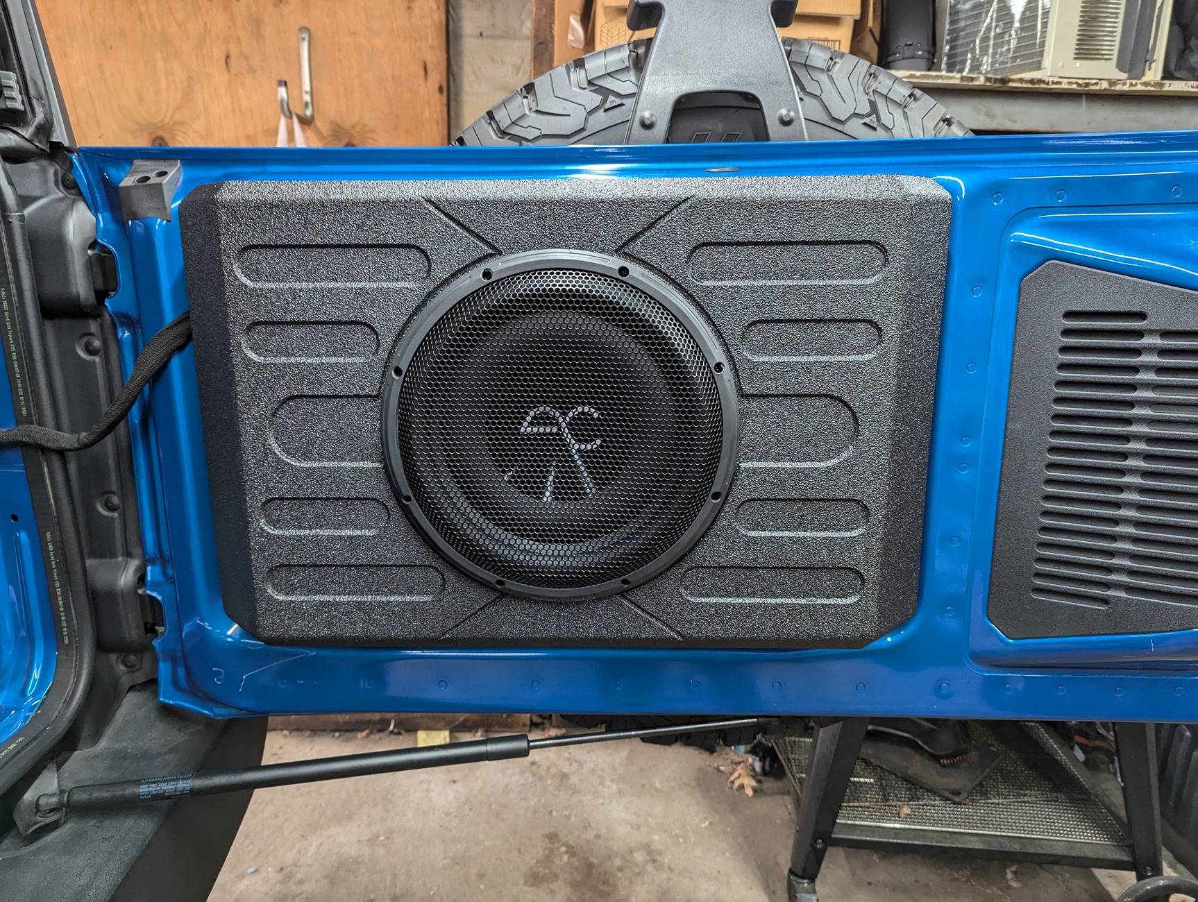

That brings me to my latest iteration. I called Joe at @plugnplaykits and asked him what he would recommend. I told him that I was planning on running the Kicker CS in the dash still, but I was going to switch the kick panels to a mid-bass Morel 6.5" (that was a part of a component set), and a set of 6.75" Morel 2-ways in aftermarket pods in the rear. I told him I wanted to get the Stinger tailgate box and mount the amps where the stock subwoofer box was. He suggested the following:
For the dash 4" speakers (rated for 65w RMS), the Musway P2. For the 6.5/6.75" speakers in the kick panels and pods respectively, the Musway M4+ DSP amp (to keep the ability to tune, but also double my RMS power. Lastly, to run the Stinger/ Audiocontrol sub, the Musway One.600 mono amp. I was a little hesitant, because I hadn't really had any experience with the brand before. However, a little look around their website and reading a few reviews online had me sold. Joe set me up with a package that included a loop-back harness to run the M4+ off the factory speaker outputs, then feed the amplified signal back to the speakers using the stock wiring.

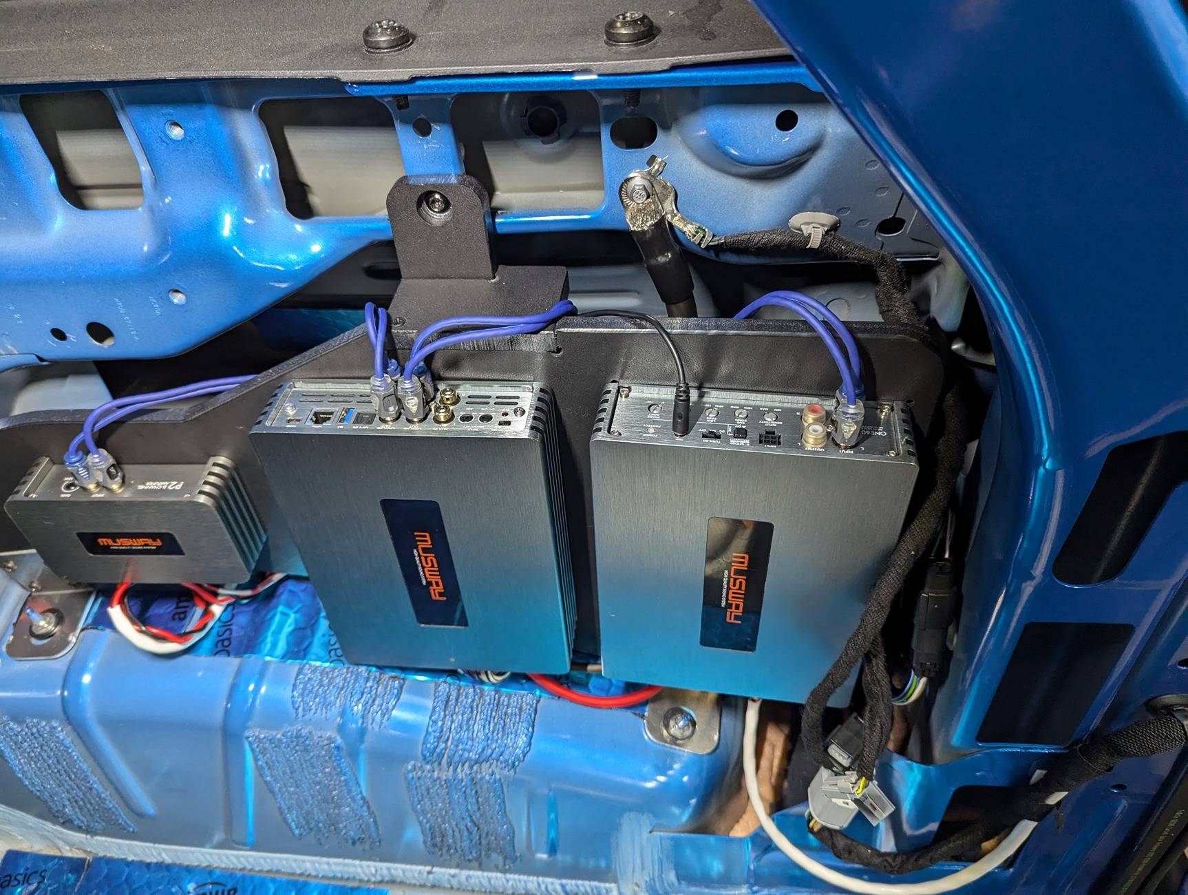

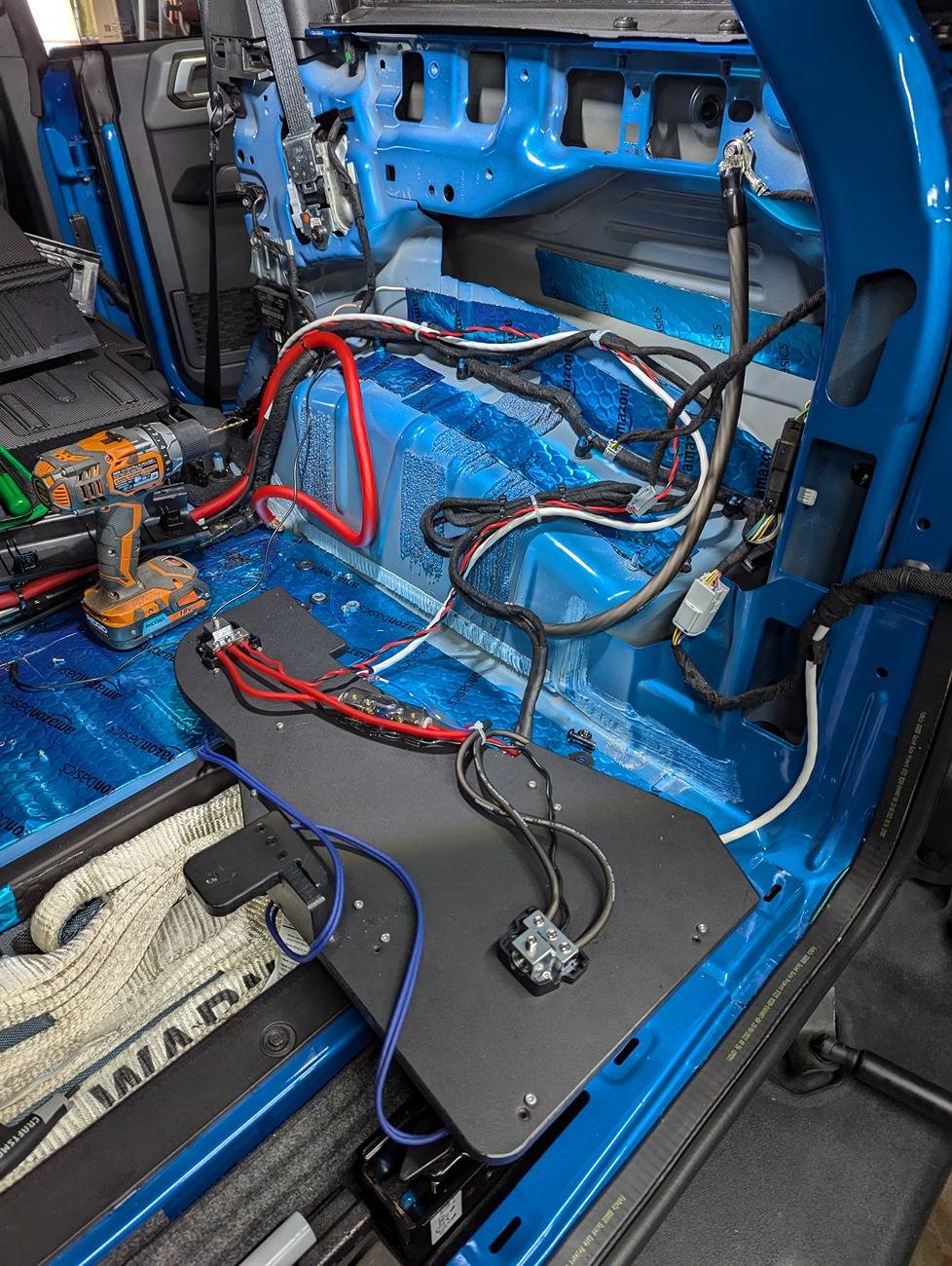

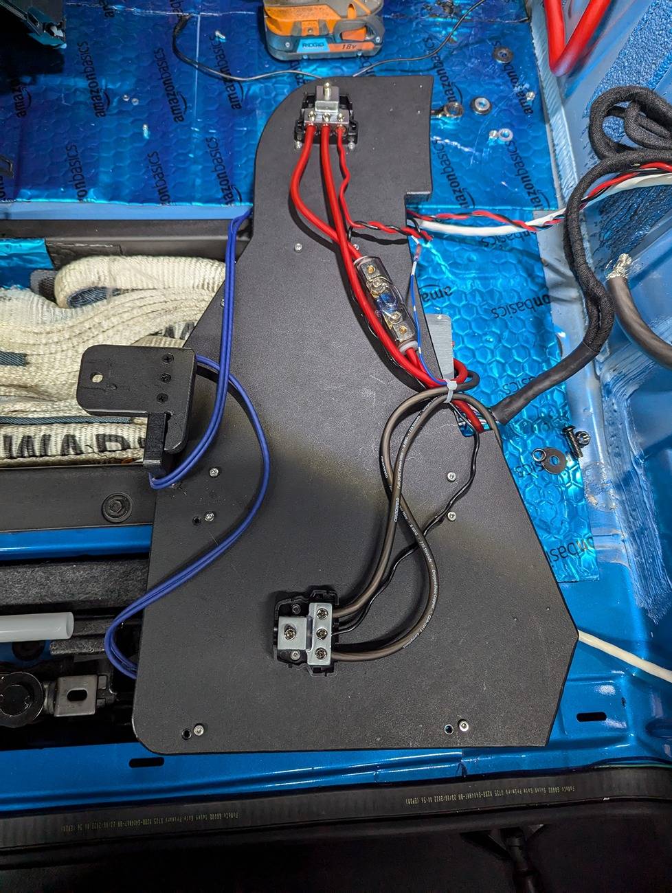

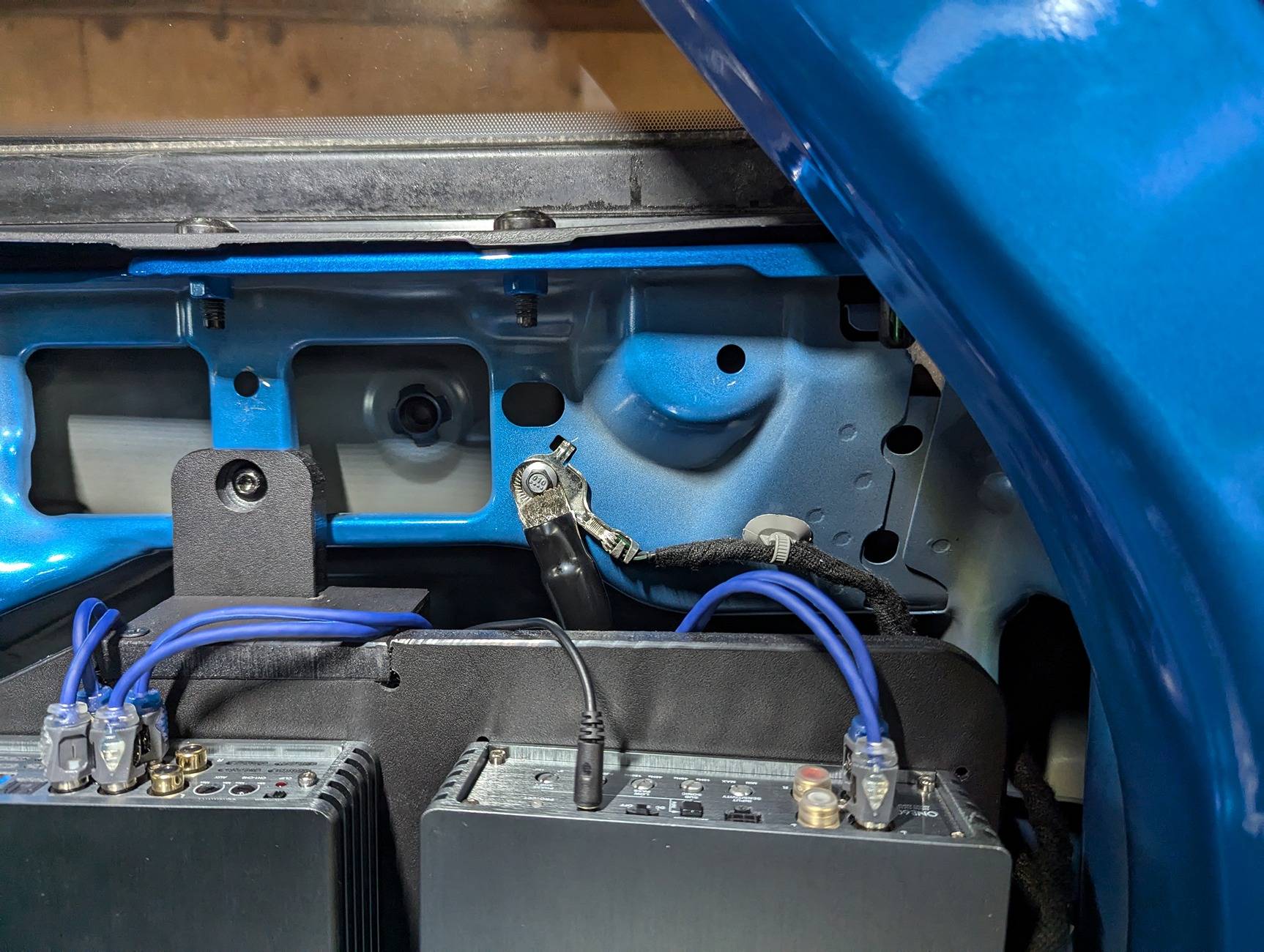

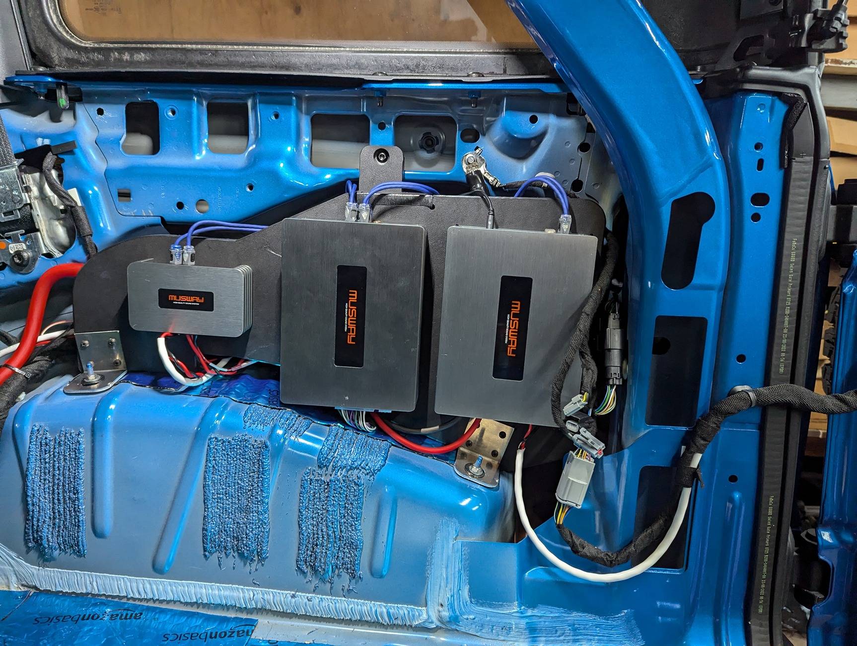

The P2 is driven by the DSP in the M4+, since there are 2 sets of DSP outputs for expansion. The other set of RCA outputs is going to the One.600 for a subwoofer channel. For power, I ran 1/0 cable from under the hood, down the driver's side and under the door trim. It's a huge wire, but it fits under the trim without issue. I ran it to the flip-cover behind the rear seats, across to the passenger side, and terminated it in the rear quarter trim. The ground side is handled by the factory ground location. The 1/0 wire is connected to a 3 way distribution block that feeds 8ga to both the M4+ and the One.600, and 12ga to the P2. This is mirrored on the ground side with the same sized wiring in black.

Joe's t-harness was connected to the ACM behind the HVAC controls and run down the passenger side door trim. I also ran the adjustable bass knob wiring and the separate speaker wire for the dash speakers down the same path.
The amps and power distribution are mounted to an MTI Accoustics amp rack that fits where the stock subwoofer would go. It's a fairly heavy and sturdy piece of plastic, so it's literally a blank slate for adding your own setup. There's plenty of room behind the trim panel for the 3 amps, and room behind the amp rack for all of the associated wiring.

I can be as obnoxious as I want now, with a decently sized and powered subwoofer. I can also cruise between Detroit and Louisville with all the windows down and still have my music as clear as listening through headphones. The Musway DSP software was incredibly easy to use, and the hardware is top-notch quality. I'm far from disappointed, bordering on elated. I'm one of those crazy folk that listen to every genre of music, and it all sounds amazing now.

Do you have the plastic interior panel that has the subwoofer speaker grill or the molded pocket? I ask because I want to know if all of that fits behind a standard panel with the pocket.

I was asking if it fit behind the cargo plastic panel once installed if the panel has the pocket in it.
I had previously taken out the pocket thing by grinding off the plastic "rivets". I had the factory box back there for the first few tries at making this thing sound decent, so I had replaced the pocket with a 3D printed grille from Etsy.
It would not fit, as I have it, with the plastic pocket in place. However, you could easily fit these amps under the driver and passenger seats using the brackets from Stinger.

Unfortunately the amps don't fit under the seats unless I take out the heat vents. I will look for a 3d grill and replace the box

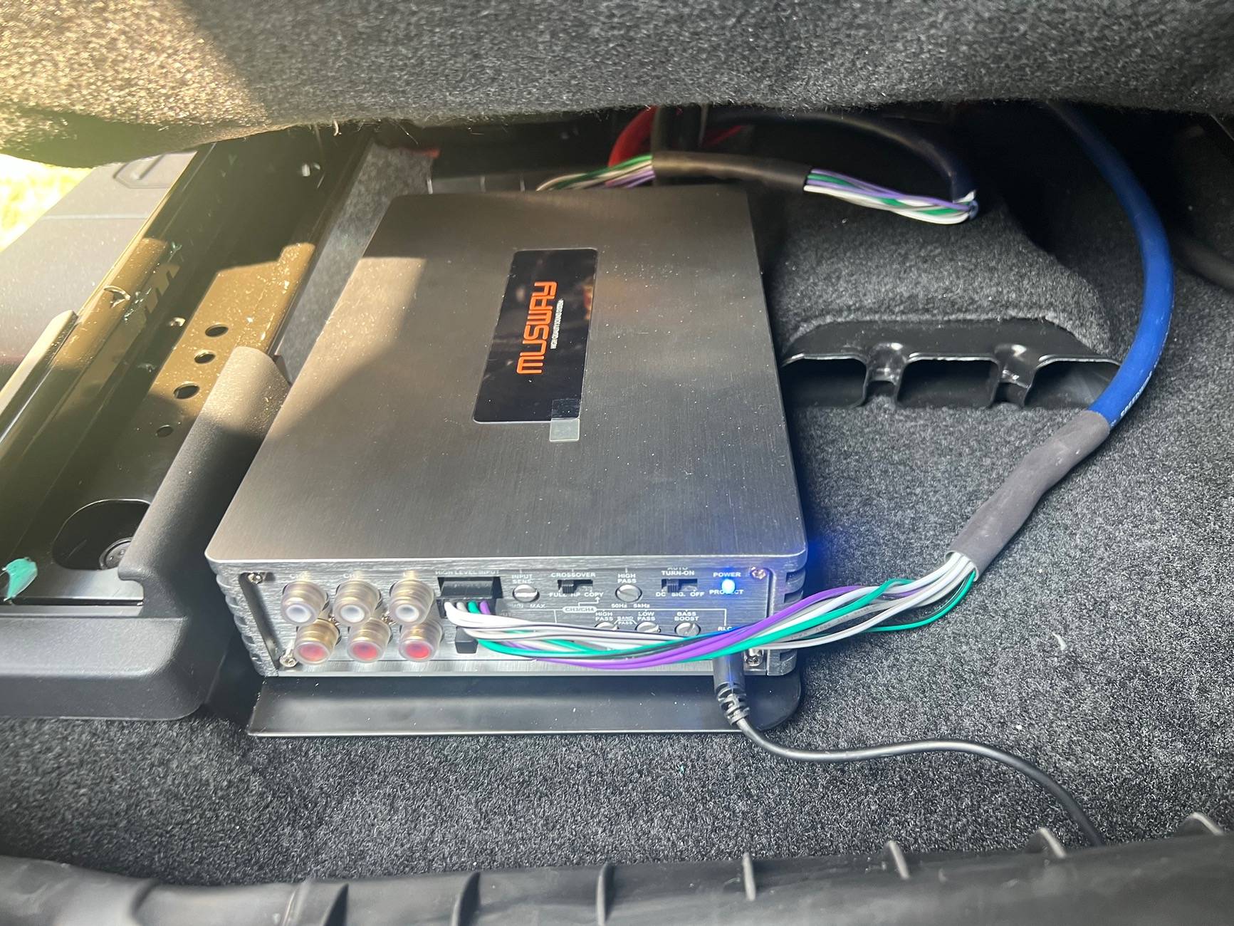

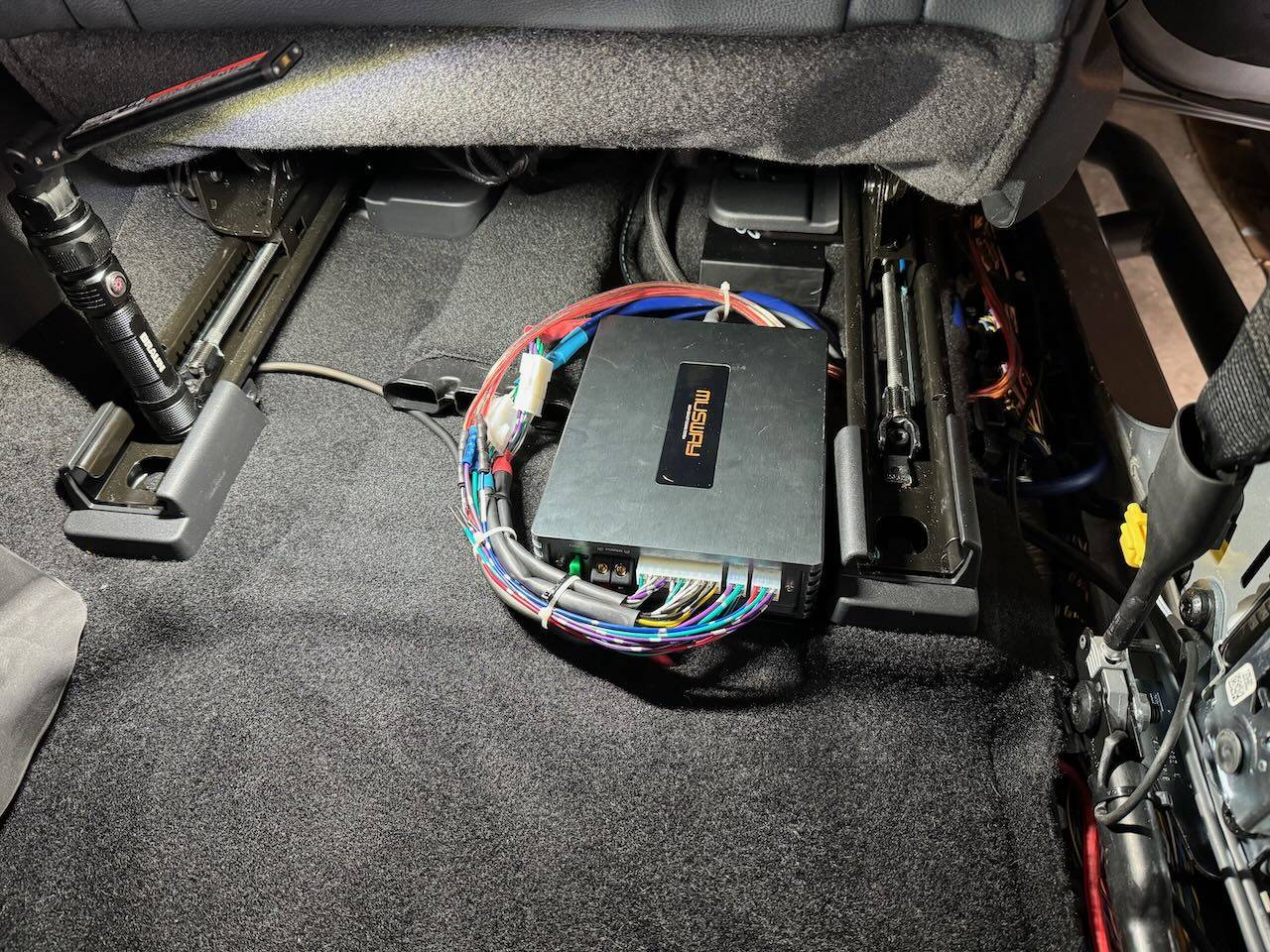

That is not true the amps do fit under the seat all Miusway amps from the two channel all the way up to the eight channel fit under the driver or passenger seat using the stinger amp rack I sell
