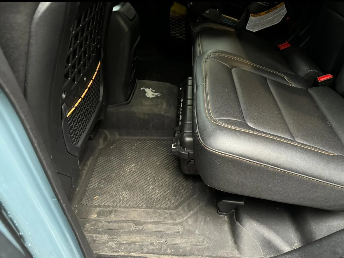

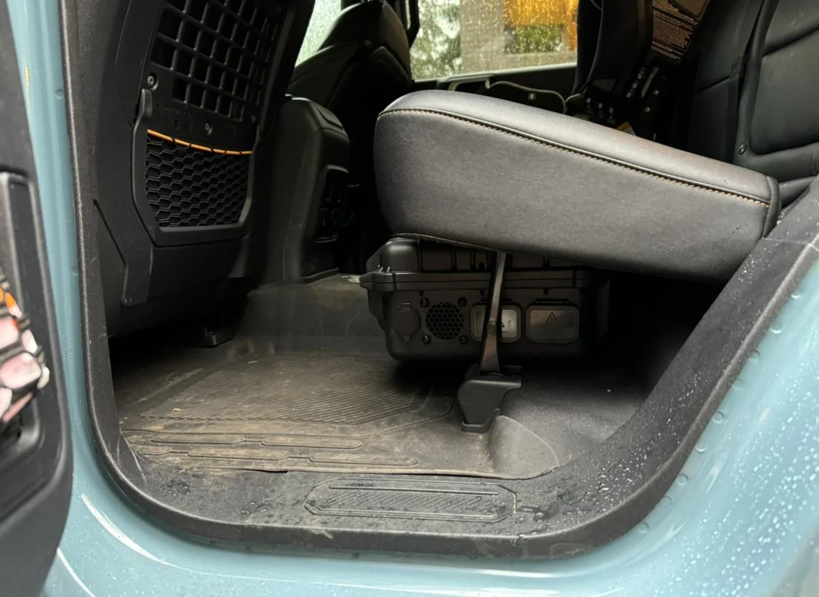

Do you have a pic of where it will live in the Bronco? I think you mentioned under the back seat at one point...Would like to see that and how you secure it at some point.
Pictures as requested of potential storage location underneath the back row of seats. As I mentioned, it’s a little tricky to get it wedged under there at first, but once you have the technique, it’s pretty easy, and it doesn’t move around much at all.

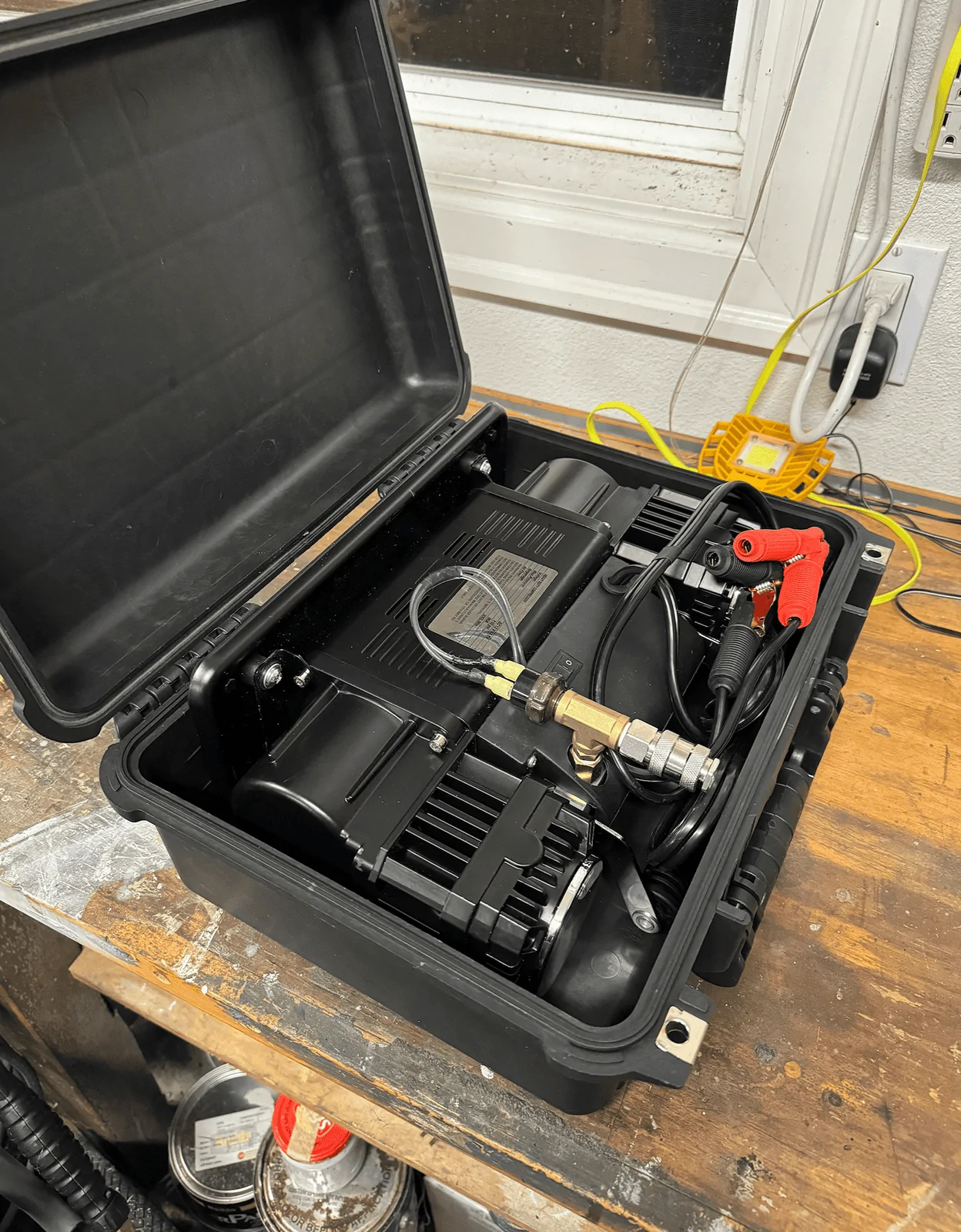

BTW, @Tricky Mike, your compressor fits perfectly in the same case. I've been debating whether or not to modify a 2nd case I keep the compressor in to make it easier to plug in and connect hoses. The issue is I still have to open the lid to allow for air flow and cooling while in use, so there's not much benefit. We'll see if I get bored at some point in the future though, I might just come up with something for it.

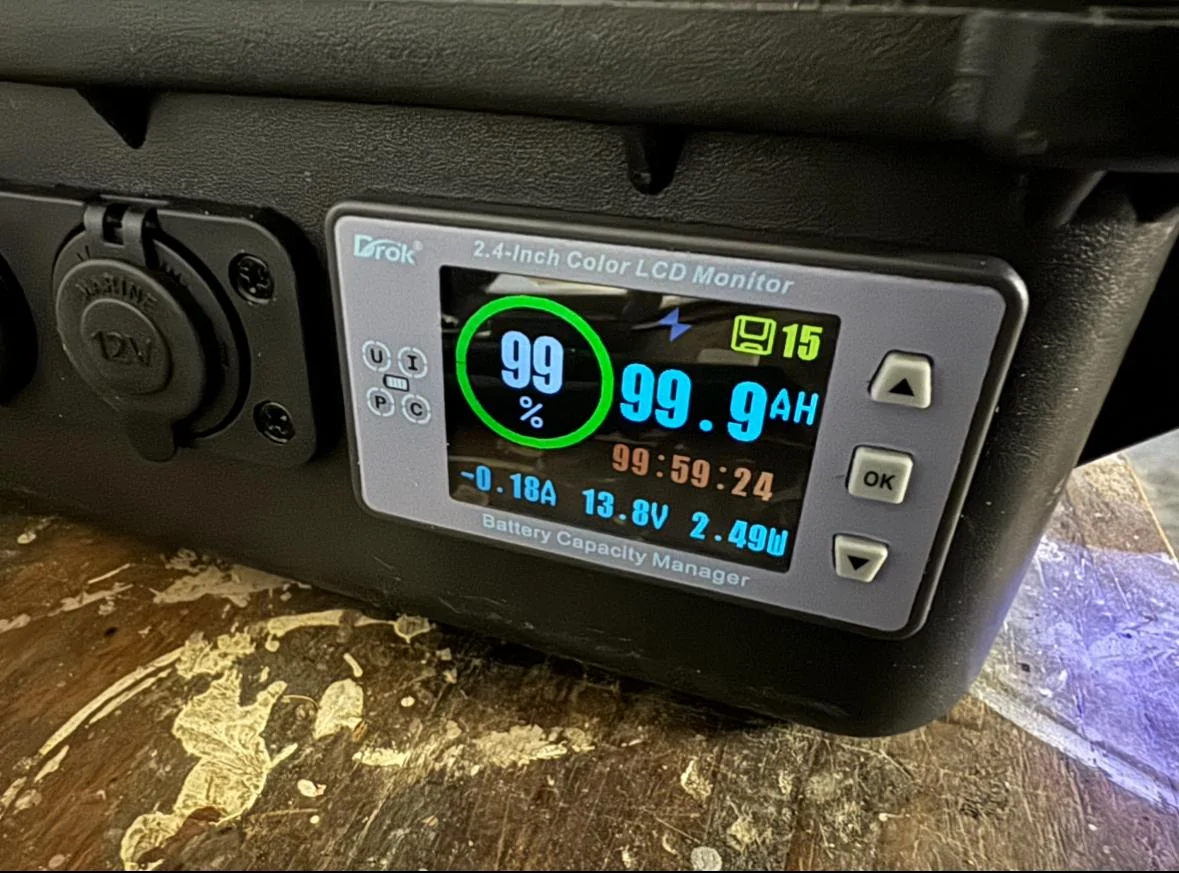

Plugged it in and charged the battery to 100% to set the monitor's max capacity setting. According to the monitor, with everything unplugged and the system on, the internal components only run on 0.2A (most of that coming from powering the monitor display). That means if I leave the power station on, but with nothing plugged in, it'll keep running for around 20 days. Thinking back on this now, I should probably verify this figure with a multimeter.
Next up is to cycle it back to 0% to test the low voltage warning and the cutoff level. Just need to find something to plug in and drain it relatively quickly... air compressor should do the trick.
