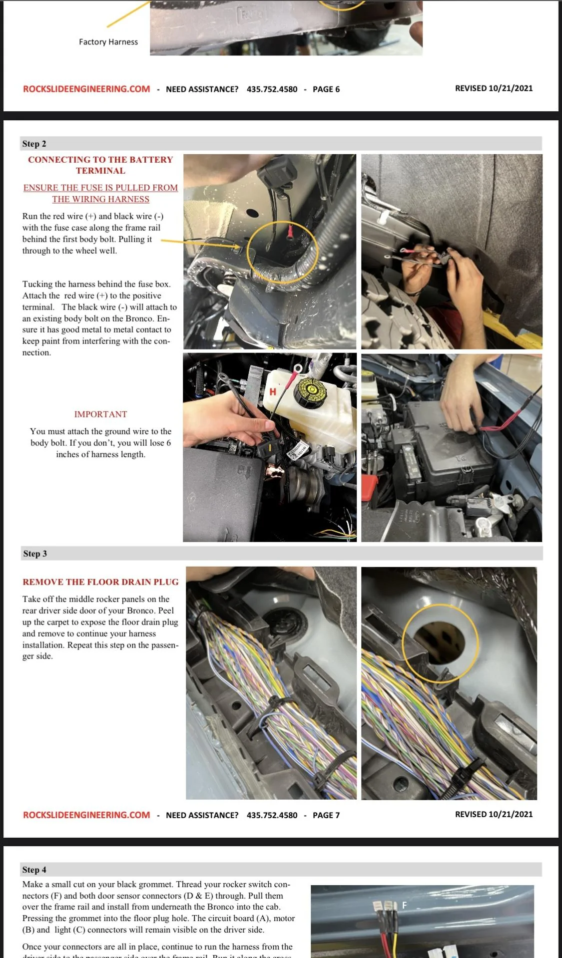

Based on the Rockslider Steps installation instructions, there is a drain hole in the floor right by the edge of the door trim. Lift the carpet/rubber and you can use that grommet/hole.

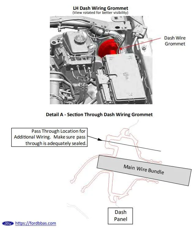

I think he is talking about the oval-shaped one above that (where I ran my ditch light switch wires). But looks like that's only available if you have an AT.
Yes that is the one I was talking about.
For anyone following the thread with a manual... I am curious about the grommet illustrated. I will try to poke through there.
Not an ideal solution, but in order to run power into the cab, i ran power wire down the driver front wheel well in the engine bay, then followed the channel under the chassis until I got to the left rear passenger seat. There is an opening in the floor there that allows a wire to come in. I just ran it along the door trim where I needed to go from there.

I have a manual...message me if there is something you want me to check and compare
Hi there!
For the main wire grommet you show in the diagram... If i were to poke through the top as shown in the image, could I assume it would come out neatly on the cabin side without tearing anything up? Perhaps with a long skewer?
I didn't realize that grommet was empty at the top. I was looking for the oval shaped, empty grommet everyone else was using.

Hi there!
Yes, I think that is exactly how it is designed. I have not done it myself, but I just went and looked at mine and it looks just like the picture. On the engine side, it does feel pretty stiff when I touched that grommet, so it might take some force to poke through. Let us know how it goes!
