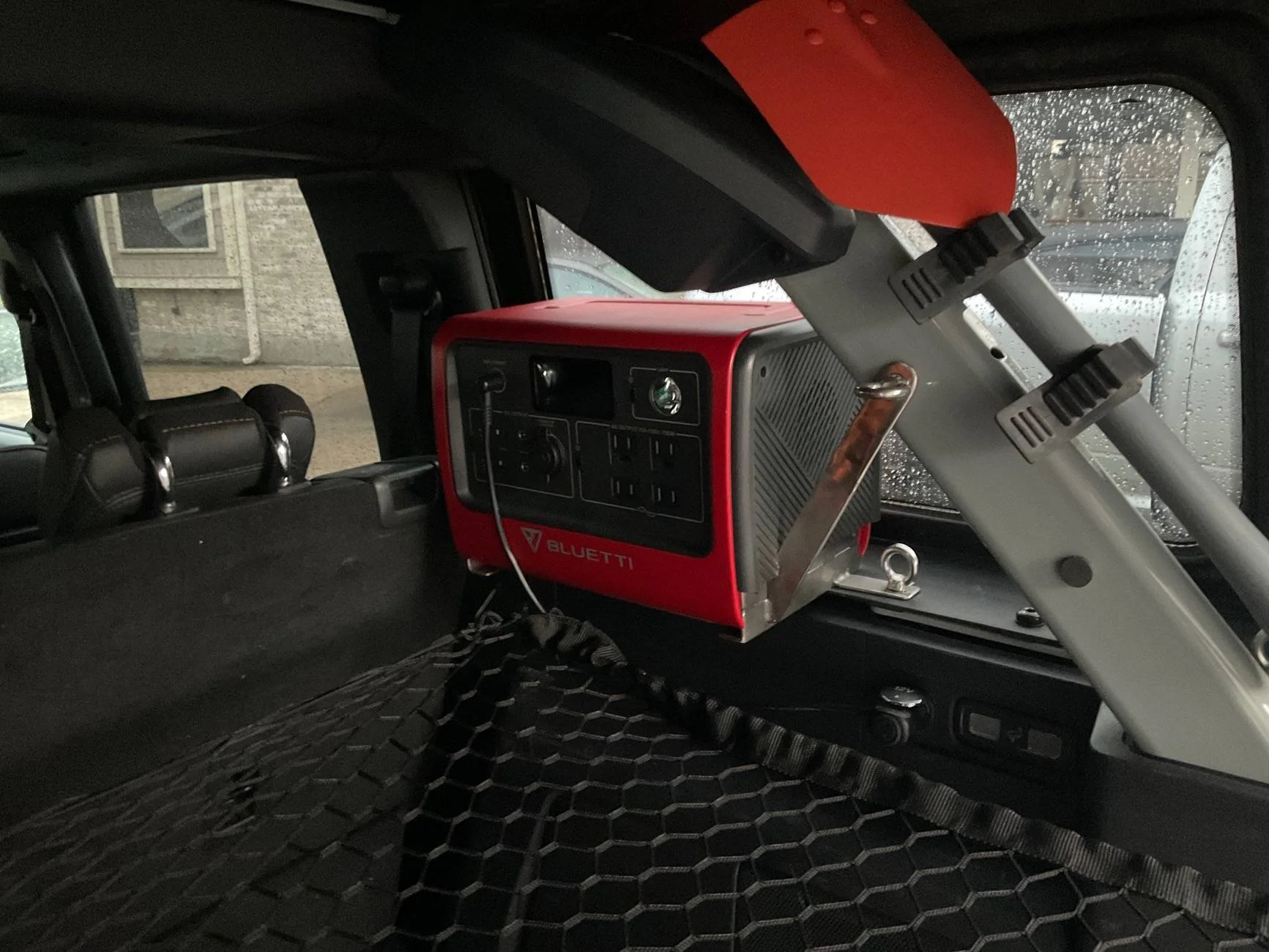

Were using a Bluetti portable power pack to power our ARB Zero 47qt. fridge.
The Bluetti powers the fridge and we have the Bluetti plugged into the rear cig port, so that it charges while we drive.
When the truck is sitting at the shop we tend to plug the Bluetti into regular 120V power to keep the battery charged.
We can go about 3 days before the Bluetti needs to be recharged
