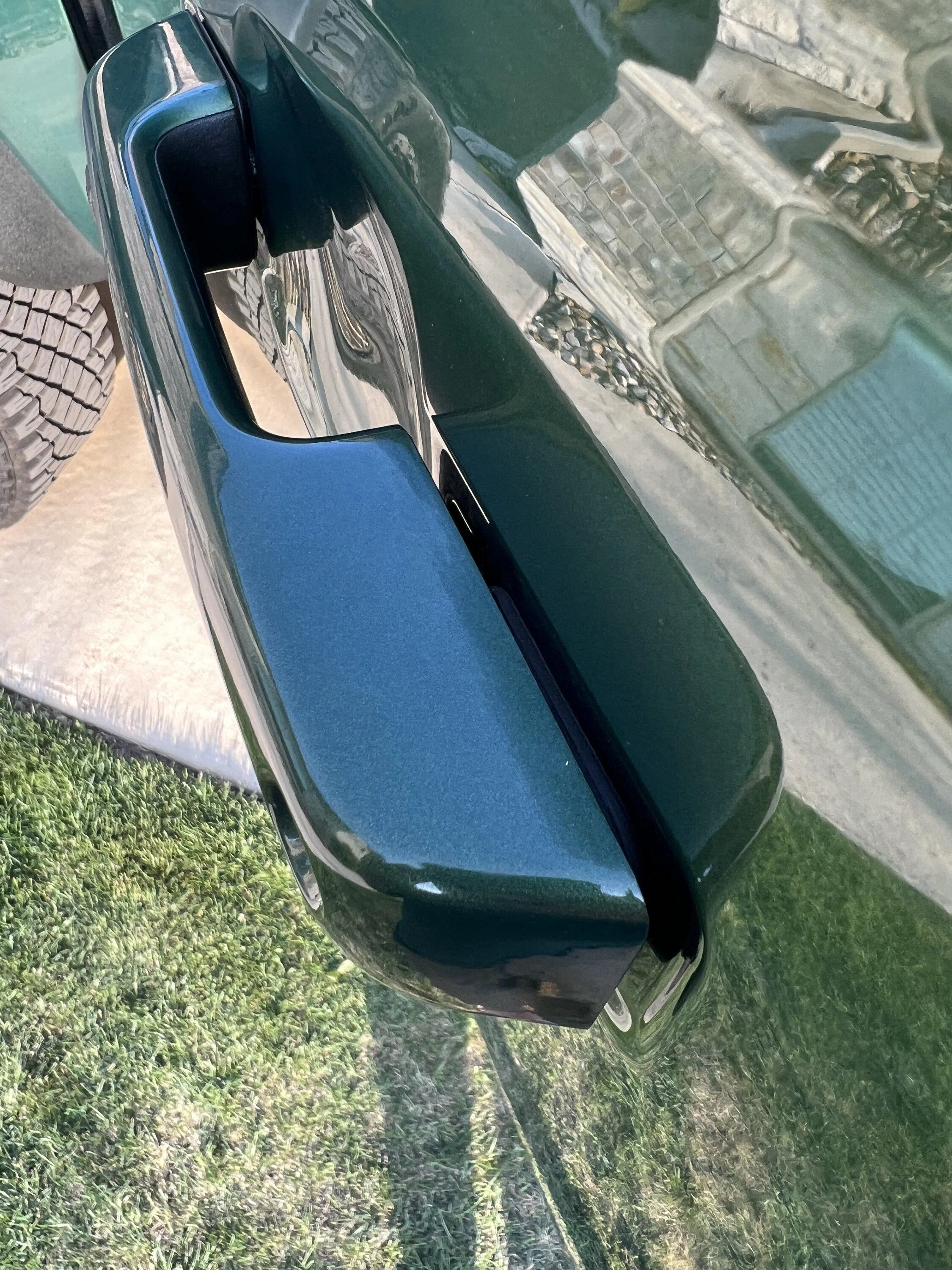

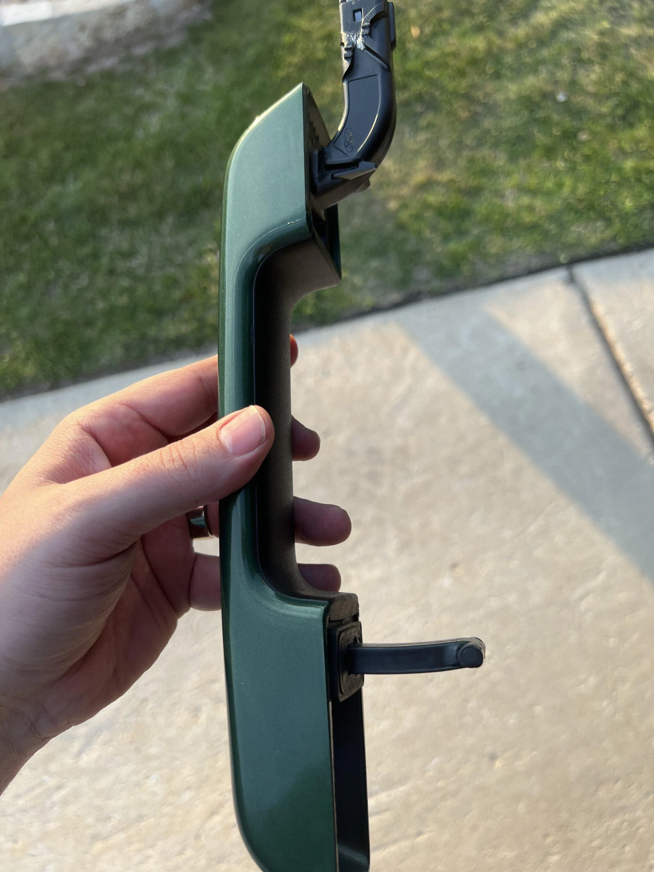

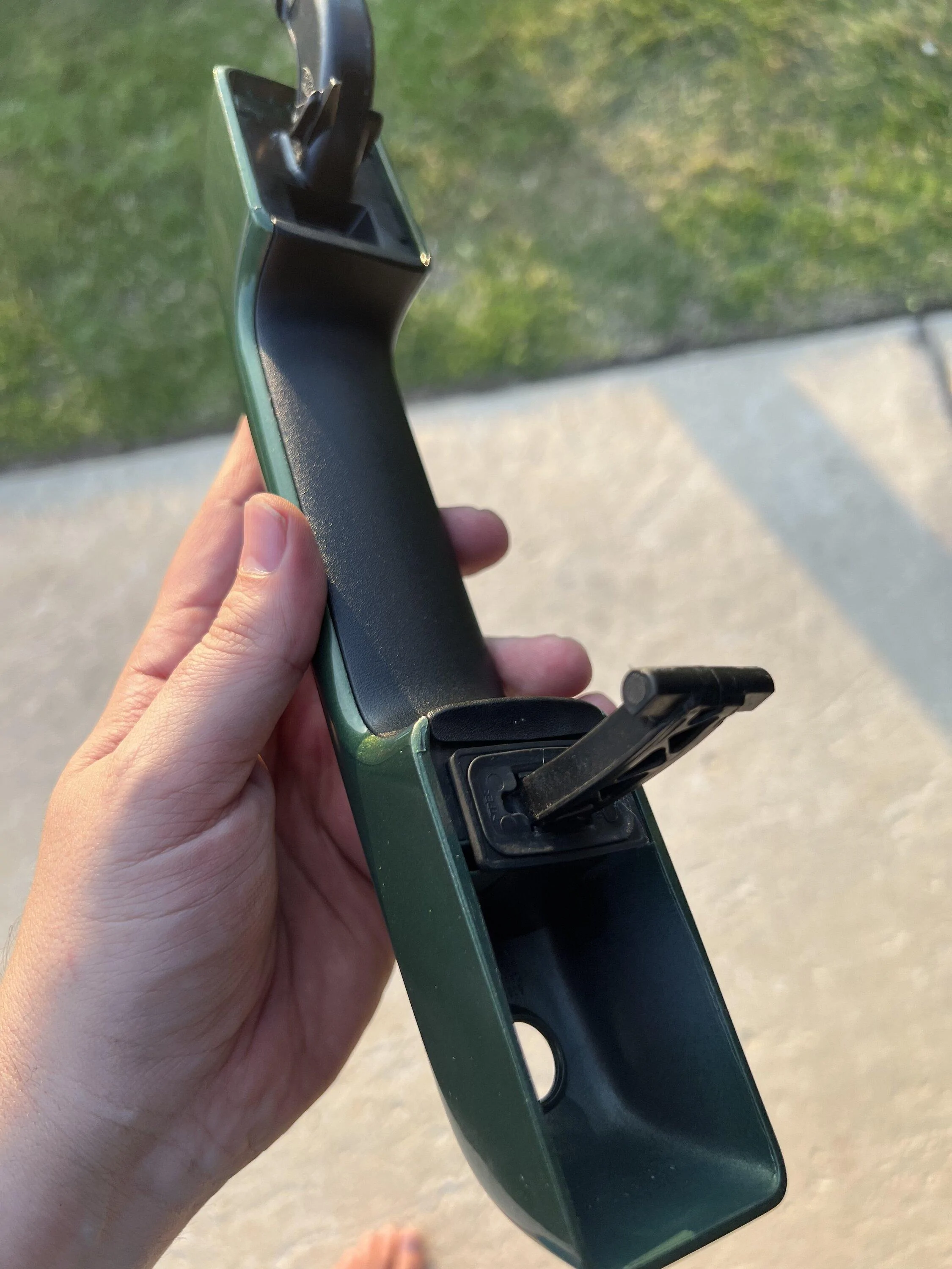

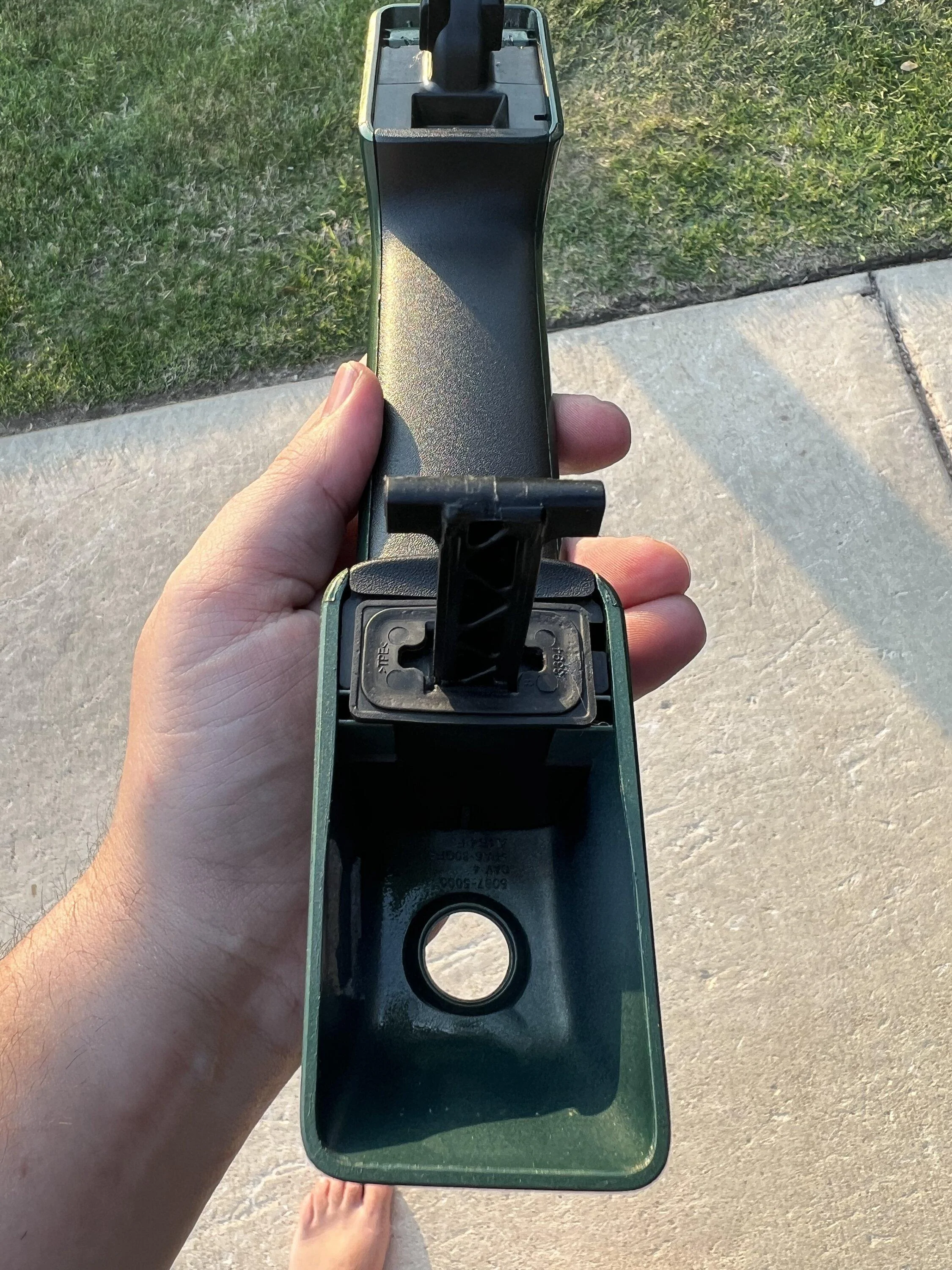

Hopeful someone has experienced a similar problem. I am doing a handle cover replacement on my Bronco. All of the covers went on without an issue except the drivers side handle. I have the new covers set properly, but when I try and reconnect the handle to the latch it won’t grab. If I try and tighten the 5 mm bolt it just pushes the handle further out. Any recommendations before I have to take the door apart?
Any help is greatly appreciated!

You may have to get some small picks and open the jaws. I had taken mine off and 2 went in by applying pressure and turning the 5mm bolt. The other two I had to open the jaws and then follow the procedure.

This was very helpful. Need to get a hook, but looks like the step I’m missing on this one. Thanks!!

Got it latched in. That last video did the trick with the hook tool. Thanks for the feedback everyone!
