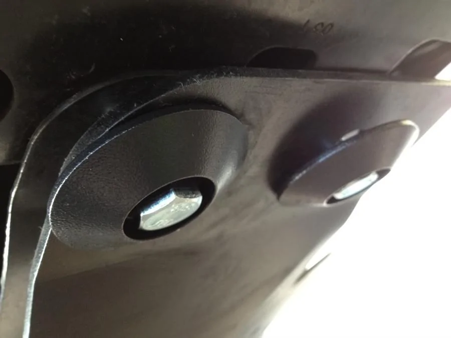

As promised a few new shots of the Lower A Arm Skid Plates that are in development! These are being developed in conjunction with the Front Differential Skid Plate and Front Bumper Skid Plate to make for a seamless transition and guaranteed fit!
Ford Bronco Prototyping the LOD "A" Arm Skid Plates 1638902707984
Those look good. You can flip those shock bolts to protect from thread damage and reduce shearing risk too....
On our Bronco those bolts are pressed in shock mount... So we are considering adding a guard plate to cover them. Most aftermarket shocks will come with loose bolts, so you'll be able to flip the bolts. You could still use our guard plate to protect the bolts heads if you wanted.
