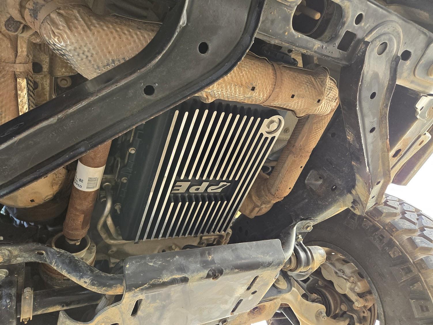

I was out off-roading in my lifted badsquatch on 37s. It comes with the steel skid plates and I sit fairly high off the ground.
The factory transmission pan isn't protected at all, and it is cheap, flimsy, brittle plastic. It weighs about a pound. I have been wheeling for about a decade in different vehicles and have lived in Utah with this bronco before I moved to NC. I'm not a noob to off-roading.
I ran over a branch and it punctured the transmission pan and ALL of the transmission fluid leaked out within a minute. I would have been stranded on the trail if I wasn't with another vehicle.
I ended up towing the bronco back home and replacing it with a PPE cast aluminum pan because it cost the same as a skid and I had to replace it anyway.
This is just a PSA, but it's a must if you go out....freak accident, but it was just a stick that brought me to a halt.

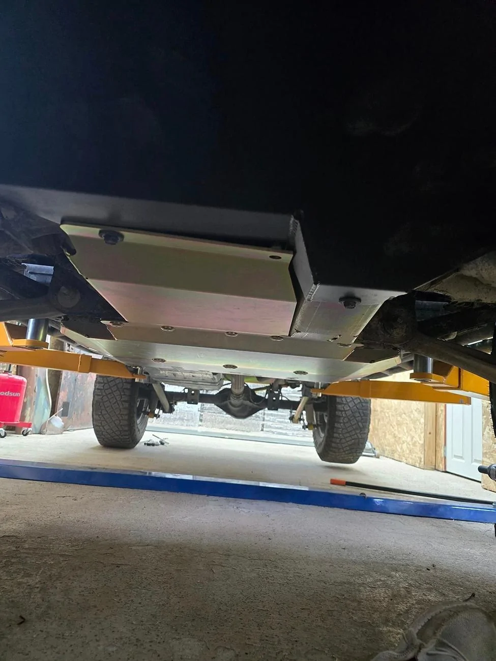

Just installed metalcloak skids. Easy install and seamless fittings.
