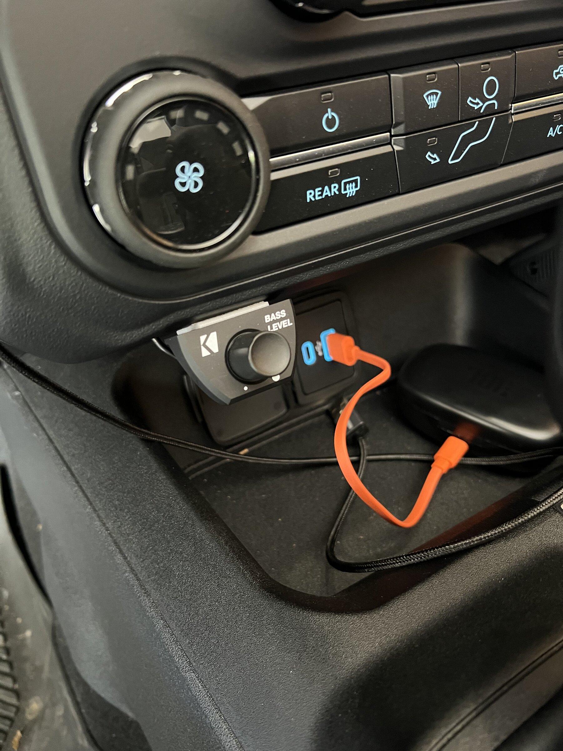

I think this is only of use if you are adding a sub... someone can correct me if I'm wrong there.
If you are adding a sub, I think its a must-have. This controller came with my wiring harness from PlugNPlay kits. I figured what the heck and installed it as it is easy to do at the same time you are running wiring for a sub to rear of the vehicle. I use it quite a bit - i need different bass level for XM radio vs. streaming Spotify vs. regular radio, and even need different level from one XM station to another. If you are wiring for a sub, I say go for it.

If you’re running the key 500.1 then yes. Very handy to have and I’ve installed the bass knob on the last couple installs I’ve done. I wouldn’t go without it now!

My head unit controls my subs so it's not necessary but if you like instant access to control it, it's nice. I have to go into the controls and go through the screens in order to control bass so it can be useful to keep it separate.
BTW, Kicker Key is awesome... will blow away the stock and the B&O system once you hear it.
What do you have plugged into the USB?

Thanks guys-I’m replacing all the speakers and getting the B&O sub enclosure (replacing the speaker it it with a low profile kicker sub), so I’ll add this to the list of stuff I need.

Those are my headphones lol. The other cord is for my phone mount charger.
Lol. I thought it was a hard drive or something.
