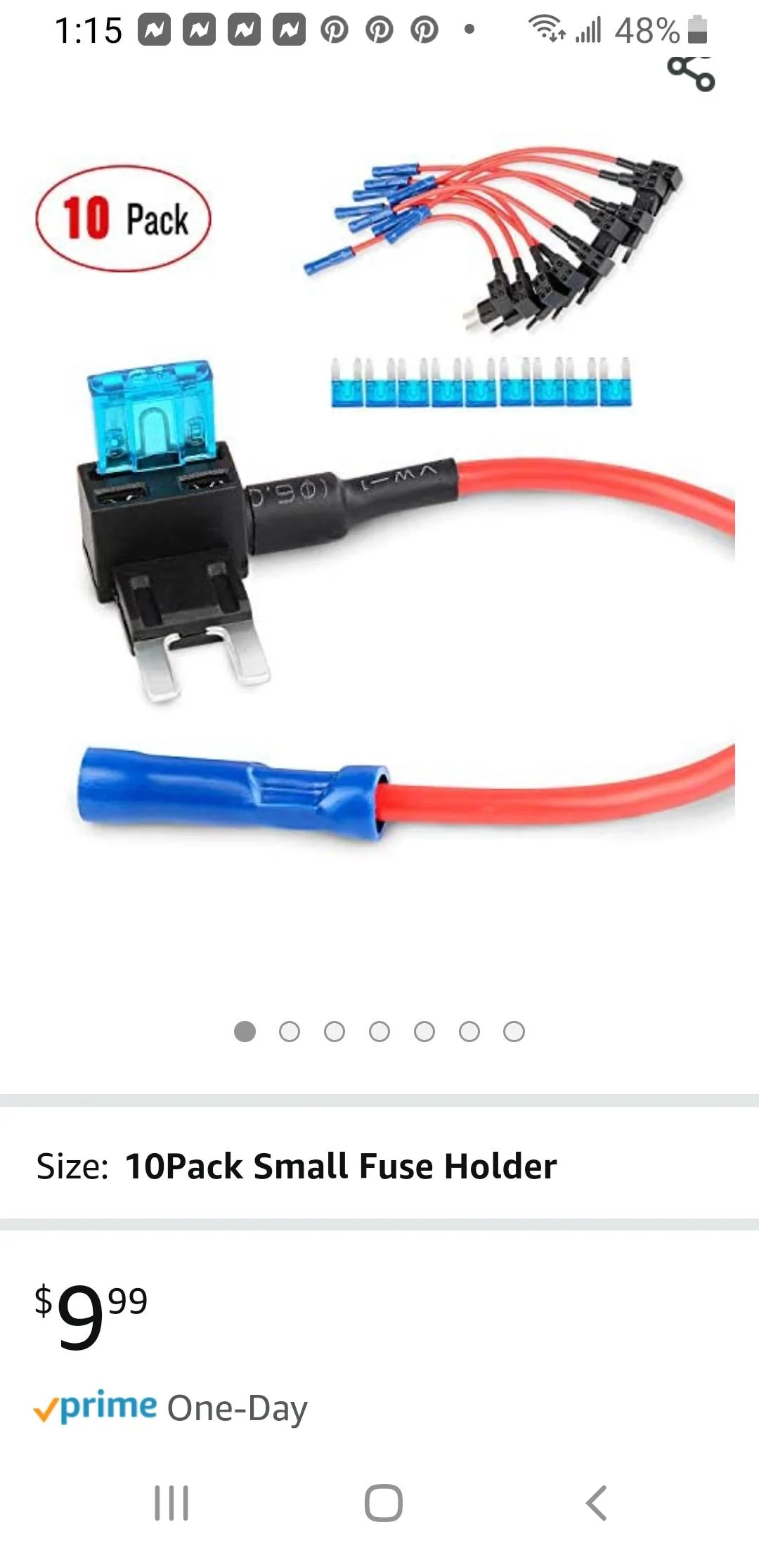

I think you did an awesome job ,I'm going to use a fuse tap in the fuse box for power so as not to tie up a switch.
would love a bit more info on this for someone who has zero idea how to piggyback off fuses.
Yes very easy find desired circut,remove fuse from fuse block,replace with one of these,it will be the power either keyed or hot always on whichever you decide..
