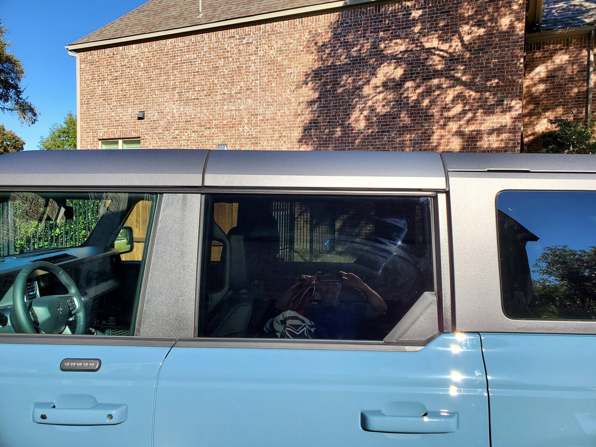

I have some edges that look sketchy. Also some snakeskin or honeycomb visible on the inside around the rear windows. I'll try to post up some pictures.

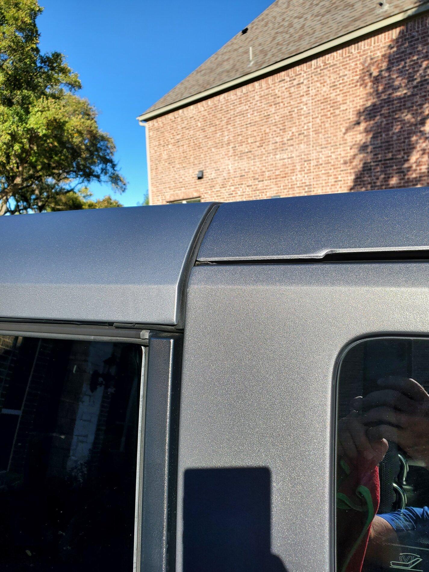

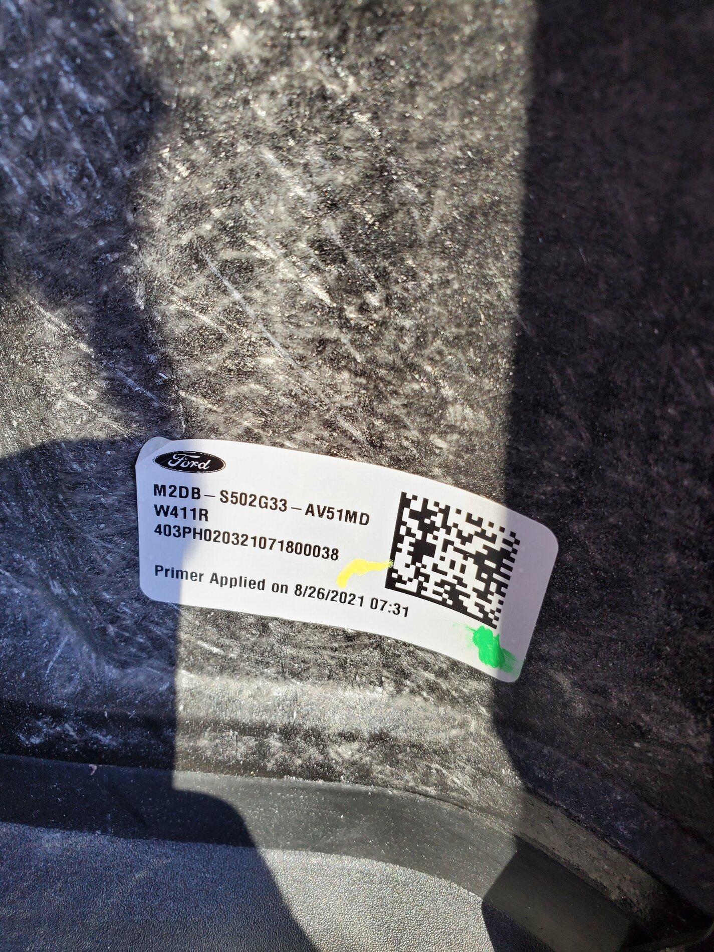

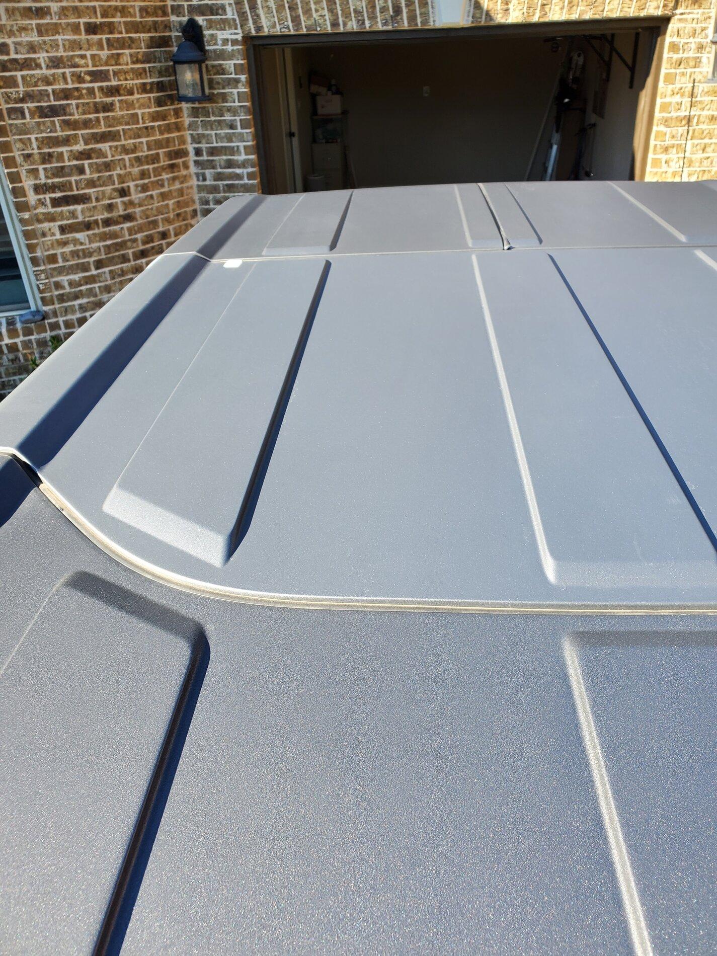

Jeep Wrangler 4-door
