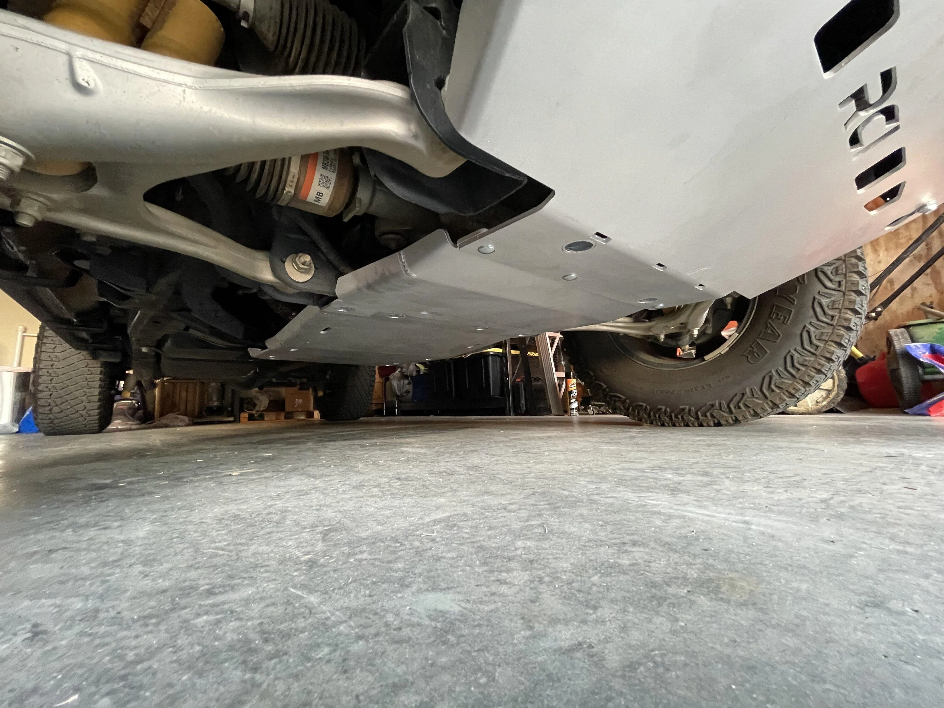

Just got my RCI ski plates in today and installed it. It was straightforward and easy.
Ford Bronco RCI Skid plate installed! 54E1A288-E375-4D9C-BDB3-D1CA4D4742BB
Looks great and thank you for your business! Let us know if you have any more feedback as you get some use out of them, we would love to know how you like them!

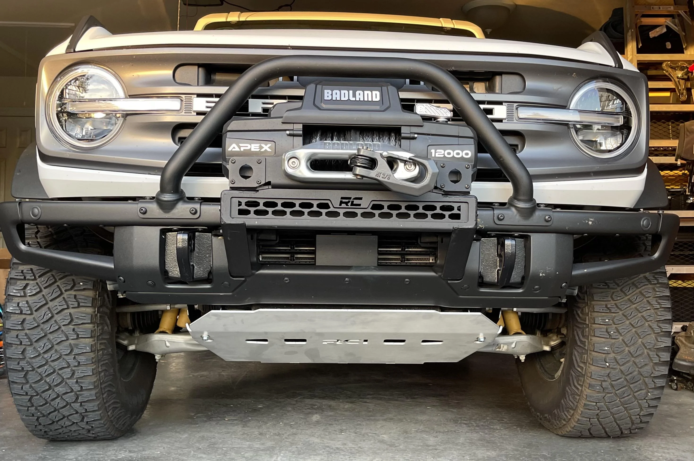

I am debating between Aluminum and Steel. Looks like you went with aluminum, love to hear why you went with what you did.
I went with aluminum for the weight savings. I know they don’t slide as well as steel, but with a bull bar upfront, RC winch mount and winch my front is squatting as is. (looking at a leveling kit to compensate. I’m on Sasquatch suspension).

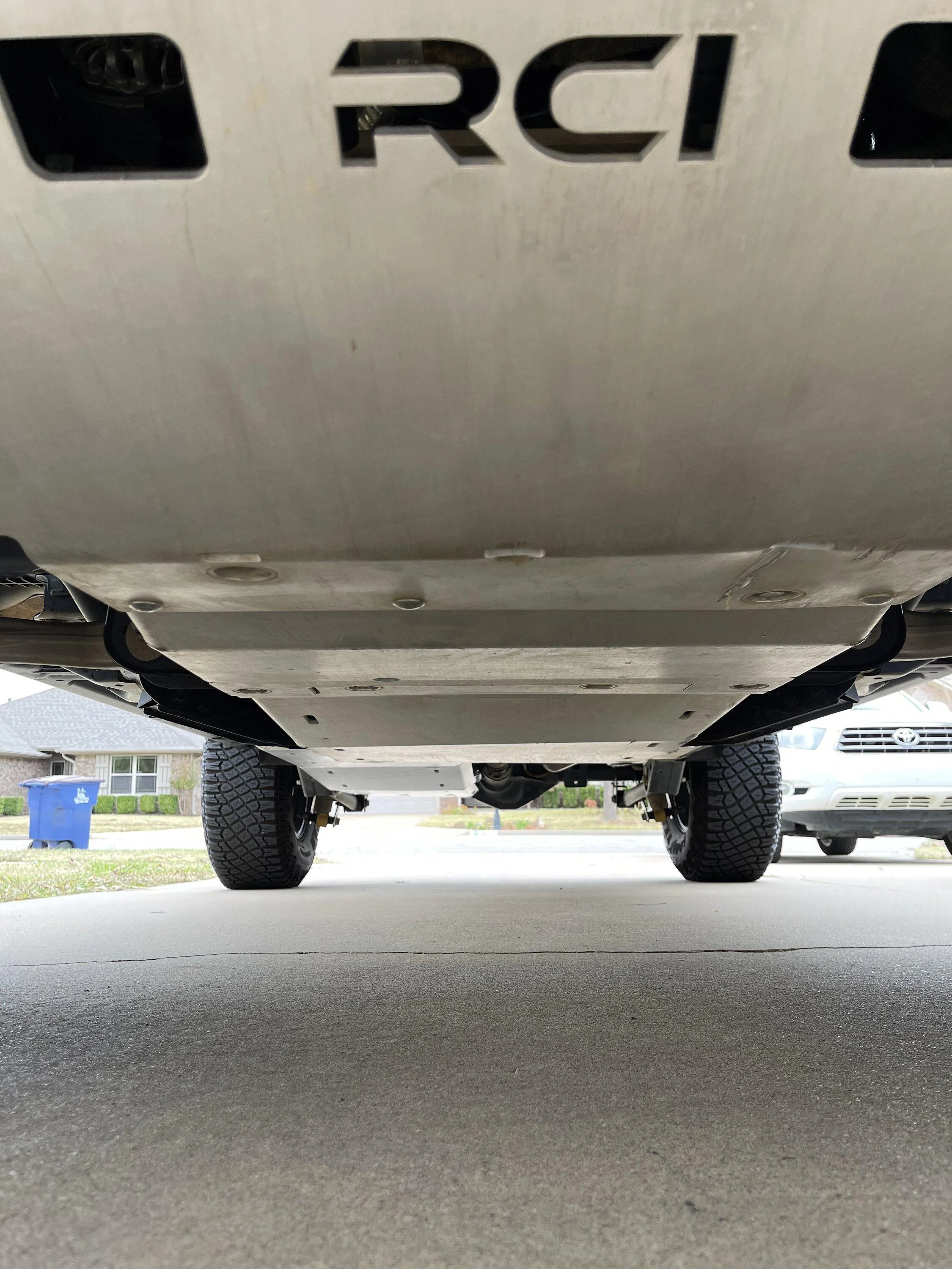

So far so good! I’ve bashed it and can still take it off without issues. I’m generally more of a scenic off-roader than getting out rock crawling. But this occasion came up. I would recommend the steel if you rock crawl for it to be heavier duty.
Ford Bronco RCI Skid plate installed! 9C16F519-B450-49F0-931E-51D6883999E6
Thanks for update I must have been typing when you were. It looks like you have gas tank skid also how was that install?

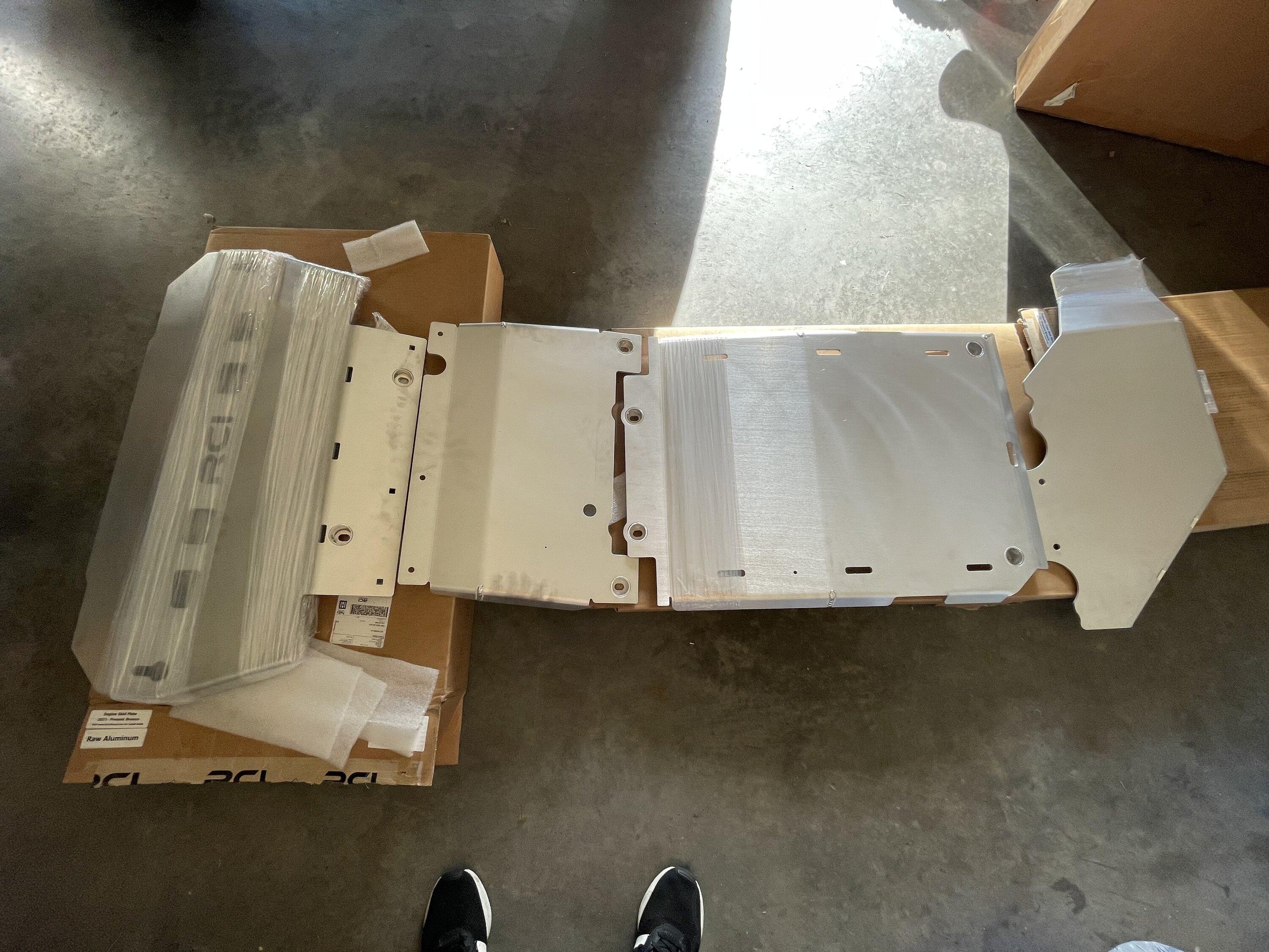

Gas tank install seem intimidating at first but after doing it, it actually wasn’t bad. Basically you strap your gas tank up with ratchet strap then remove the factory bracket and bolt up the new skid. In the instructions it says to allow some play on the back bracket when you install… make sure you follow that otherwise it’s hard to line up that back bracket. After I got the skid loosely installed. I removed the straps. Make sure to position it to allow it to slide out from between the skid and gas tank.
@F150rubyred
You’ll want a Jack or an assistant to help hold the skid up while you bolt it up.
I did it by myself so I used a Jack to hold up one end of the skid while I bolt up the other.
