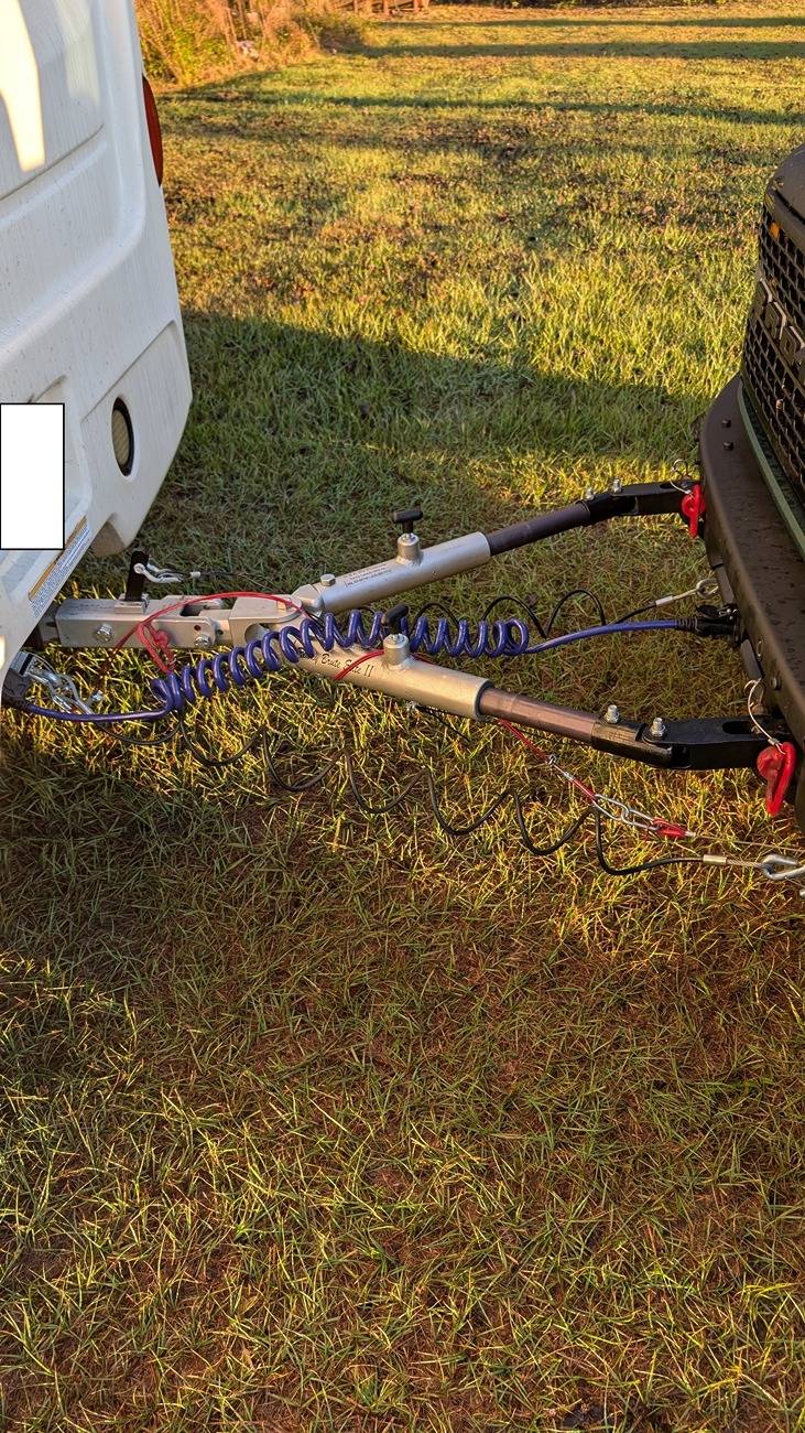

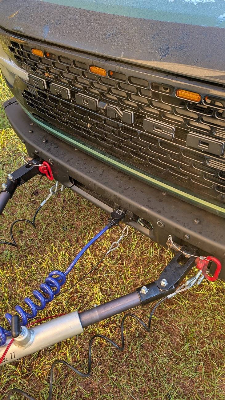

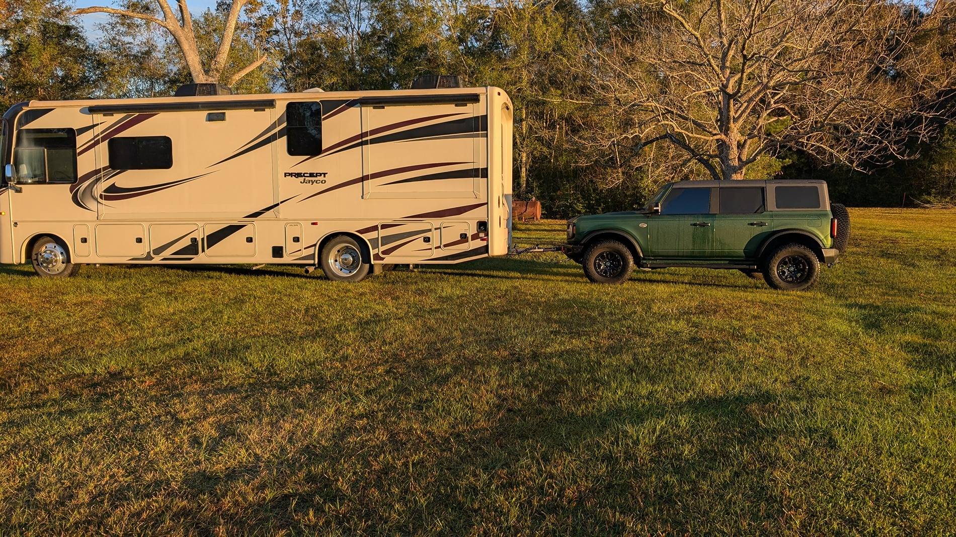

I have successfully towed the bronco now for about 1500 miles total over 3 trips with no issues. This setup is easy to connect and disconnect and so far I am very happy with the results. If anyone has any questions about the above, I will be happy to answer them if I can.
Ford Bronco Ready Brute Elite II flat tow setup PXL_20240521_192005936
Ford Bronco Ready Brute Elite II flat tow setup PXL_20240521_190544480
Ford Bronco Ready Brute Elite II flat tow setup PXL_20240521_120459593
Ford Bronco Ready Brute Elite II flat tow setup PXL_20240521_190552554

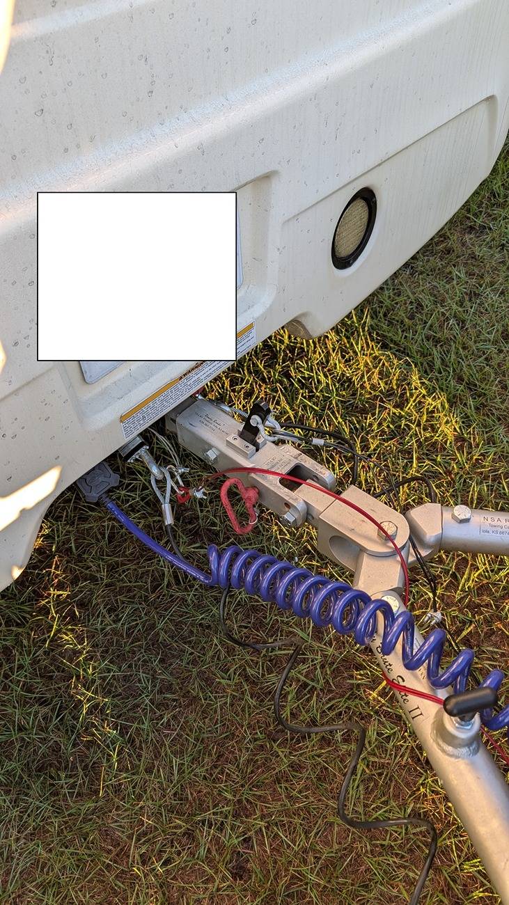

I have a question about the charge line. Is it grounded through the tow bar or a separate ground wire? I’ve towed twice without a charge line but they were 3 hour stints. I’m heading off tonight after work and will be dry camping half way on a 900 mile treck. I don’t want to chance discharging the Bronco battery.

It's grounded through the tow bar, or really through the motorhome. Just to be on the safe side, I have unhooked everything overnight when I have stopped to sleep at Walmarts or rest stops . I agree that the clevis expense was quite high, but the folks at NSA were very helpful, so I didn't mind throwing some extra money their way. Since I sent exact measurements to them, the fit was quite tight, so didn't need to put bushings in. I actually needed to work the pins a bit with a hammer a few times to loosen them enough to work them by hand. I am quite happy with the setup, so if you have any additional questions, please let me know! Appreciate the kind words.

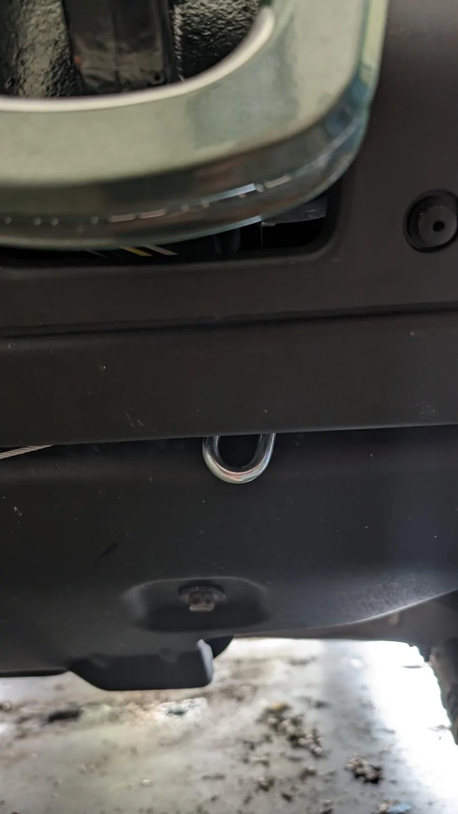

Nice work! When you installed the LoD brackets, did you have to do any drilling? I read something in another post about having to enlarge some of the frame mounting holes.

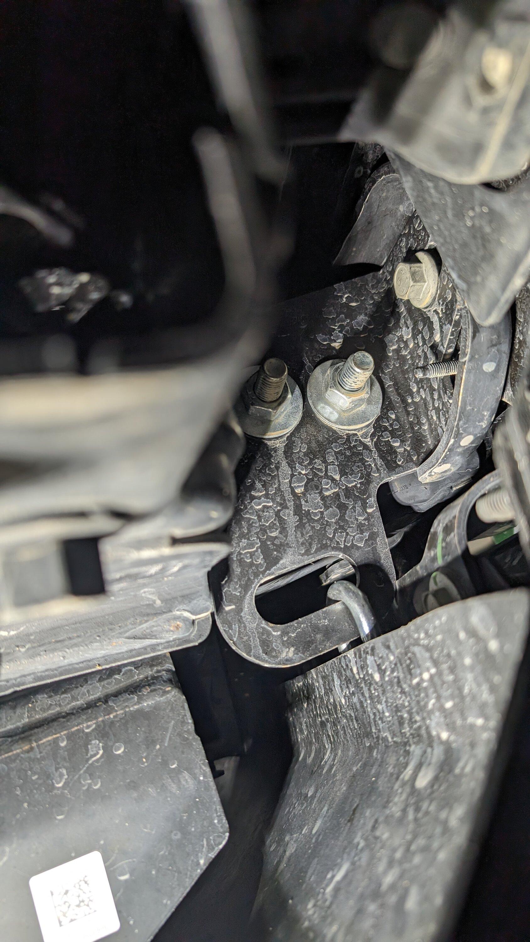

Thank you! Yes. I did have to do a bit of drilling. It was easy enough to get the cordless drill up in there to enlarge the existing holes a little bit. If I remember correctly, I think I drilled on additional hole for each bracket as well as part of the install. You definitely need to remove the skid plate (4 bolts) when putting them on, there is not much room to work with as it's a tight fit.

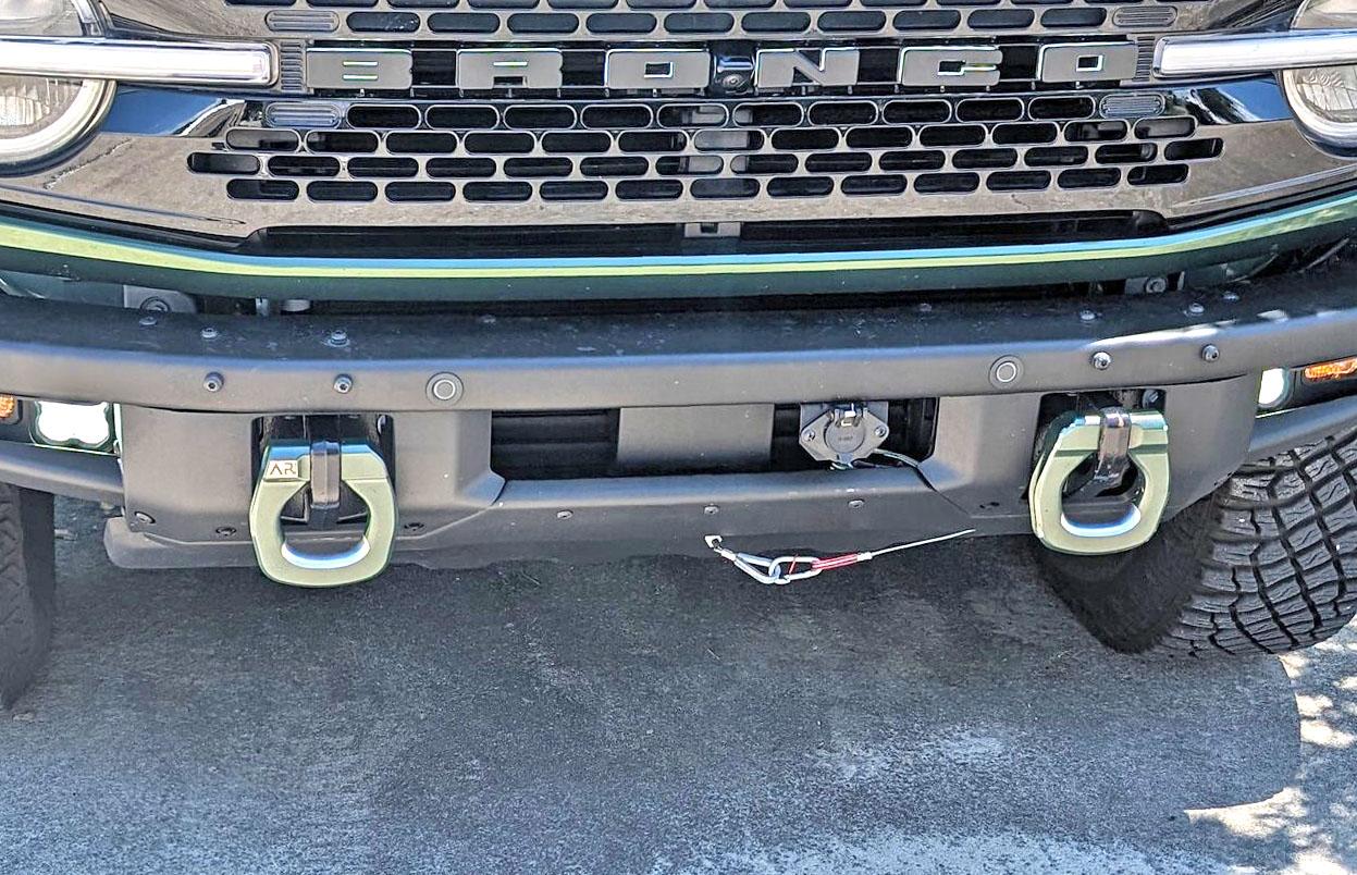

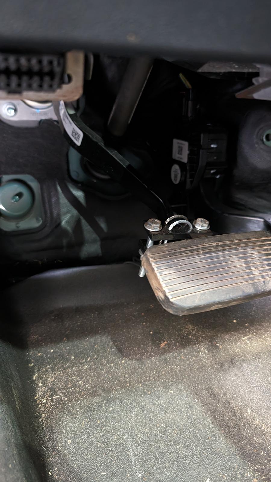

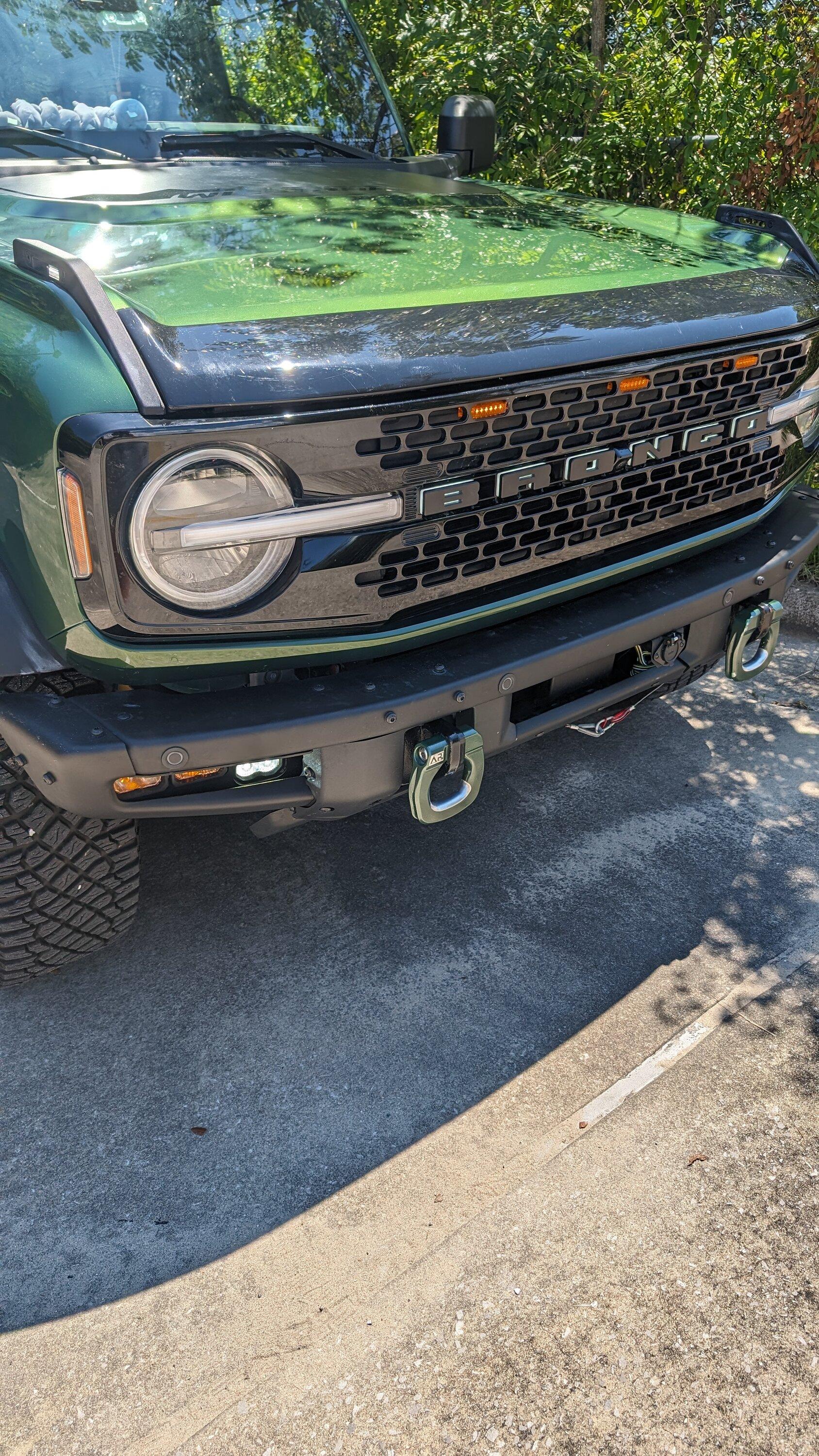

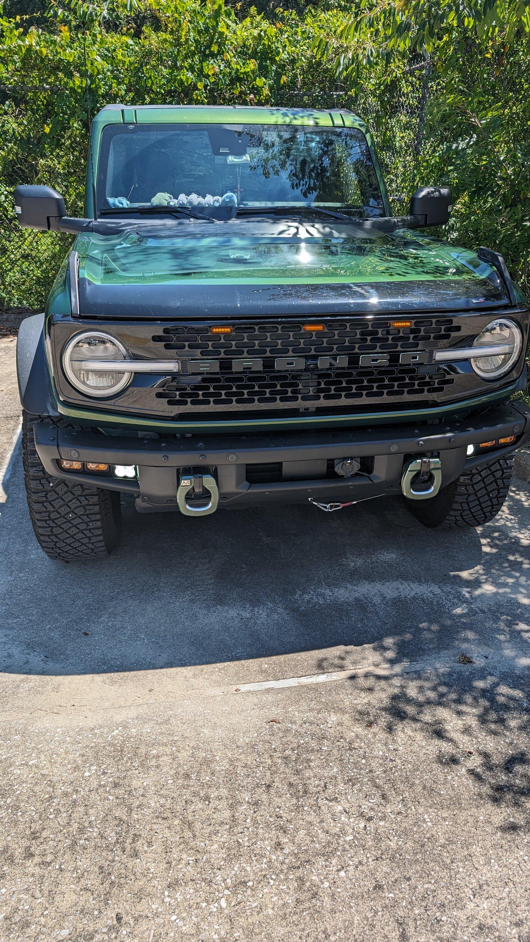

It was not too bad running the brake cable from the pedal to the front of the vehicle. You want to try and keep it as straight as possible when working your way up to prevent the possibility of kinking the wire. See the pics below to see where I went through the fire wall and were the cables ended up at the front.
Yes, I take the D rings off when I know I am going to flat tow. The clevis's hook up to the same spot my D rings are at in the photos.

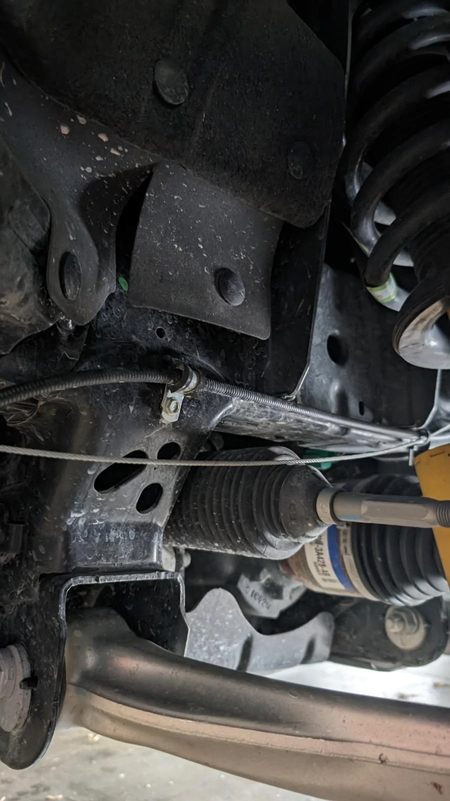

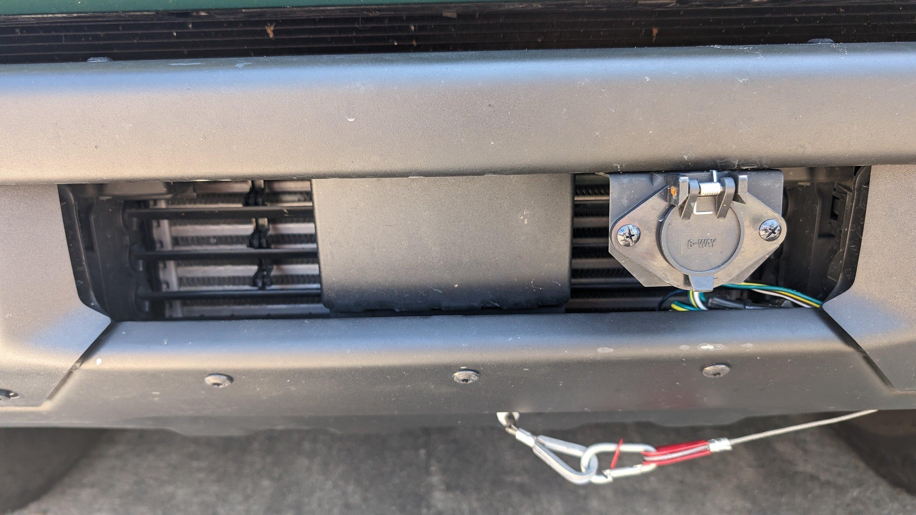

This pic shows where the emergency brake away cable comes out. The reason it is going to the left in this photo as when it's not connected to the motorhome, I just hook it up to the brake cable for storage as you can see in the other photos. it basically comes out, between the skid plate and below the tow hooks. As a bonus, you can see the quick connect links I connected to the LOD brackets to help connect the safety chains.
Ford Bronco Ready Brute Elite II flat tow setup PXL_20240523_131622178.NIGHT

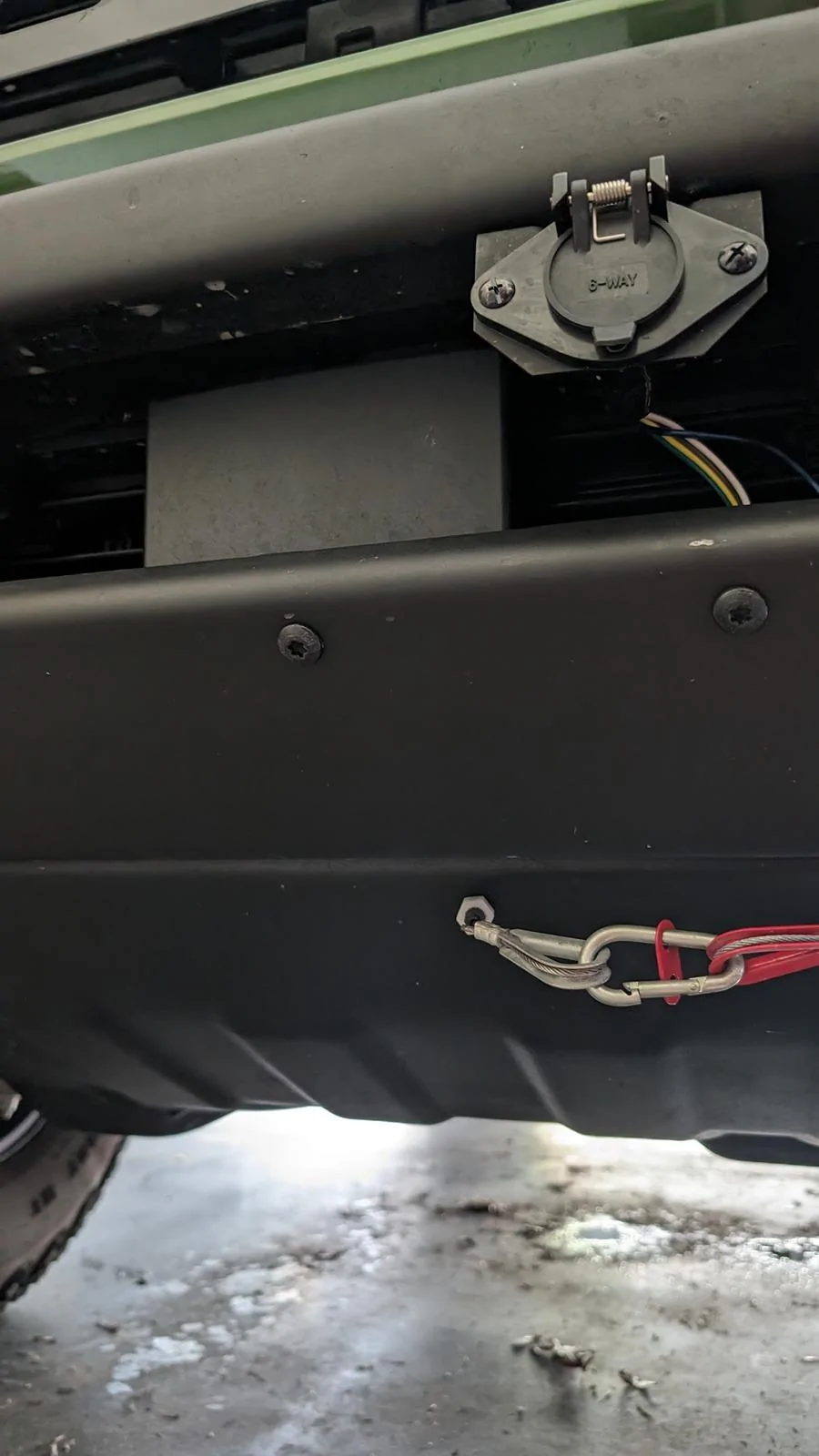

This photo shows were I mounted the 6 way pin and where the brake cable comes out at the front. I drilled a hole in the skid plate basically in the center of the bronco. Also, as you can see the emergency brake away cable is attached to it during storage.
Ford Bronco Ready Brute Elite II flat tow setup PXL_20240523_131639501.NIGHT

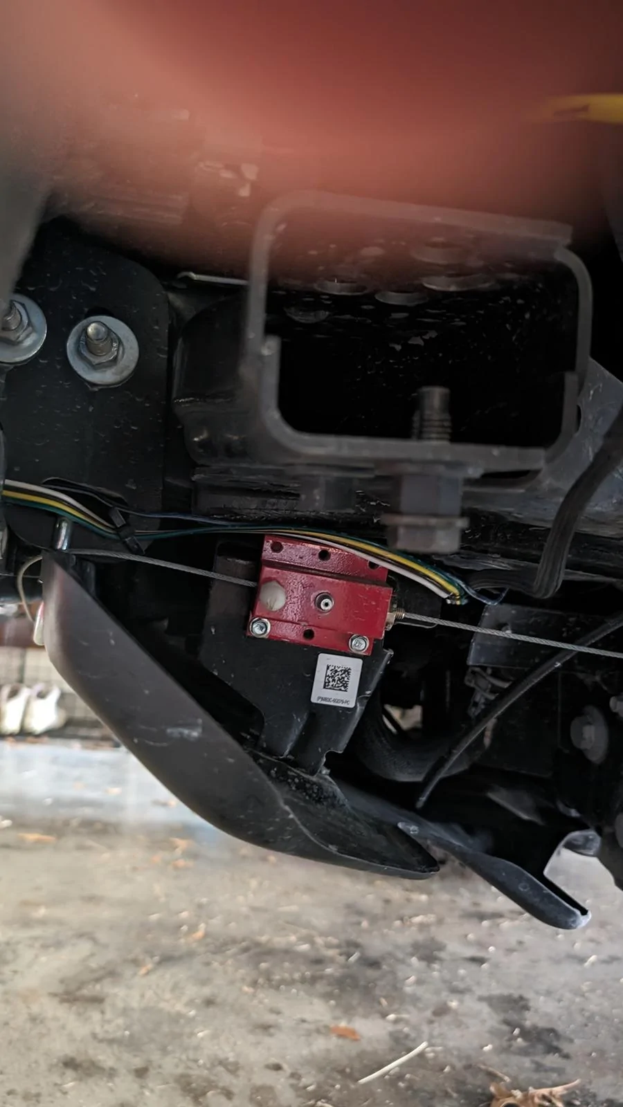

This is a side view showing where the emergency brake away box is mounted. Under the crash bar and above the skid plate. from there it runs straight back to the fire wall and brake pedal.

This one shows a little further back, the top wire is the brake cable, and the one below it is the emergency cable. I am basically following the frame back to the brake pedal. After I took this photo, I added another loose zip tie to the two cables so the emergency cable does not dip down so far.

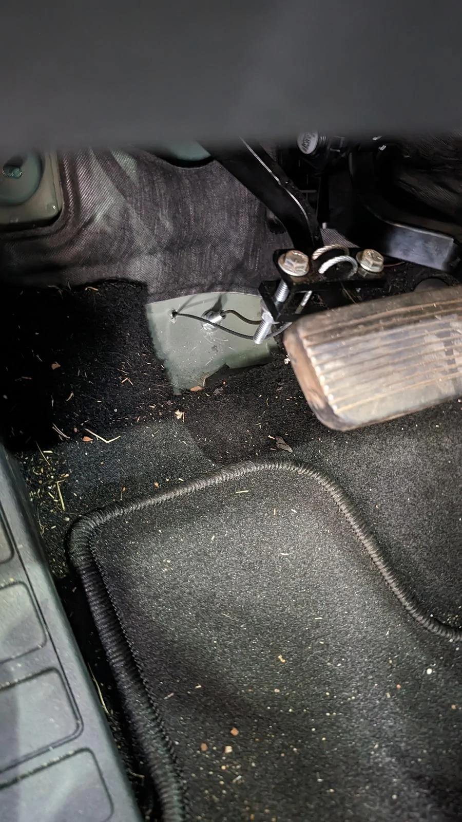

This one shows where the two cables come through the fire wall into the cab and connect to the brake pedal. I took the weather tech floor mat out for the photo. The left wire is the emergency brake away, and the right one is the regular brake cable.
