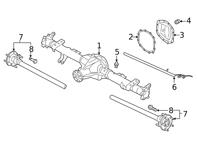

Had to order a left side axle for a 2019 Ranger the other day just to get the axle seal.
I sure hope later on down the road Ford offers these seals as an individual piece.
$649.95 is a lot of dough when all you need is the seal.Once the vehicle is out of warranty I would think the aftermarket would have a solution.This was a locker btw,assuming the Bronco will share the same style axle.
Just thinking out loud here,not trying to scare anybody.I just wonder sometimes what engineers are thinking.

Where did it leak out of? Did ford say anything about it? Thanks for the heads up BTW

The tech said the o-ring style seal was leaking pretty badly,not sure if maybe it was nicked during assembly or what.Very low mileage unit,he did say that the seal could have been replaced if it was offered that way,and perhaps Ford will offer the part by itself down the road.I am sure the aftermarket will in time too.

That does not seem right. What model is the axel? Heck for that price I would just use some marine grease & call it a day. That stuff is like silly putty & has fixed more than one leaky axle on the trail ;)

The new Ranger axle is made by Dana it is no longer the sterling 8.8 I believe the Bronco will also be Dana Advantek.I hope as the design evolves will will see separate components available.Time will tell.Here are some interesting features to check out.https://www.therangerstation.com/ranger-tech/dana-advantek-axles-ford-ranger/

This might be more of what's at issue for the OP. Dana has the seals, but they're not willing to sell them to Ford individually. Ford has to purchase the complete axle assembly from Dana.
