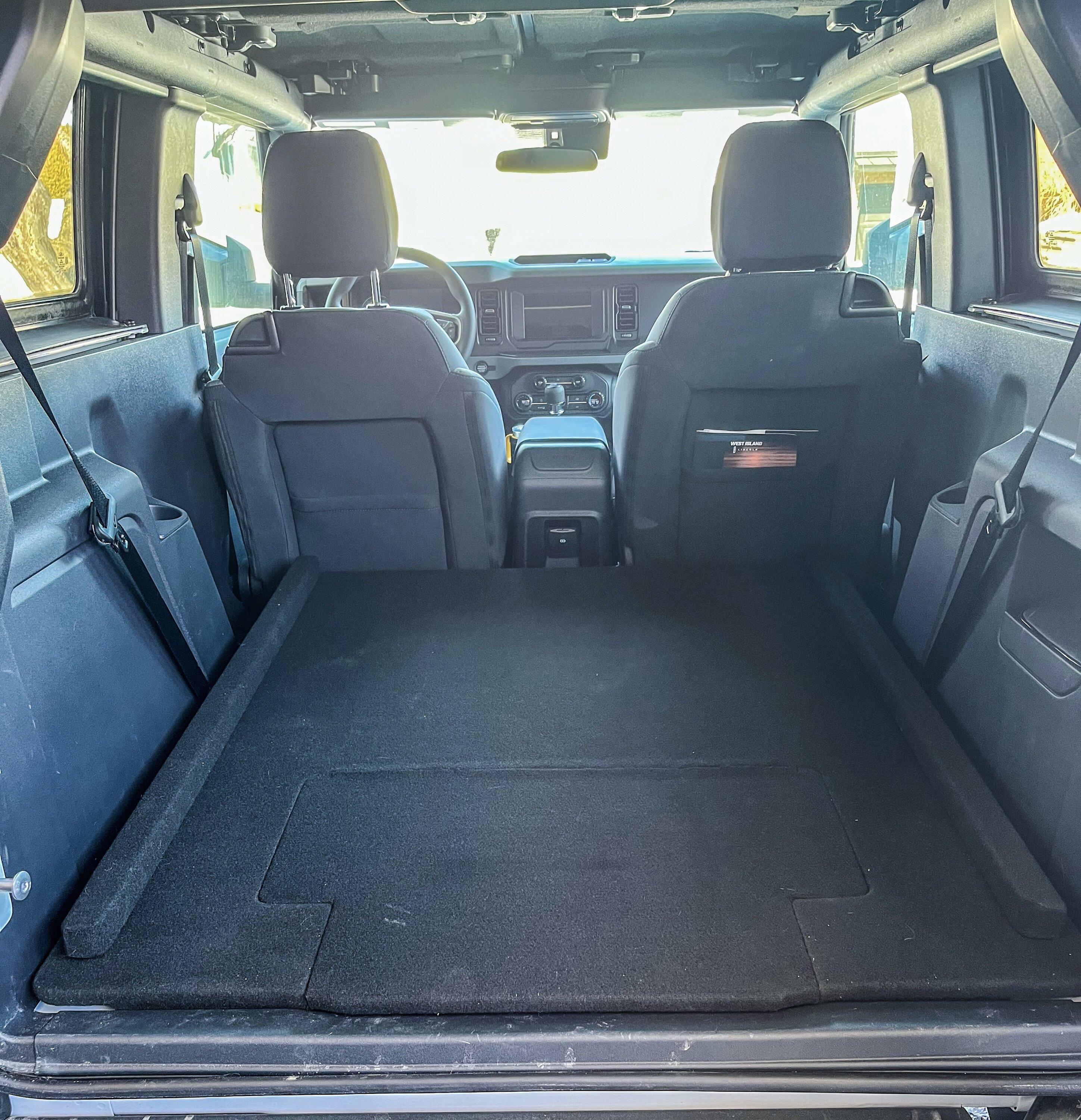

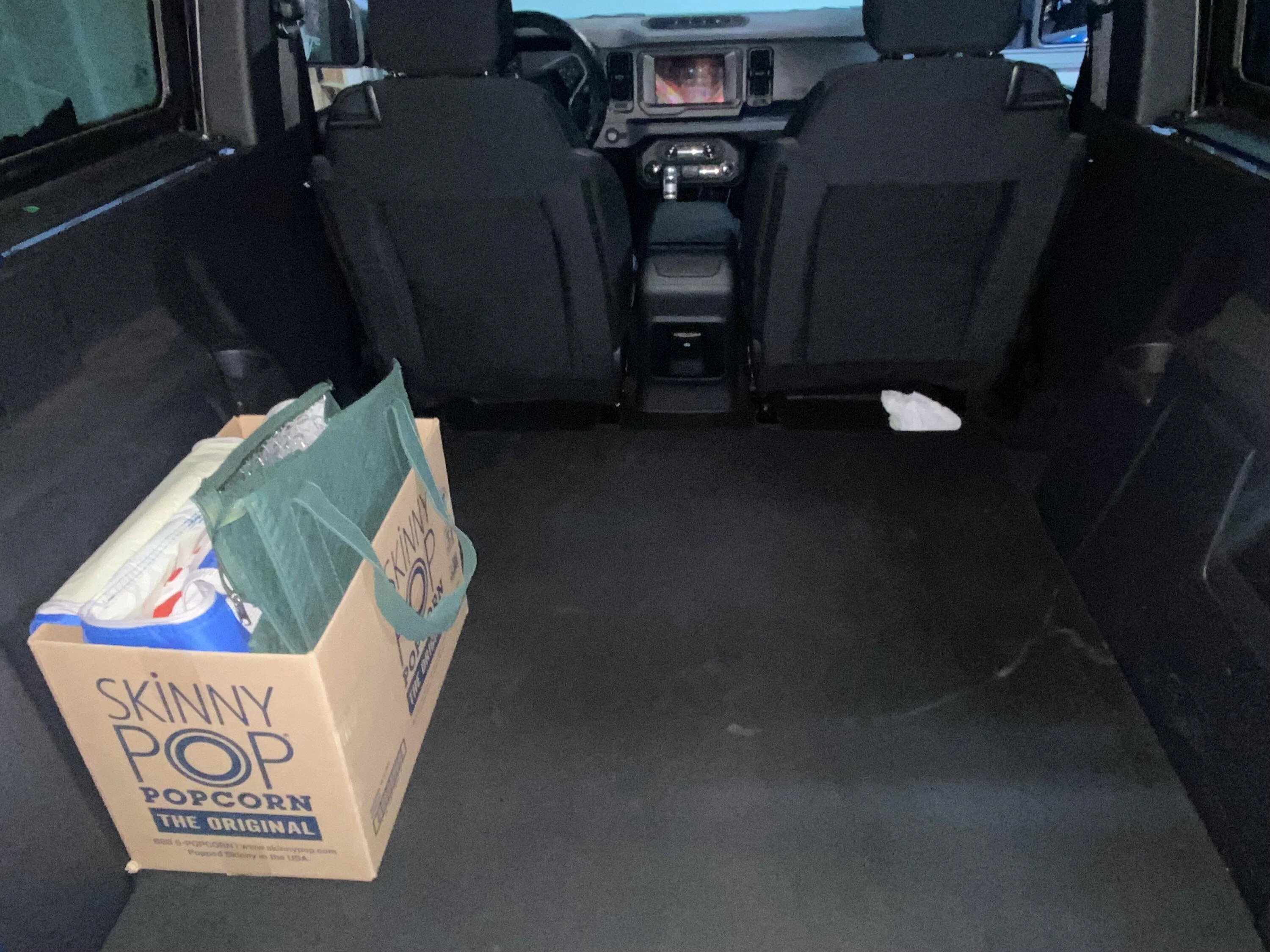

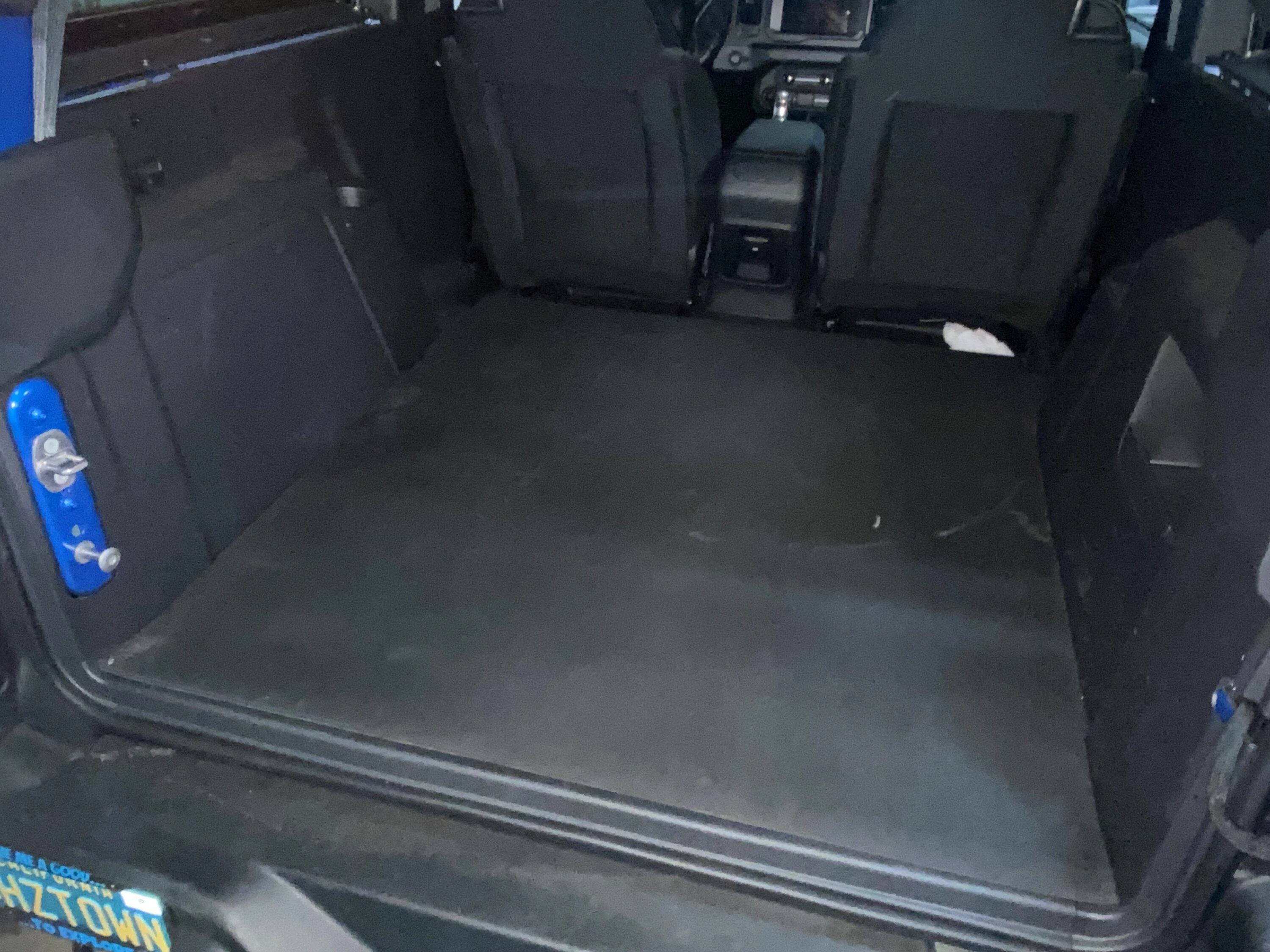

This thread inspired me to move my ass and get it done. build a base level with under-floor access and will be adding a second deck 12” higher that’ll match the sides shape all the way to the front and give me a locked down area for when the roof is off.

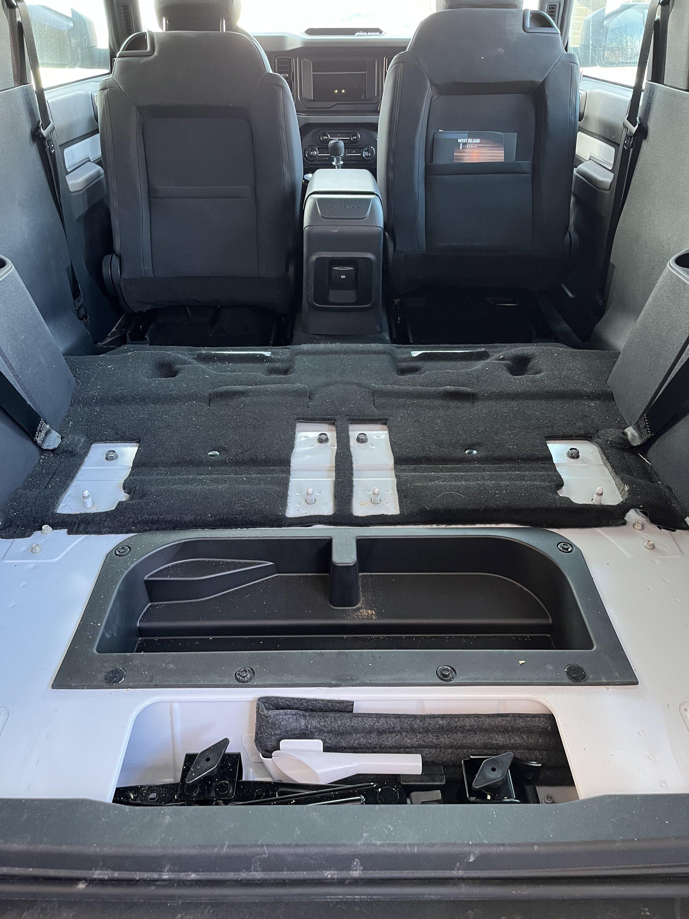

Well, I did the first stage of my seat removal took them out!
Trim the studs down to the height of the nuts put two pieces of rubber that usually lines toolboxes in work trucks flipped upside down.
Next stage is to build a platform with storage for a woofer and tools and things
But this will get me by for now

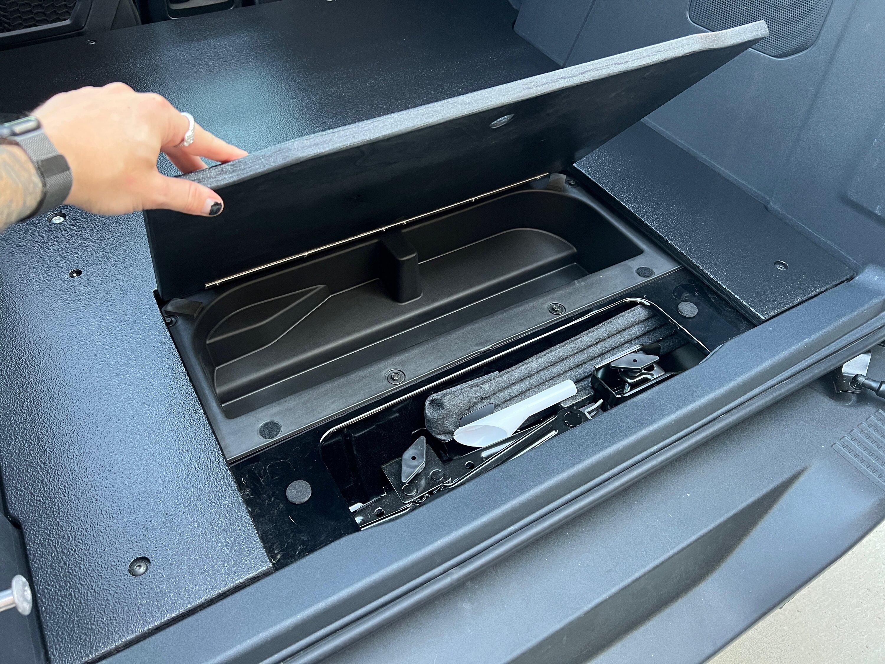

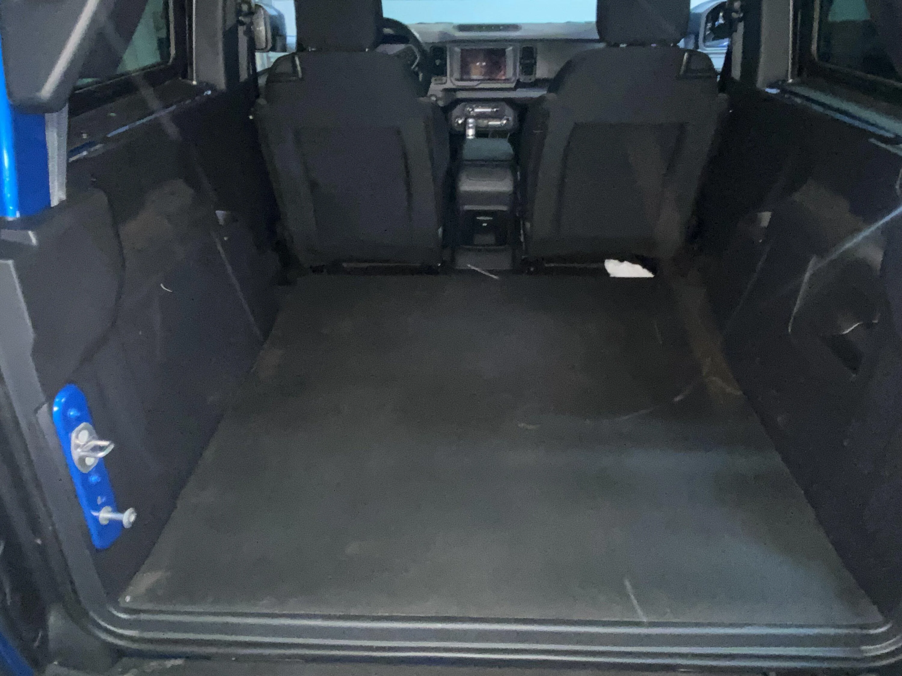

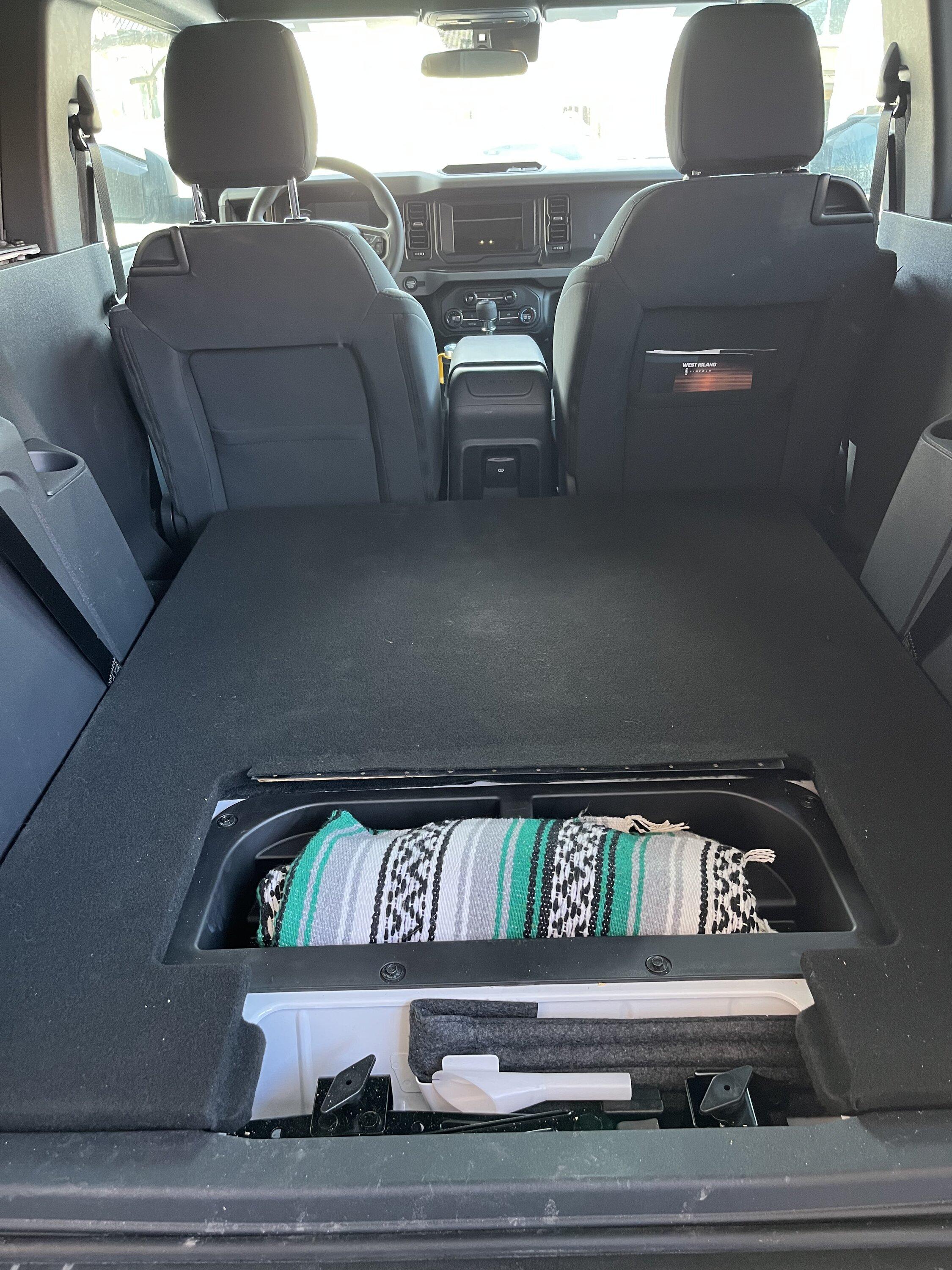

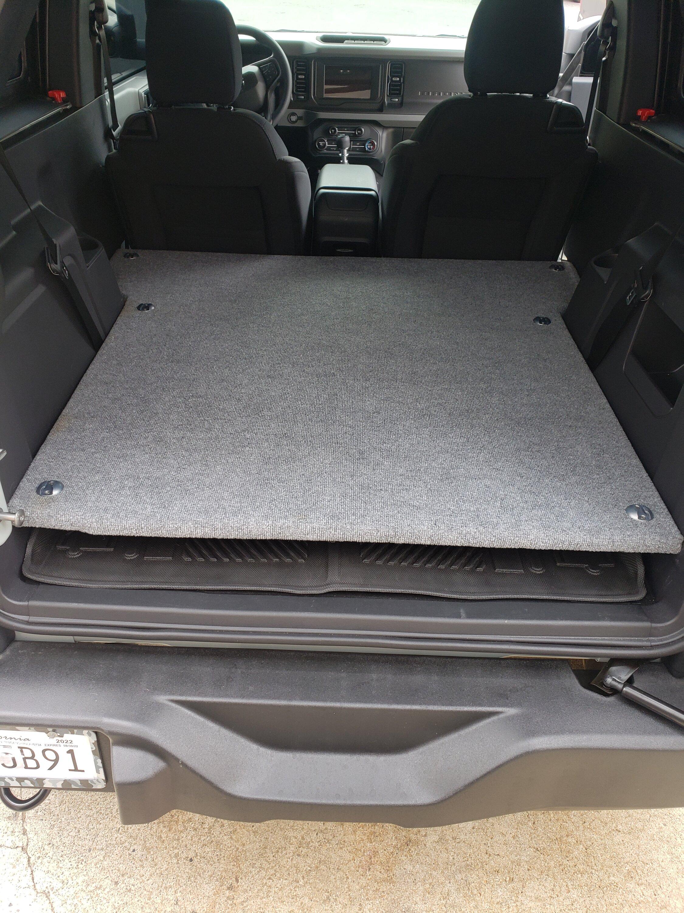

Nuked my back seats on my 2-Door and made a deck from wood to fit the contour. The deck fit just fine from the front to the back with out bolting down. Between the bolt tops, side seatbelt brackets and the rear tailgate lip it just fit level. Covered in a Lowes outdoor 5x7 rug cut down to fit. I have a working trapdoor that just needs just cut out that the carpet is still covering. Simple KISS design. Had to unbolt the speaker to get it through the back door.
Cheers,
HD
Great idea cargo space is so limited in the 2 door, I wish I would have thought about this before I got a 4 door!
