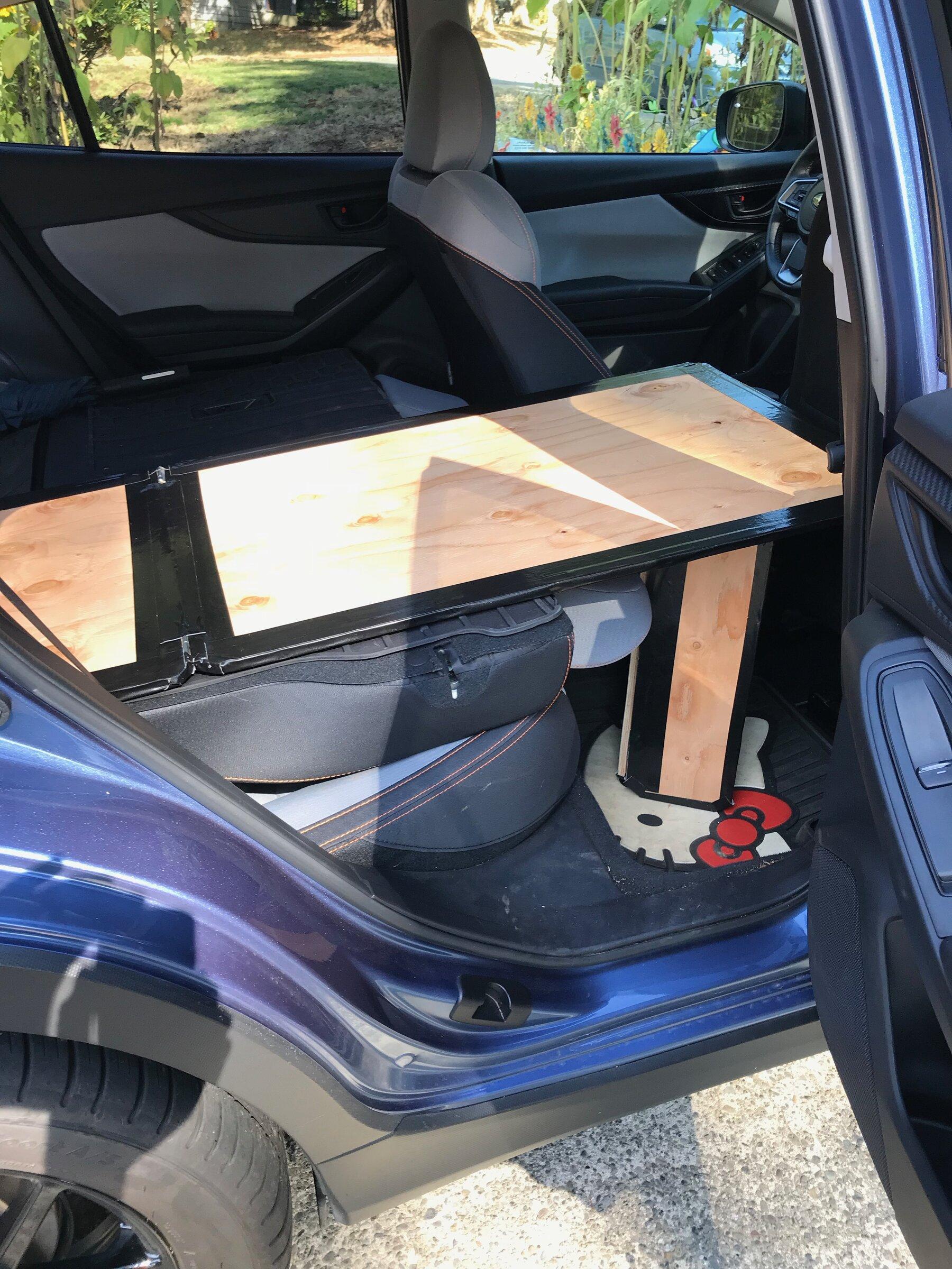

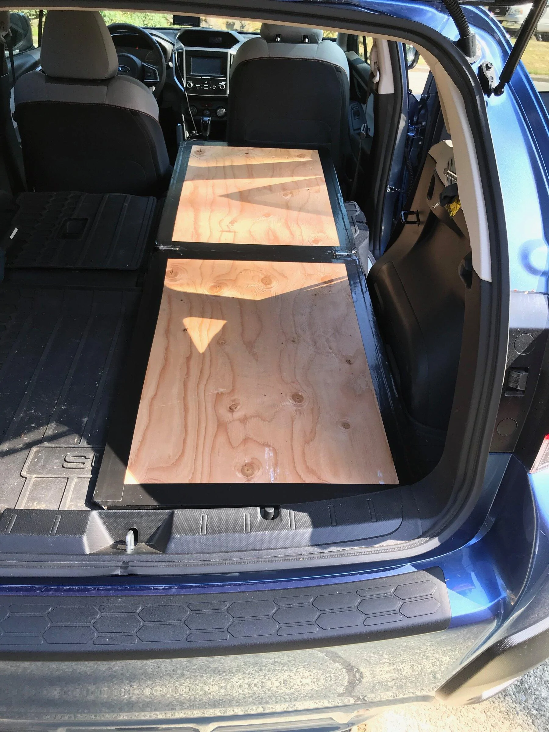

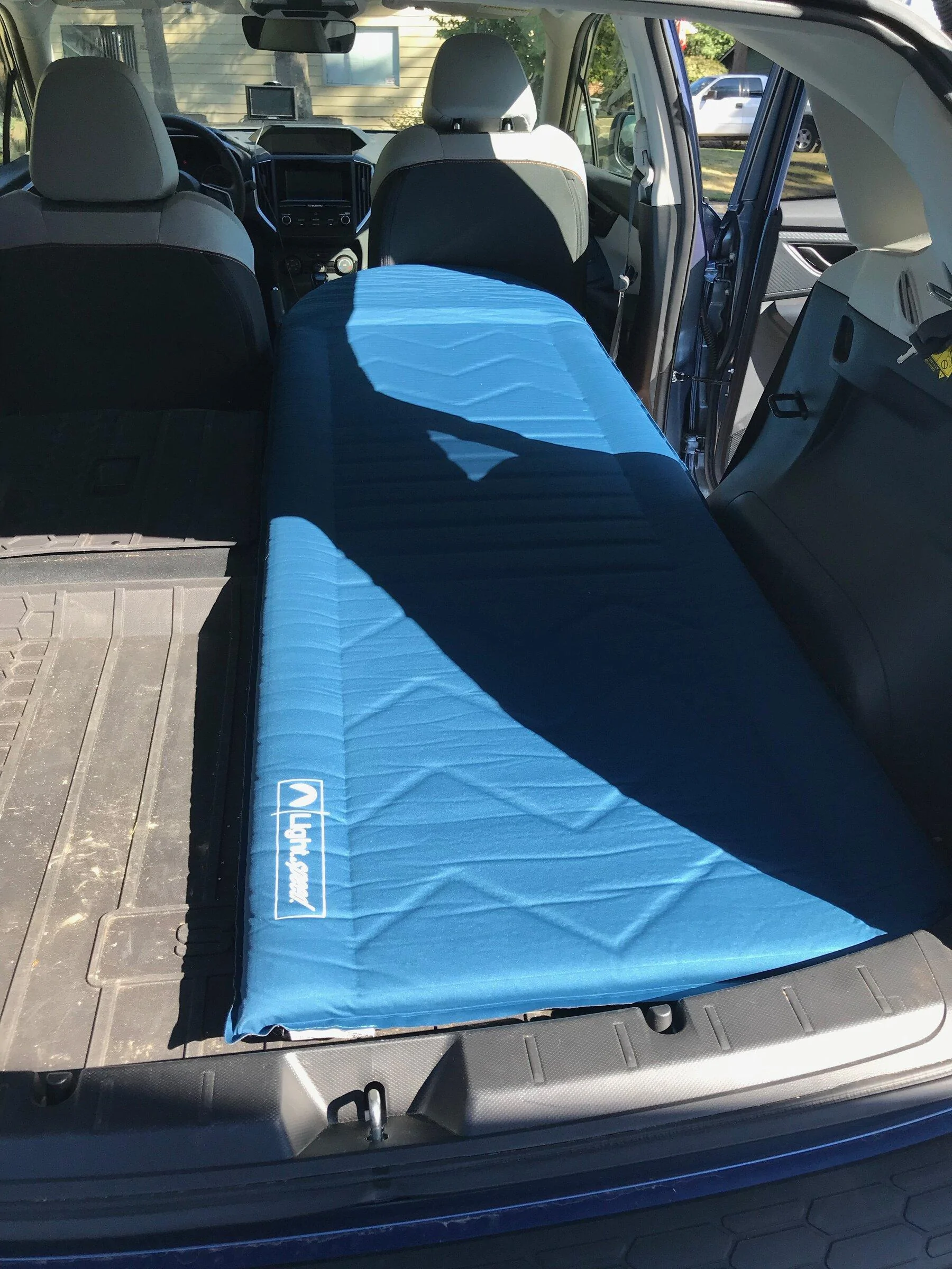

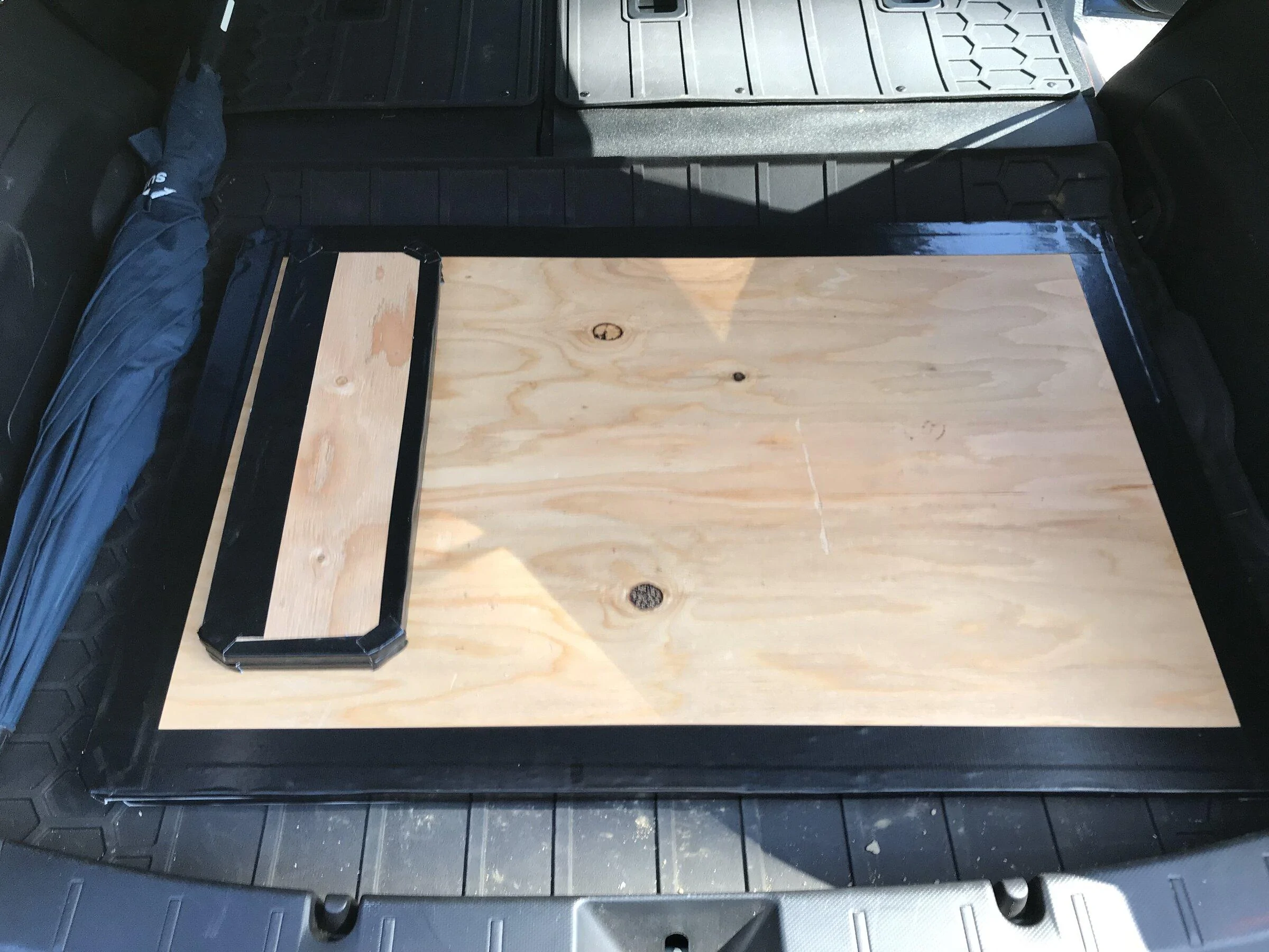

I really like it, I think it looks great. But I wonder about tie downs. Are you going to access the ones in the rear cargo area?
I made something somewhat similar so I could sleep in the back of my Subaru when out in the woods.
It folds right up and stows behind the seat.
