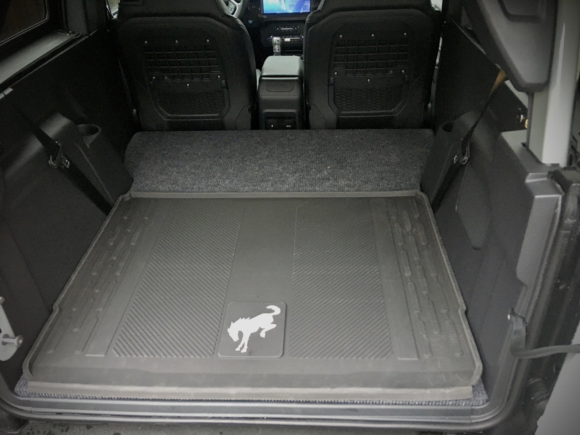

This is the fit of the back mat for the 4-door bronco in my 2-door. The fit is just right to the contour of the back. I added it to have an area that I can put wet muddy stuff from hunting and fishing. The part by the tail gate still has some memory from the shipping and will flatten out just fine once some heat hits it.

Nuked my back seats on my 2-Door and made a deck from wood to fit the contour. The deck fit just fine from the front to the back with out bolting down. Between the bolt tops, side seatbelt brackets and the rear tailgate lip it just fit level. Covered in a Lowes outdoor 5x7 rug cut down to fit. I have a working trapdoor that just needs just cut out that the carpet is still covering. Simple KISS design. Had to unbolt the speaker to get it through the back door.

This is EXACTLY what I want to do with mine. Can you message me information, possibly? Need the details! My guy can do this, but details would be helpful! I will take down what I can from the rest of this thread. Looks perfect!

You did an amazing job! You could prolly sell this as a kit, or, at least a DIY Template project. I really like that it's not bolted down. Nicely done!!

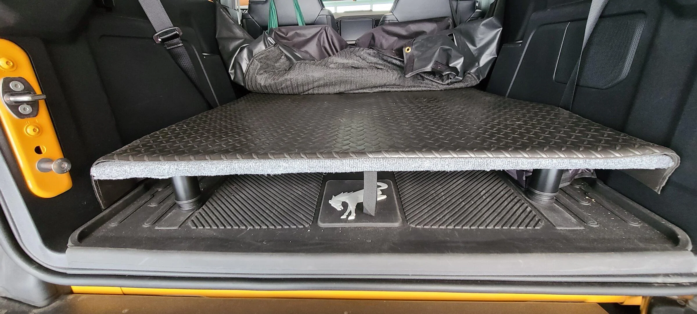

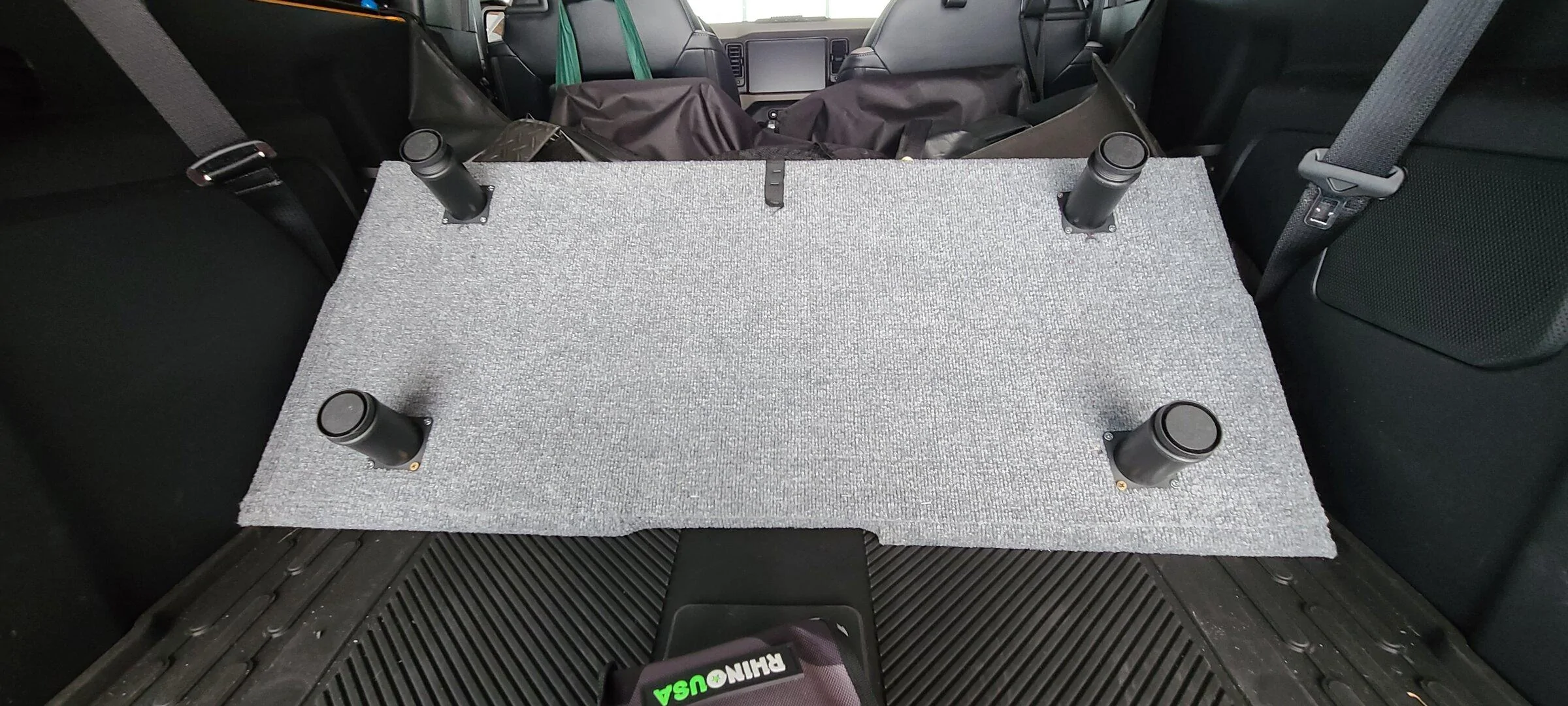

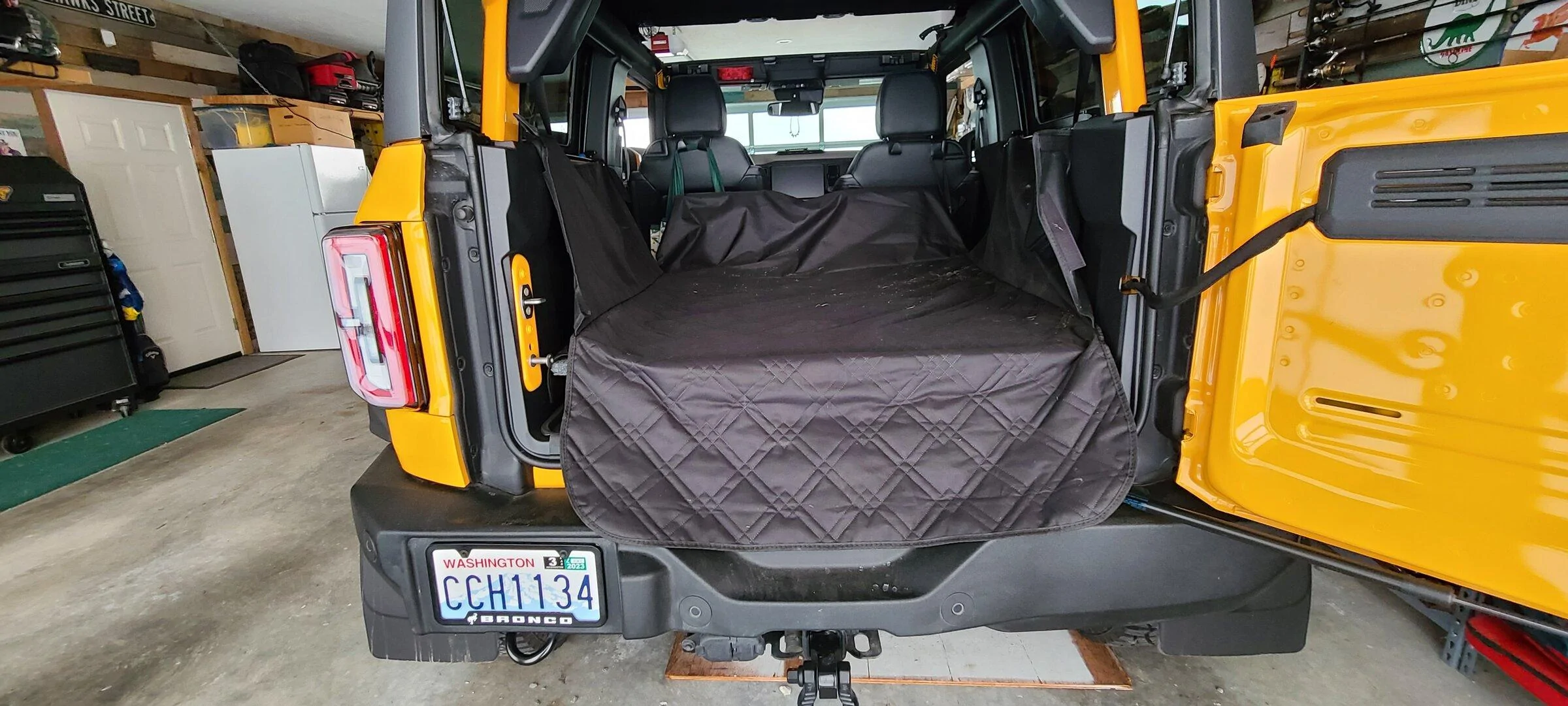

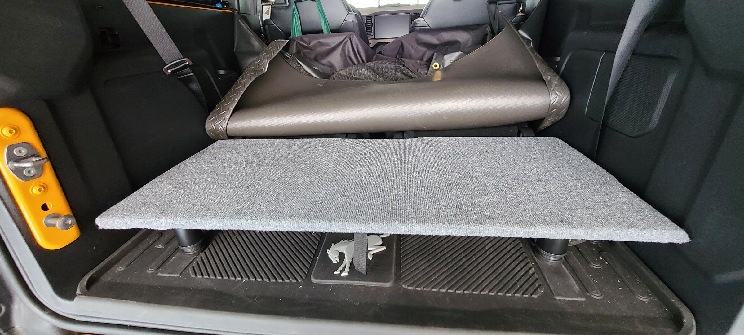

Ok...here ya go:
First pic shows platform with the full cargo length rubber dimond zee mat on top: (provides padding when crawling around in there)
Second pic shows carpeted platform:
Third pic shows carpeted underside of platform with 5" legs.
Over all of that, I installed the Mabett cargo/pet liner. I installed grommets in the cargo liner, and bungee them to the GPCA Quick Release T-Handles.
Makes for easy clean-up (grass and dirt from golf shoes, bag, battery operated caddy cart, etc.). Able to stow small things under the platform (roof panel bag, foldable shovel, first aid kit, golf balls, etc).
See...it happened!

Looks awesome BTW! 👏🏼👏🏼 I like the legs and looks easy for a quick removal.

What are the dimensions of the platform?
Cat
Cat
Jul 26, 2020
3,405
8,056
Whidbey Island, WA
MB500SL, HD Road King Custom
Owwwlick40
O
Mar 16, 2022
Toyota Corolla LE
Plywood dimensions: 3/4” board cut to 20”x18” (they’ll do it for you at many hardware stores)
Marine grade carpet $12
These legs purchased from Amazon: https://amzn.to/3mN7gQY
Going to give this a shot. Thanks!
