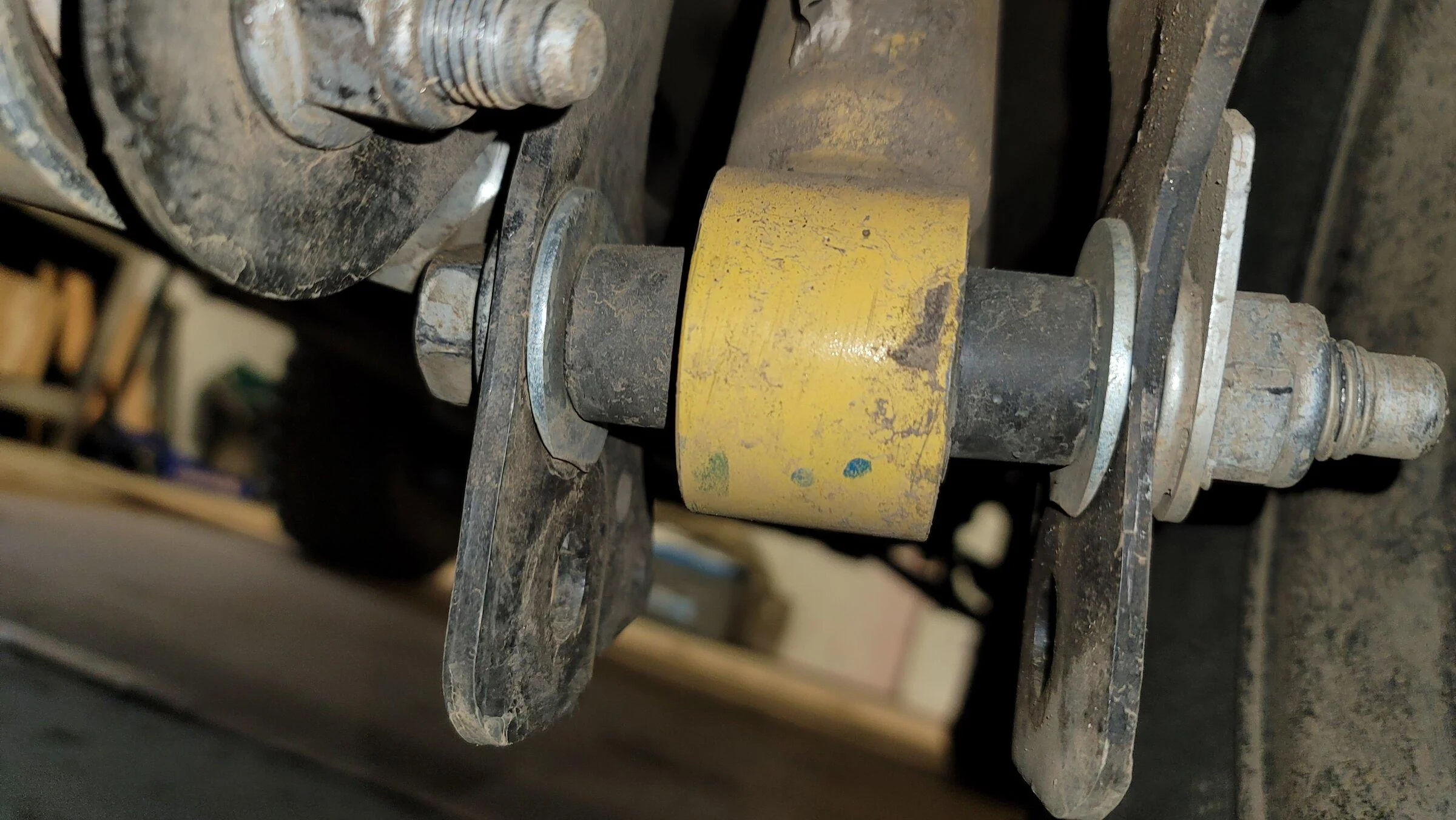

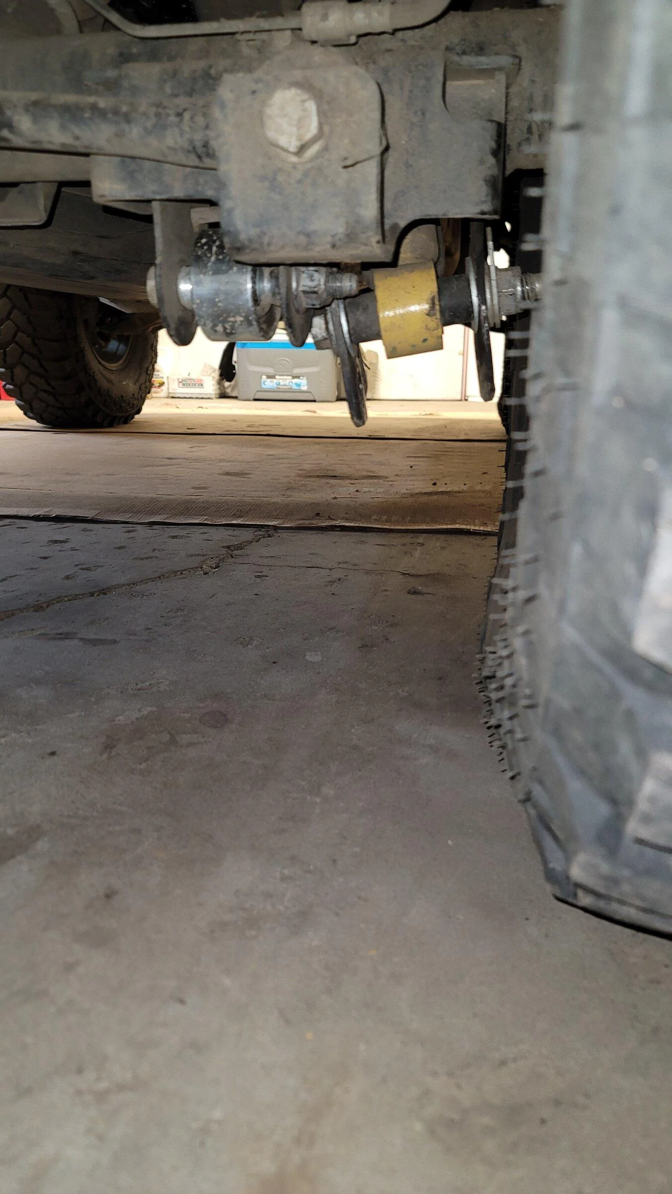

Most of them Ive see are a joke! They just hang down even LOWER with the extra protection! NO THANKS!
I just moved my shock mount up for 2” lift and 2” more ground clearance! Next I'll hack off 2” and weld a plate FLUSH on the bottom....
I'd rather spend $50 on a drill bit and kill 2 birds with one stone, than buy some overhyped doo-dad that actually do virtually nothing beneficial for my truck.

It works fantastic ! Easy way to lift and gain ground clearance. It seems to me the upper rear control arms are the limiting factor nin the rear articulation at this point. Looking at rock jock uppers for a quick fix...long-term fix is to toss the panhard rod in the trash and triangulate the rear upper control arms together into one w/one center mount on the top of the axle.

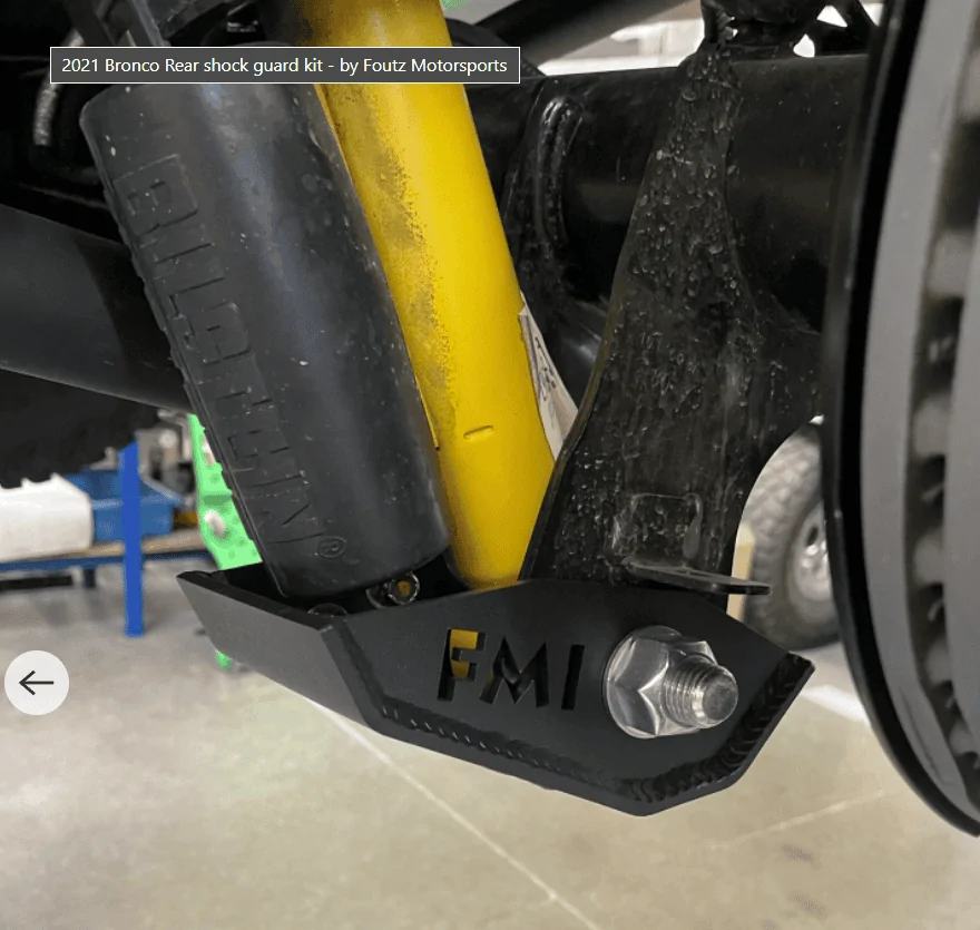

I really like that idea, looking forward to updates. For now going with bolt-on. Foutz has their shock skid plates in stock. Ordered yesterday and they already shipped! I compared all the brands, I liked the way these had multiple angles, looked like they'd skid well.
https://www.foutzmotorsports.com/co...nco-rear-shock-guard-kit-by-foutz-motorsports

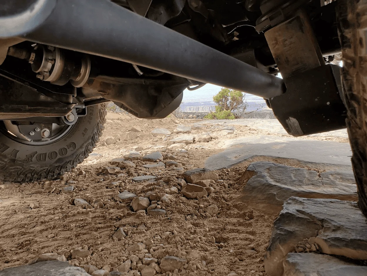

I have the Valkyrie rear shock skids and they worked well. I banged the hell out of both sides in Moab this week where I definitely would have bent the mounts around without the guards. This pic was near the top of Top of the World on day 1 (half way), day 3 had much more hits.

The FMI ones look very nice. I don't recall seeing them available at the time I ordered mine.
