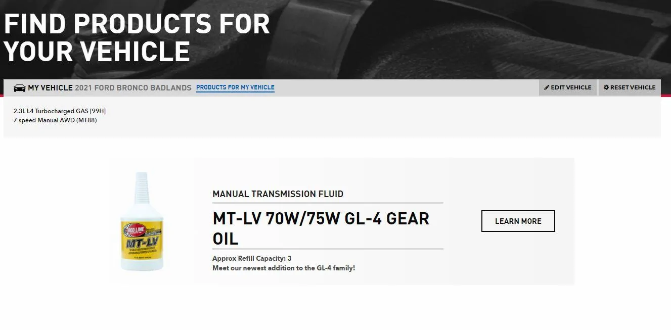

I would like to replace the transmission oil in my 7MT with Red Line Oil's gear oil. Their website recommends the MT-LV 70W/75W GL-4 GEAR OIL -- has anyone else tried this out yet? I have had fantastic results using Red Line Oils in prior transmissions, and my Bronco's 7MT feels kinda dry/notchy.
If you've replaced your 7MT with this stuff or another Red Line Oil product, I'd love to hear your feedback.
Thanks!

I just flushed out the fluid at ~1700 miles. The redline MT-LV definately feels better when shifting! That subtle grindyness when shifting now feels like a a positive bump when going into gear. I'm happy I made the switch.
For what its worth, it was a very easy procedure. Nothing interfered with the job, just a straight drain then fill situation. took about 40 minutes including cleanup -- Nice!
