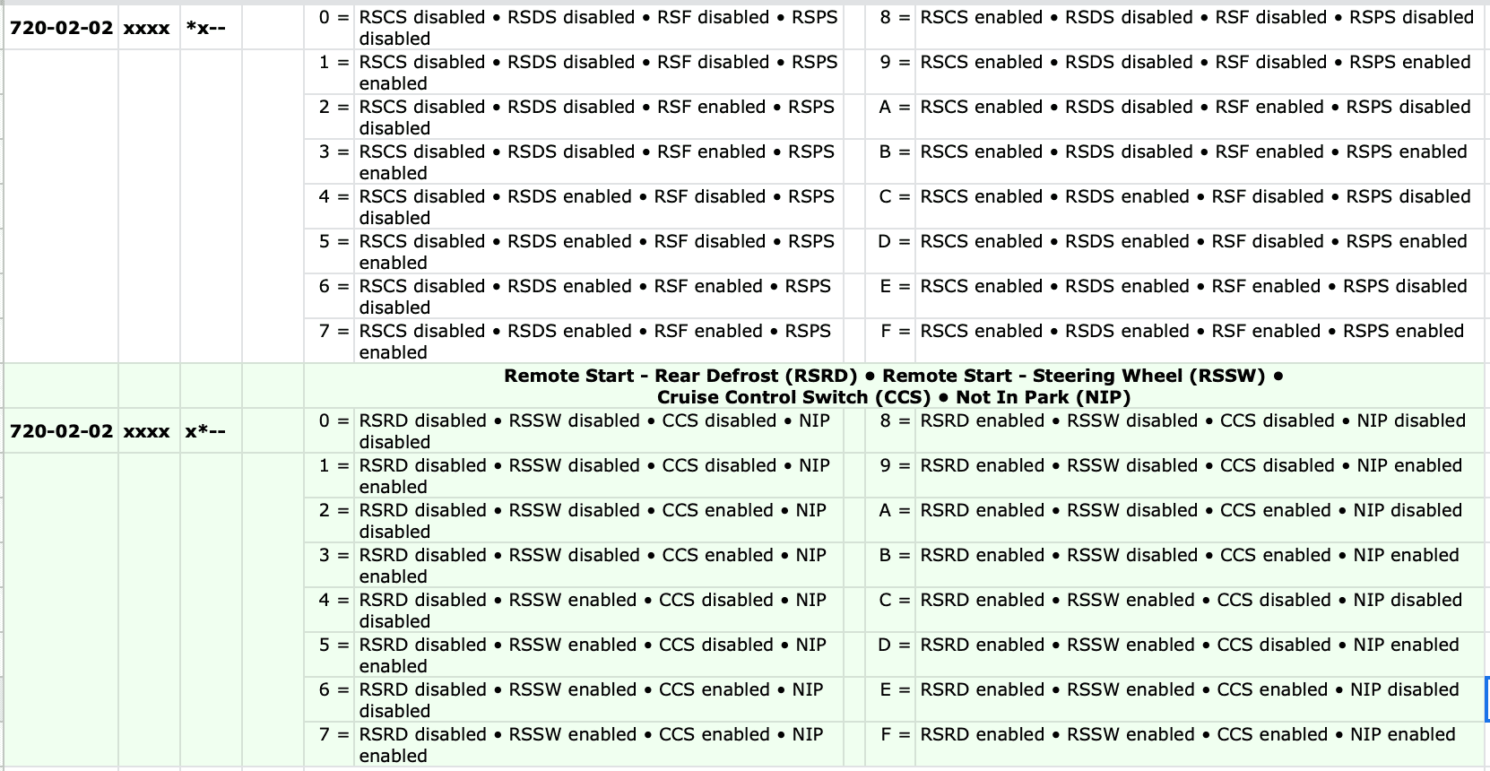

So far, from the 2015-2020 F150s spreadsheet, here's the remote start options
Ford Bronco Remote Start - Manual Trans using FORScan Screen Shot 2022-01-31 at 12.57.31 PM
Ford Bronco Remote Start - Manual Trans using FORScan Screen Shot 2022-01-31 at 12.57.15 PM

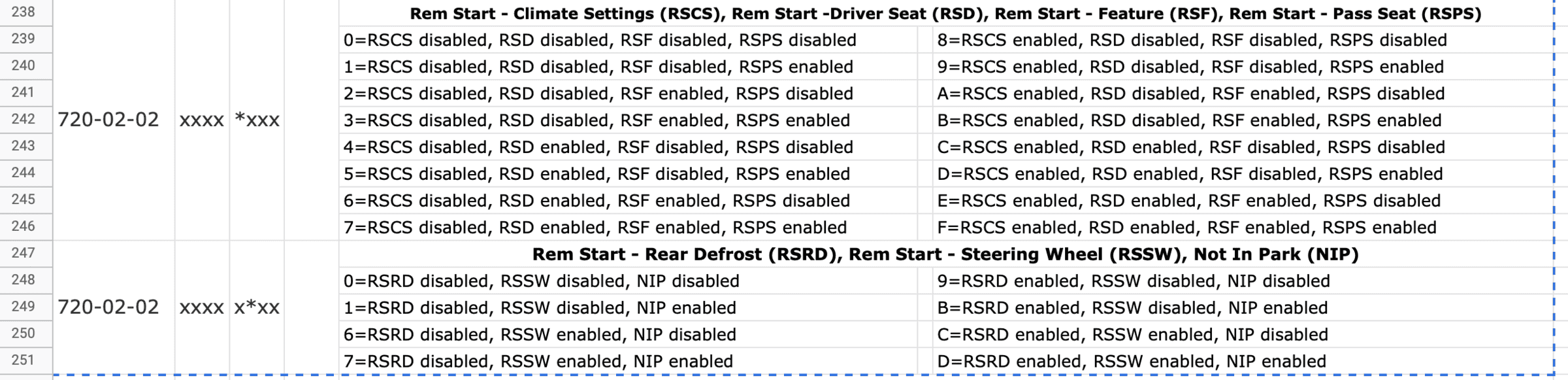

For 2021 F150s, here's what they have:
Ford Bronco Remote Start - Manual Trans using FORScan Screen Shot 2022-01-31 at 1.00.55 PM
My module reads :
720-02-02 0A08 D815
2021 Badlands 2.3 MT ST High pkg
I'm a little confused why for Dxxx, it shows RSCS, RSD, RSDS enabled with RSF disabled. I get why RSF is disabled, but why enable RSCS, RSD, RSDS? Autostart maybe?
For my x8xx, RSRD is enabled, which again I'm not sure why since I don't have remote start or rear defrost (soft top).
If anyone with an automatic reads this, what does your 720-02-02 module read, and what's your build? I'm assuming here 720-02-02 is the correct one based on the F150s, but I'm hoping to find a similar build as mine and compare modules

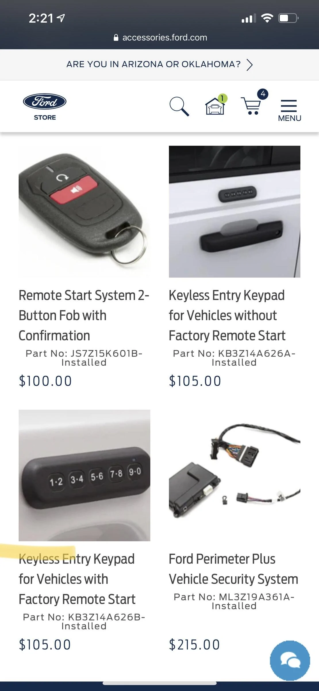

Ford accessories offer remote start kits and keys. I was curious if this is plug and play and if it would work on the bronco manuals.
Supposedly you would need the key and the perimeter plus security system. I am genuinely curious if there’s an east way to add it without going crazy aftermarket systems

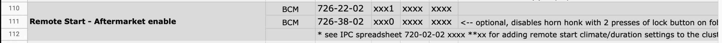

I found a few things in the f150 spreadsheet that look promising, the one in the BCM references above, which I think has to do with the key. but also I found one in the SYNC computer (forget what that’s called) that seems to be linked to the FordPass app. It had the remote start disabled for mine, but I found a base and a badlands with autos and both had remote start enabled on that location.
Once I get a few minutes to actually hook up the computer I’ll test them out
