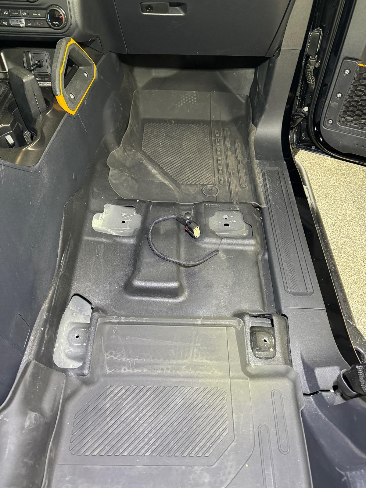

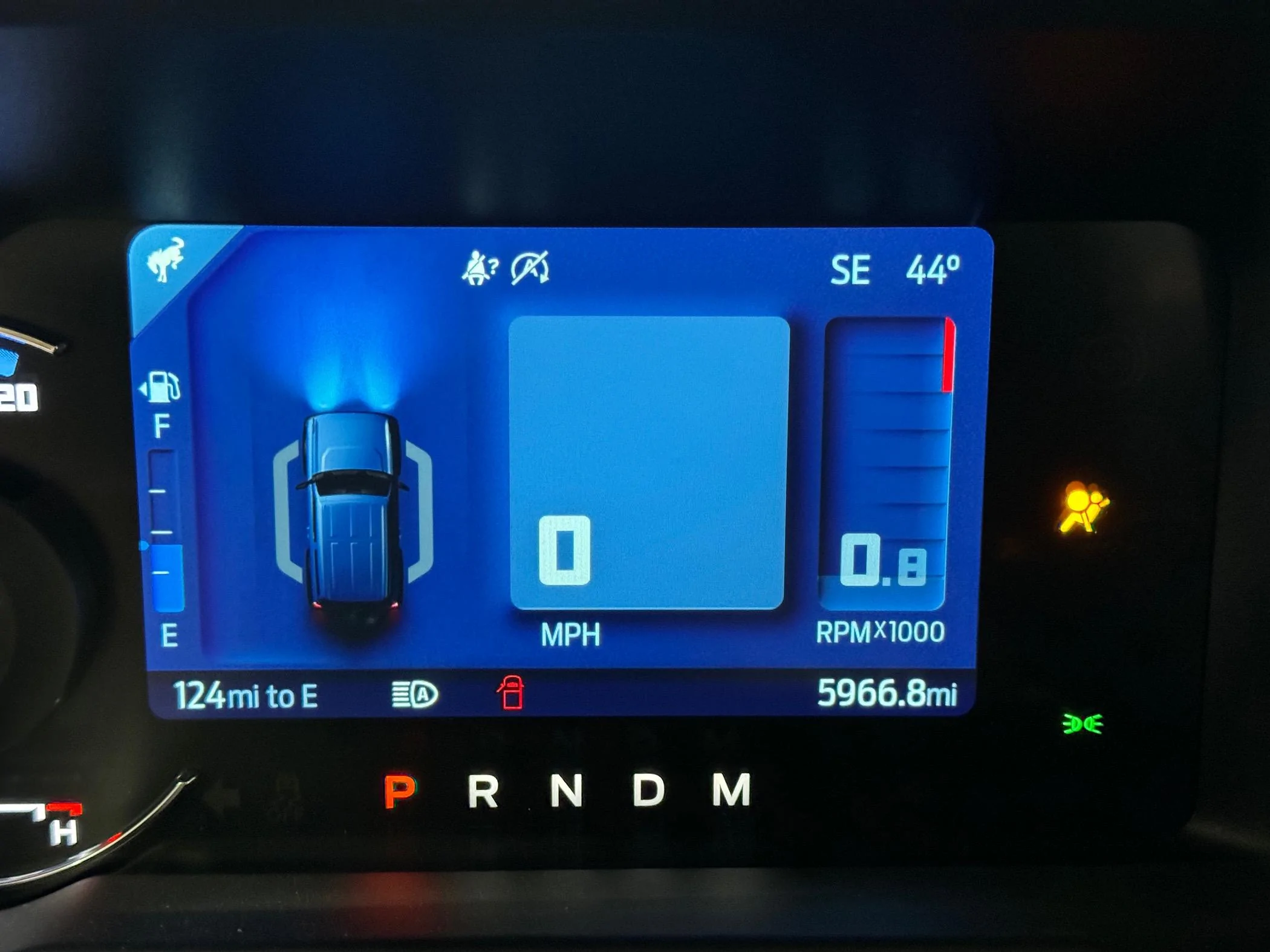

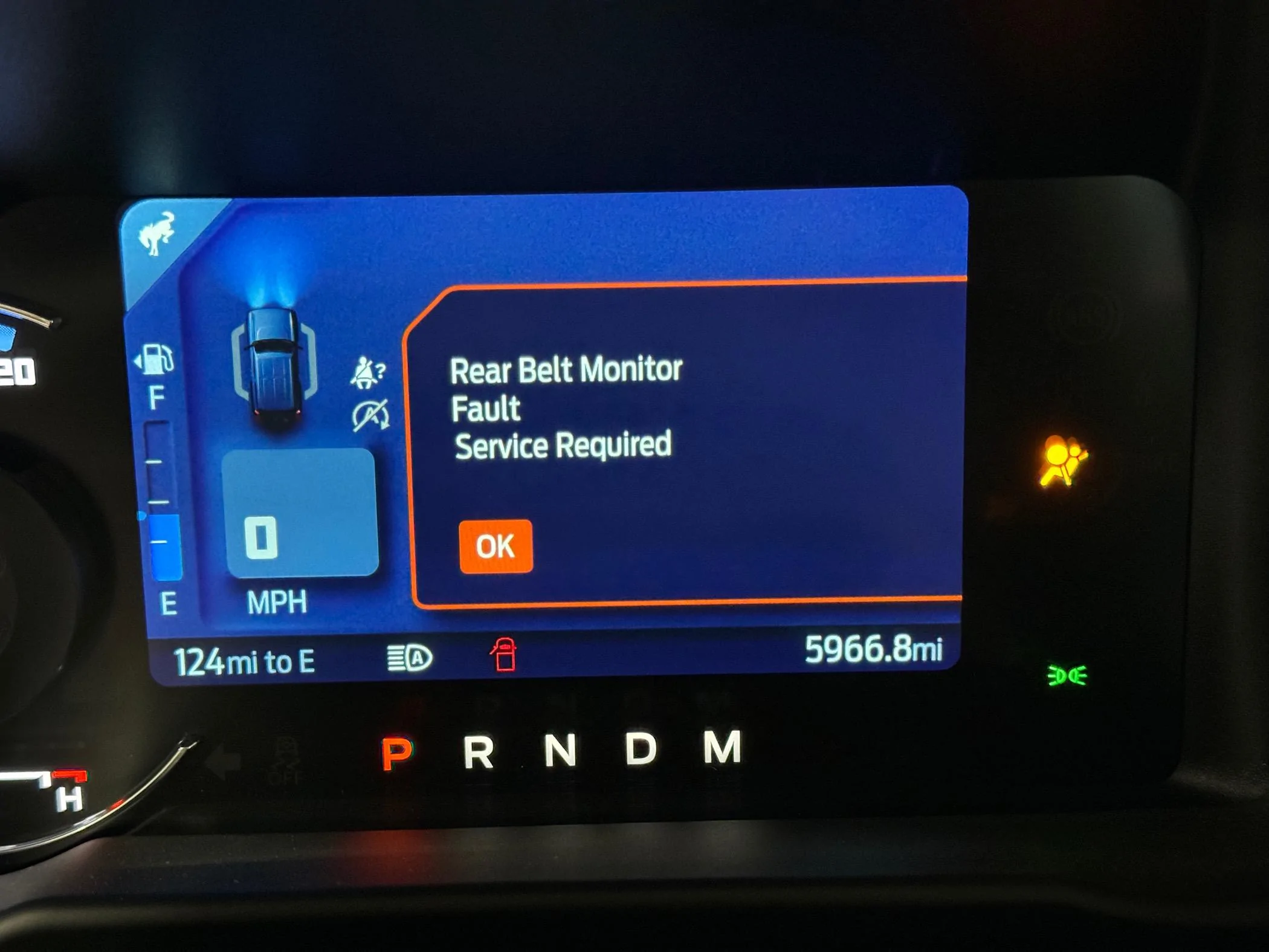

I took the front passenger seat out of my 2-door to build a sleeping platform.
Each time you start the Bronco, you’re presented with a warning on the cluster that says: Rear Belt Monitor Fault. Service Required, which you can dismiss. After that you’ll have an airbag light and a little seatbelt icon with a question mark.
