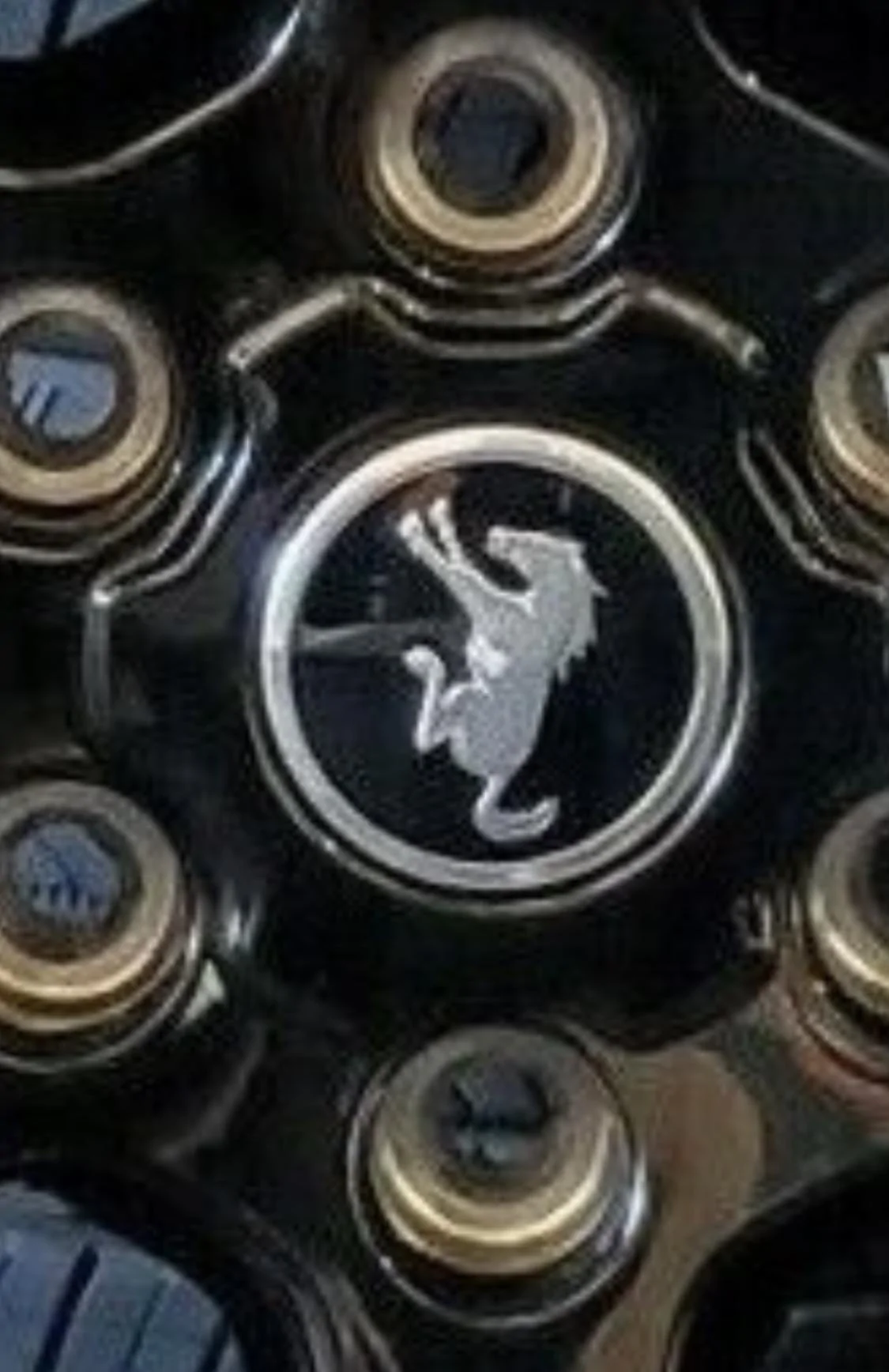

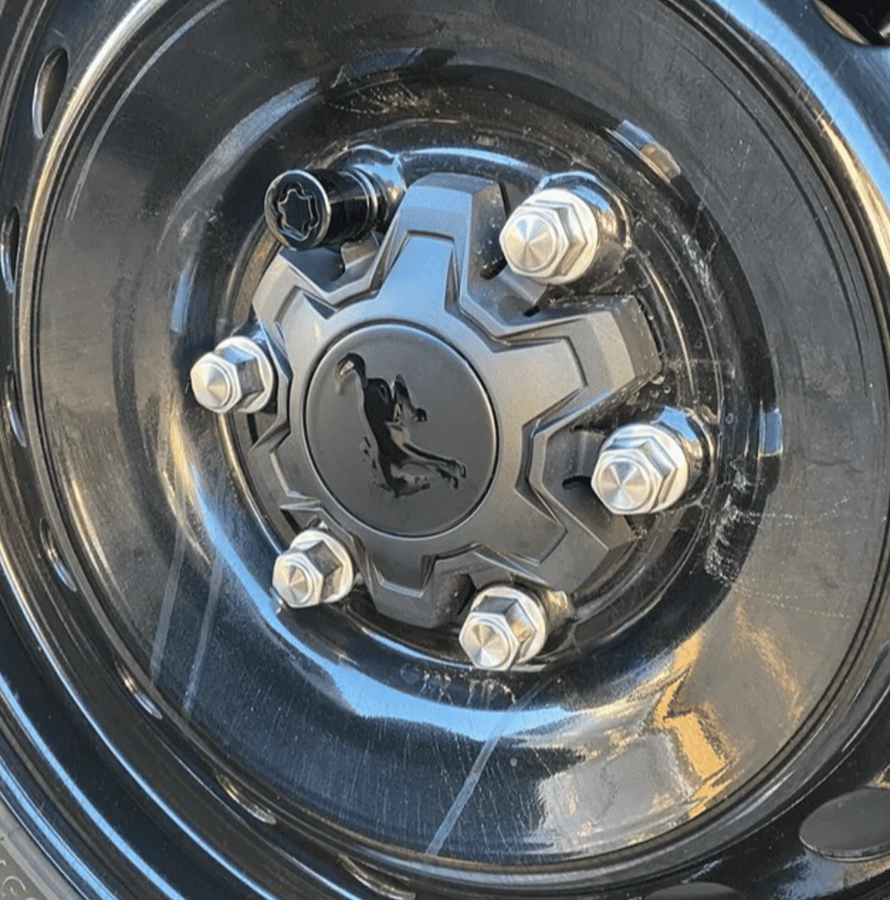

Oh, nice. I literally did the same thing with my Mustang. Looked great.
For my Bronco though, I wanted to switch things up, and ended up buying these vinyl overlays from Sticker fab (though mine are inverted: gloss black background, matte black horse).
Ford Bronco Removing/Replacing Center Caps on Stock Wheels? Screen Shot 2022-06-15 at 2.03.32 PM
After watching an install video, I think removing the caps will make things easier, so I appreciate the info on removal!

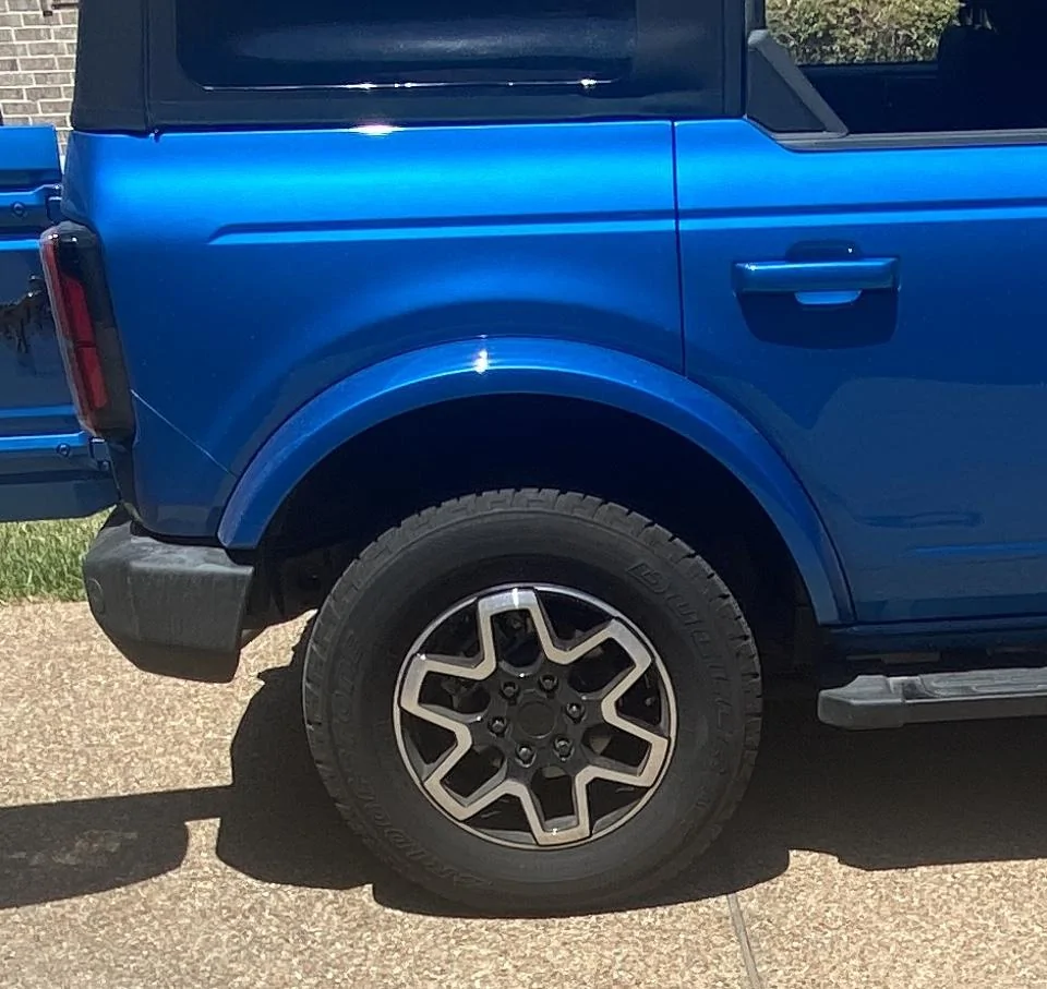

Got a pic with it installed?

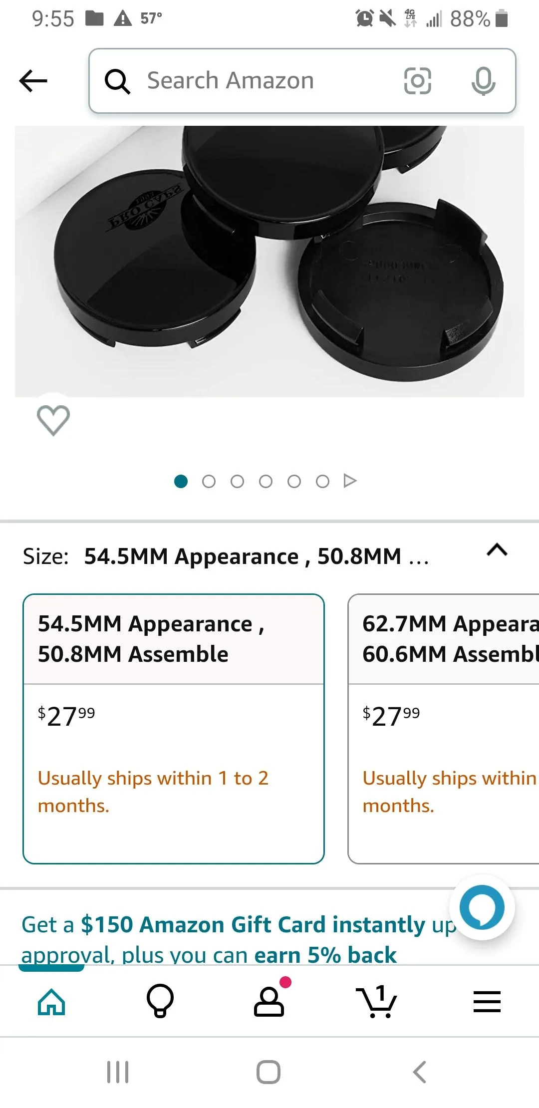

Which size did you order on Amazon. I don't see any with the size perimeters you mentioned. Furthermore, my OD measured 63mm or 2.5 inches. I just want to ensure that I order the correct size. Your help is greatly appreciated.

What size did you buy? Thanks!
Aurongel
Aurongel
M.
Oct 21, 2021
164
262
Austin, TX
2016 Dodge Challenger RT
My apologies but since I made that post I switched my stock OBX wheels to the RTR Tech 6 18" which have entirely different center cap inner/outer diameters.
For what it's worth though, I purchased from this brand on Amazon and have been 100% satisfied by their quality and return policy during the trial and error phase of finding the right size.
