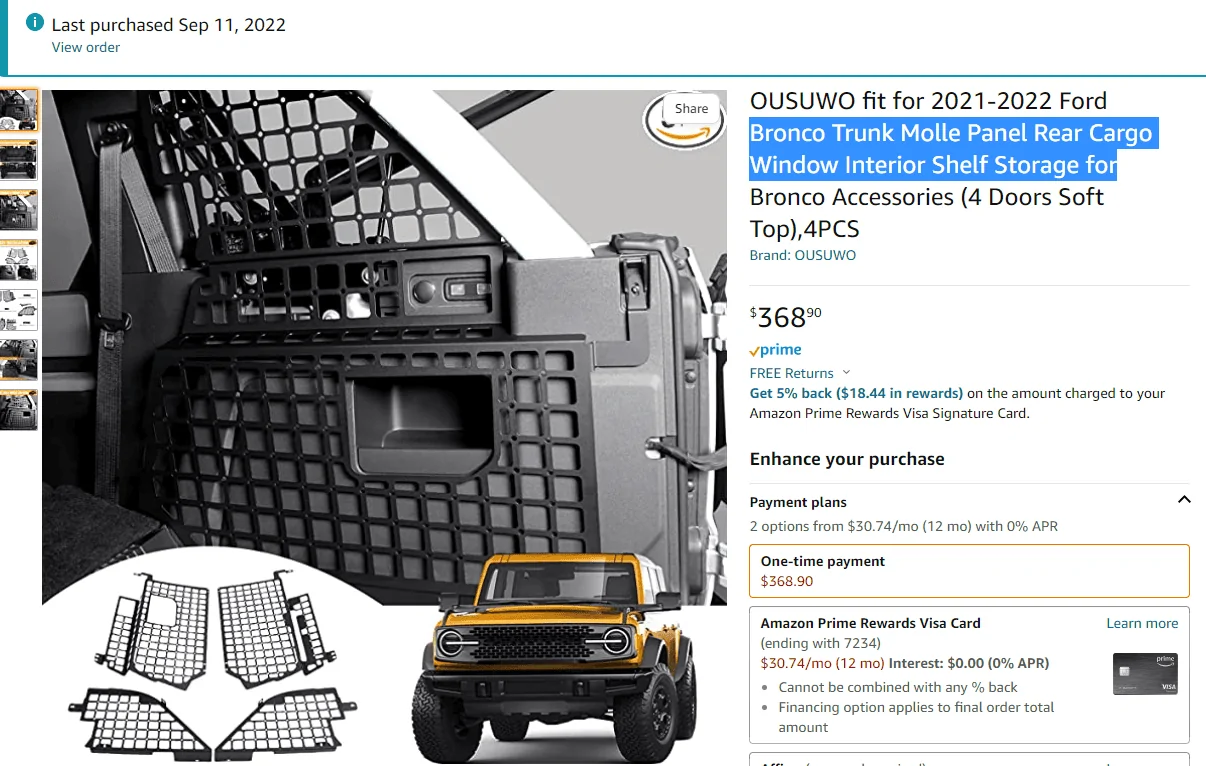

Anyone who owns their Bronco for more than a day quickly realizes how easy those black plastic panels lining our cargo area (and other areas) scratch. That is one of my most disappointing features of the Bronco since there is tougher material out there that they could use. I have been looking for a solution for awhile and finally settled on lining the back with Molle Panels, including the top window area as well. I was going to use a vendor here on the forum but they only had the bottom so I searched on Amazon and came across the below. You will also see another company or two selling a product that looks to be similar. So similar that their how to video was applicable for my installation. I guess that is just the way China products operate. Anyway, yes I was hesitant getting this from China but as I said, the American made version didn't make the upper panels, so I took a gamble and ordered the below off Amazon.
https://www.amazon.com/dp/B0B6MYR6DN?psc=1&ref=ppx_yo2ov_dt_b_product_details

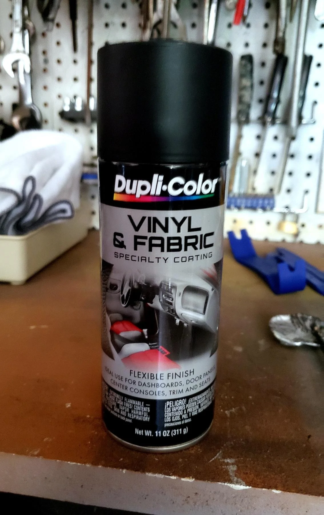

Before I did, I decided to repaint those nasty scratches with some automotive spray paint made for interior dashes, etc. This isn't as scary as it sounds as it was very easy to tape off the back area and of course removing the top helps. I also did this once in HS to change my car's full interior to black. I knew if I didn't repaint it, I would still be able to see those nasty long scratches unless I covered the entire vehicle with attachments! To paint, I just took my time and added 3 or so light coats. Was easy to cover black with black since it blends in well.

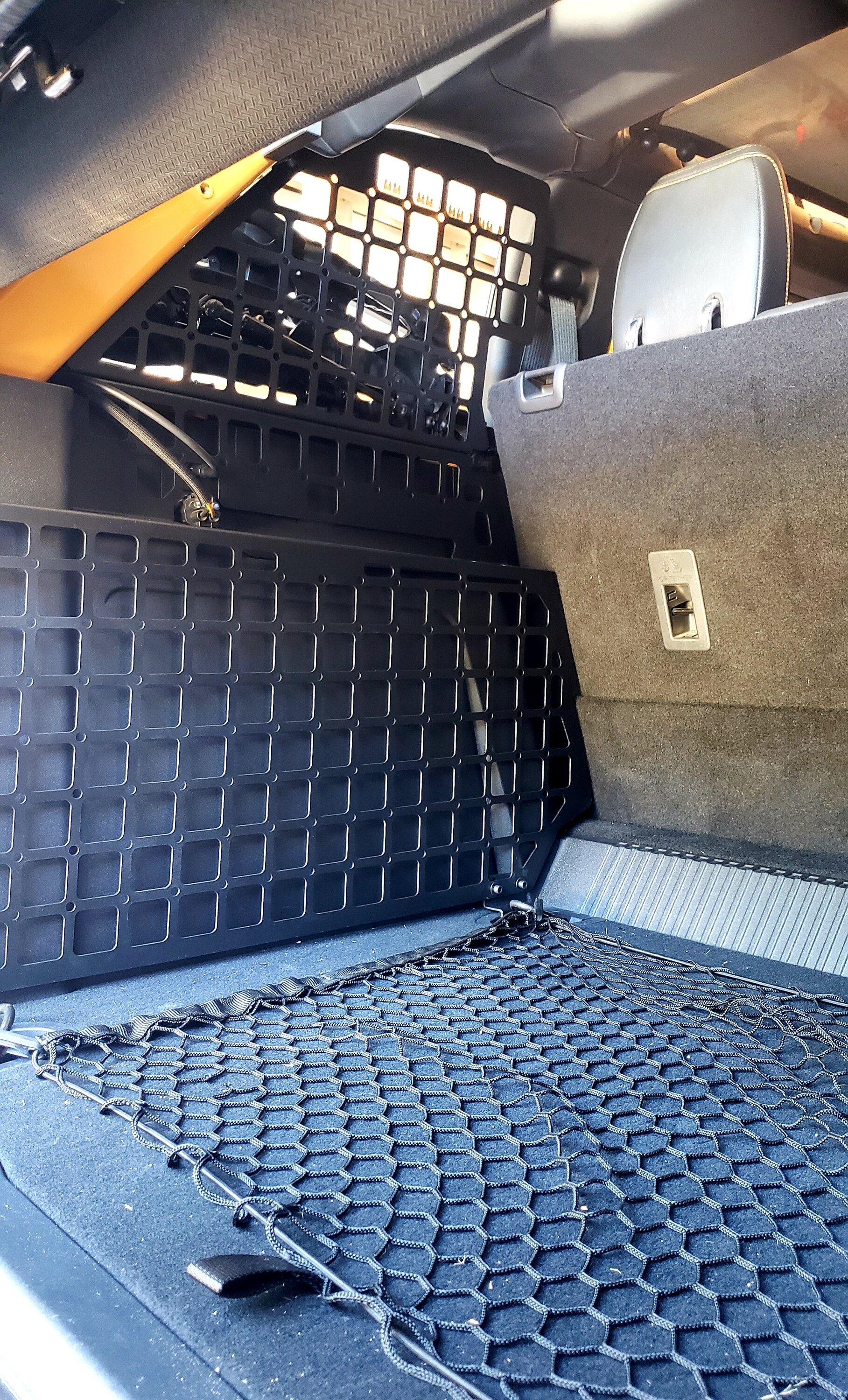

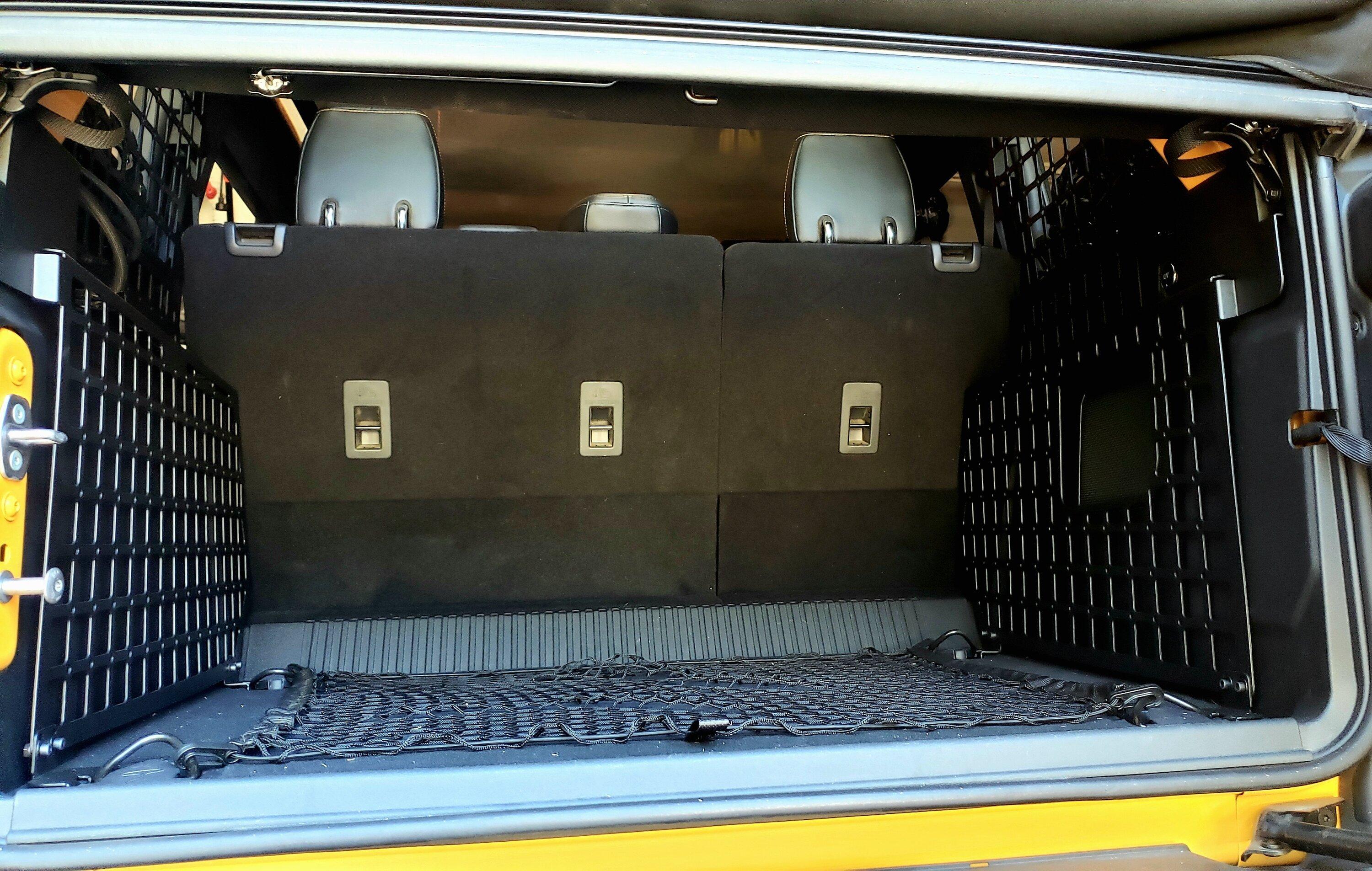

The installation of the Molle Panels went very smooth. I will suggest to only tighten the bolts fully when all the others are attached as there is some play in the alignment, which is a good thing. Also the feet of the panel that attach to the cargo net anchor points may work better mounting to the outside of the panel for the two closest to the front. I saw another reviewing say the same thing. These are easy to move around and play with before final tightening.
I like the overall look and it feels very snug and tight. For what its worth, I did confirm you can still recline your rear seats to that extra back position, which I dont think another manufacture would allow until they recently redesigned it. In addition, the instructions say the plastic covers for the cargo netting bolts will no longer fit. This is true, however I trimmed them a little with my dremel tool thinking I would get them to work. They still wouldn't snapback into place due to how the molle feet fit in those holes. Not to be outdone, I made them work by adding a little JB Weld Epoxy Glue. Strong stuff but not sure they will stay there after hauling a few things around.
Below are some before and after shots. As you can see, my Molle Panel Tailgate needs to share some duty now so I will be moving some things around soon.

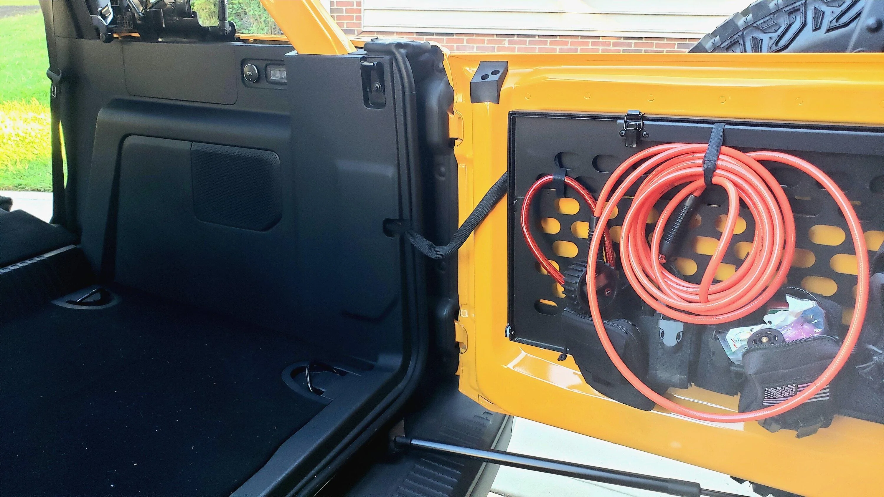

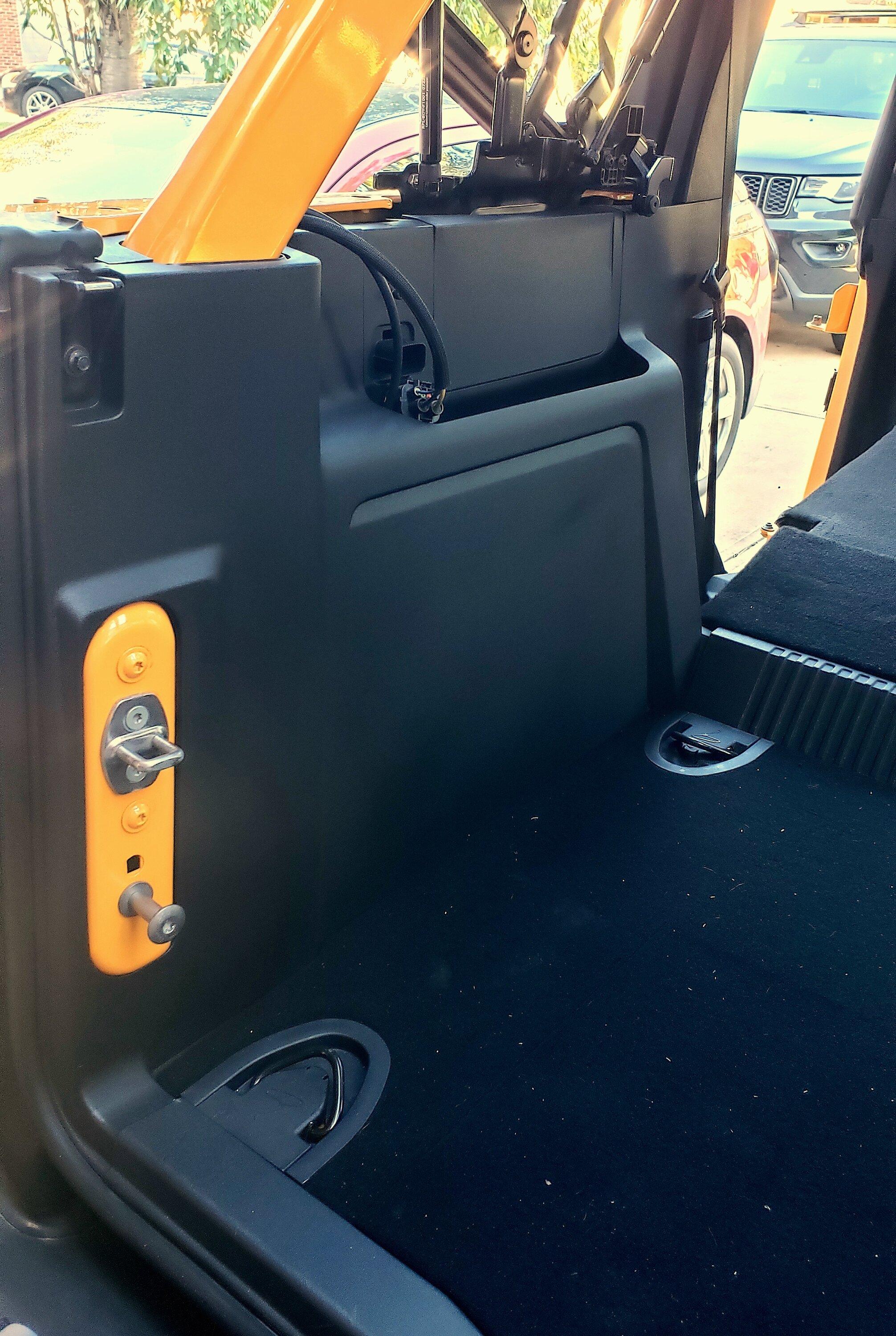

Right after painting (I couldn't find any good pics showing scratches prior to this)
Ford Bronco Repainted Scratched Rear Cargo Panels Prior to Installing Rear Molle Panels Over Them 20220922_171453
Ford Bronco Repainted Scratched Rear Cargo Panels Prior to Installing Rear Molle Panels Over Them 20220922_171427

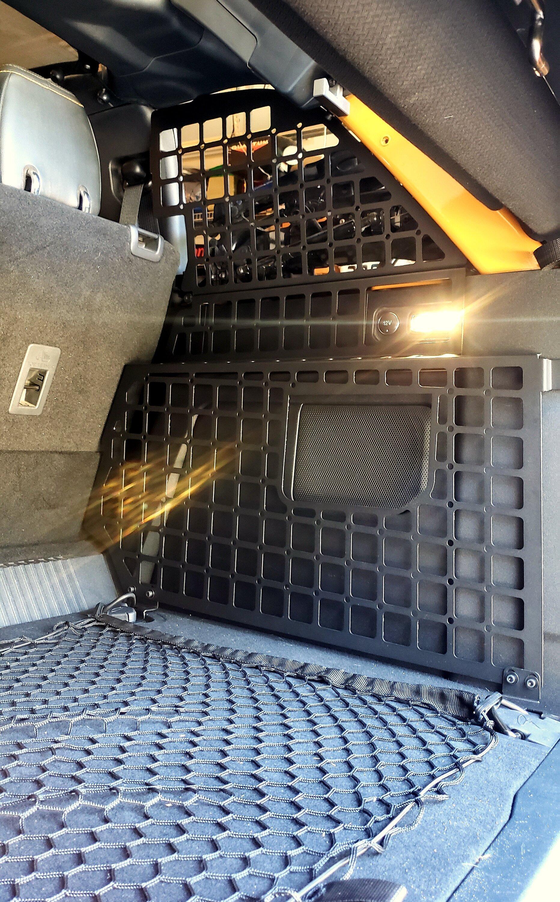

After Molle installation
Ford Bronco Repainted Scratched Rear Cargo Panels Prior to Installing Rear Molle Panels Over Them 20220922_171246
Ford Bronco Repainted Scratched Rear Cargo Panels Prior to Installing Rear Molle Panels Over Them 20220922_171155
Ford Bronco Repainted Scratched Rear Cargo Panels Prior to Installing Rear Molle Panels Over Them 20220922_171216

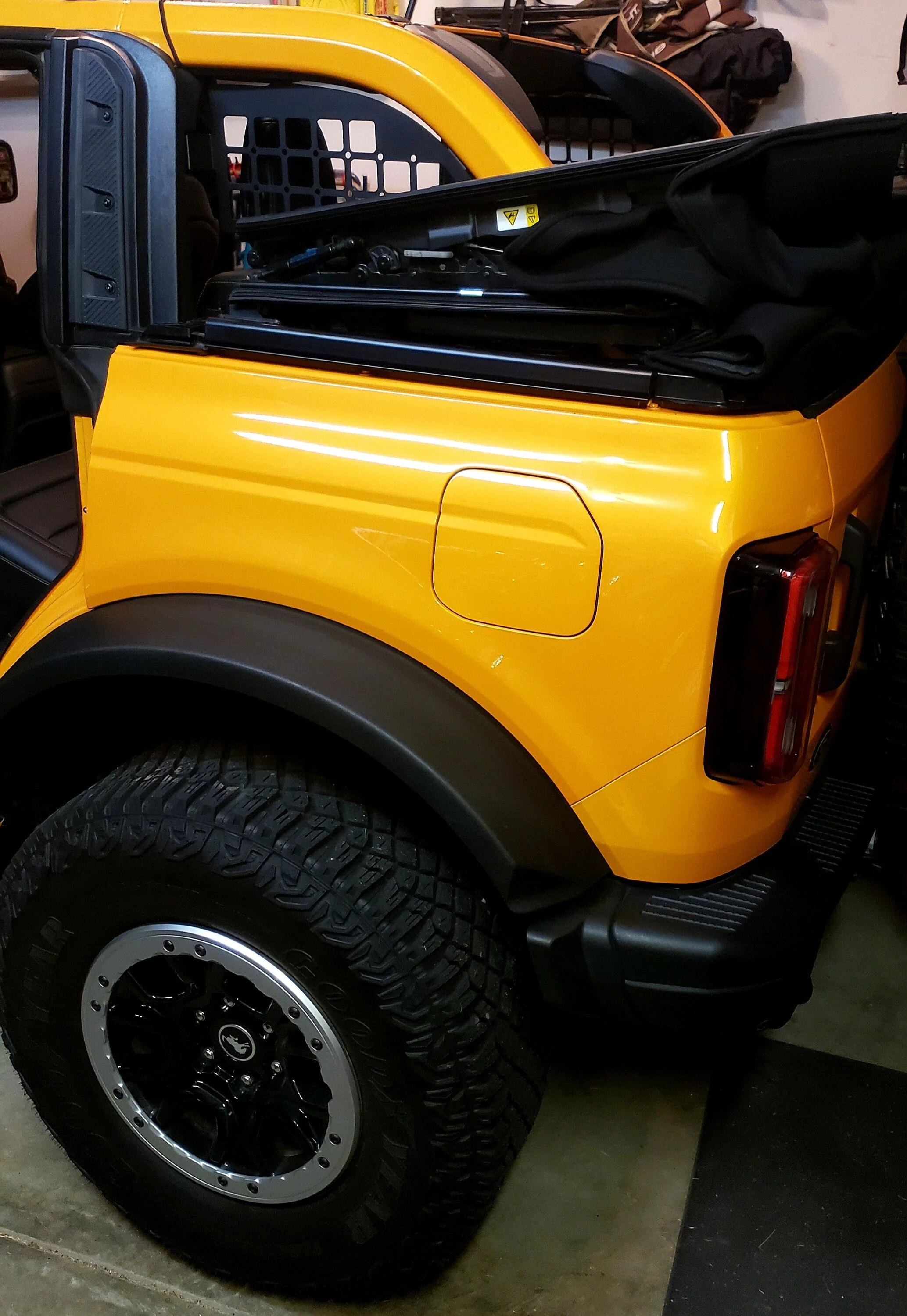

Look of Window from Outside
Ford Bronco Repainted Scratched Rear Cargo Panels Prior to Installing Rear Molle Panels Over Them 20220922_171524

What was the color spray paint you used? Black? Charcoal Black?.... THX

Which paint did you use for the scratches?

Sure, this was the paint I bought which they sell in most automotive stores. The back says Flat Black. and indicates its even flexible. It is a few dollars more than regular spray paint but I think it was worth it now. It worked better than I thought as I originally was just going to coat it very lightly and blend back away from the scratches near the center. But it looked so good that I just did the entire back...

Hard to tell in picture, but does the flat black color match well to the cargo panels or would you recommend a charcoal gray. I know it will not be perfect either way, but hoping to get close in color. Rather use it for touch up then paint the entire back.
