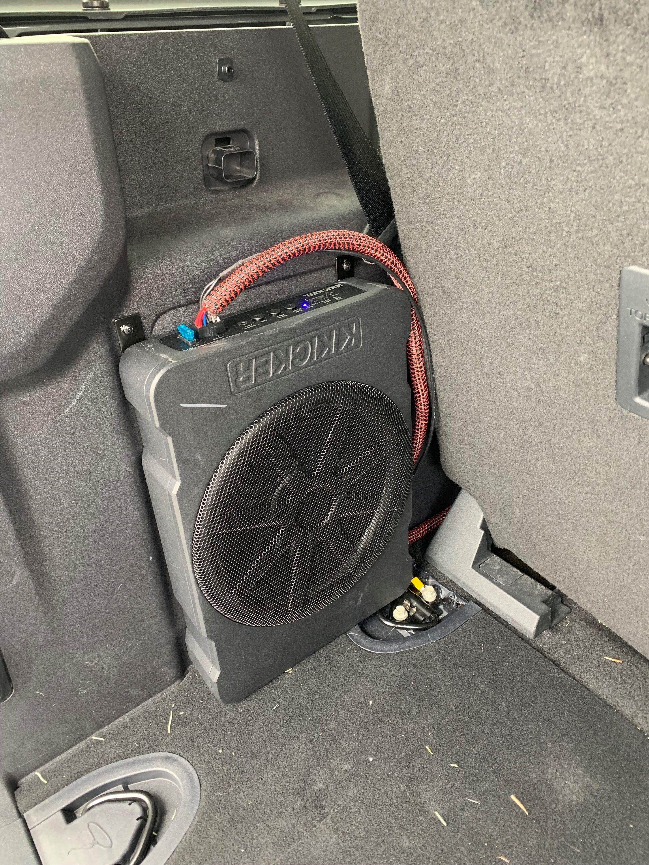

Purchased a 2022 two door in October that I had ordered 18 months ago. Love the vehicle but hated the sound system. I'm 51 and like rock. After watching several YouTube videos, I decided to replace all the speakers and add a subwoofer. I called crutchfield and they were more than helpful with recommendations. I ended up with (4) Kicker KS 4" speakers for the dash and rear. Dash is the hardest. Use a hotel key or an old credit card to pop the grill off. Then it's just splicing two wires and your set. Rear speakers, the grill pops right off with a squeeze near the bottom of the grill. And then it just splicing two wires. For the kick panel speakers, I decided to go with Kicker CS 6.5 speakers. There are several videos out there on how to remove the kick panels but it's real easy. I then put a kicker hideaway in the cargo area, running the wires down the track to the kick speakers where I used Tap It's to get signal to the subwoofer. All this for less than $600 and it sounds fantastic.

I purchased some new speakers as well, but really want a subwoofer. Would like to see some pics as well and how it was connected to the system.

Only place I had room for it in the two door model.

I used the screw from the tie down brackets. You can see it in the picture if you look close.
