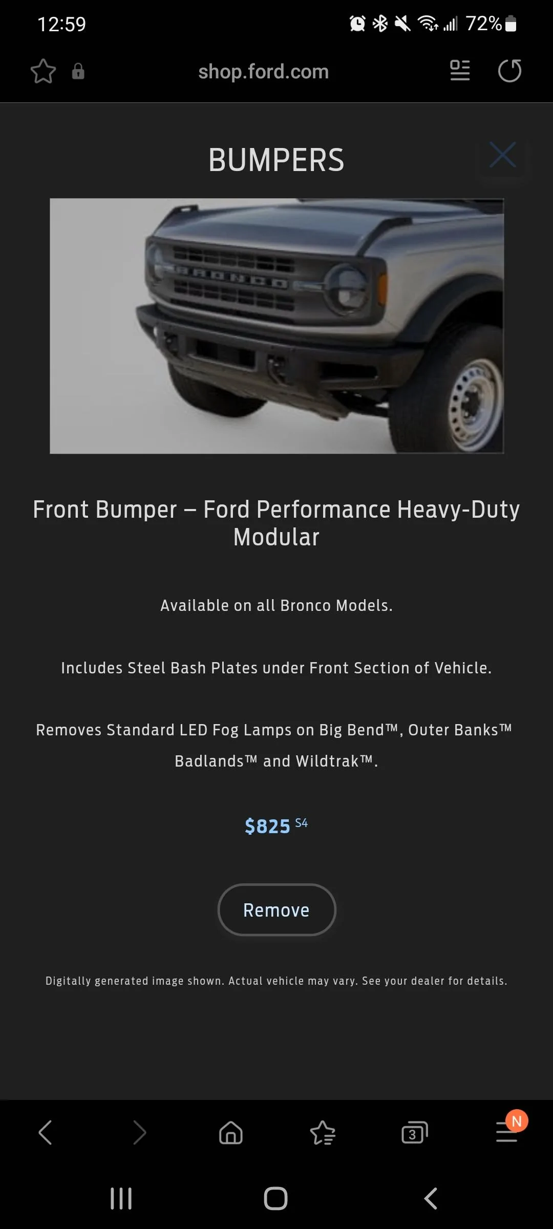

I ordered and received a 2021 4 door Wildtrak. In an effort to ensure my order was prioritized, I left off the heavy duty modular front bumper. Now that I've had my Bronco for a month, I'd really like to upgrade to the modular bumper. I called my dealer and after consulting with his parts guy, he said that the modular bumper isn't available as a package replacement yet and I would have to piece it all together. He recommended going with an aftermarket bumper such as 4 Wheel Parts. My question for you all is, has anyone purchased a Ford factory modular bumper and installed it yourselves? And if so, what was the difficultly level? I know that parking sensors will need to be swapped. Are there any other hidden obstacles? I'd prefer going with a factory swap vs aftermarket which might block the crash sensors. I look forward to hearing everyone's thoughts. Is anyone else in this same situation and what are you considering?

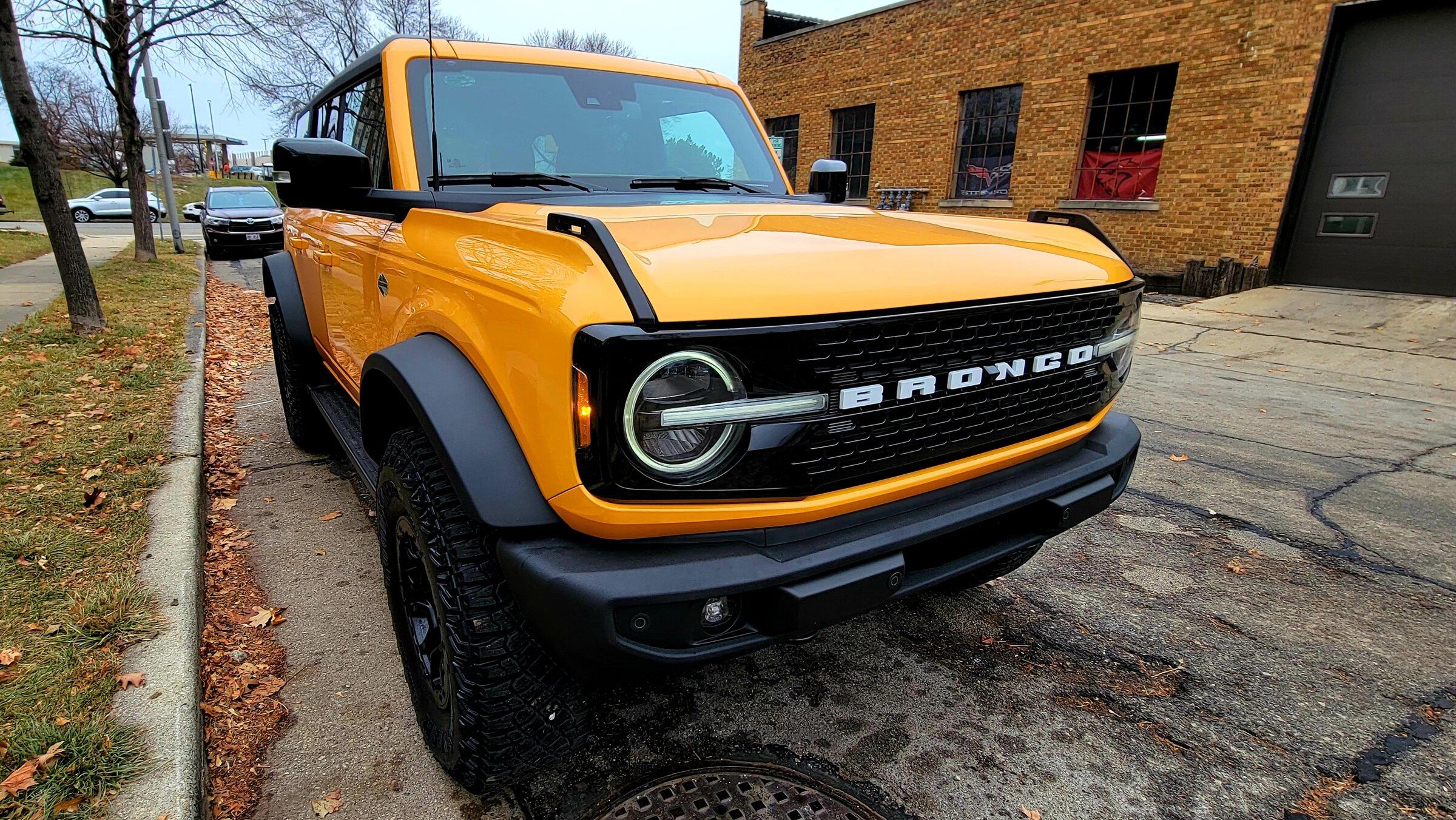

Here are some pics, we are getting close. Just missing the plastic covers surrounding the recovery hooks on both sides.
Very, very nice! I was thinking of selecting either the Diode Dynamics or Baja Designs light kits but i saw the ZroadZ kit at a much better price! I am not too familiar with their products but I noticed that they are located within 5 miles of my house! So, i might have to give them a try.
Question: would you be able to install the lights with the lettering right-side-up by flipping the plates? Virtually every example that I’ve seen has the ‘ZroadZ’ lettering upside-down. It’s not a big deal but my slight OCD would force my eyes (and mind) to always fixate on that non-issue…
Looks like I’m missing the same , noticed it when I picked up today. Hope they aren’t too far back ordered.
