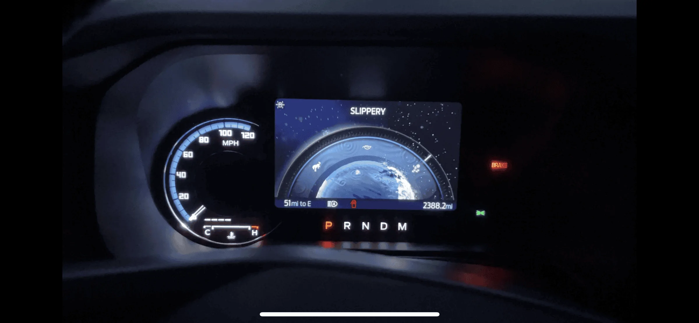

Resolved: dealer has me setup MyKey which he explained to recognize the fob and restore radio stations, etc, etc. it actually does not, rather it removes access to certain functions.
Must not have something set or doing something correctly. Only 3 modes (Normal, Eco, Slippery) are appearing when turning the dial as shown in video. Thoughts?

Can’t watch the video. What 3 does it show?

Video is likely too large. Only Normal, Eco & Slippery are appearing.
Interesting. Those are all modes you can shift to while still in Drive, and don’t need to shift to Neutral for 4Hi-Lo. Did you try disconnecting the battery for a hard reset? Any notifications in your ford app of issues?
