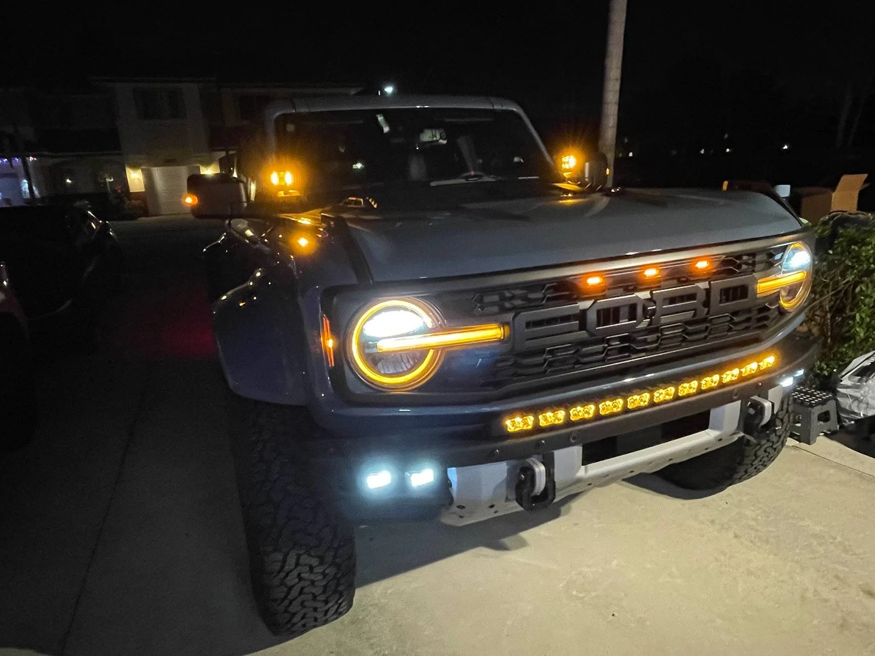

I have the M&R 40” and Cubes. Good bang for the buck. Amber and white light fits my Bronco Raptor perfect. Also added some Oracle 8 piece rock lights, I have 4 more on order.
