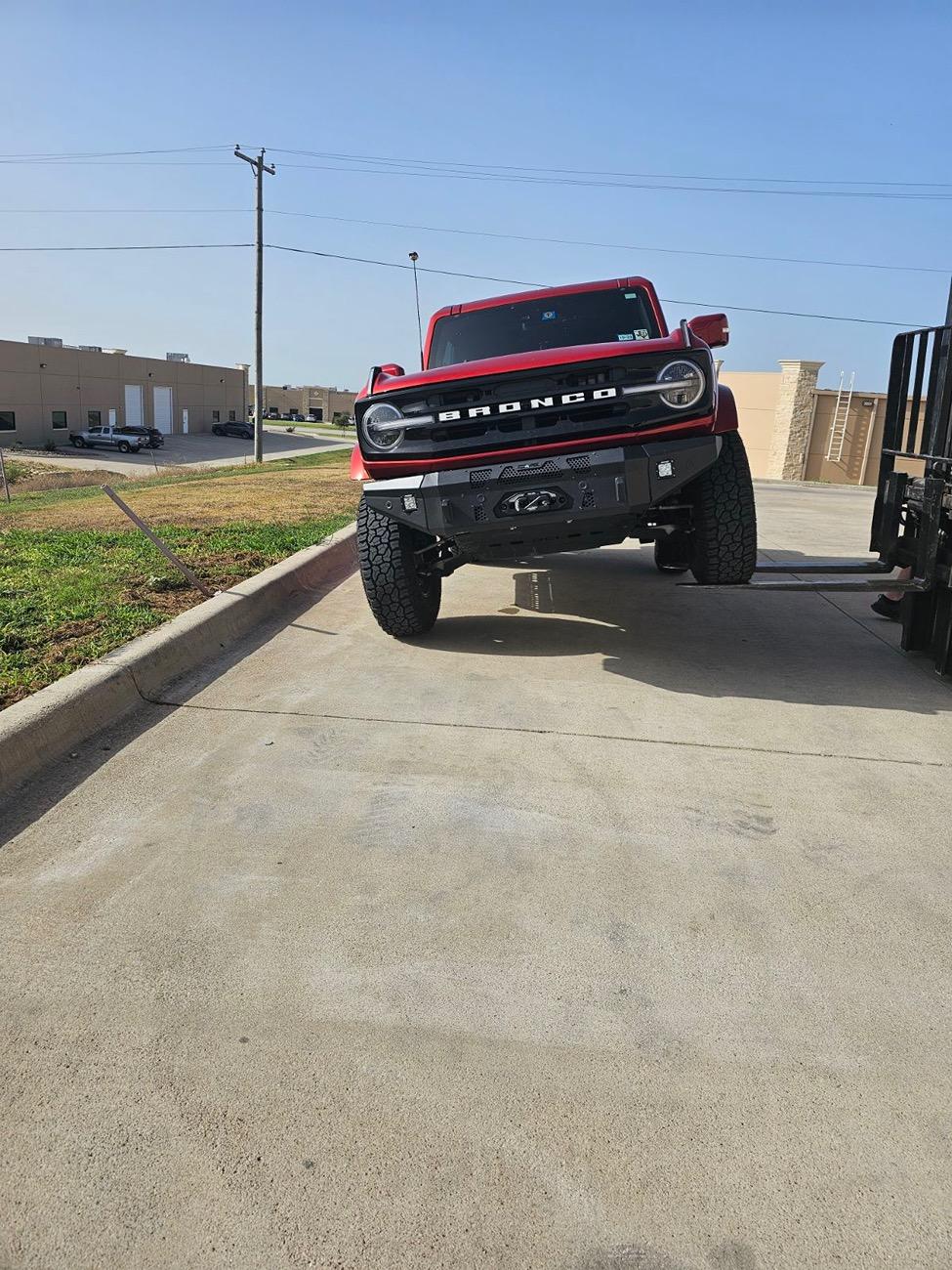

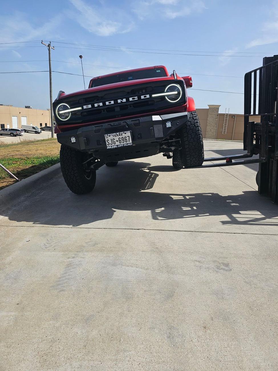

I had Rockjock Antirock Sway Bar installed last week. I have a non-Sas 2 door OBX with no rear sway bar, Eibach 2.0 coilovers at 3.3” in front and 3.0” in rear. The shop used a forklift and said I was at 15” of height with factory sway bar and 18” after. Not quite as scientific as I’d hoped and not sure I can translate this to ramp travel index but figured I’d share anyway. The ride, while more side to side lean and a little bouncier, is not bad at all. A nice set it and forget it option, albeit expensive.

Nice visual representation! My only question is does it continue to sway back and forth if you hit a bump around a curve on the freeway at 70+ like with the factory sway bar unbolted? Or does it still function to a degree and stop sway from oscillating after a disturbance
It doesn’t really oscillate or sway back and forth in that situation. The torsion aspect of it causes more lean but once the suspension absorbs the bump it feels settled.

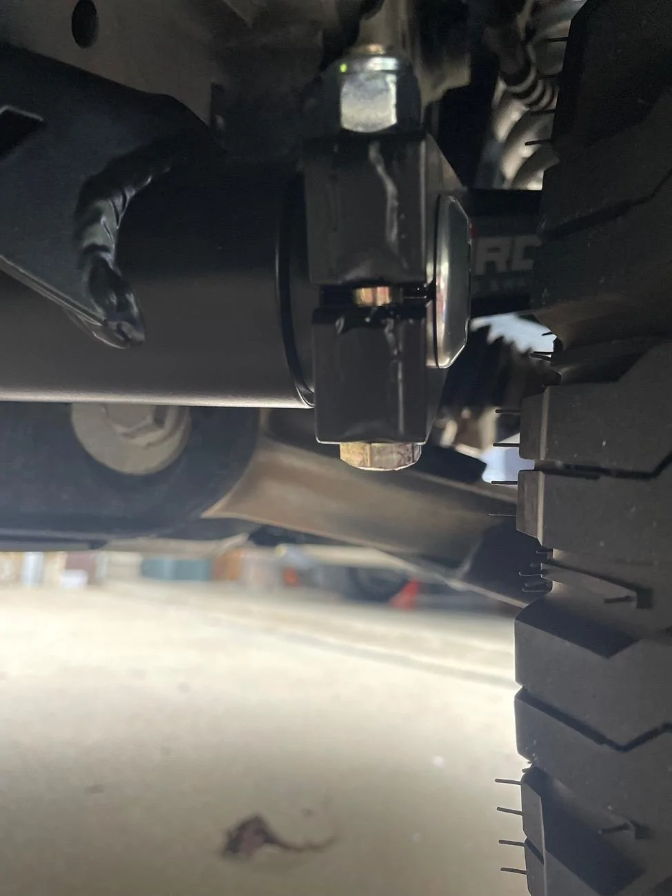

Do you have the needed 0 offset or are you just going to deal with rub?

I’ve got 17x8 +25 offset wheels on Falken Wildpeak R/T’s that are 35x11.5x17 and no rub at full lock. It’s about 3/4” with a tire lug lined up to the bar from making contact with the rockjock.
Yes, I’d image if running a 12.5” or wider with a little more positive offset (say, running Sasquatch OEM wheels and tires) that it would rub.
