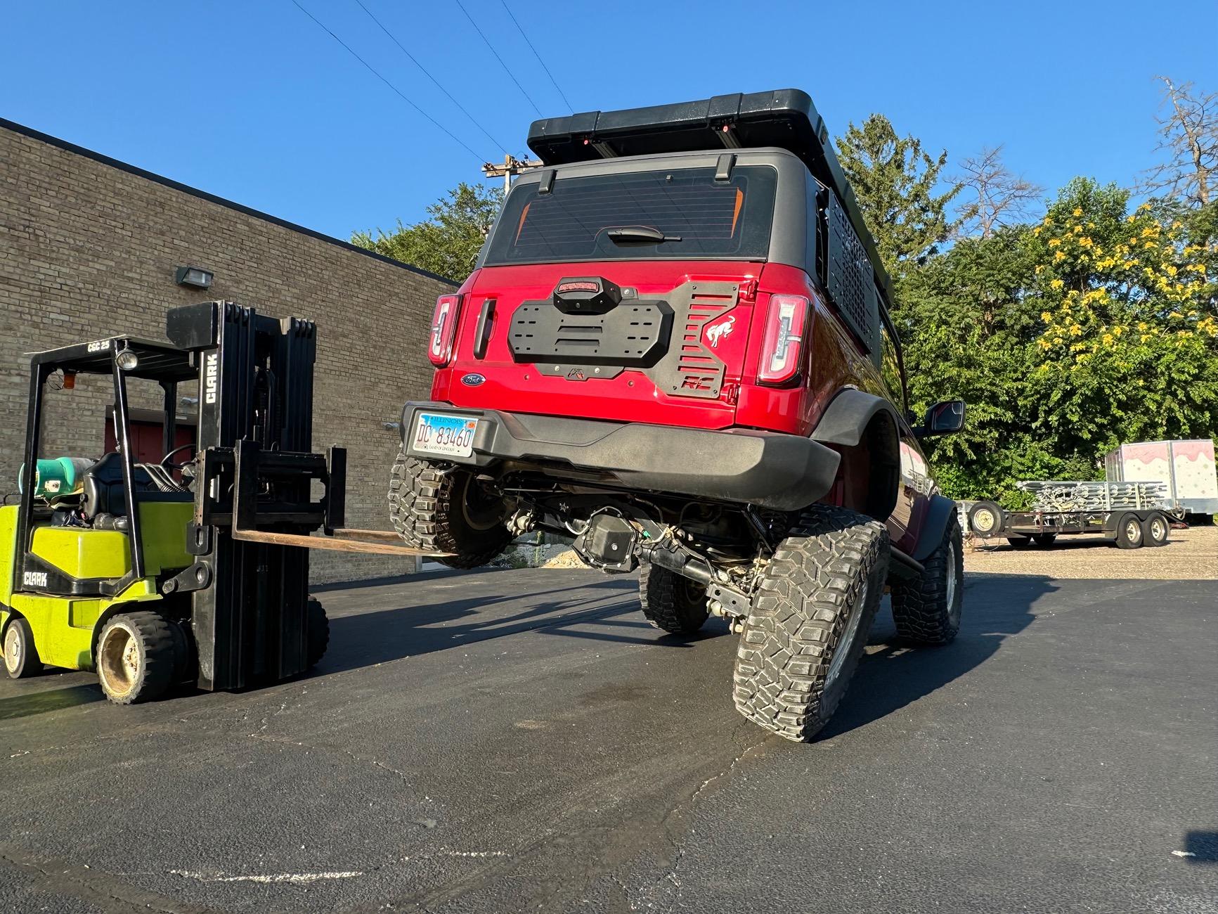

We installed the RockJock4x4 Rear AntiRock system on the 2-Door.
installation of the system is easy enough, the hardest part (which isn’t in the video) is removing the old muffler after 3 years of Illinois salt. Bolting up the AFE muffler (or equivalent from other MFG) that’s required for this system was easy though!
We’ve been without sway bars front or rear for over a year, and adding this did reduce the flexibility of the Rock Krawler Pro-X 4-Link rear, but not by as much as I was expecting… and the reduction of body roll was greater than the articulation lost.
Overall, would definitely recommend if you have a factory rear swaybar and aren’t ready for the no-sway-bars life.

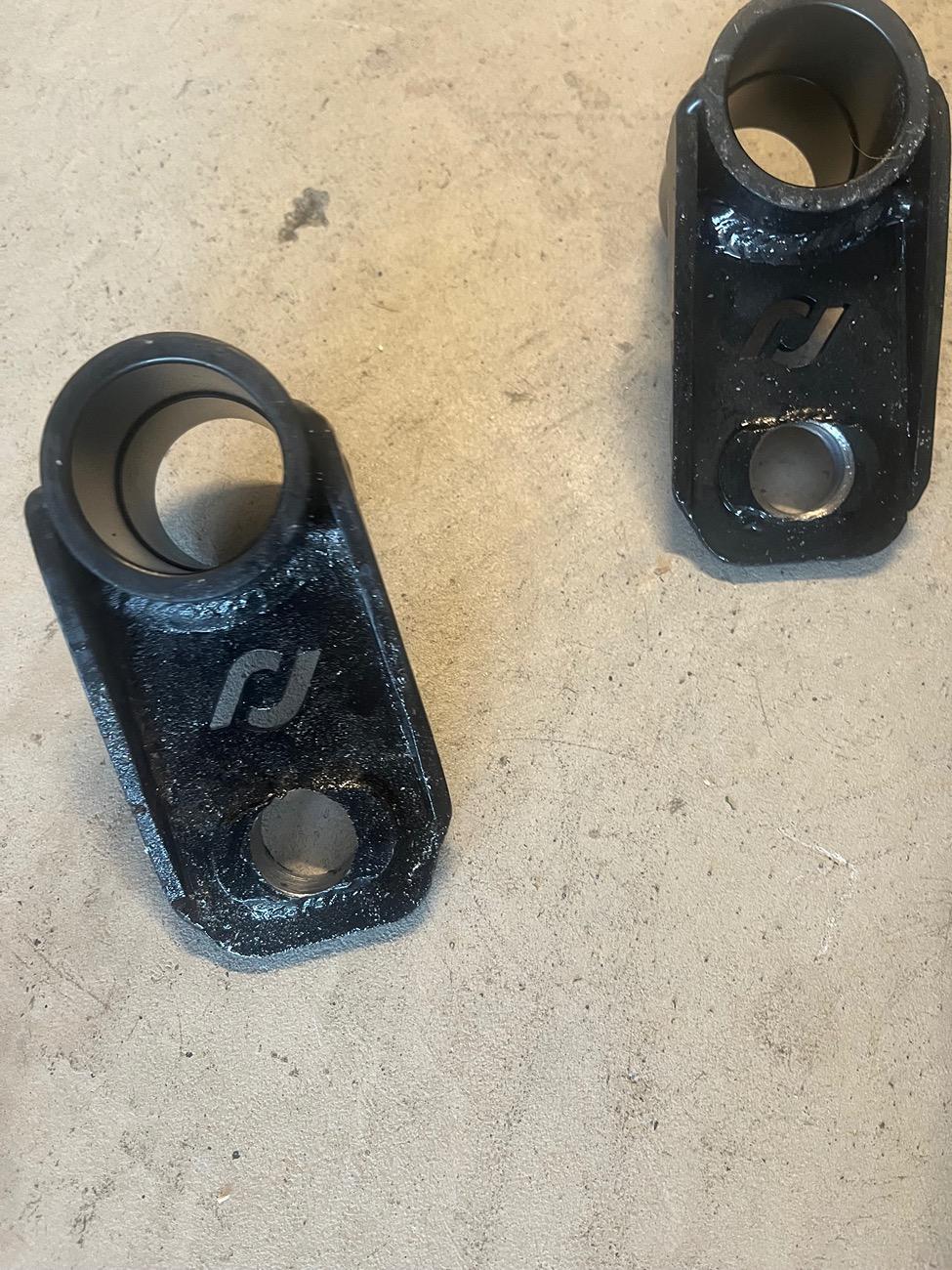

Installing ours today. The rear winch mount uses the same holes that the swaybar uses so we had to do a little drilling. And by little I mean a lot. Damn bolts are .75”
Ford Bronco RockJock Rear AntiRock [Install + Forklift Flex Test] IMG_2607
Yeah! That’s a LOT of drilling! lol
🤜🤛 for making it work!!

It certainly took some patience. Destroyed a uni-bit in the process 😂😬
Removed the factory rear sway bar while swapping out the driveline and adding the RK coilovers, and goodness the body roll is bad. (Took awhile for the RJ swaybar to arrive) It’ll be interesting to see how much of a difference it makes with our setup
