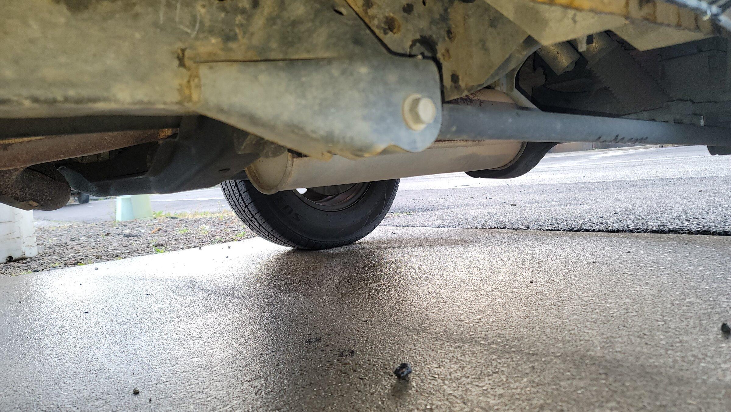

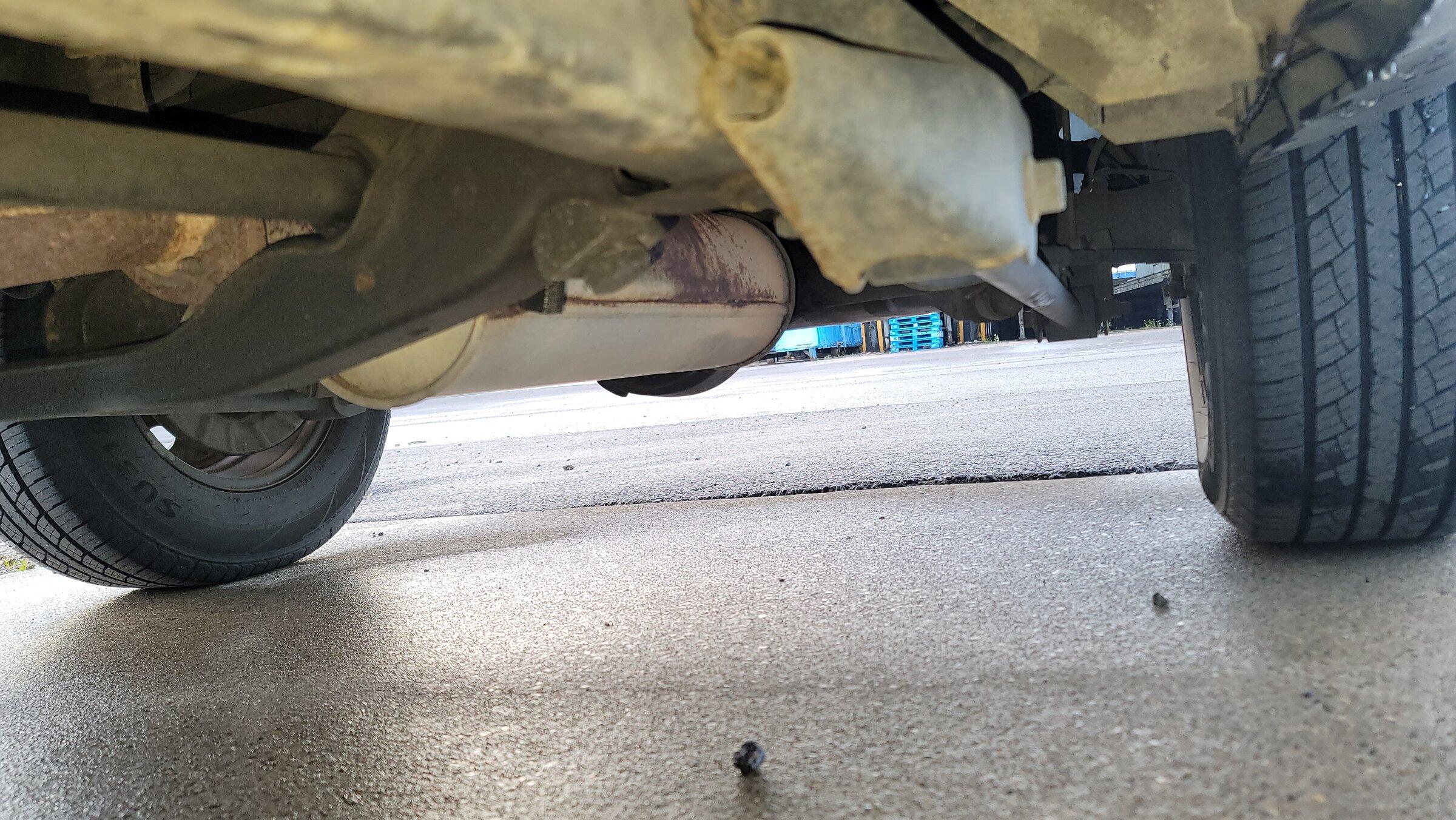

I plan on cutting those dumb rock-catcher mounts off and doing the isuzu style instead...they moved them out and up.
Here's a pic of the isuzu style I'll be running soon.
My plan is something like this with the bottom FLUSH with the frame! And might as well lengthen the lower control arms while I'm at it and move the frame mount forward about 12" too.
