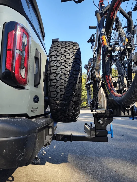

What's needed?: You will need a hitch extension to clear the spare. After a test fit I determined I could get away with only a 5 or 6 inch extension. Unfortunately because of the necessary overlap, hitch extensions can only be made so short. 7" is the shortest I can find commonly, though I saw a very expensive 6.5" option (solid steel). The shorter the better (to reduce the force multiplier of the extension) but I opted for the much more economical 7" option.

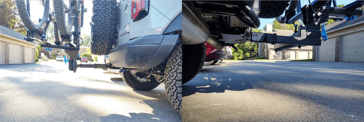

Ground clearance is maintained. Obviously the departure angle is reduced. There are high clearance bike racks that may retain the full Bronco spec. But in my opinion that is not worth the hassle of loading, or the compromised cargo access. I don't plan to do hardcore wheeling with the bikes on, but will certainly take it done mild/moderate trails. Additionally, with the bikes removed you can easily flip up the rack to gain some departure angle back.

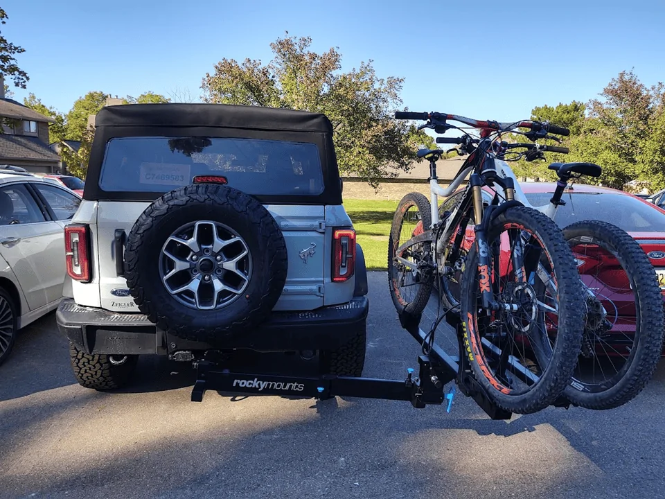

Note: Plenty of clearance between the spare and roofline. They just don't have shorter adapters than this.

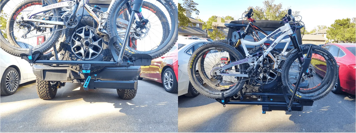

Note: Wow, look at that flex! I admit this does not look pretty, I think it will hold up though, just don't drive like this! Keep in mind there is also a hitch extension which introduced a bit more slop to the system.

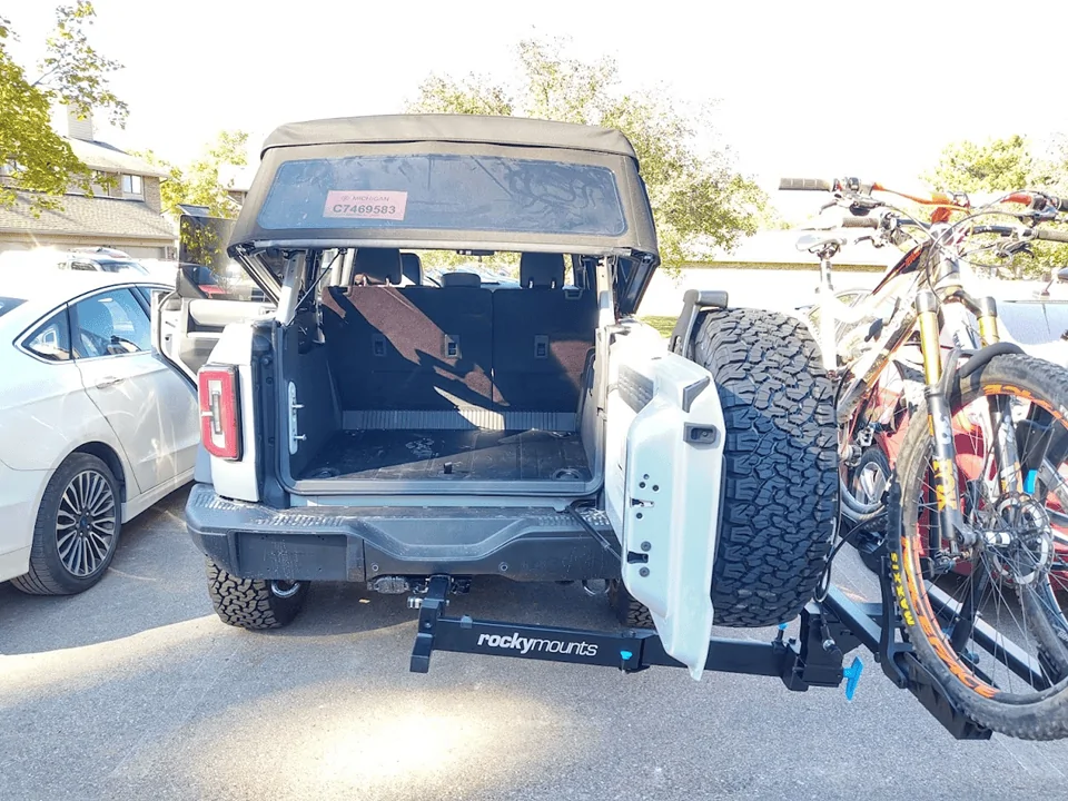

Note: The gate is sitting at it's 90° rest position but you can open it past 90° before the tire hits the bike pedal.

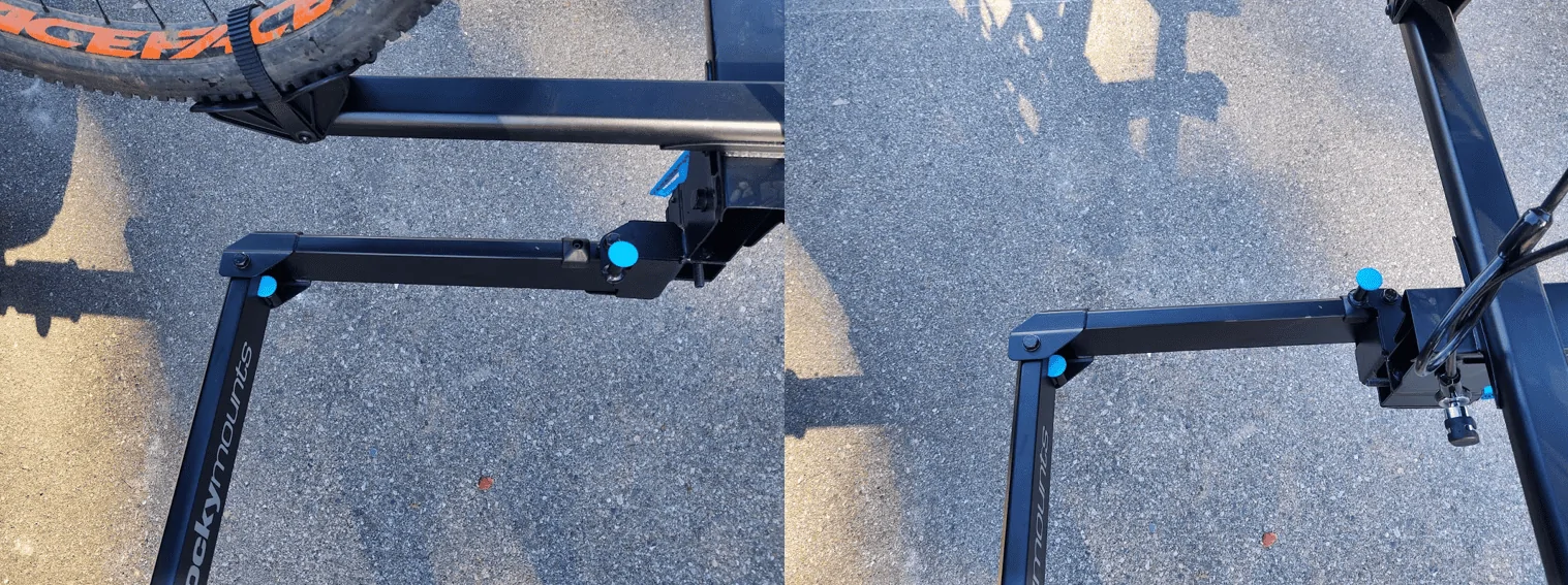

Note: There is a pivot both for the cantilevered arm, and the bike rack on the arm, so the bikes can swivel independently from the cantilevered arm.
