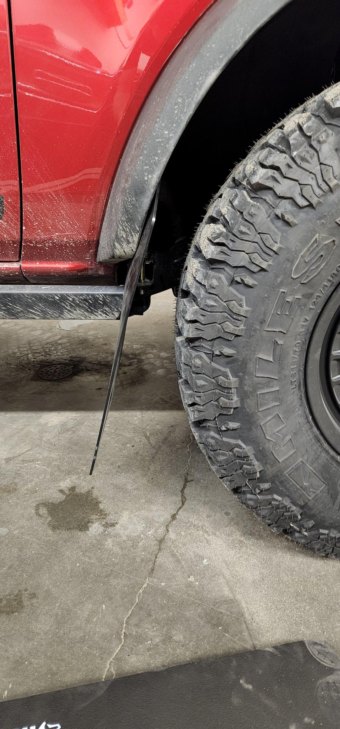

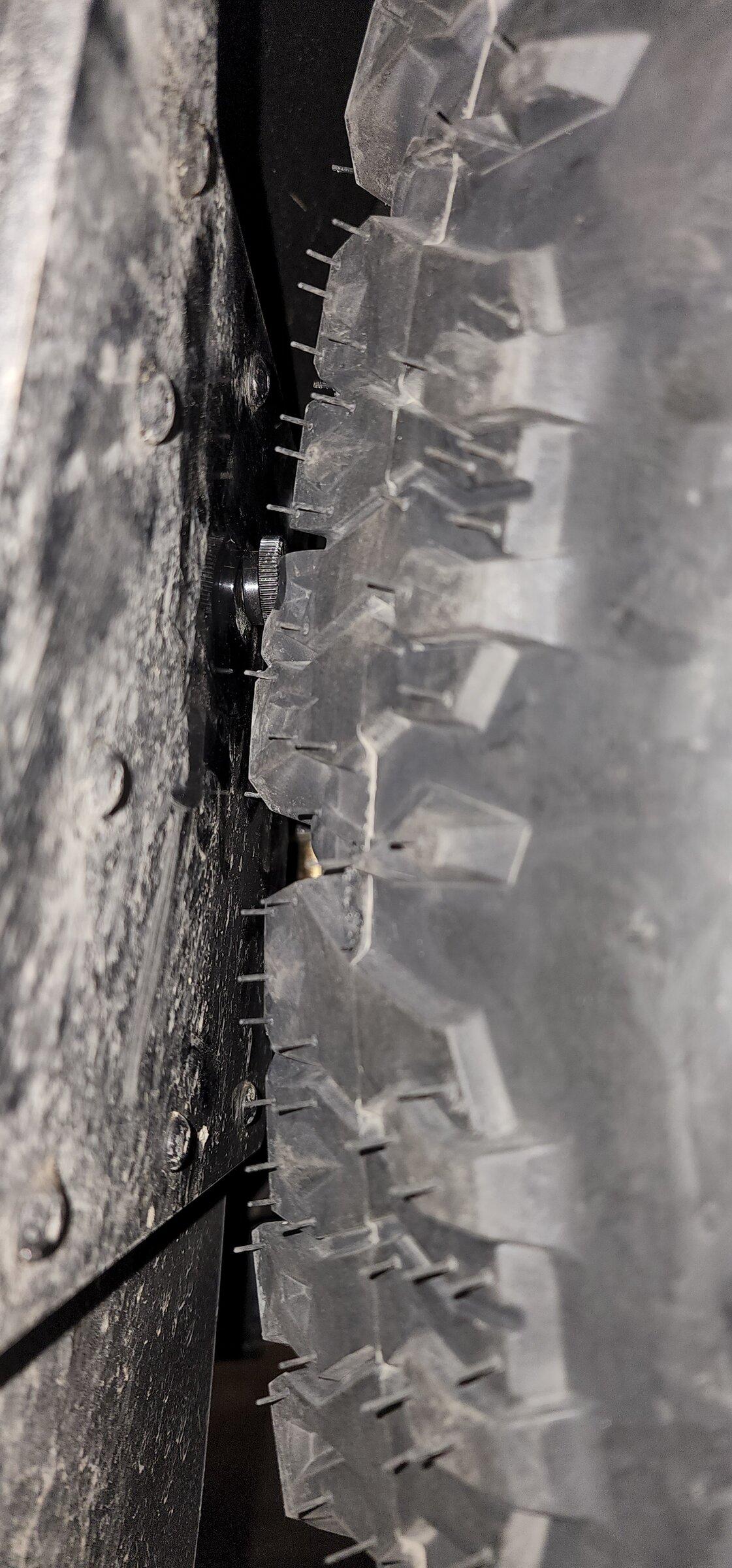

Mine shipped today & I have 9ā wide +01mm offset wheels. Sounds like I might be sending mine right back.Apparently I didn't take a pic before I took them off, but I put my 315/70 Patagonias on today and the front flaps DO NOT CLEAR. 8.5 wide 0 offset wheels.
So stock tire size with an offset change won't clear these flaps.
I'll be modifying them to work, but they really need to redesign the front flaps.
Yup if you don't want to modify anything should probably send them back.Mine shipped today & I have 9ā wide +01mm offset wheels. Sounds like I might be sending mine right back.
Where are you rubbing? On the bracket or the flap??Apparently I didn't take a pic before I took them off, but I put my 315/70 Patagonias on today and the front flaps DO NOT CLEAR. 8.5 wide 0 offset wheels.
Catching the thumb screws and slight rubbing on the flap. On flat concrete, would only get worse with flex. I'll get a pic for reference this evening. Been needing to pull and swap to the new gold clips anyway.Where are you rubbing? On the bracket or the flap??

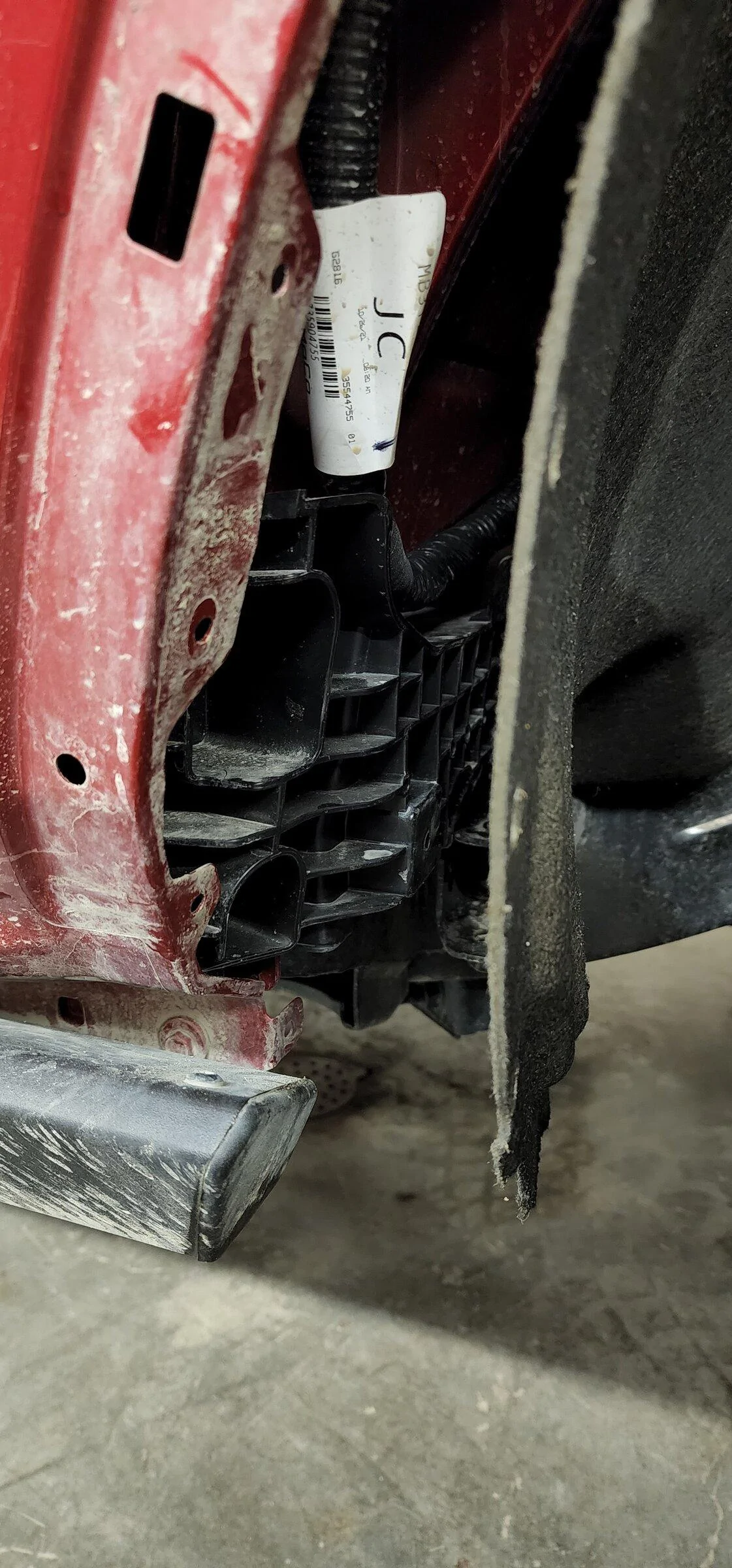

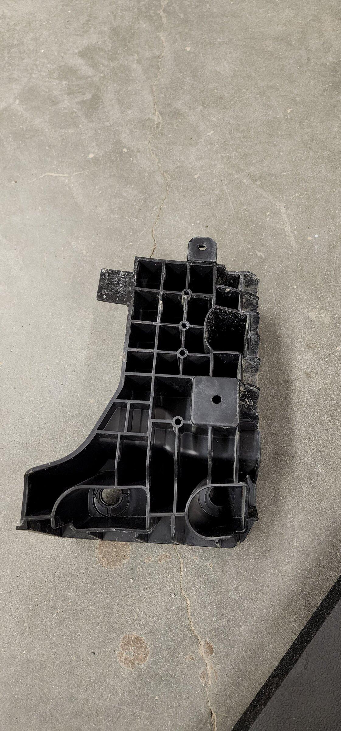

It does look like you'll have plenty of room now even with flexing. You'd think Ford could've made that plastic and rock rail flush with the body panel from the get go...Took some effort but we're making progress here. Haven't done the drivers side yet but after several beers I've got the passenger side on and clearing with the thumb screws.
I thought at first I'd get away with just swapping the thumb screws out for button head screws but that was a no go.
So I removed the plastic block behind the fender liner like a another member here had mentioned doing. As far as I can figure out this things only purpose is to provide a place for a couple of the liners push pins to grab hold.
This makes lots of room for adjustment of the RB mounting bracket, but the problem then is the flaps run into the rock rails. So...out comes the Dremel.
I'd suggest moving your cars outside before firing up the dremel, because at some point your little cutting wheel will shatter, shoot across the garage and play a round of pinball between the wall and your GT350 (like I said, *several* beers were involved with this job)
Now everything seems to fit. Still on level ground but I'll get it flexed out some this weekend and see what things look like.
More work than it's really worth and I'd tell anyone with these on order and plans to go to more aggressive wheels cancel their order.

Looks nice, much cleaner fit, and how you'd expect them to look from the get-go, but that looks like a fair amount of custom work to get something pricey to fit cleanly. Really glad I sent mine back.Took some effort but we're making progress here. Haven't done the drivers side yet but after several beers I've got the passenger side on and clearing with the thumb screws.

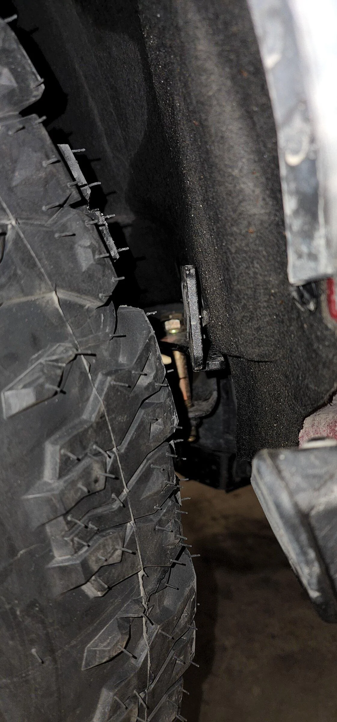

The mud flaps are the least of your worries.Clearance with bare bracket:

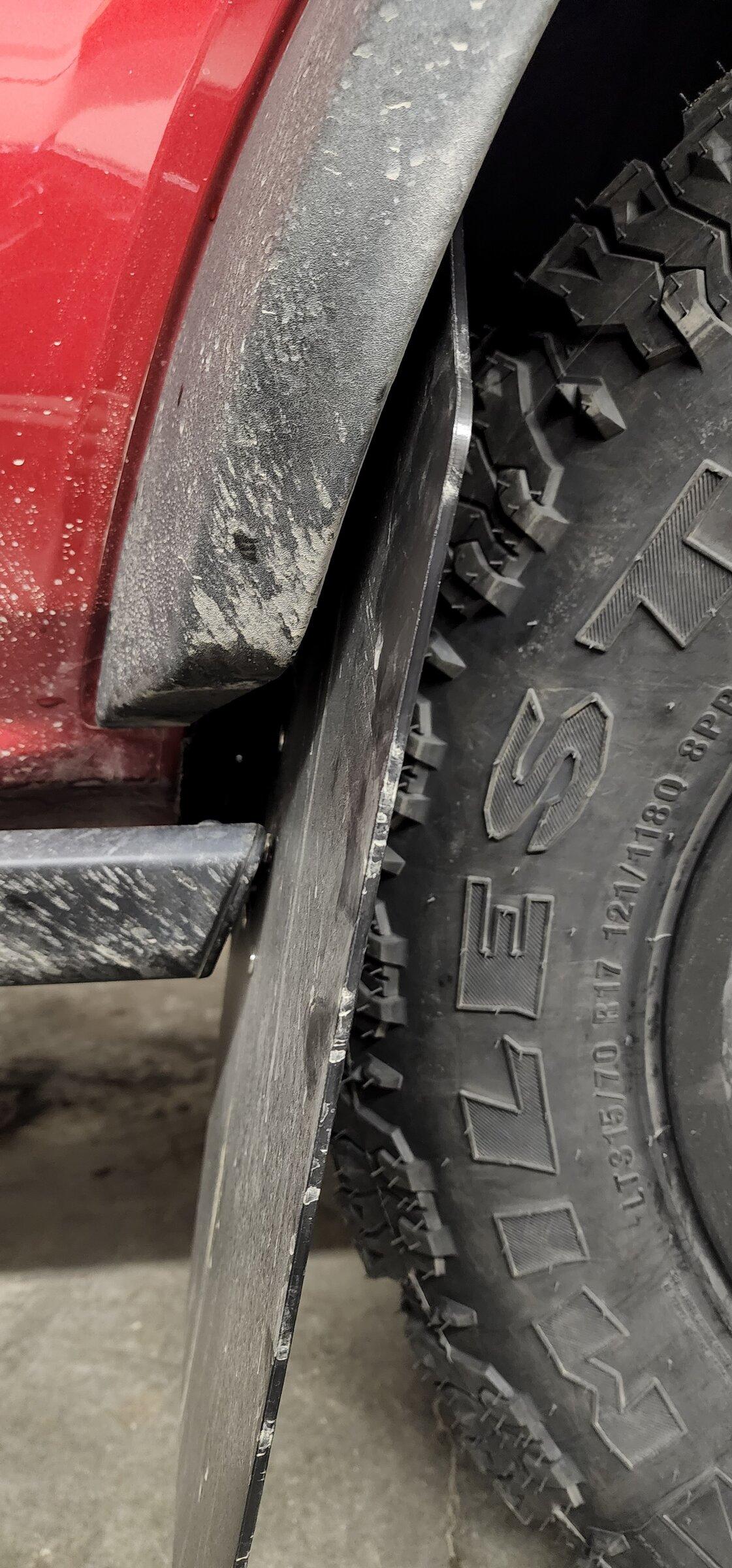

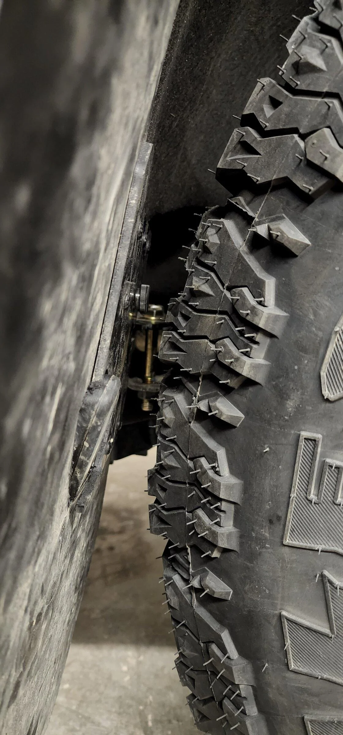

Clearance with flap and thumb screws. This is flat concrete and you can see the lug squished against the thumb screw.

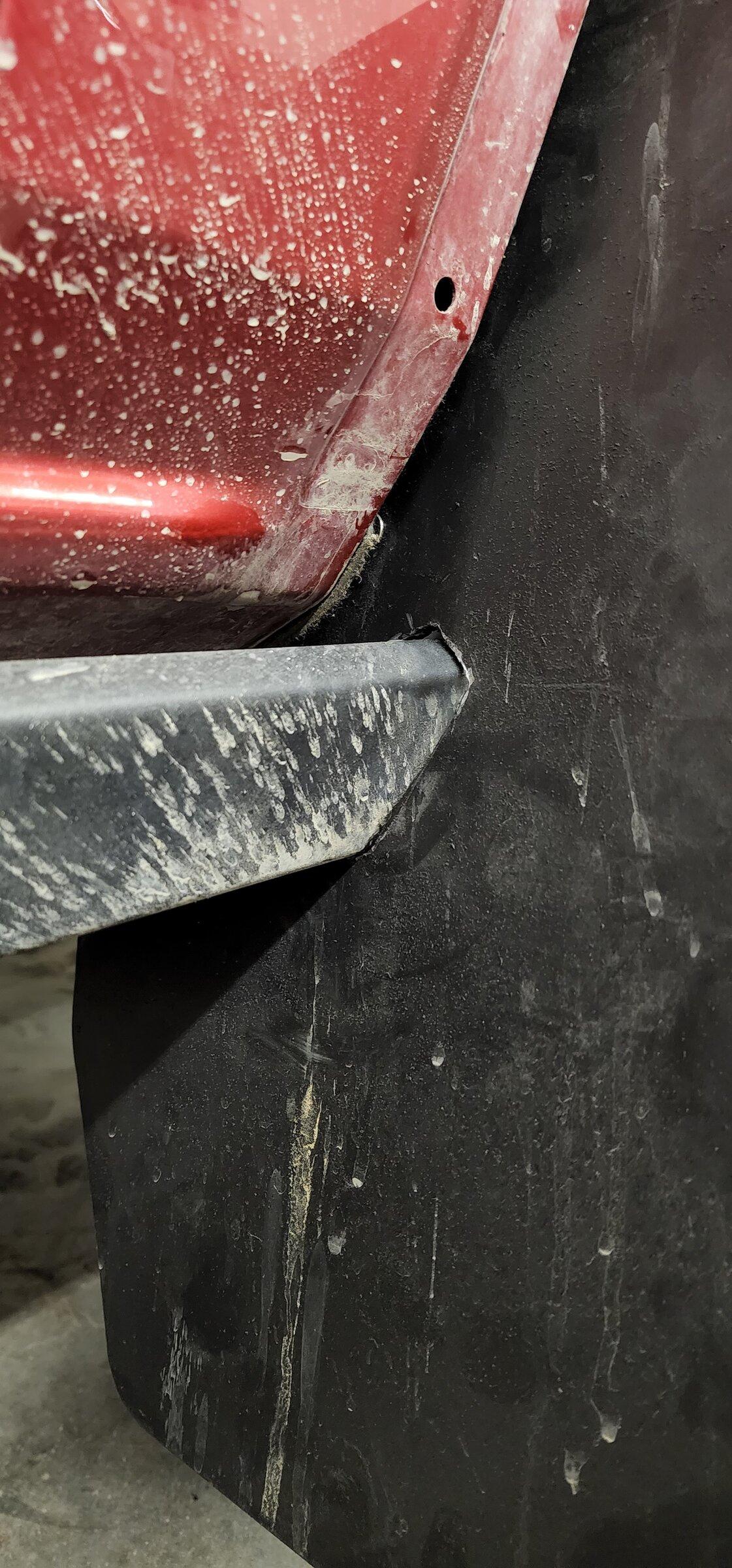

Not much clearance to be gained even if I modify the flap because of the rock rails.
I'll see what I can do about it but so far these are a no go with 0 offset wheels and a more aggressive but stock size tire.
