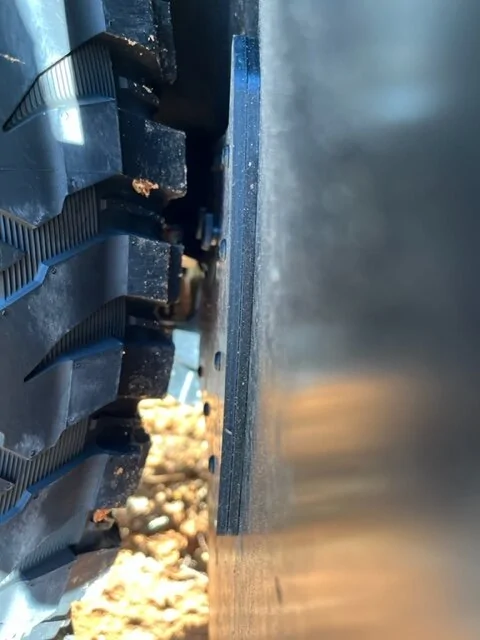

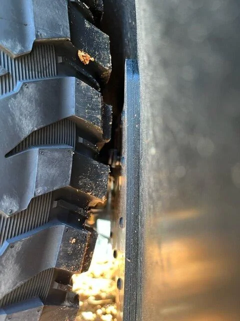

This is a pic of results when I installed without removing the plastic piece behind the fender liner. 100% rubbed never even went down the road. To be clear I knew this wasn't going to work already.
Ford Bronco RokBlokz Mudflaps with oversized tires IMG_9509

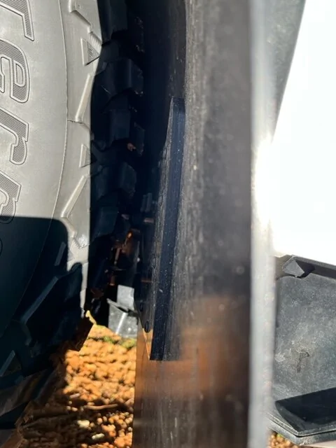

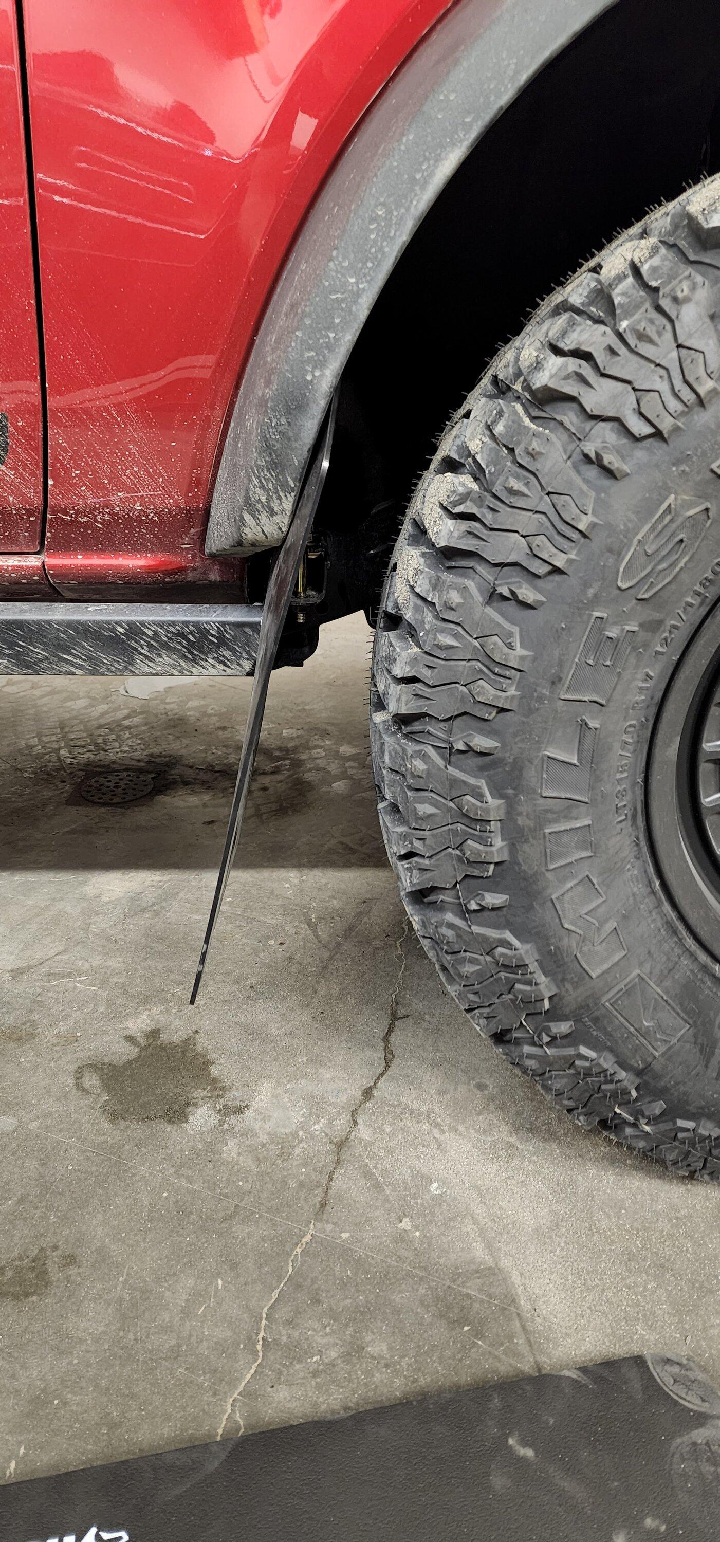

Next, I did what I said above. Pulled the fender flare, pulled the fender liner to get to the large plastic piece, removed the 3 bolts and removed, next I reinstalled the fender liner and fender flare, Installed the mudflap with the bracket and all put together, now when installing the 2 big bolts I pushed the mudflap back as far as I could and tighten while holding it back. This way I would get max distance from the tire. Personally I like it, I think the rockslides help keep it looking better.
Ford Bronco RokBlokz Mudflaps with oversized tires IMG_9513
Ford Bronco RokBlokz Mudflaps with oversized tires IMG_9514
Ford Bronco RokBlokz Mudflaps with oversized tires IMG_9515
I most likely will keep the back ones off unless I am pulling my boat or something, But maybe not I dot really think they look that bad. (Also the rear are pushed all the way in. They can be pulled out about an 1in or so)

Hey Bradley, thanks for all of your posts - have learned a lot. I'm running a similar set-up (BD Sasquatch w/ 1in level, OEM wheels, 3/8ths wheel spacers, and 37x12.5r17 Cooper AT3 XLTs). So, before I spend the $ on RokBlokz - can you confirm that the front RokBlokz flaps did not fit out-of-the-box? You had to delete a plastic piece from behind the back-side of the front fender liners?

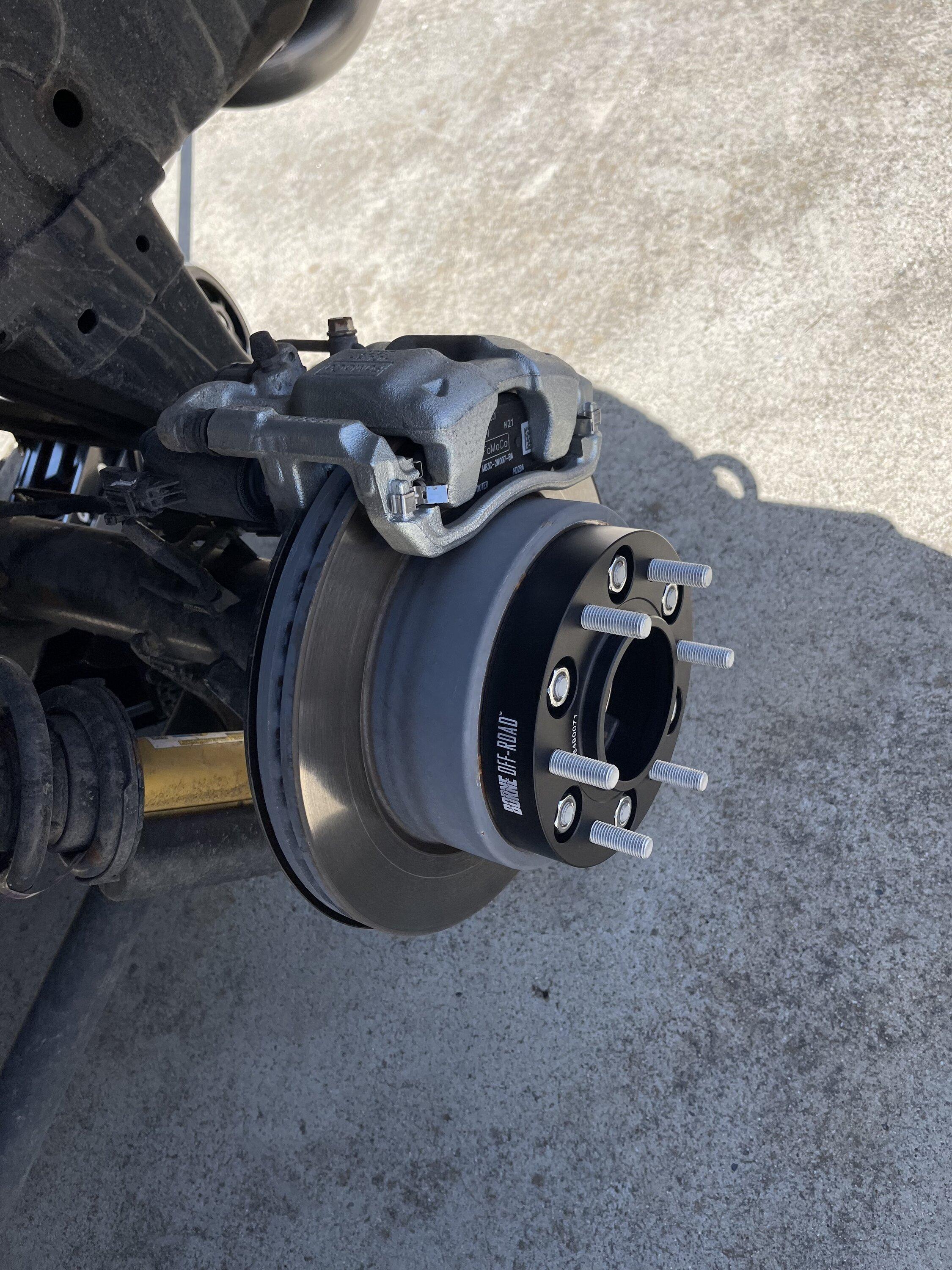

Yea mine rubbed with stock wheels and tires sasquatch, with 1.2” wheel spacers. I put 1” level kit on front and is close but doesn’t rub anymore.
I'm going to say it will rub with any type of off-roading if not just with the install your lift may keep it off but really no reason not to delete the plastic piece.

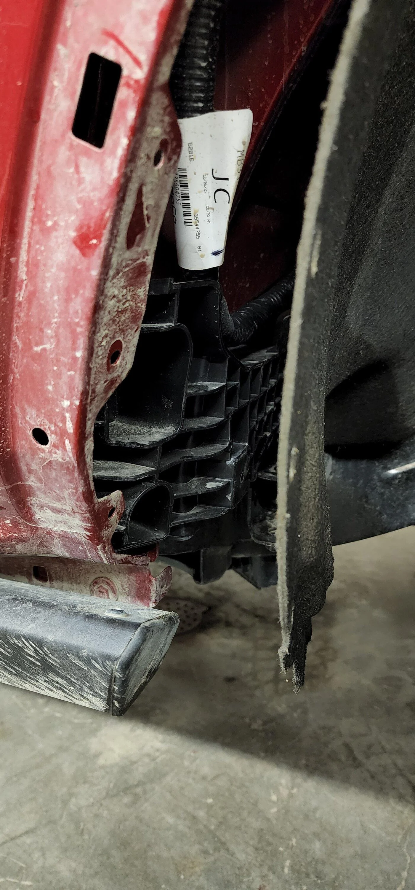

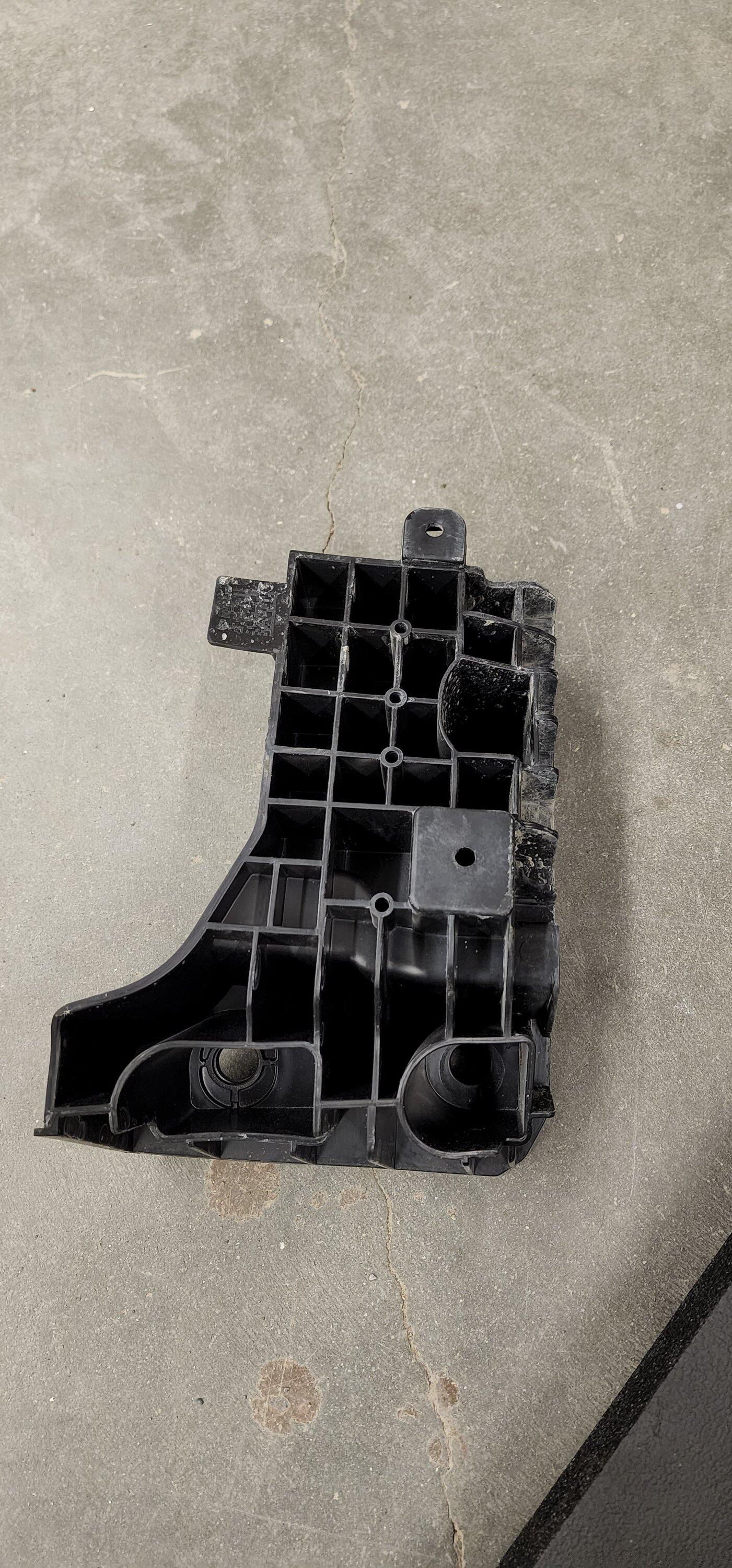

So deleting the plastic piece allowed you to push-back the front RokBlokz flap mount far enough back (toward the firewall) to avoid rubbing? Which is the plastic piece behind the fender liner you deleted? Sorry if I missed something obvious - thanks for helping me along! 😂

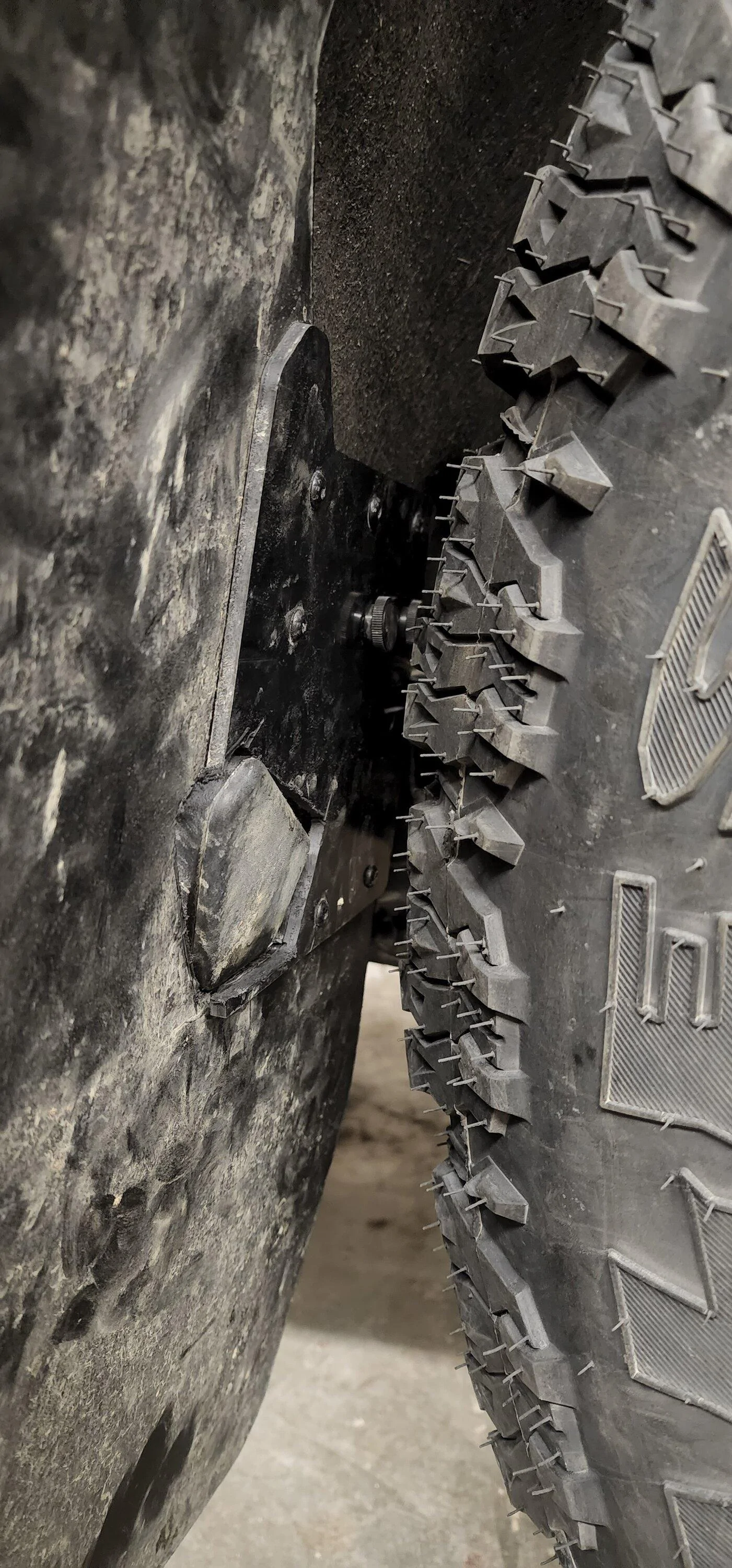

Yea removing that gives you a lot of extra room. All it does it create a place for a couple of the push pins that hold the fender liner to grab on to, but it kills a lot of clearance. So you lose a couple push pins when you remove the block, but the flap and its bracket will hold the liner up.
I posted pics of the actual block in another thread but I may as well post them here as well. If your vehicle has rock rails you'll need to cut holes in the flaps to take advantage of the extra clearance gained by removing the plastic spacer.

What type of spacers did you use? I have a BL/SQ and I wanted to use some to increase the offset of my wheels.
I used the Borne ones by Mishimoto
