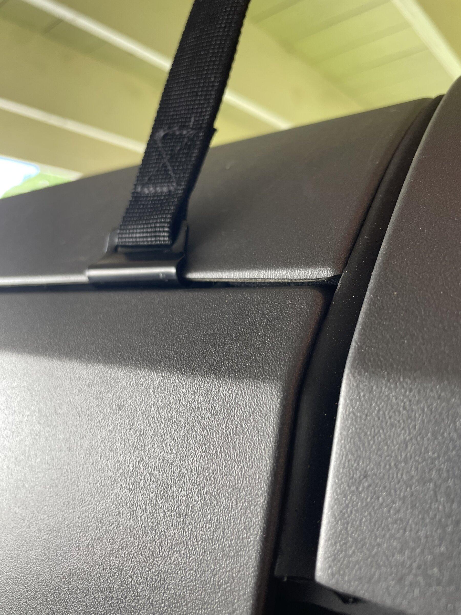

So I didn't get the roof rails with my 2-door. Looking at it now, maybe I should have, but I didn't really like the bulky look of them and figured I could get them later or some other aftermarket one. Well, I hear you still can't get the oem one yet, and it'll probably be twice the price so I'll probably be strapping my surfboards down with some type of makeshift soft rack setup for awhile. Anybody try these flat hook type straps on their bronco yet? There are some companies that will custom make cam or ratchet straps with these type "flat hooks" too.
Might try to come up with some type of hoist system with them as well.

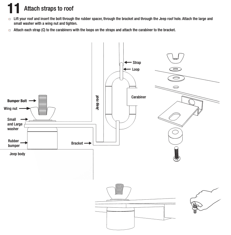

https://www.bestop.com/products/hos...-2018-2021-wrangler-jl-2007-2018-wrangler-jk/ - is what i really want them to come out with for the Bronco.
The reason why i like this - is the way you attach it to the hardtop. Contact them and can't buy the bracket to test fit, but seems like its an easy make part.
i want to be able to close the back window when in the air and also not have the straps on the rubber moulding.

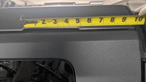

The width of each "anchor point" is about 4 3/4".
Ford Bronco Roof straps for hardtop. 1642208589449
My initial though was that a 4" flat hook at each of the Roof rack mount point would be the best (distribute the load of the roof while hoisted), but think it is overkill. In looking at some different options, going with 4 x 2" flat end with bolt loop's may be the best option - still overkill (2" x 11" Fixed End w/ Flat Hook and Bolt Loop)
These straps would then connect to something similar to the Harken hoist (Harken Overtop) or (Kayak Hoist)
I prefer the 4 point system of the harken on the ceiling as I use the Kayak hoist today for ladders and it's easy for it to tilt to the side when lifting.
With a 4 door top there are 4 mounting points on the roof.

I only have a 2-door so only two rack mounting points, but I think I could probably hook the base of the hardtop with a flat hook for hoisting.
I’m also wondering how strong the rest of the top dripline would be for strapping purposes. Also looking at the rear 2 inches of the front roof panels.
Those ones you linked look beefy, but good peace of mind!

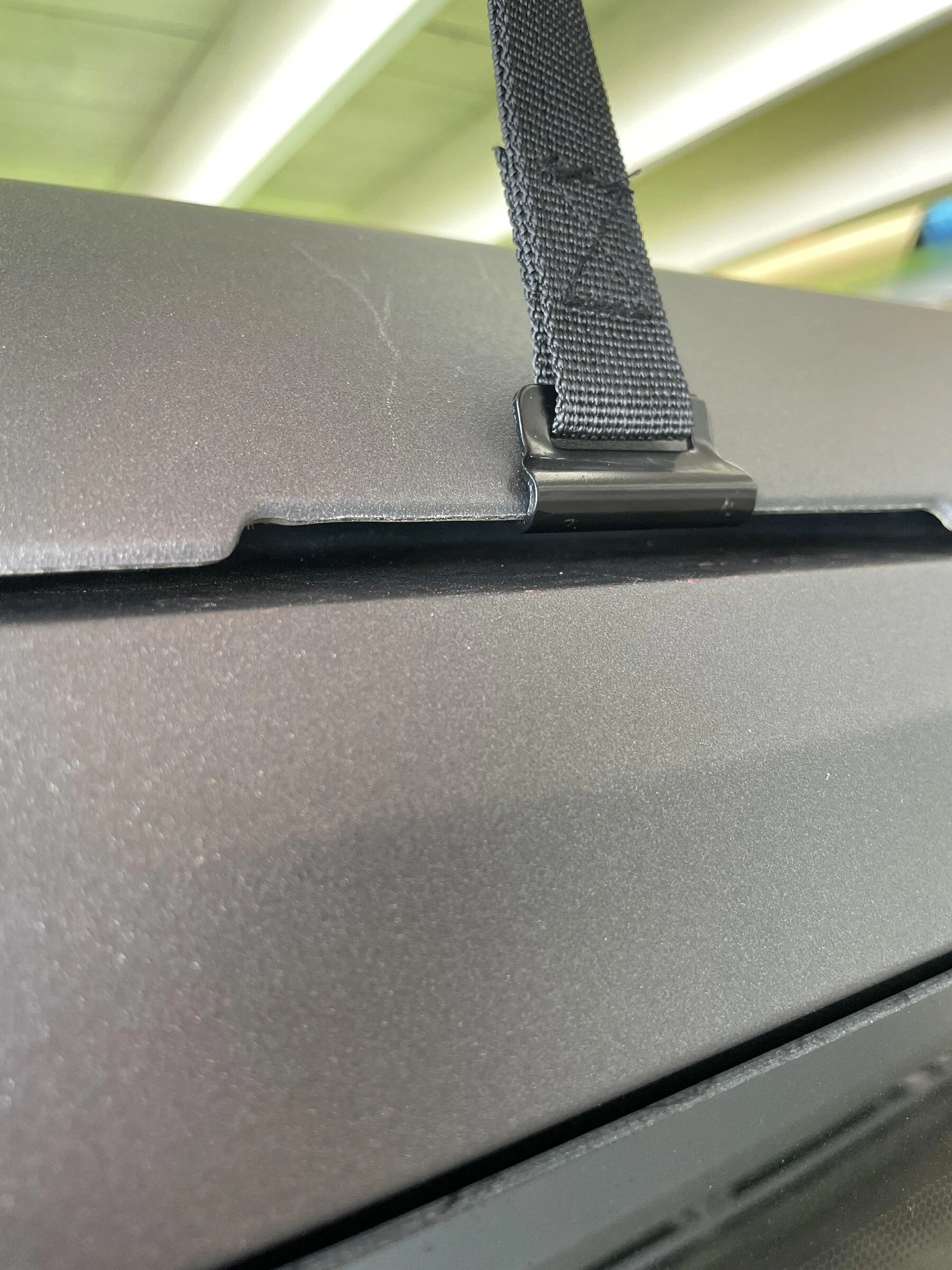

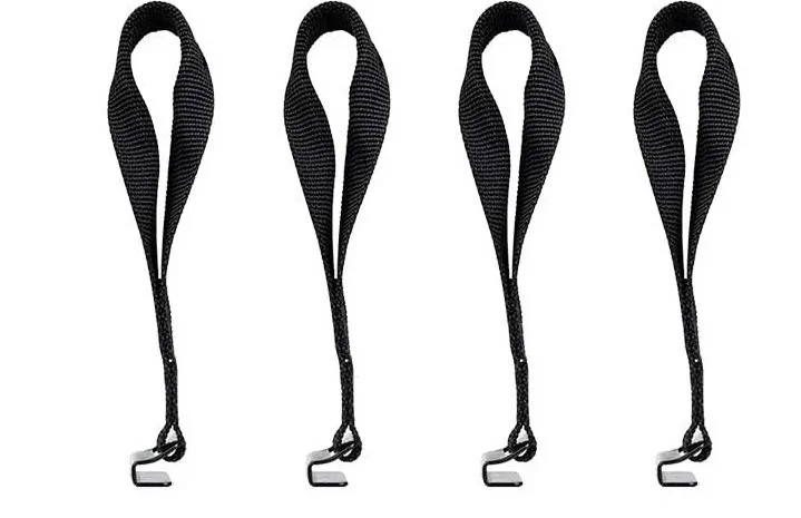

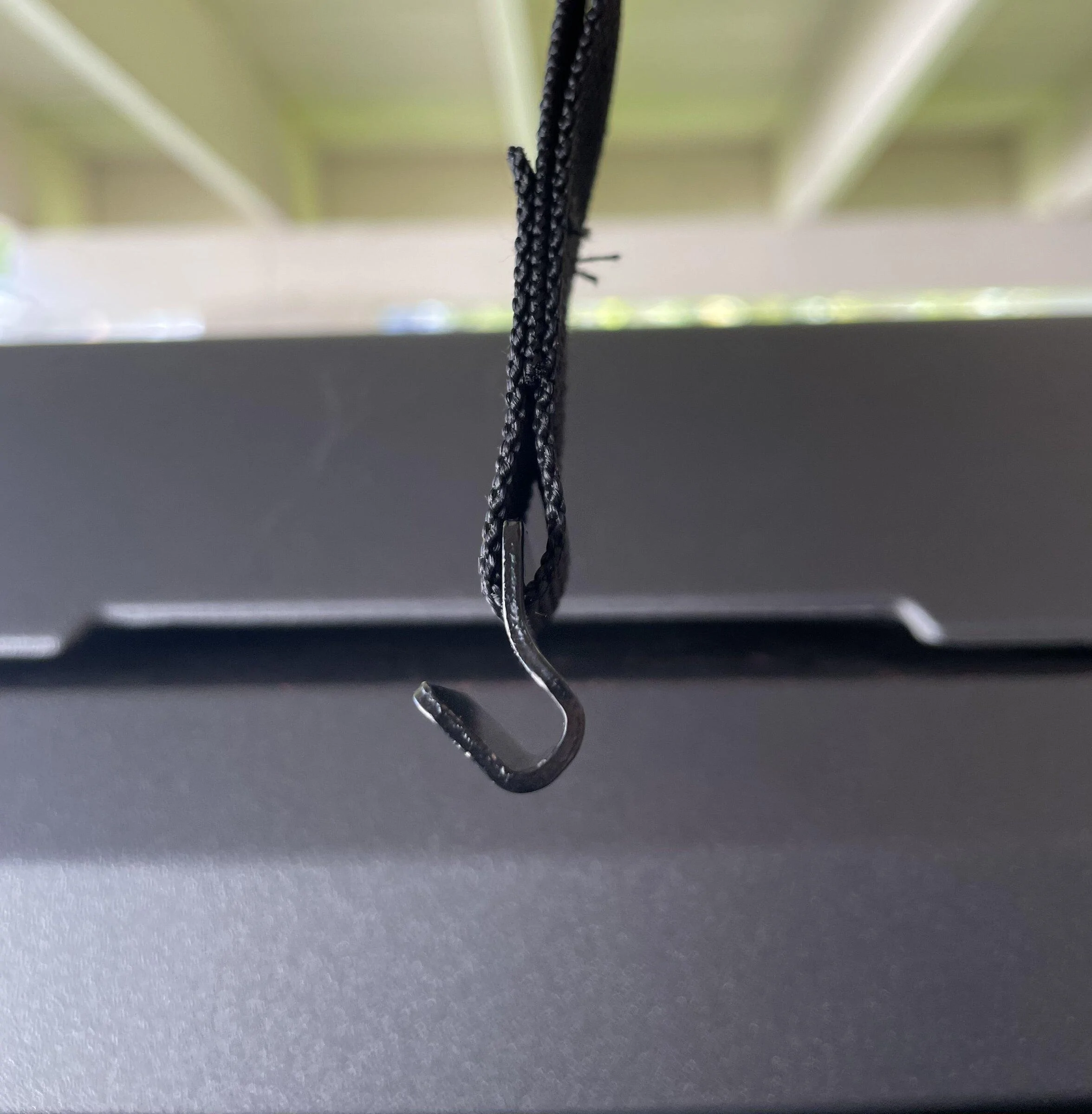

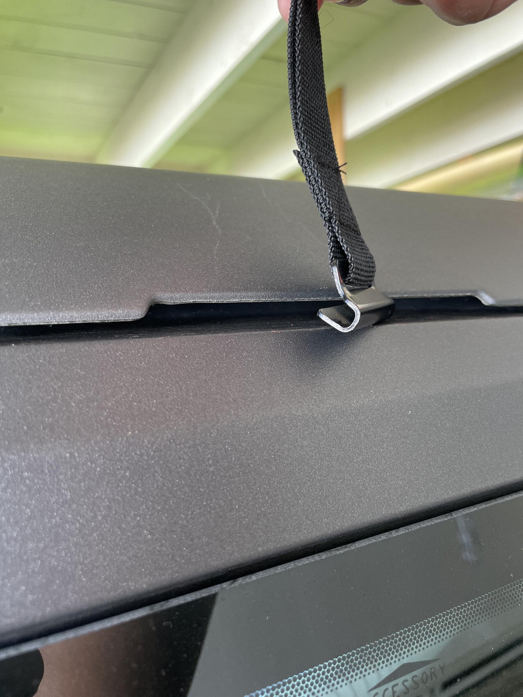

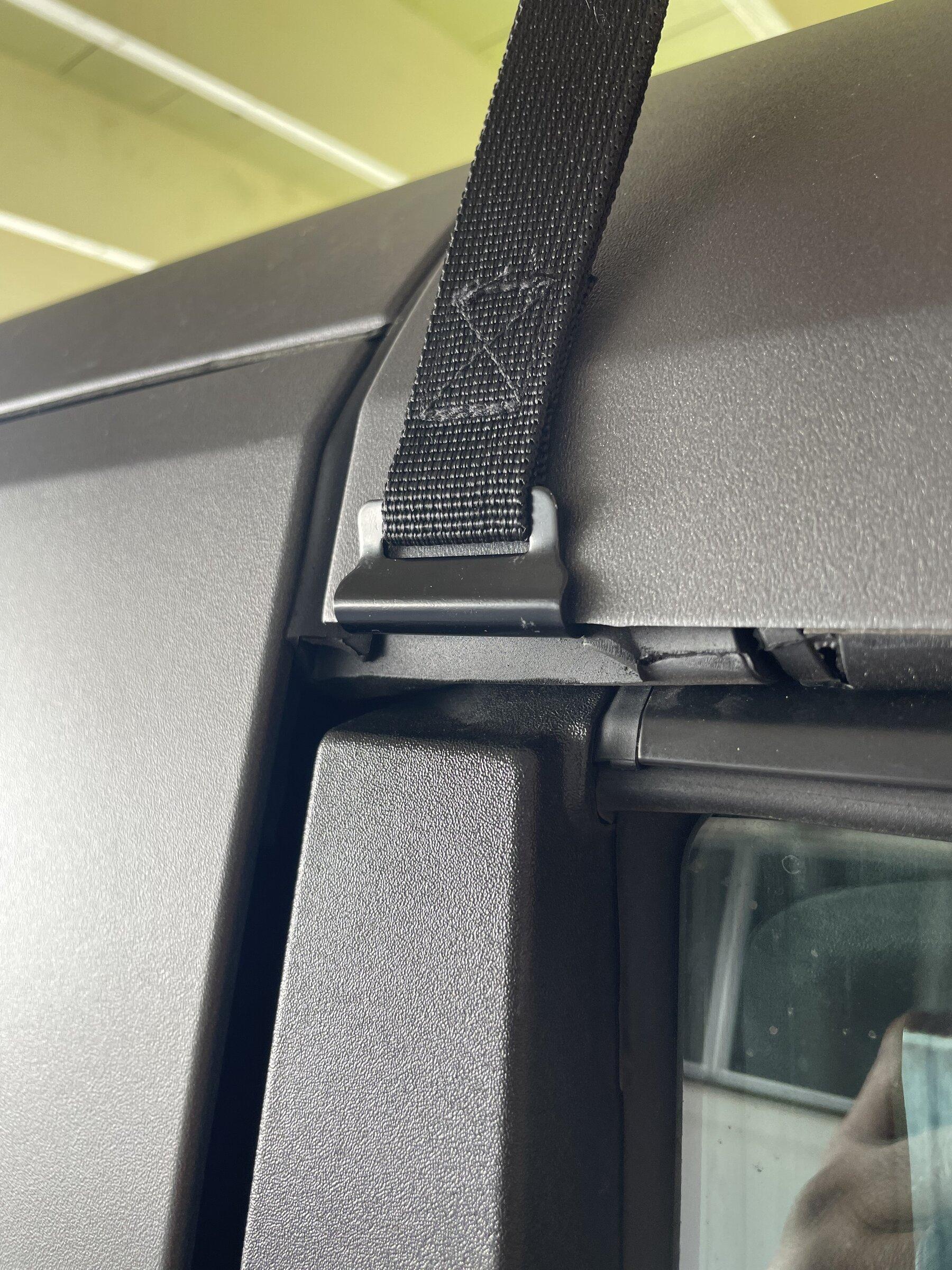

So I bought the cheapest set on amazon to try out. $8.50 for eight short loops w/ the flat hook. Couldn’t really tell what the profile of the hook was from the pics. These seem like they will work for me for strapping down my surfboards in combination with some cam straps. They hold pretty good and the MIC doesn’t flex much. Wish the hooks were a little longer, but they work. They can also slide down the full length of the “drip rail”, and can hook onto the rear of the front roof panels on a 2-door. These won’t hook the bottom of the MIC, maybe if you lift it first. But I think lifting from the bottom like that with straps might be too much stress.

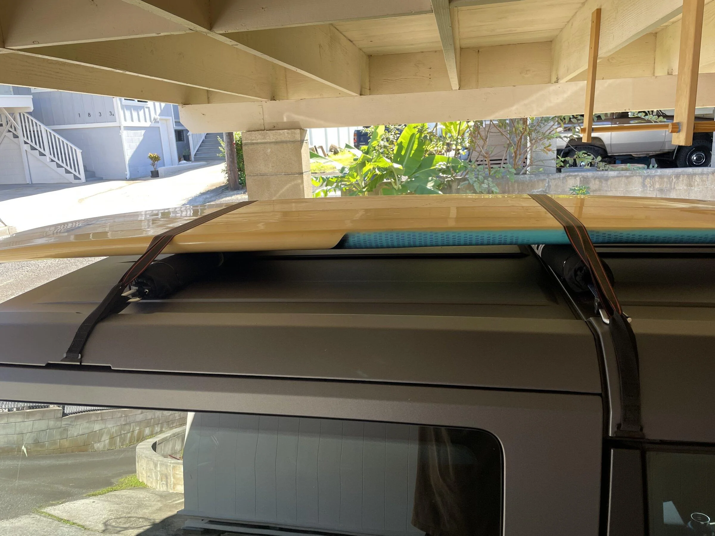

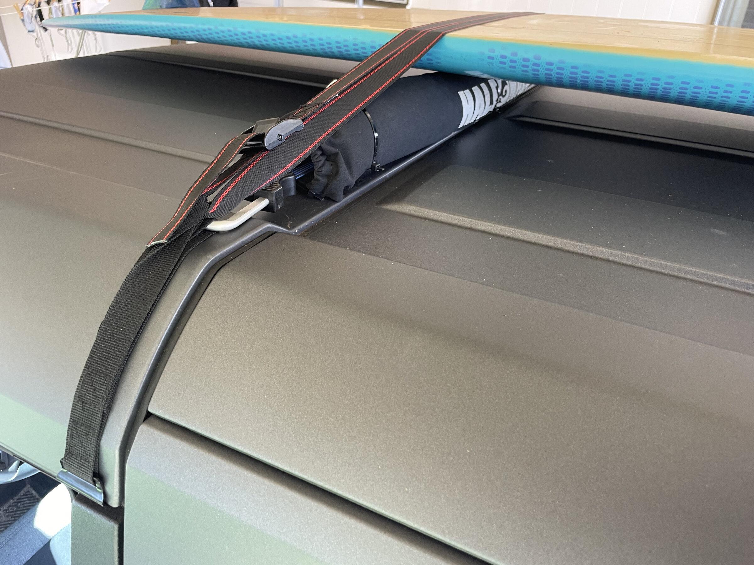

Always run two straps. And front is the most important. Just finished my setup as described earlier. Some bungee straps w/ caribener ends running through a old set of rack pads I had. Connected to the flat hook loops and boards tied down with cam straps. It’s solid. I have one set of flat hooks on the front roof panel.
Ford Bronco Roof straps for hardtop. A829010B-56CF-470C-A29C-9F8679C84D4C
Ford Bronco Roof straps for hardtop. E6238F8F-E4FA-42F6-A28B-A86BB349F77C
Going out now. Will let you know if I lose it on the highway.

Thanks for the update. That looks pretty solid. But now I realize the difference with the 4dr...I dont have that anchor point in the front panel...I just have 2 anchor points in the back, which is why I was worried about just using those two in the back panel.
