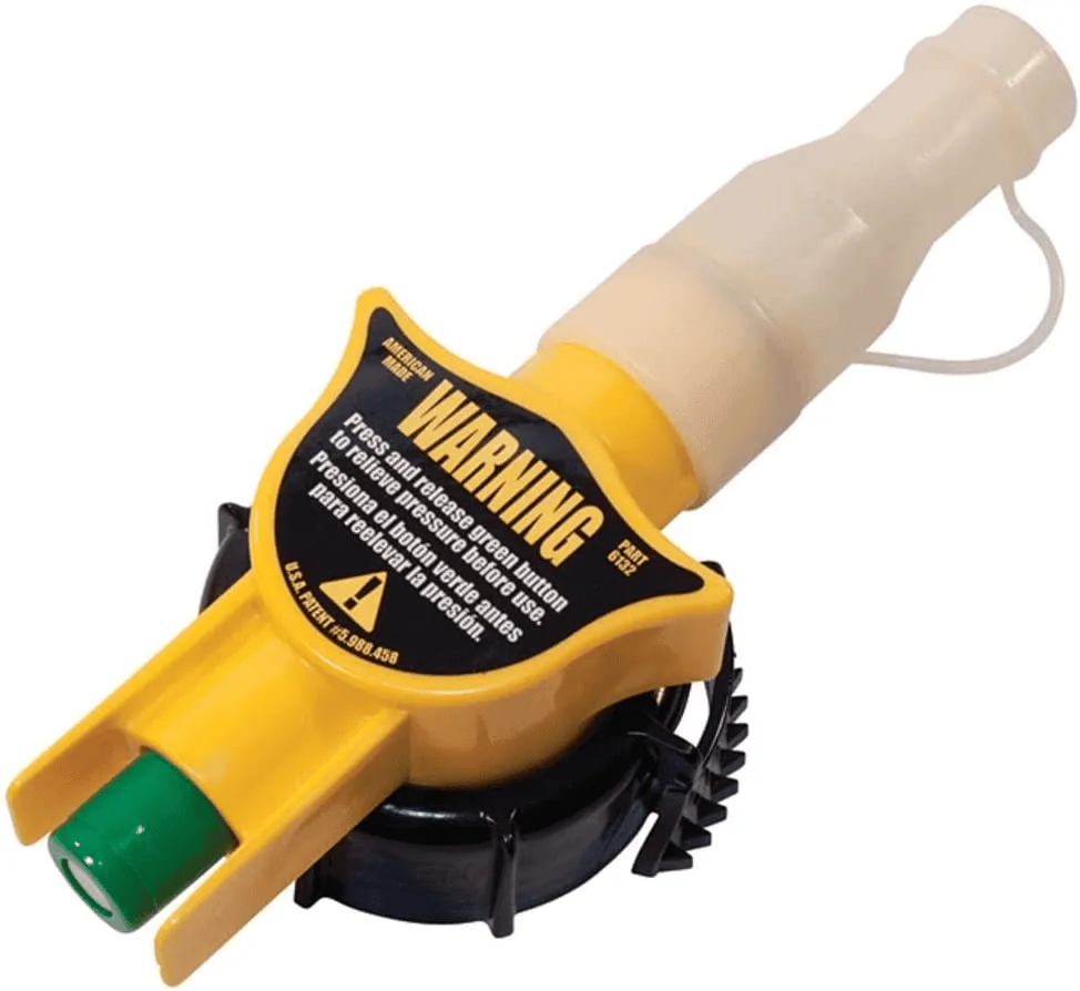

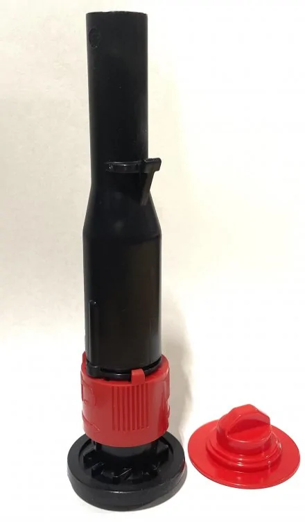

Which spout did your Rotopax come with:
The Yellow one is the old one, and the black and red is the newer one.

The “red one’. It will only work against a “hard object”. Using it with the Bronco funnel requires an extra hand or two.

Okay, the yellow/black ones are the old gas/diesel ones, but I have one 1 gallon gas with the new red/black ones.
What I believe you will need to do is turn the red piece and hold it down while you are pouring, the yellow/black ones you don't need to turn the yellow piece.
What it sounds like you were doing, was trying to put pressure on the top of the nozzle to push in and get it to flow, since you can't push in on the funnel, you should be grabbing the base of the nozzle, turn and push down the red piece and continue holding that red piece down while you poor into the funnel.
If you still can't get that to work, the all yellow is said to be for water, but you could just use that. However I would not store that all yellow in a rotopax that is full of fuel, I would just keep it for easy pouring and not leaving it in fuel.
